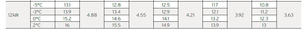

Both definitely say they will quote, on the basis of a Vaillant 12kW Aerotherm Plus (which is more than 0.6 m^3) and a Daikin Altherma HT ?16kW respectively. It remains to be seen what they come up with and whether it includes any heat loss calcs.

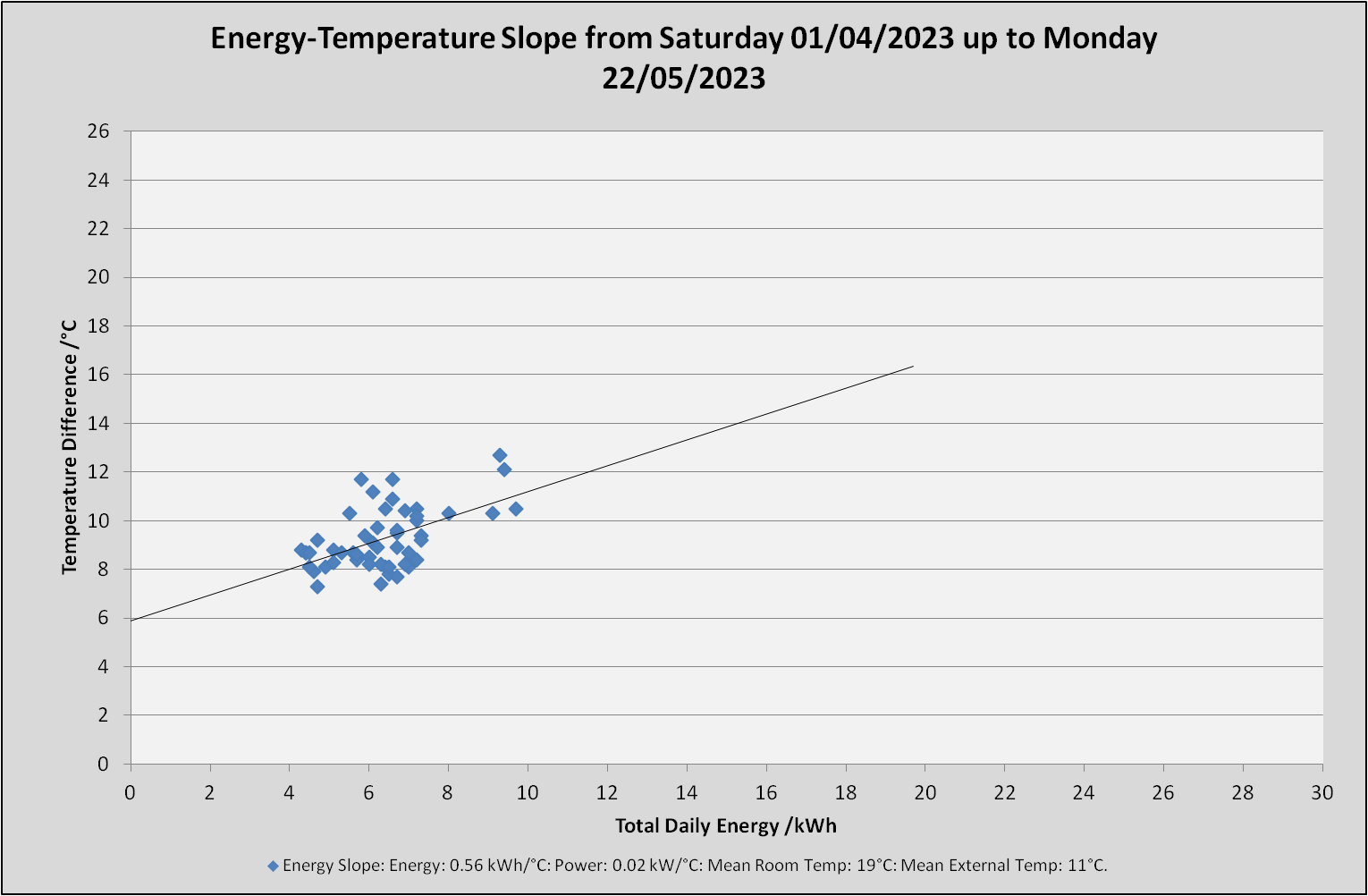

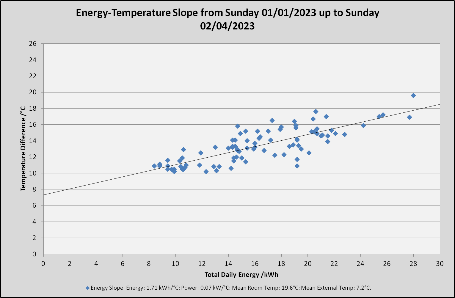

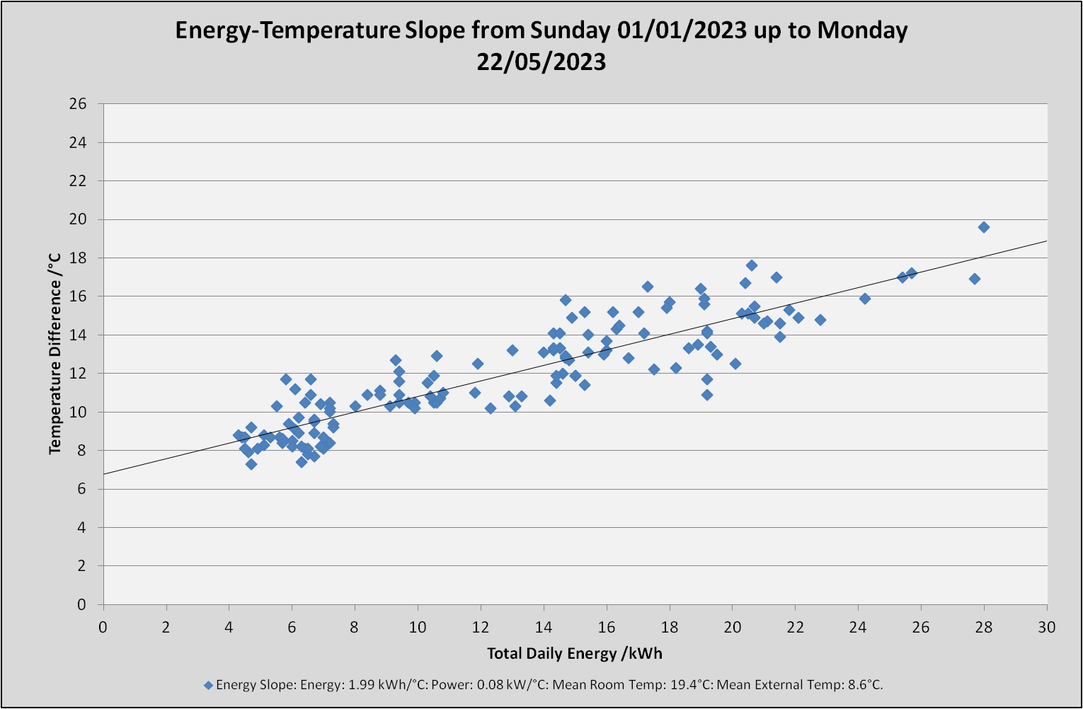

Based on my own experience I wouldn't assume this.  From a physics standpoint there is little or no thermal separation between rooms, so the whole house loss might not be much less with zoning than without.  My measurements on my own house tend to support this.
If you can bear to wait, run your current heating next winter at low flow temp 24*7 with at least most rooms heated.  You may be surprised.  This last winter I did that and consumed 10pc less energy than has historically been the case.  Take frequent measurements or get a smart meter.
I have gone from 16kW calculated by 2 MCS installers, to 10.5 calculated by me, to 7.5 actually measured during the very cold patch last December (when it was lower than the 'design' temp for five days and nights in a row).  This is consistent with a regression analysis of my half hourly meter readings and the maximum three hour average for the entirety of the 2022-2023 heating season.  I am now planning to fit a 9kW pump.  Of course I may end up cold, but if I need a bit of supplemental heating and as need a bit of supplemental heating on a very few days then that's probably a good trade off.

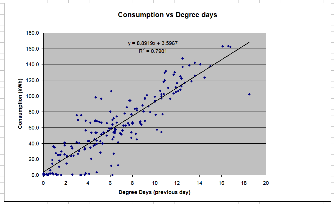

5 hours ago, JamesPa said:
With a smart meter, half hourly meter readings are available and can readily be correlated with average OAT/degree days to get the required load (and with a bit more manipulation the 'thermal mass', which could help with setting up control parameters).
Something like this?
With the heating off.
With the heating on.

Below is my plot of daily consumption vs degree days, calculated daily from half hour smart meter readings.
Note the maximum daily total consumption is 165kWh ie average 6.9kW.  This is for a house that the MCS bods rate at 16kW.  Observations of my smart meter in the cold period (when it was 3C below the 'design temp') indicate 7.5kW and, if I would out the 3 hour average over the entire period it maxes out at 9kW, just once during the whole period, on a day when I turned the heating off at night.  So for certain 9kW is sufficient in my house and 8kW would very likely do.
Furthermore actual observations indicate that most of the time my house sits at around 4kW.  Thus, if I were to do what the MCS bods want me to do and install a 16kW unit or more, I would be into cycling most of the time with the typical modulation ratio* of about 3, a COP disaster.  (*excluding units like Samsung which, according to @markocosic, deploy somewhat dodgy techniques to make the modulation ratio appear better whilst actually wasting energy and, in fairness, some of the 'better' units like Vaillant which appear to have a genuine modulation ratio which is greater than about 3)
The current way to calculate heat load is, I am fast concluding, pseudo-science because it depends on factors that, in the real world, are not well known (other than in a brand new building) and which make a significant difference to the result.
This thread will hopefully stimulate constructive criticism of this view (based on the factors I have stated in the first post).  If I am right then the industry method of calculating heat load for retrofits needs to be upended.  I am genuinely looking forward to a robust debate on this matter.

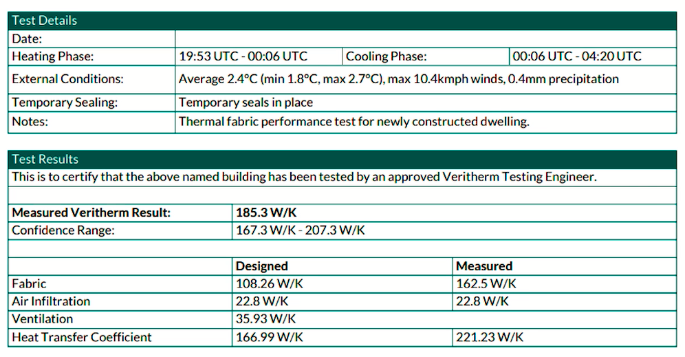

But I suppose the big question is how well is it viewed by the installation trade? If they believe in it and it reduces uncertainties and therefore the risk of an unhappy customer there is something in it for them.
So I will ask the two firms what they think when they get back to me. I will also ask them for references for similar properties to mine.
Is this the way forward? Has anyone here had Veritherm in?

Its impossible to tell whether the loss is nearer 6 than 12kW, I wouldn't be surprised if the loss were ~8kW but, as I know very little about your home (and even if I did don't have anything other than a qualitative idea of the effect), this is pure speculation.  The qualitative test in the paragraph above might tell you a bit more but not enough to make a decision IMHO.
So does this matter?  Again it all depends.  If the MCS bods fit a 14kW poorly modulating HP on the back of a 12kW calculation and your house turns out o be 8kW and require, say, 3-4kW through most of the shoulder season, you will get rubbish COP.  If they fit a 12 or 14kW unit that can modulate reliably down to whatever is required in the shoulder season the COP wont suffer significantly.  However even in the latter case you may still be forced, possibly unnecessarily, to do one or more of the following
add a buffer tank (cost, space, bad for COP unless properly set up, which it likely will not be)
upgrade primary feeds to the CH (cost plus disruption)
upgrade primary feeds to the DHW cylinder (cost plus disruption)
replace the DHW cylinder (cost plus disruption)
replace more emitters than is necessary (although thats not necessarily so bad because you will likely, as a result, to be able to run at a lower flow temp than designed)
In addition you will likely end up with a 2 fan unit not a 1 fan unit, which may therefore require express planning consent and, depending on your LPA and surroundings, this may cause problems or render the project impossible.
Again without more detail its impossible to know, and even with more detail it depends on which particular preferences the individual installers have.
+ @SteamyTea
It doesn't really matter for calculating peak load but for interest I was able to get a much better regression fit by adding the following variables to a multivariate regression:
Solar energy
Temperature delta
HDD*Windspeed
R2 = 0.93

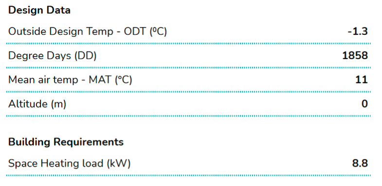

Have you looked at the Michael de Podesta YouTube video?
It seems at least as accurate a method for heat pump sizing as those used by commercial specifiers.
The heat punk calculator is a fairly simple interactive calculator that will give you heat pump size from building dimensions and construction and lets you play with emitter sizing and flow temperatures to see the effect on performance. You have to set up an account but it's free. Fairly time consuming initially but very informative.
https://heatpunk.co.uk/home
13 minutes ago, S2D2 said:
HDD*Windspeed
Interesting one.
Windspeed on its own is a very weak correlation for my house.
Generally windspeed correlates nicely with OAT.
Mainly because we have high windspeeds from the SW, and low windspeeds from the NE.
Does mean we get caught out occasionally, Beasts from the East.
Edited by SteamyTea
26 minutes ago, SteamyTea said:
Interesting one.
It's by far the least significant of the three but had enough of an impact for me to leave it in. If I get around to the known airtightness issue jobs I imagine it would become even less significant. Good airtightness and insulation would see it removed entirely as an input variable I imagine.
Thanks for this.  The video is basically advocating a specific variant of the general principal I am suggesting (ie actually measuring the heat loss rather than, or in addition to, calculating it from theoretical assumptions about the fabric).
I registered for Heatpunk, its basically a same old same old MCS assumption based estimator, which will probably work fine if you have a house that is
a) of a consistent construction
b) hasn't had fabric upgrades, and
c) has the MCS assumed ventilation rates (are there any such houses?)
However it will get wrong, in some cases by a massive amount, houses which have been extended to different specs, have had partial fabric improvements or fabric upgrades to variable specs, or are not as leaky as MCS assumes.
Newer houses should, in principle, fare better as they are less likely to have variably-specified fabric upgrades.  However they may also be less leaky than older houses so I'm not entirely sure that overall the result will be that much better.  The heat pump manufacturers, at least those with web connected monitoring, have the stats on this if they chose to look.  It would be really interesting to find out what they know!
