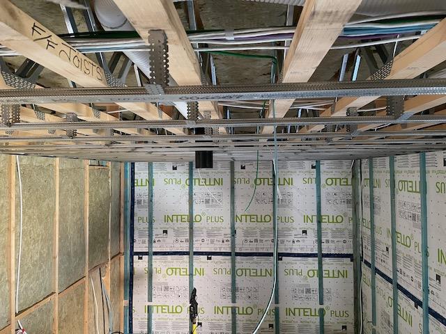

Thorfun Posted July 2, 2023 Author Posted July 2, 2023 Please forgive this potentially noddy question but do I need a specific type of screw to attach the GL8 to the timber frame? Or do I pilot hole the track and then just use standard timber screws?
TonyT Posted July 2, 2023 Posted July 2, 2023 You get screws with a drill tip, so you don’t pre drill google gyproc screws
Thorfun Posted July 3, 2023 Author Posted July 3, 2023 8 hours ago, TonyT said: You get screws with a drill tip, so you don’t pre drill google gyproc screws Thanks. Did that and found these on Screwfix which I’ve ordered. https://www.screwfix.com/p/easydrive-pz-wafer-self-tapping-screws-8ga-x-3-4-100-pack/6553h seem the same thing as the Gyproc ones.
Thorfun Posted July 3, 2023 Author Posted July 3, 2023 19 hours ago, TonyT said: You get screws with a drill tip, so you don’t pre drill google gyproc screws I bought these from Screwfix https://www.screwfix.com/p/easydrive-pz-wafer-self-tapping-screws-8ga-x-1-2-100-pack/8979h and they do the job but they're quite hard to get to screw in! I need to apply quite a bit of pressure which is tricky when you're up a ladder trying to hold a GL1 channel and the GL12 bracket and a screw and the drill! would the 'official' Gyproc screws be any easier? https://www.jewson.co.uk/p/gypframe-wafer-head-drywall-screw-fixings-13mm-l-chrome-PRTBG692# or would they be exactly the same as the Easydrive ones from SF?
saveasteading Posted July 3, 2023 Posted July 3, 2023 The official ones tend to be better. Sharper points and fins. Its worth having a few quality heads too. Boarders go through a lot so it must be important, and that's why you can buy a big pack of them. 25 dewalts. How flash is that? 1
Thorfun Posted July 3, 2023 Author Posted July 3, 2023 58 minutes ago, saveasteading said: The official ones tend to be better. Sharper points and fins. Its worth having a few quality heads too. Boarders go through a lot so it must be important, and that's why you can buy a big pack of them. 25 dewalts. How flash is that? I have new Dewalt heads. Will see if I can get some Gyproc screws local tomorrow morning. Although I guess I can make a start on a different room and wait for mail order delivery.
Thorfun Posted July 6, 2023 Author Posted July 6, 2023 (edited) not bad for a first effort even if I do say so myself. Edited July 6, 2023 by Thorfun 5
Nickfromwales Posted July 6, 2023 Posted July 6, 2023 That hanger system seems to have made the job easier than with timber. Quite pleasing on the old OCD, lol.
Pocster Posted July 6, 2023 Posted July 6, 2023 On 03/07/2023 at 21:18, Thorfun said: they do the job but they're quite hard to get to screw in! I need to apply quite a bit of pressure You need some 💪💪💪💪💪💪
Thorfun Posted July 6, 2023 Author Posted July 6, 2023 4 hours ago, Nickfromwales said: That hanger system seems to have made the job easier than with timber. Quite pleasing on the old OCD, lol. yeah. it was really simple. I'm definitely an MF convert for ceilings! yet to try walls though.
Thorfun Posted July 6, 2023 Author Posted July 6, 2023 3 hours ago, pocster said: You need some 💪💪💪💪💪💪 the official Gyproc screws were better but the new Dewalt Drywall screwdriver makes it a doddle. 1

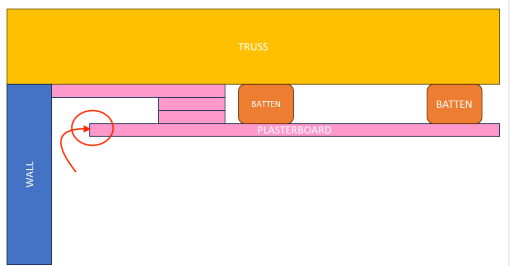

Thorfun Posted July 8, 2023 Author Posted July 8, 2023 (edited) qq. I've made the shadow gap similar to how @MortarThePoint drew it. how would I finish off the plasterboard edge that forms the shadow gap (circled in red in the drawing taken from @MortarThePoint's drawing) it's just raw plasterboard with no covering. I need something on the end to 'finish' it as surely can't just leave it as open plasterboard!! Edited July 8, 2023 by Thorfun added photo 2
Thorfun Posted July 8, 2023 Author Posted July 8, 2023 19 minutes ago, Thorfun said: qq. I've made the shadow gap similar to how @MortarThePoint drew it. how would I finish off the plasterboard edge that forms the shadow gap (circled in red in the drawing taken from @MortarThePoint's drawing) it's just raw plasterboard with no covering. I need something on the end to 'finish' it as surely can't just leave it as open plasterboard!! ok. so it's called an edge bead! available in metal or plastic https://www.ccfltd.co.uk/plastering-beads-and-mesh/british-gypsum-gyproc-drywall-metal-edge-bead-12-5mm-x-2400mm/p/850434 https://www.ccfltd.co.uk/plastering-beads-and-mesh/british-gypsum-gyproc-drywall-plastic-edge-bead-12-5mm-x-3000mm/p/850000 https://www.ccfltd.co.uk/plastering-beads-and-mesh/expamet-plasterboard-edging-bead-13mm-x-3000mm/p/987960 🙂

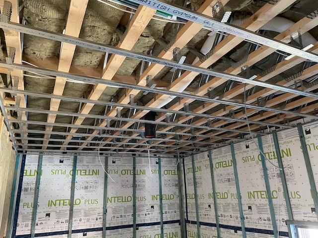

Thorfun Posted July 11, 2023 Author Posted July 11, 2023 On 06/07/2023 at 17:39, Thorfun said: not bad for a first effort even if I do say so myself. and now with the void filled with 100mm Rockwool RWA45. all ready for boarding. 🙂 now I need to figure out how to build the dropped ceiling canopy over our bed! 1
