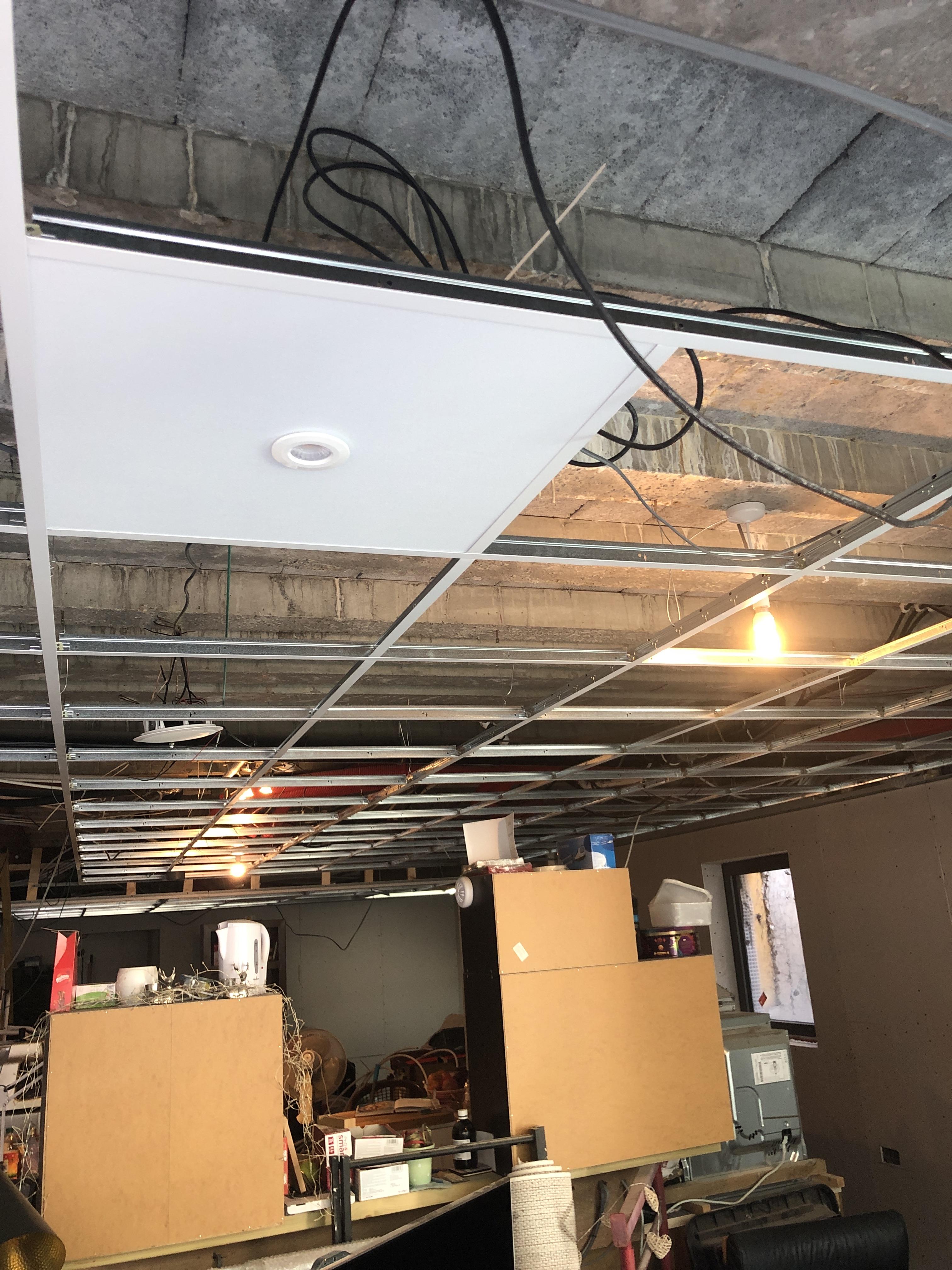

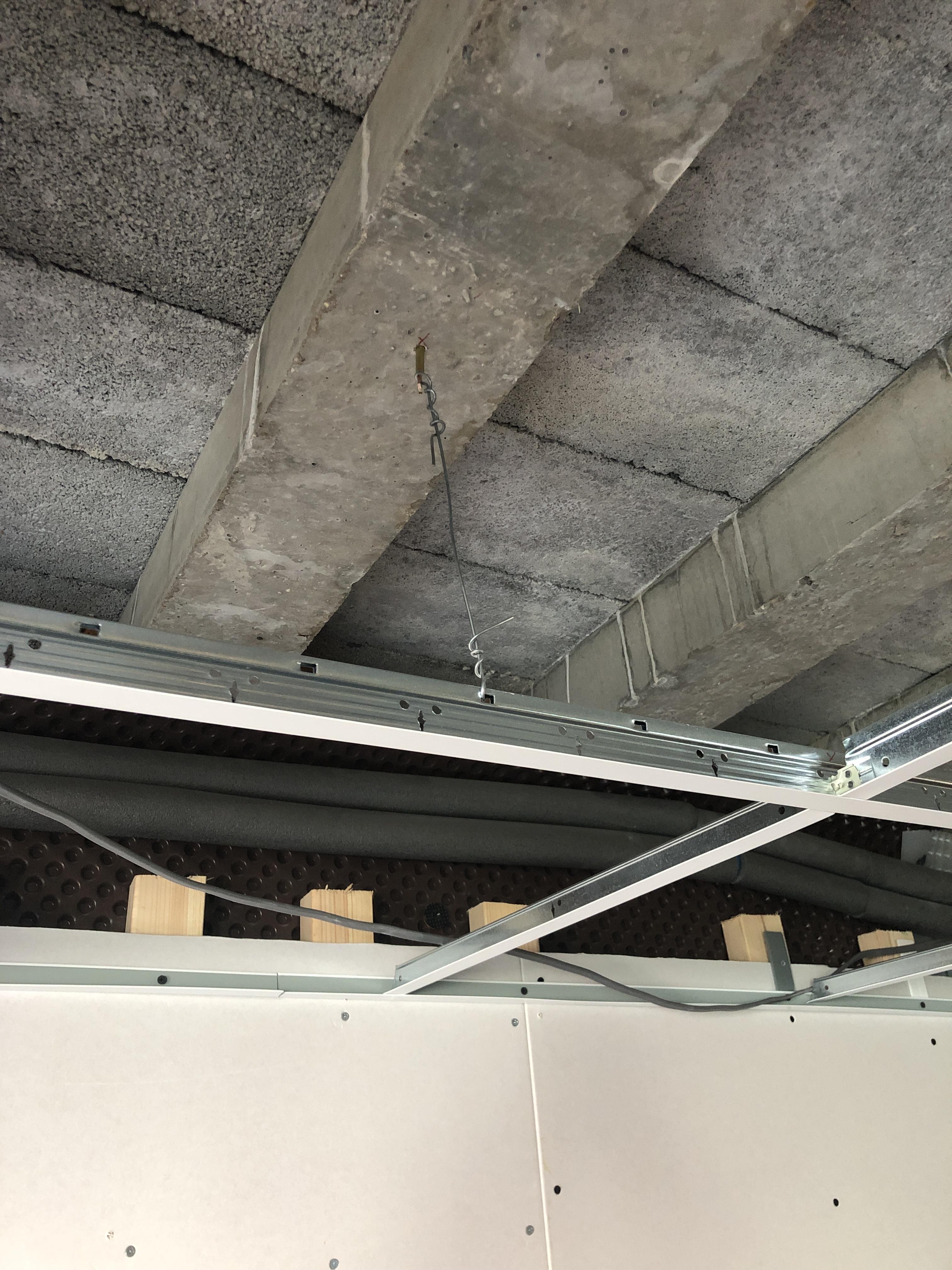

Thorfun Posted May 24, 2023 Author Share Posted May 24, 2023 2 minutes ago, pocster said: Yawn ….. does that grid system attach to the beams above? 1 Link to comment Share on other sites More sharing options...
Pocster Posted May 24, 2023 Share Posted May 24, 2023 Just now, Thorfun said: does that grid system attach to the beams above? Yes ! But with nice simple hammer in bolts and wire … Link to comment Share on other sites More sharing options...
Pocster Posted May 24, 2023 Share Posted May 24, 2023 What’s the cost estimate for your ceiling ? Timber , pb , skim , paint ? Your area slightly larger than mine I believe Link to comment Share on other sites More sharing options...
