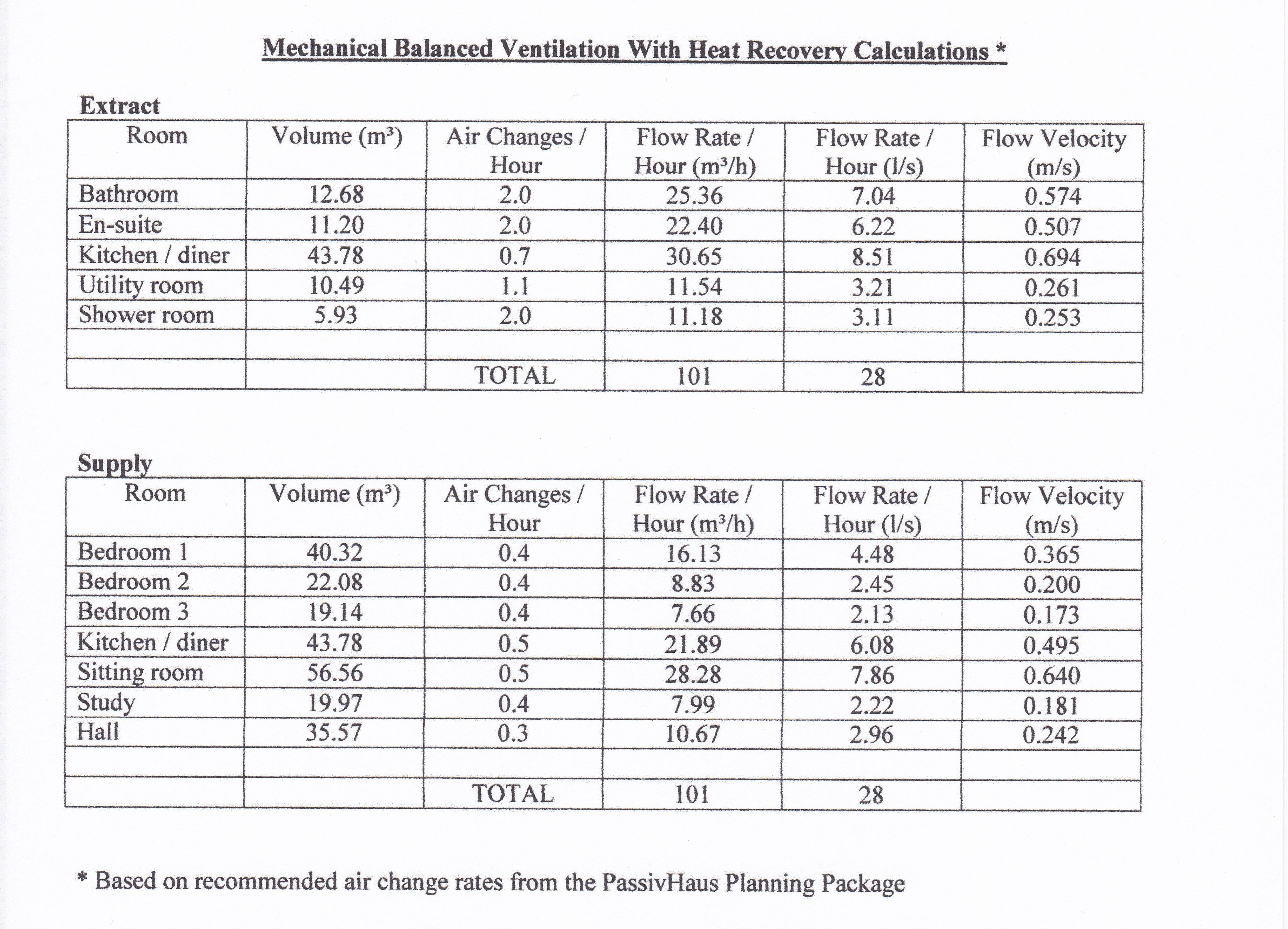

Gone West Posted May 11, 2023 Share Posted May 11, 2023 5 hours ago, Ola said: They have explained this was to help balancing the system I designed and installed the MVHR system in my last house and I had an outlet in the hall which helped with balancing the system. It's not a problem. Here is the calculation for the house. Link to comment Share on other sites More sharing options...
Ola Posted May 11, 2023 Share Posted May 11, 2023 4 hours ago, Gone West said: 10 hours ago, Ola said: I designed and installed the MVHR system in my last house and I had an outlet in the hall which helped with balancing the system. @Gone West Thanks for your input. In my case, the designer has added one valve each - supply and extract. Would it still help with balancing? In what way? I get @eandg's concern for having stale warm air sitting under the rigde (we have an open ceiling in the upper hallway too), so I'd be actually keen on having these additional valves, providing they don't have a negative impact on the whole system? (For example, drying the air too much) Could someone kindly explain why MVHR designs don't tend to have valves located in hallways? Is this just a more economical way (because of the cascade ventilation) or are there any other reasons? Link to comment Share on other sites More sharing options...

Gone West Posted May 12, 2023 Share Posted May 12, 2023 9 hours ago, Ola said: In my case, the designer has added one valve each - supply and extract. Would it still help with balancing? In what way? I don't see how. I have looked at the details on your other thread and both of the BPC configurations look odd to me. I've not seen extracts from bedrooms recommended before. The Paul design looks more conventional. The basic factors are to extract from 'damp' rooms and supply living areas, with the extract and supply being balanced. In a two storey house the hall and landing aren't usually classed as living areas but there is no reason why a supply can't be fitted either to balance the system or because the hall is large and used as a living area, as in my last house. Link to comment Share on other sites More sharing options...
