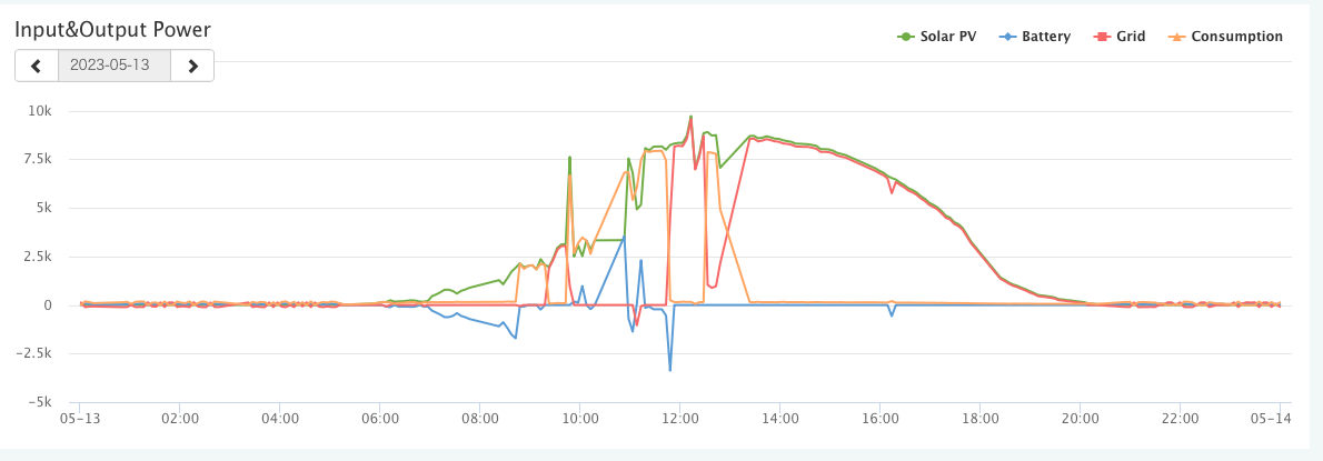

Thorfun Posted May 10, 2023 Share Posted May 10, 2023 I wanted something that could power the house in a power cut. Tesla Powerwalls had stupid lead times and so I went for a Luxpower Squirrel Pod with HanchuEss Greenlinx batteries the maximum 13A in a power cut is a little limiting but I’m planning to ask the sparky to wire lights and a coupling of emergency sockets to the EPS. but you’ll find that answer to your question depends on who you’re asking! If you read the threads in the battery forum you’ll get a good understanding of the sort of response you’ll get. 😉 1 Link to comment Share on other sites More sharing options...

Thorfun Posted May 14, 2023 Share Posted May 14, 2023 12 minutes ago, Gill said: @ThorfunThis is an interesting solution. I'm finding it rather difficult to compare batteries that meet my needs. Specifically in the winter months I want the option of a high draw rate as we'll be running some heating & cooking all on electric. If I understand the squirrel pods, these replace the single inverter? If I went two pods and enough batteries to max the draw, I have ability to pull 7 kWh concurrently. For grid export am I correct in thinking that would cap at 7kW also? How you finding the system is working for you? Also curious if it would support different batteries or if its limited to greenlinx. I'm not seeing it documented the max number that can be chained - how many pods are you running? The alternative I think would be a single larger inverter and batteries with high draw rate which only seems to be available on pricier models but there's a trade off - having more kit is potentially more points of failure. Never easy working this stuff out.... I had to cut back on spending so I only bought a single SPOD and 2 x 3.2kWh Greenlinx batteries but I have it in mind to expand that when I have some extra money. having 2 x SPODs and enough batteries would give you 7kW discharge rate. the export is not capped nor dependent on the battery system. this image shows today where I was exporting 8kW to the grid after the car had finished charging. I find the system pretty good to be honest. like I said, I'm a bit miffed that I can only have 13A max as an emergency backup supply but we have very few power cuts and if we do at least that'll be enough to keep the lights on. afaik the SPOD isn't limited to Greenlinx batteries. I bought directly from Big Green Beard and they also offer other batteries but the Greenlinx ones are the ones they recommended to me. I believe that max 2 x SPODs can be chained but a call to Infinity Innovations should clear that up for you. I had this data sheet sent to me which might help. Squirrel Pod Information-1.pdf 1 Link to comment Share on other sites More sharing options...
Gill Posted May 14, 2023 Author Share Posted May 14, 2023 32 minutes ago, Thorfun said: the export is not capped nor dependent on the battery system Cheers for the data sheet. Nice stats - so your export always maxes out when you're not using. For your g99 was that based on your solar array max generation then instead of squirrel inverter? I did see they have a g99 datasheet so assumed like other inverters this was enforcing a limit. 35 minutes ago, Thorfun said: bit miffed that I can only have 13A max as an emergency backup Does seem a bit odd. EPS not high on my requirements list. Would be a nice to have something but I can probably live with a extension cable in an emergency. 38 minutes ago, Thorfun said: max 2 x SPODs can be chained but a call to Infinity Innovations should clear that up for you Less of an issue with export not being limited. I've sent over a query anyway - good to know capacity should some random requirement come down the line. One other question on placement - temperature wise I'm thinking wall mount / get a rack under the house (suspended floor). That will keep the squirrels cool in the summer but there is a risk in depth of winter thar the battery performance will take a hit. Any experience with temps /performance? Thanks Link to comment Share on other sites More sharing options...
Thorfun Posted May 14, 2023 Share Posted May 14, 2023 36 minutes ago, Gill said: Nice stats - so your export always maxes out when you're not using. For your g99 was that based on your solar array max generation then instead of squirrel inverter? I did see they have a g99 datasheet so assumed like other inverters this was enforcing a limit. honestly don't know. my installers did the G99 application and I've not worried about it all since then but I presume so as I have a 10.5kWp array with a 10kW inverter. 37 minutes ago, Gill said: One other question on placement - temperature wise I'm thinking wall mount / get a rack under the house (suspended floor). That will keep the squirrels cool in the summer but there is a risk in depth of winter thar the battery performance will take a hit. Any experience with temps /performance? I started a whole thread on the subject of placement. in the end I put the inverter and batteries in the basement next to the CU. happy reading. 😉 1 Link to comment Share on other sites More sharing options...
Gill Posted May 14, 2023 Author Share Posted May 14, 2023 8 minutes ago, Thorfun said: I presume so as I have a 10.5kWp array with a 10kW inverter. Ah. My mistake - I thought the squirrel was performing the same job as inverter. So it's squirrels and inverters required. If you don't mind me asking, what inverter did you go with? I'll have a read through that thread - I want to avoid attic (summer heat) and indoor space is limited so at a premium. Link to comment Share on other sites More sharing options...
Thorfun Posted May 14, 2023 Share Posted May 14, 2023 3 minutes ago, Gill said: Ah. My mistake - I thought the squirrel was performing the same job as inverter. So it's squirrels and inverters required. If you don't mind me asking, what inverter did you go with? I'll have a read through that thread - I want to avoid attic (summer heat) and indoor space is limited so at a premium. you can get hybrid battery inverters that will do the pv and battery but I'd already purchased the Solaredge inverter with the PV system. there are many on here, @Nickfromwales is one, who would recommend you go for a DC battery system especially if EPS is not required. @pocster is also having fun with a Solaredge battery and Powerwall combined system. I believe he's thinking of a second SE battery so might be worth getting their opinions as well. if the wait for the PW2 wasn't 18 months when I was looking to get a battery system installed I'd have simply gone with that. but it was and I didn't want to wait so went the route I did. but it's a much larger field of options and probably more joining the arena all the time, it's more than my little brain can cope with! 1 Link to comment Share on other sites More sharing options...
