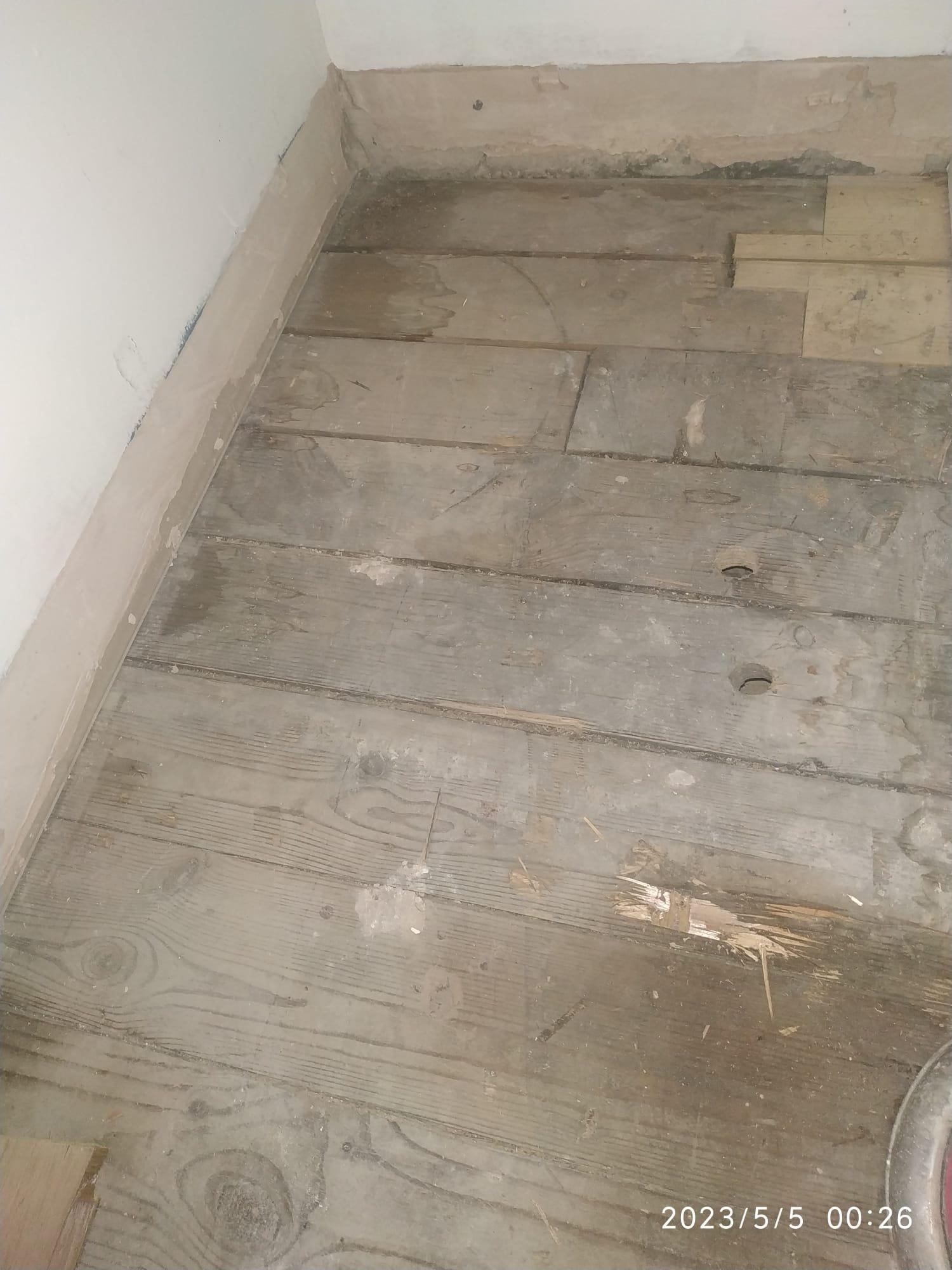

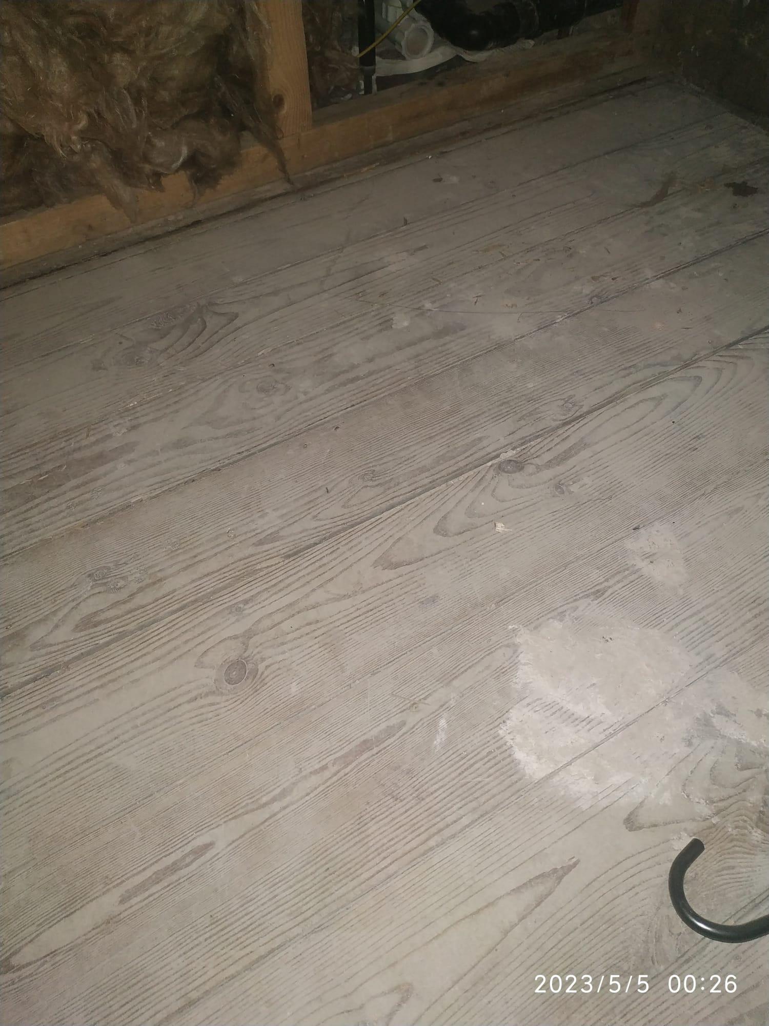

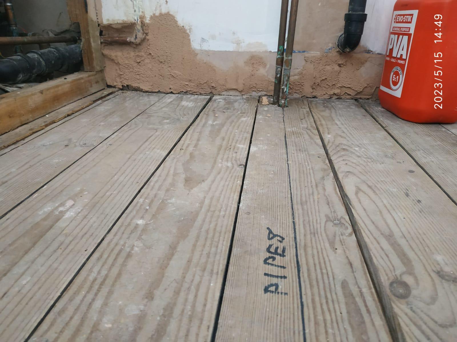

JohnBishop Posted May 4, 2023 Posted May 4, 2023 Hi All, I just ripped these old 5mm wooden boards that were under the vinyl. Currently floor boards are exposed. What would you recommend I should do next? Should I get new 5mm OSB boards and put on top or plaster boards then attach them with some special screws? So: 1. floorboards 2. plasterboard / OSB 3. thinset 4. Schluter DITRA decoupling membrane 5. thinset again 6. Schluter Kerdi membrane in the corners to waterproof 7. thinset and tiles Have I missed anything? Thanks
nod Posted May 4, 2023 Posted May 4, 2023 Osb is no good Use ply or cement board Thin coat is no good for Ditra Ardex 200 is bombproof Better with a PB plank for sound deadening If you use a cement board or insulated tile board No need for Ditra Jus use a flexi adhesive The bed should be the same thickness of the tile your putting down Good to go 😁 1 1

nod Posted May 5, 2023 Posted May 5, 2023 The floor doesn’t look bad at all You could go directly onto that with Ditra Or simply bed a cement or a 10 mil insulated board down 1

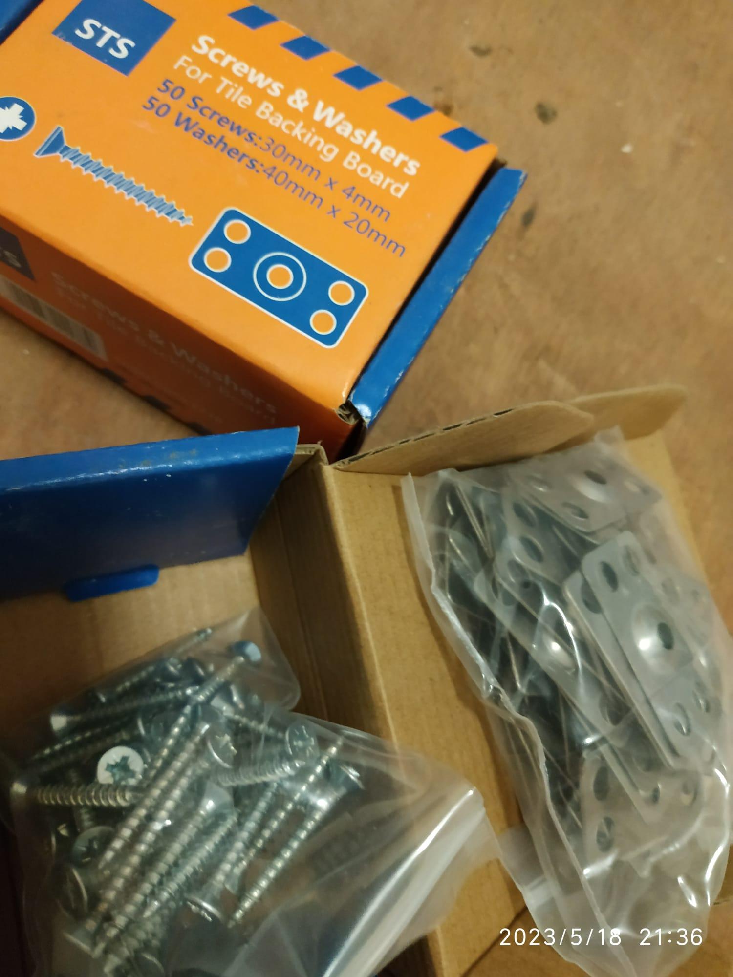

JohnBishop Posted May 6, 2023 Author Posted May 6, 2023 Ok I decided to go for this 12mm STS Tile Backer Boards instead so: 1. floorboards 2. flexi adhesive 3. STS tile backer board + screws and washers 4. flexi adhesive 5. tiles The last two question? 1. these boards are waterproof and the adhesive is also waterproof. Do I have to put anything in between the boards or the adhesive is enough? 2. finally what should I use to waterproof where the floor connects with the walls?

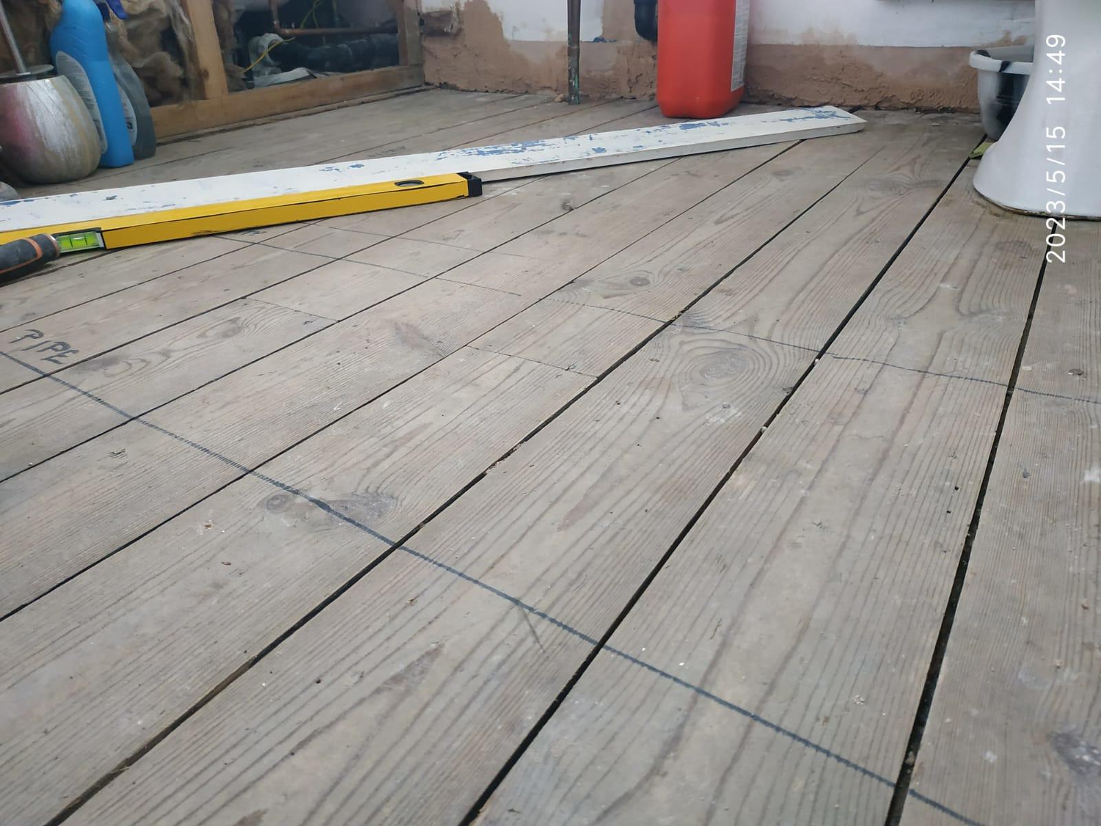

saveasteading Posted May 7, 2023 Posted May 7, 2023 On 05/05/2023 at 20:24, JohnBishop said: STS Tile Backer Board? I used that to bridge over old floor boards before tiling. I stapled it down which is what i would do again. Then tiled. The problem I had was that the floor was bouncy, very old and probably under-designed joists, so the STS, being flexible, did not help in stiffening the floor. I think it all settled down, but a few tiles came loose when i walked on the floor perhaps too soon. (Not my house, now sold, so no latest report available). Of course normally people don't jump on a toilet floor. If your floor is robust then yes I would say STS is fine, and easy to use. plus helps a little in insulation. If bouncy then I would use a cement board which would probably kill the bounce. 1
Nickfromwales Posted May 8, 2023 Posted May 8, 2023 On 07/05/2023 at 19:04, JohnBishop said: Gents, appreciate your responses. Thank you Yes so far I have screwed many boards and hammered all the existing nails. The floor seems solid I continue walking and looking for the last squeak. I have the 12mm insulated boards from Wickes. Can this substitute plywood? Makes sense. I identify the lowest points and mark them with a pencil. Yes, it can substitute, if fully bedded into flexible tile adhesive and screwed at the edges etc, but I would still ply it. Nothing worse than fitting out the entire room to then slowly see cracks in grout and then tiles coming loose. Major works to put that right retrospectively. 1

JohnBishop Posted May 11, 2023 Author Posted May 11, 2023 On 10/05/2023 at 15:35, Nickfromwales said: Easy tiger. How level is the floor? Do you mean how level are the floor boards to each other or level in general. If you mean how level in general then there is a drop of about 8mm across over 2m from the outside wall. Not every floor board is even to each other but I have screwed them so there is no movement or squeaking.
JohnBishop Posted May 13, 2023 Author Posted May 13, 2023 (edited) I would put some ply down but 9mm ply, 12mm STS, 9mm tile and at least two layers of adhesive makes it well over 30mm. Considering laminate floor to the bathroom will be a 20mm step at least. If I go for 60cmX60cm tiles this should be fine. I understand if I go for smaller tiles. Edited May 13, 2023 by JohnBishop

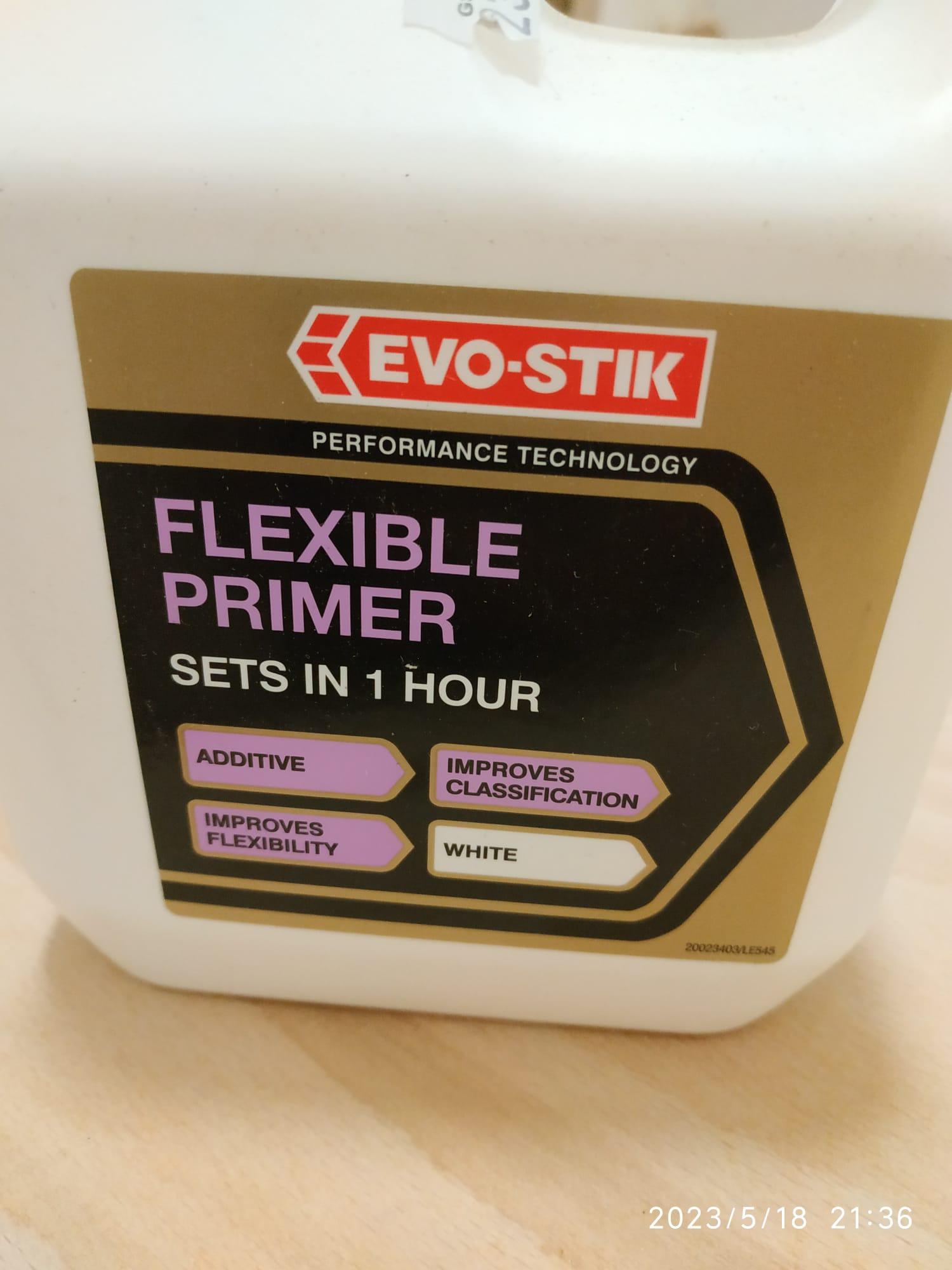

JohnBishop Posted May 15, 2023 Author Posted May 15, 2023 I bought some 5mm ply wood boards. Would this work in combination with STS? If so how can I join all together? 1. floorboards 2. ply + screws 3. flexi adhesive 4. STS tile backer board + screws and washers 5. flexi adhesive 6. tiles I have this EVOSTICK primer. In this scenario should I paint it over the floorboards or the plywood. I think it makes more sense to screw ply and STS together, right?

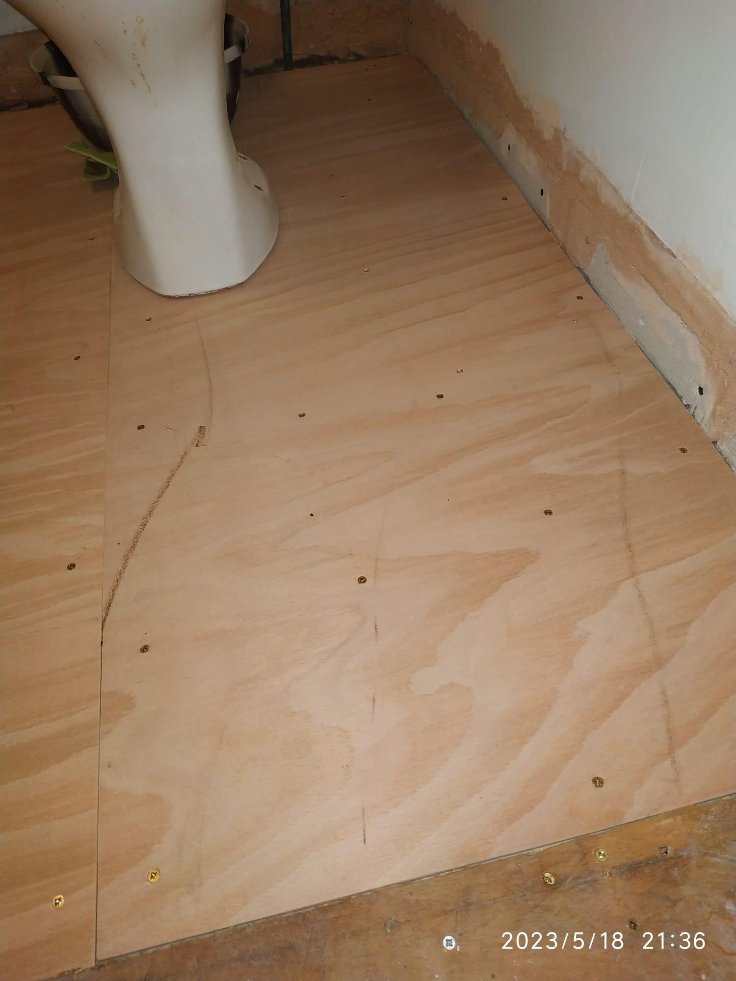

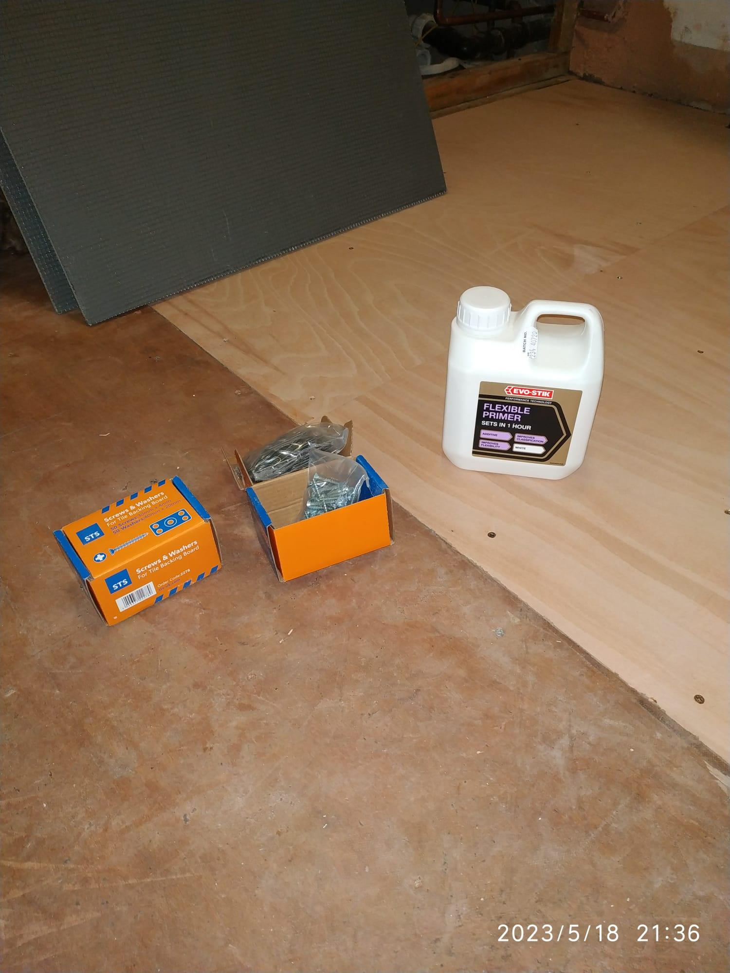

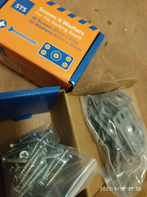

JohnBishop Posted May 18, 2023 Author Posted May 18, 2023 (edited) I have secured the underlying floorboards and decided to put down and screw these 5mm plywood boards. Now I have these items: 1. STS screws and washers 2. STS 10mm insulation boards 3. EVO-STIK 1L Flexibond Tile Adhesive Primer Can anyone tell me what should I do next? Should I paint the Evostik on both sides of the STS and glue the STS boards to ply then screw them in. Then I think I am ready to start tiling. Edited May 18, 2023 by JohnBishop
