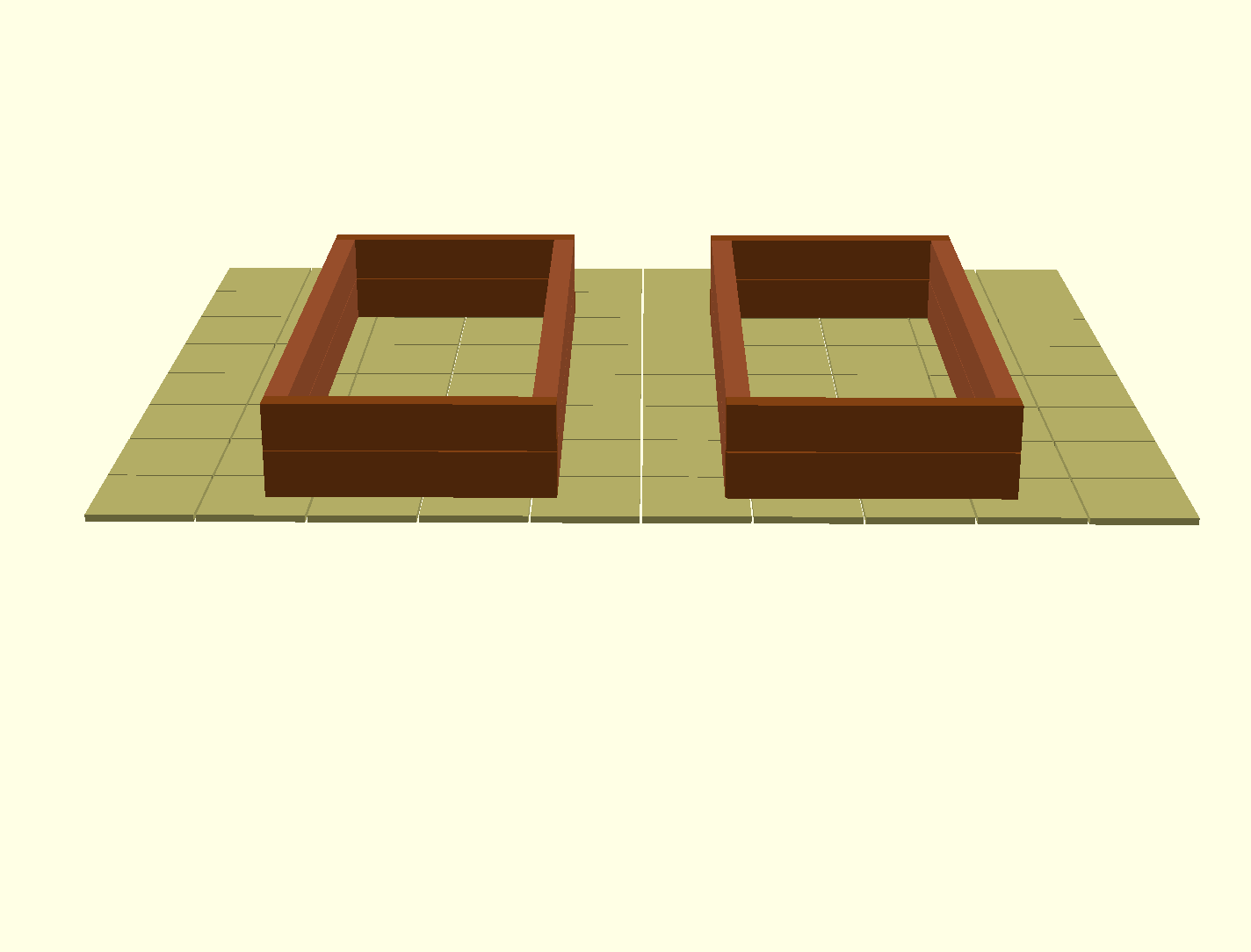

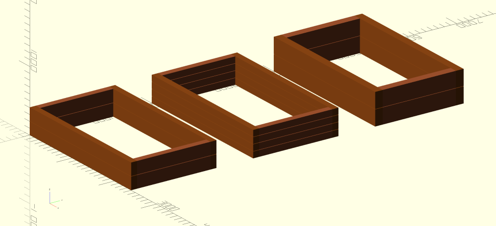

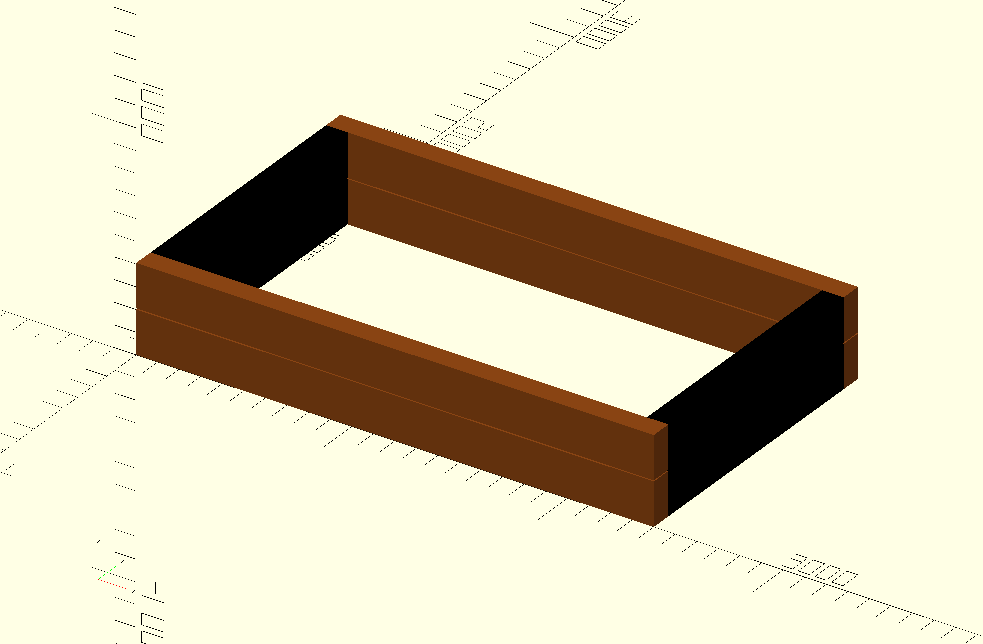

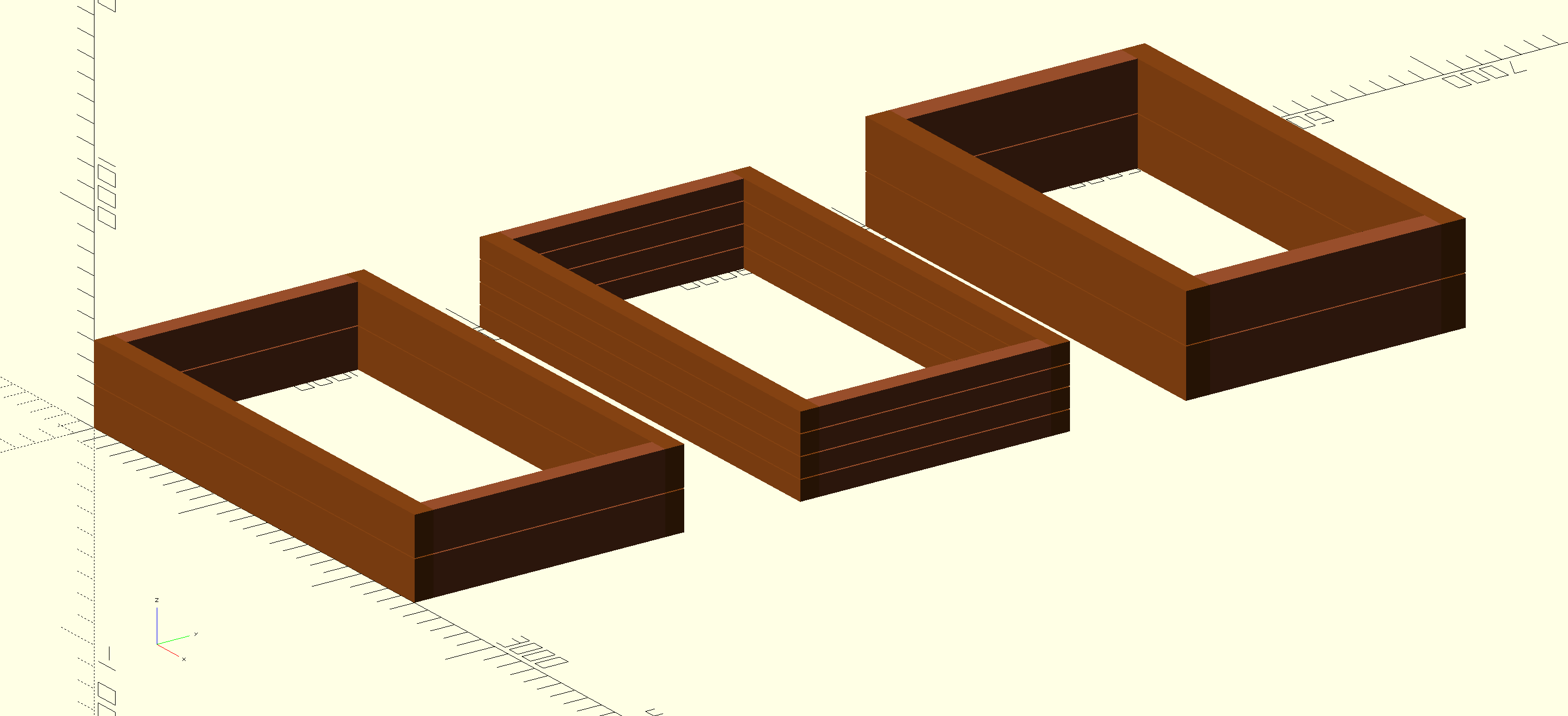

Radian Posted May 4, 2023 Share Posted May 4, 2023 I'm planning to make some raised beds for growing veggies and the current thinking is to make 1.2m x 2.4m frames by cutting one 2.4m x 0.2m x0.1m tanalised 'sleeper' in half to make the ends, with two more sleepers for the sides and stack two frames to create a 0.4m high bed out of six sleepers. The first question on my mind is would the 2.4m sides 'give' too much when filled with soil? I could use chunkier 0.25 x 0.125 sleepers but they're £45 each rather than £30 Seems like such an obvious design, I wondered if anyone else here had already built something similar? Link to comment Share on other sites More sharing options...
Gone West Posted May 4, 2023 Share Posted May 4, 2023 (edited) 3 hours ago, Radian said: Seems like such an obvious design, I wondered if anyone else here had already built something similar? Not yet, but was going to later this year. I was going to use the 100mm thick sleepers and if they did flex tie them together on the inside with a short post half way along. Keep us updated I'll watch with interest. Edited May 4, 2023 by Gone West 1 Link to comment Share on other sites More sharing options...
saveasteading Posted May 4, 2023 Share Posted May 4, 2023 I used 4 x 4 timber packers from steel deliveries. Lapped them and screwed them together downwards and ends, and it is working fine after 4 years. I didn't bother with corner or side pegs. There is negligible load from the soil. If you practice 'no dig' the soil will stabilise permanently too. It becomes a crusty entity, crisscrossed by wormholes and good fungi. I don't fancy cutting the sleepers though, unless of course they are sitting there foc. I fear they might also distort dramatically when cut. Start collecting cardboard (without sticky tape) and newspapers to lay on the ground. They smother the grass and weeds, then rot away. The amount of worms in mine is amazing, due to compost and manure on the top over the winter. 1 1 Link to comment Share on other sites More sharing options...
Radian Posted May 4, 2023 Author Share Posted May 4, 2023 1 hour ago, Gone West said: Not yet, but was going to later this year. I was going to use the 100mm thick sleepers and if they did flex tie them together on the inside with a short post half way along. Keep us updated I'll watch with interest. Just a tip about using a halfway post - if they're just driven into the ground it won't do much. The trick is to tie across from the other side with galvanised steel strap between the posts. This goes under tension and holds the sides in. I'm beginning to conclude that there won't be too much flex without extra retention anyway so probably not needed. 1 hour ago, saveasteading said: I used 4 x 4 timber packers from steel deliveries. Lapped them and screwed them together downwards and ends, and it is working fine after 4 years. Interesting, that's something I hadn't considered - I could use standard 0.1m square fence posts. I like the idea of being able to screw down each layer to the one below. I've modelled that as well as the jumbo sleepers (which I'm ruling out now): Annoyingly, the price of using two 0.1m square posts is generally more than that of a single 0.2m x 0.1m sleeper. I hoped the volume sales of fence posts would help here but evidently not. It's pissing me off that all these timber products are more than twice the price they were the last time I did any hard landscaping🙄 1 Link to comment Share on other sites More sharing options...

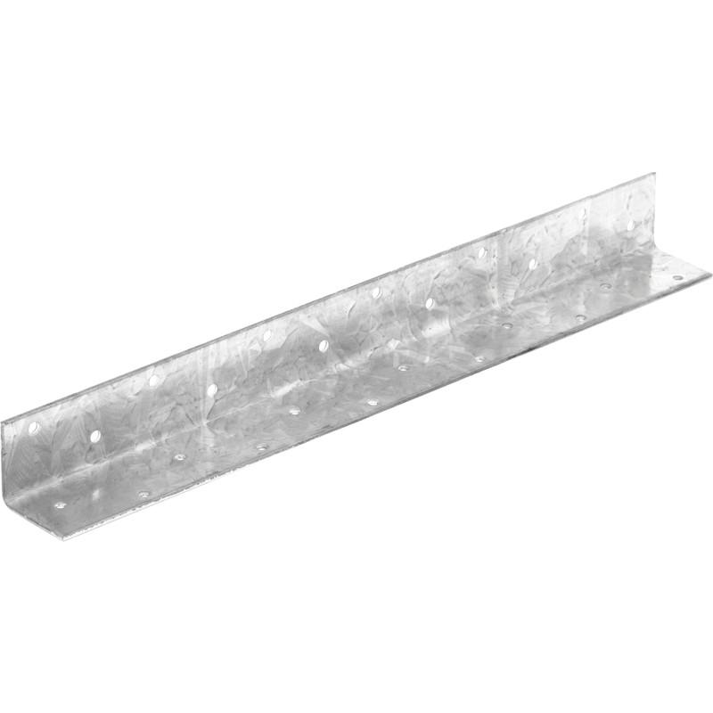

joe90 Posted May 4, 2023 Share Posted May 4, 2023 I recently built a raised bed for my nephew but only one full sized railway sleeper high on its side. Joined the sleepers with angle iron and coach bolts in the corners and straight brackets on the straight join in the middle, worked well. Link to comment Share on other sites More sharing options...
Radian Posted May 4, 2023 Author Share Posted May 4, 2023 2 hours ago, joe90 said: I recently built a raised bed for my nephew but only one full sized railway sleeper high on its side. Joined the sleepers with angle iron and coach bolts in the corners and straight brackets on the straight join in the middle, worked well. Sounds good and chunky. I like the idea of using angle iron. If you can hand-pick railway sleepers to get decent ones you can't really beat them but if at the mercy of what gets delivered then I've seen plenty that I wouldn't want to grow food in! I'm thinking of using these 300mm x 32mm angles on the inside to hold it all together while gunning Waterproof No More Nails onto the mating surfaces. and of course plenty of: Link to comment Share on other sites More sharing options...
Gone West Posted May 5, 2023 Share Posted May 5, 2023 13 hours ago, Radian said: Just a tip about using a halfway post - if they're just driven into the ground it won't do much. The trick is to tie across from the other side with galvanised steel strap between the posts. This goes under tension and holds the sides in. I'm beginning to conclude that there won't be too much flex without extra retention anyway so probably not needed. Originally I was going to use dung boards, because they come in 4.8m and 6.1m lengths, and have several short posts along the lengths to stop flex. Wendy didn't think they were chunky enough so the plans changed to sleepers. The idea was for two 3m long raised beds seperated by a 1m walkway covered by a long arch, so forming a cross shape. The problem is long chunky bits of oak are a lot more expensive than dung boards. Link to comment Share on other sites More sharing options...

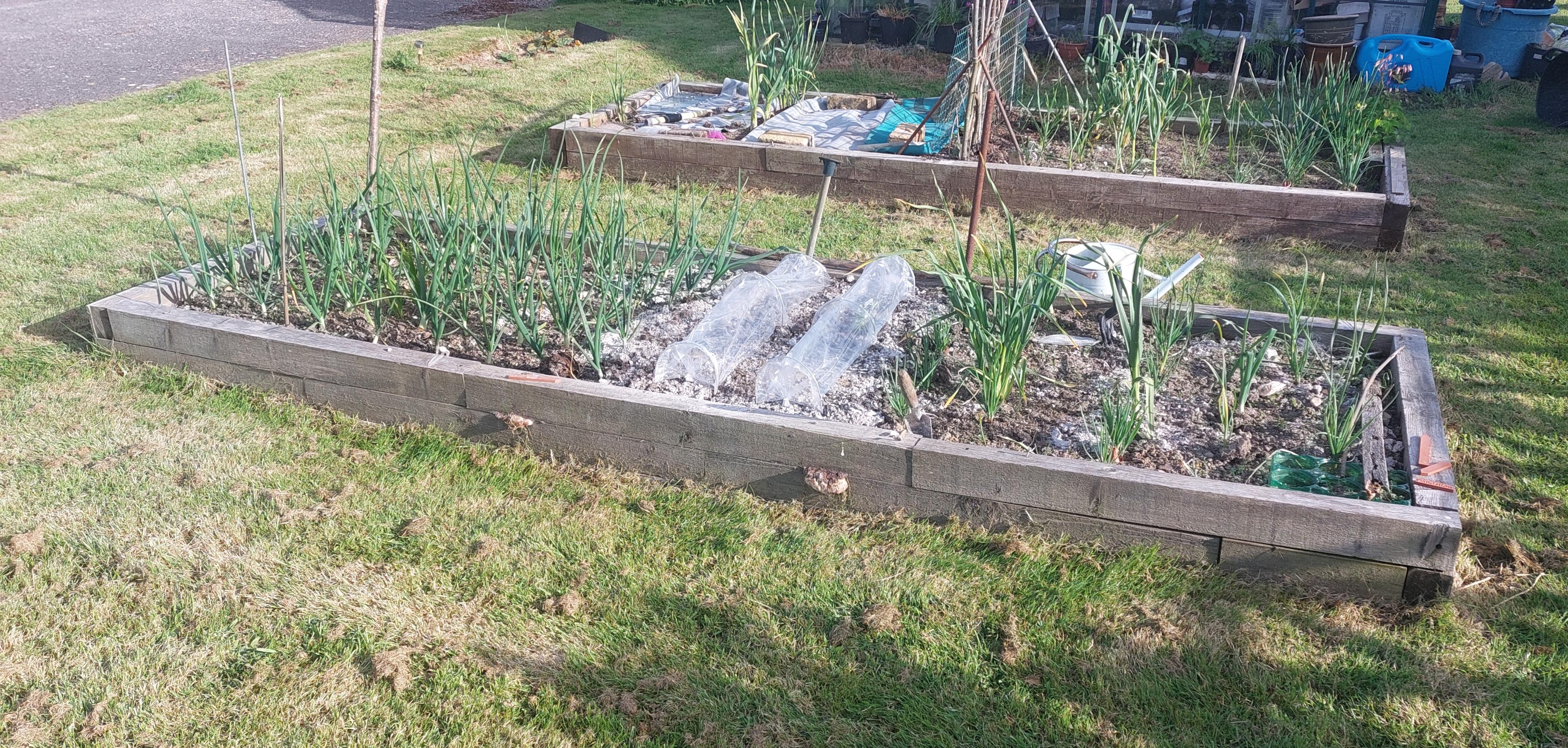

saveasteading Posted May 5, 2023 Share Posted May 5, 2023 Here are mine. 2 Link to comment Share on other sites More sharing options...
Radian Posted May 5, 2023 Author Share Posted May 5, 2023 3 hours ago, saveasteading said: Mine are not, however, handsome features, just doing the job. Look good to me! Not sure where you have them as upper left looks like it might be an asphalt drive? Mine are going at the front of the house in a forgotten corner to the side of the drive. Does everyone just plonk them down directly on the soil or put in gravel or some other barrier to slow the rot? Link to comment Share on other sites More sharing options...
saveasteading Posted May 5, 2023 Share Posted May 5, 2023 Number 1, I just took out the turf and laid them in there. Next time I had learnt not to bother, and I took out the turf only enough to set the timber down beneath it, and put cardboard over the rest. It needed to be set down, to resist the spread of roots. If it wasn't in grass, i don't think it needs recessing at all. Note the VPL as a weed suppressor. Link to comment Share on other sites More sharing options...

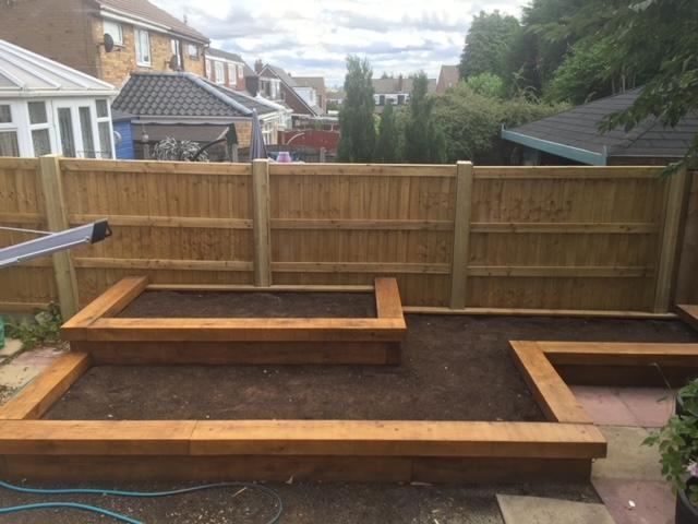

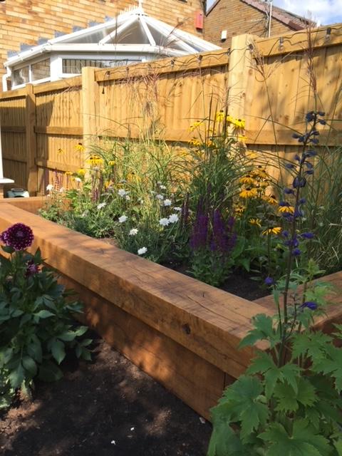

DarrenP Posted May 6, 2023 Share Posted May 6, 2023 I used full width oak sleepers on ours, I bedded the bottom ones on their sides then did the top laid flat like a T I doweled the top to the bottom along with screws from inside upward so they were hidden 5 Link to comment Share on other sites More sharing options...
Radian Posted May 6, 2023 Author Share Posted May 6, 2023 1 hour ago, DarrenP said: I used full width oak sleepers on ours They look great. Did you oil them? I priced-up Oak and the extra expense didn't strike me as being a show-stopper but I noticed that a 2.4m sleeper weighed in at 50Kg and decided against it! Cutting and machining are all much more difficult and I understand that you need to use stainless-steel screws otherwise the resins eat them. Apart from that they look beautiful and last a lot longer. Link to comment Share on other sites More sharing options...
DarrenP Posted May 6, 2023 Share Posted May 6, 2023 1 hour ago, Radian said: They look great. Did you oil them? I priced-up Oak and the extra expense didn't strike me as being a show-stopper but I noticed that a 2.4m sleeper weighed in at 50Kg and decided against it! Cutting and machining are all much more difficult and I understand that you need to use stainless-steel screws otherwise the resins eat them. Apart from that they look beautiful and last a lot longer. Yes I used Osmo UV oil as we are south facing. The oak cost me around £35 I think so wasn't too bad and yes hard work to cut... I used a belt sander on the top as its a good seating area so didn't want any splinters Link to comment Share on other sites More sharing options...

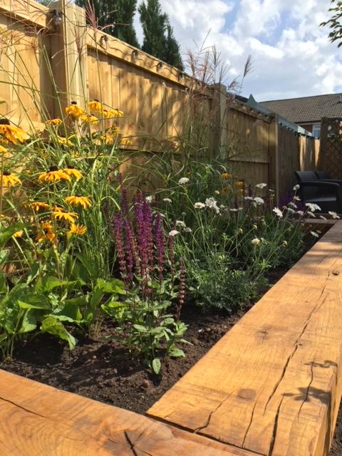

IanR Posted May 7, 2023 Share Posted May 7, 2023 I created a 10m x 4m veg patch with 2 rows of untreated oak sleepers (3m x 200 x 100), side on. Filled with earth that regularly gets rotovated, and no sign of movement after +5 years. 1 Link to comment Share on other sites More sharing options...

IanR Posted May 7, 2023 Share Posted May 7, 2023 7 hours ago, saveasteading said: Now that it is established, I really recommend " no dig". It's not just a gimmick or lazy, it works really well. I'm a traditionalist. My veg plots get turned over twice a year with the winter turn including lots of compost etc. The one in the picture less so, but the other I have started was quite heavy soil and I've still got some way to go get it in good condition. Even then though, I'll still be turning them over every year. Link to comment Share on other sites More sharing options...

Radian Posted May 7, 2023 Author Share Posted May 7, 2023 12 hours ago, IanR said: I created a 10m x 4m veg patch with 2 rows of untreated oak sleepers (3m x 200 x 100), side on. Filled with earth that regularly gets rotovated, and no sign of movement after +5 years. It looks like you bedded the sleepers down onto concrete pads where they connect - did you just dig a pit for the concrete at those points and level-fill to get an even base? Link to comment Share on other sites More sharing options...
IanR Posted May 7, 2023 Share Posted May 7, 2023 Just now, Radian said: It looks like you bedded the sleepers down onto concrete pads where they connect - did you just dig a pit for the concrete at those points and level-fill to get an even base? That Looks deceiving. What you can see is the over-site from the build. There's no concrete under the sleepers. The long edge closest to camera is just sitting on the over-site. The back edge of the veg patch had to be dug in a little to get it level as the garden slopes down a little towards the bottom of the photo. On the lower course of sleepers along the long side I did drill a few Ø10 holes vertically, and then hammered in some Ø8 rebar through the sleepers and into the ground. Link to comment Share on other sites More sharing options...

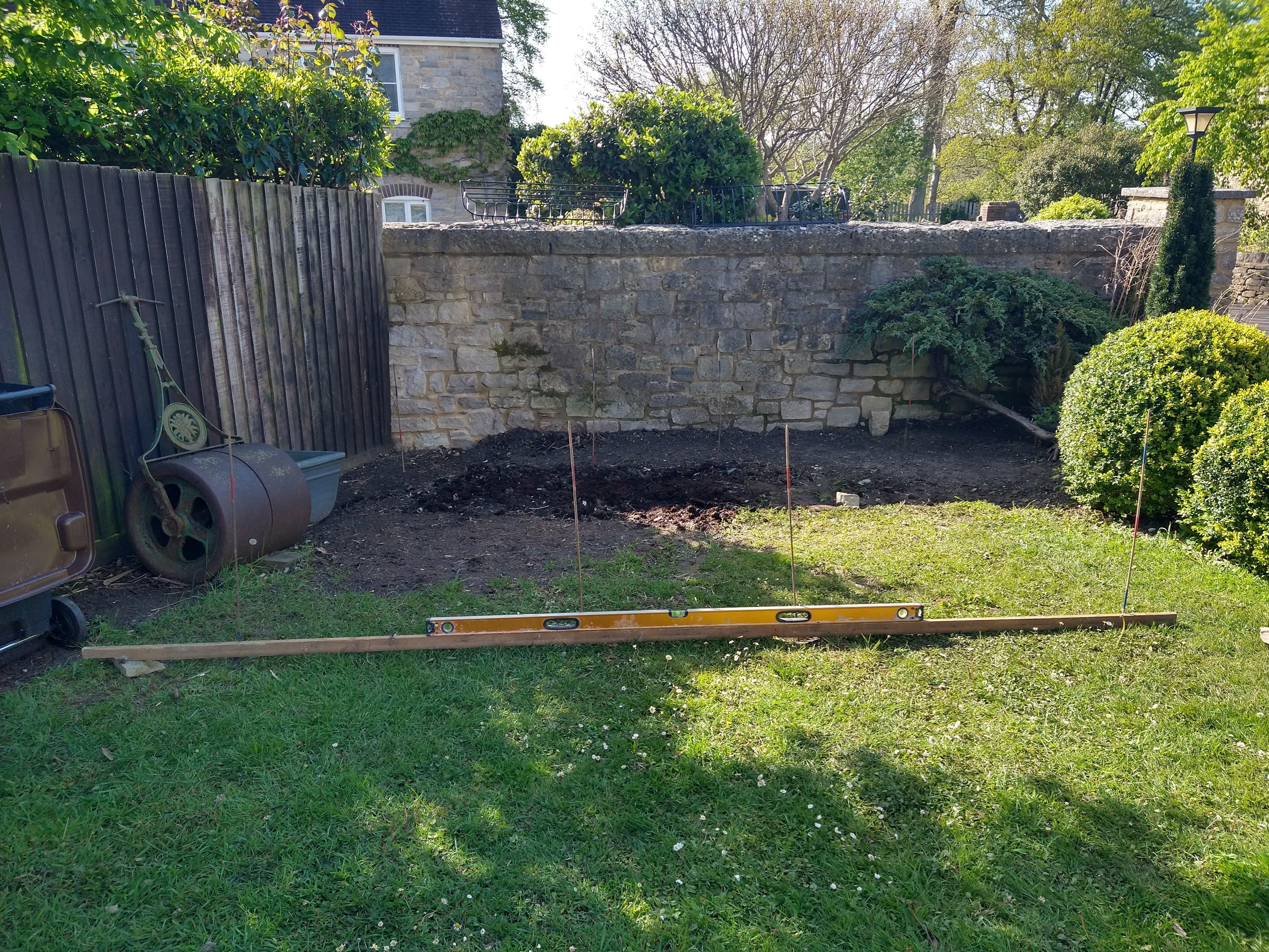

Radian Posted May 8, 2023 Author Share Posted May 8, 2023 12 hours ago, IanR said: There's no concrete under the sleepers Fooled me there 😄 I'm having a bit of a head scratch about what to do next. Here's the site with 8 sticks marking the corner positions of the beds: I was going to spread gravel around the beds but I have around 100 x 450mm concrete slabs lifted from our old patio and stacked behind the garage. They could be laid as a flat area and the sleepers placed on top (with the slabs removed from under the beds): But I don't really want to make it the full-on patio build that I'd normally do (excavate 200mm, whaked-in 150mm MOT type 1, 20mm mortar bed, 30mm slab etc.). I'm wondering if loose-laying on a screeded bed of sharp sand might be sufficient? Drainage would be a bit better overall such that I might get away with laying it without a fall (it would seem wrong to have a fall on the beds anyway). I still need to dig down to undisturbed soil (clay probably) and the whole area slopes down towards the wall and into the corner where the fence meets the stone wall and I can't really build-up with excavated soil in the corner as it will settle in time. That'd mean having a 250mm deep sandpit in places 🙄 Link to comment Share on other sites More sharing options...
