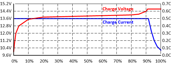

Dan F Posted April 27, 2023 Posted April 27, 2023 On 27/04/2023 at 21:12, SteamyTea said: Charging of batteries, and thermal stores for that matter, is not linear. So it may take 60 or 90A initially, but the power will decay exponentially as the batteries get closer to the maximum charge. Thermal management may help a little, but that will use some of the available power. Expand I don't understand battery chemistry, but based on this graph charge current maintains stable up to 90% SoC, while voltage increases. So, between 10-90% SoC power transfer actually increases slightly over time, doesn't it? Of course, once you get to 90% current drops off, but most people keep their batteries between 10 and 90%.
SteamyTea Posted April 28, 2023 Posted April 28, 2023 (edited) On 27/04/2023 at 23:28, Dan F said: but based on this graph charge current maintains stable up to 90% SoC, while voltage increases Expand That chart is not showing time though. Edited April 28, 2023 by SteamyTea

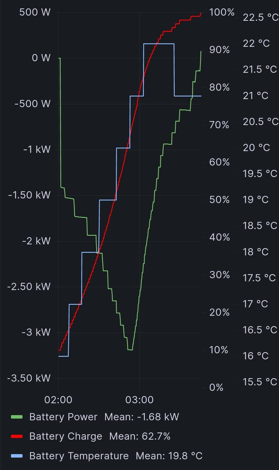

S2D2 Posted April 28, 2023 Posted April 28, 2023 Here's one that does, a small Solax battery rated for 2.5kW charge, the reality is far more complicated:
SteamyTea Posted April 28, 2023 Posted April 28, 2023 On 28/04/2023 at 07:18, S2D2 said: the reality is far more complicated Expand Yes, reality is a killer.

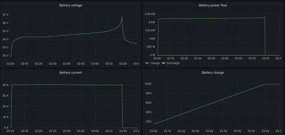

Nick Thomas Posted April 28, 2023 Posted April 28, 2023 Have some graphs of an LiFePO4 battery charging from 15-100%:
SteamyTea Posted April 28, 2023 Posted April 28, 2023 On 28/04/2023 at 07:36, Nick Thomas said: Have some graphs of an LiFePO4 battery charging from 15-100%: Expand Isn't this just showing the effectiveness of the BMS and thermal management? Probably find that the batteries could accept a much higher charge, but then degradation becomes a problem. The main point I was trying (badly) to make is that you probably have to oversize the storage so that it can accept the capacity you need, safely, in the relatively short time you have to charge up. 1
PhilT Posted April 28, 2023 Posted April 28, 2023 On 28/04/2023 at 07:56, SteamyTea said: Isn't this just showing the effectiveness of the BMS and thermal management? Probably find that the batteries could accept a much higher charge, but then degradation becomes a problem. The main point I was trying (badly) to make is that you probably have to oversize the storage so that it can accept the capacity you need, safely, in the relatively short time you have to charge up. Expand Absolutely. The claimed "100% discharge" of the one I use, and its accompanying written guarantee, would be ludicrous if it didn't have massive hidden headroom built in
Dan F Posted April 28, 2023 Posted April 28, 2023 On 28/04/2023 at 07:36, Nick Thomas said: Have some graphs of an LiFePO4 battery charging from 15-100%: Expand This matches my understanding; constant current and marginally increasing power during charge (given an increase in voltage). At least up to 90%.
PhilT Posted April 28, 2023 Posted April 28, 2023 Large commercial storage batteries are very conservatively spec'd. For non critical applications such as radio control hobbies (airplanes etc.) the cell packs have "C" ratings as high as 120, which means they can safely discharge in 30 seconds!
S2D2 Posted April 28, 2023 Posted April 28, 2023 On 28/04/2023 at 07:36, Nick Thomas said: Have some graphs of an LiFePO4 battery charging from 15-100%: Expand Interesting, the Solax is also LifePO4 but far more conservative with the current, which I just sort of assumed was normal. What capacity and temp is your battery for this charge?
