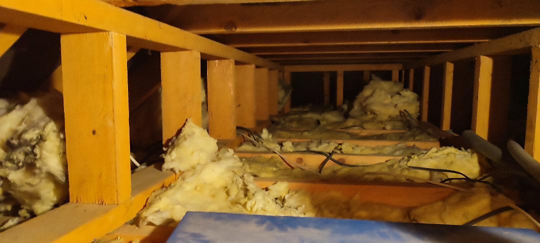

Question Posted April 16, 2023 Share Posted April 16, 2023 (edited) An electrician fitted a fan in an upstairs shower/bath room and there is no grill on the outside wall, and no grill added to the soffits. So I am concerned that the air is being extracted into the attic and could cause mould and perhaps damage the wooden roof structure. The attic has a very small height (39cm height, floor joist to the joist under the flat roof) and from the entrance of the attic in the ceiling below, the fan is about 180cm down horizontally and close to the sloping room on the left. Please see picture. The electrician has gone and been paid, and is certainly not interested. I wouldn't trust him anyway. Grateful for any advice. I don't fancy crawling along the attic to check it. Edited April 16, 2023 by Question Link to comment Share on other sites More sharing options...

JohnMo Posted April 16, 2023 Share Posted April 16, 2023 As @TonyT says, then as you come out of the roof, leave behind another couple hundred mm of insulation. It looks very thin in the photo. Before you start looking have a watch of this video. He could have also installed a rubbish fan as shown on here Link to comment Share on other sites More sharing options...

Redbeard Posted April 16, 2023 Share Posted April 16, 2023 Is the fan in a stud wall or a ceiling? Can you see any ducting in the loft? If not, i suggest isolating the supply (or asking a 'trician to do so) and removing the fan to have a look. It sounds as if you suspect that he's just fitted the unit and left it to fill the void with steam. Is that what you think may have happened? Link to comment Share on other sites More sharing options...

Question Posted April 16, 2023 Author Share Posted April 16, 2023 1 hour ago, Redbeard said: Is the fan in a stud wall or a ceiling? Can you see any ducting in the loft? If not, i suggest isolating the supply (or asking a 'trician to do so) and removing the fan to have a look. It sounds as if you suspect that he's just fitted the unit and left it to fill the void with steam. Is that what you think may have happened? It is a ceiling fan. I can't see any ducting in the loft but it is quite far away. the only way is for me to see is to crawl along the loft. Link to comment Share on other sites More sharing options...

Redbeard Posted April 16, 2023 Share Posted April 16, 2023 Or drop the fan off the ceiling. If it has a duct attached you know it has one (though you do not know where it goes to), and if it doesn't.... If it is the cheap wire-wound plastic duct make sure it does not go up and down (over uneven insulation, for example) or else each dip can become a slime-sump. Link to comment Share on other sites More sharing options...
