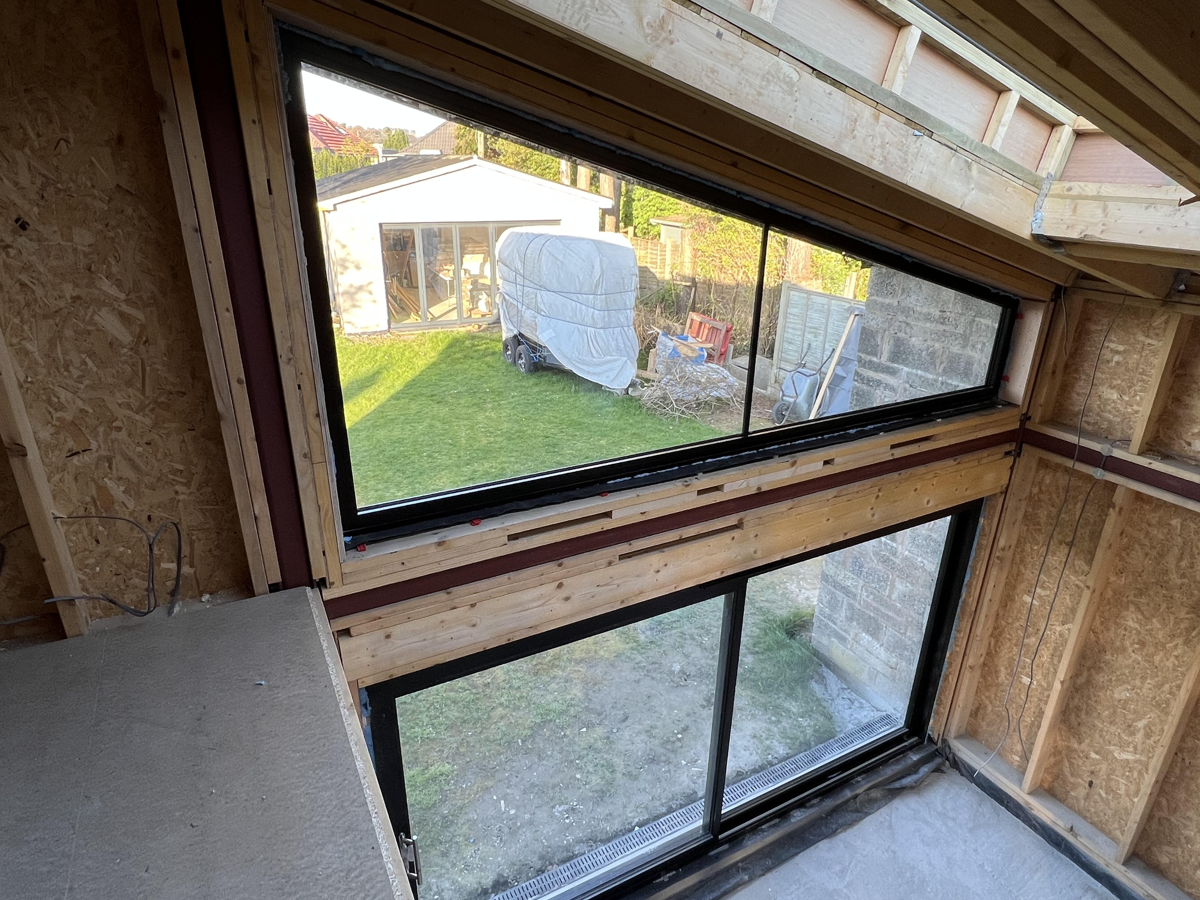

craig Posted April 18, 2023 Share Posted April 18, 2023 41 minutes ago, ggc said: El-cheapo laser gave out the same result as their expensive professional tool (to my surprise too) Tilt & Turn is to be re fitted What did they say regarding measurements and unit sizes? Link to comment Share on other sites More sharing options...

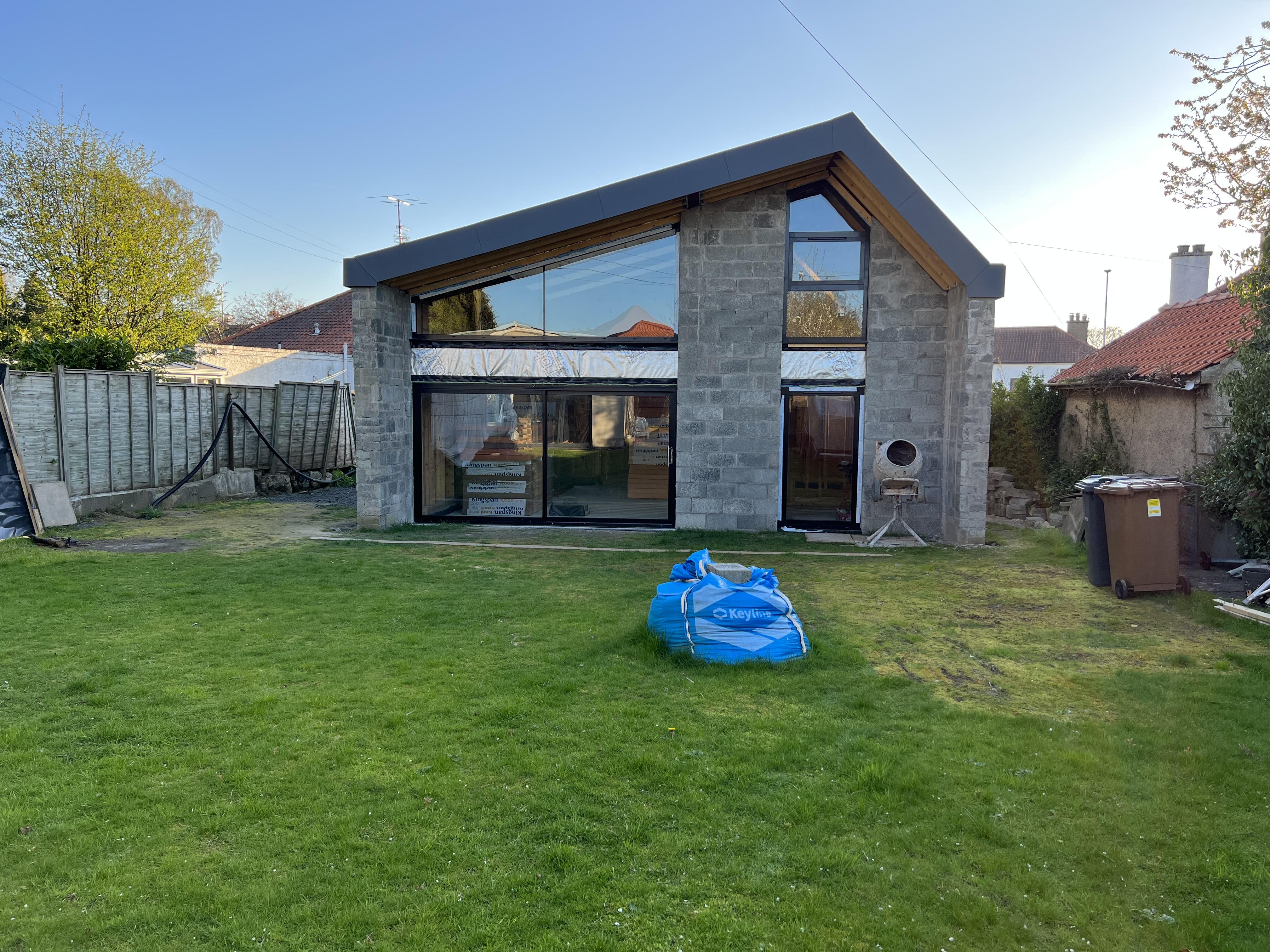

ggc Posted April 20, 2023 Author Share Posted April 20, 2023 On 18/04/2023 at 15:49, craig said: What did they say regarding measurements and unit sizes? So….. The glazing company blame the builders for having the fire stop incorrectly positioned. And stand their ground that everything is good. They have now fitted the angled window above the sliding glass, and had removed the frame to pack with timber ply, to make it a snug fit. The chap we are going to use for the rendering job today said the glazing company have mis measured. Looks like we are sucking it up, but I will piss n moan with the other issue at hand ( an incorrectly ordered door) that is still not resolved and looks like at best is 6 weeks away Link to comment Share on other sites More sharing options...
craig Posted April 20, 2023 Share Posted April 20, 2023 2 minutes ago, ggc said: The glazing company blame the builders for having the fire stop incorrectly positioned. And stand their ground that everything is good. Sh!te, get an independent surveyor. They're Scottish suppliers/installers, they "should" know 90% of everything in Scotland goes in behind the ingo (check reveal). 2 minutes ago, ggc said: They have now fitted the angled window above the sliding glass, and had removed the frame to pack with timber ply, to make it a snug fit. That tells you everything you need to know. 3 minutes ago, ggc said: The chap we are going to use for the rendering job today said the glazing company have mis measured. He is of course correct. 3 minutes ago, ggc said: Looks like we are sucking it up, but I will piss n moan with the other issue at hand ( an incorrectly ordered door) that is still not resolved and looks like at best is 6 weeks away Stand your ground, they're obviously not accepting responsibility or saying we've ****ed up, these are the options available and our preferred solution is x. Is this acceptable? 1 Link to comment Share on other sites More sharing options...
ggc Posted April 20, 2023 Author Share Posted April 20, 2023 32 minutes ago, craig said: Sh!te, get an independent surveyor. They're Scottish suppliers/installers, they "should" know 90% of everything in Scotland goes in behind the ingo (check reveal). That tells you everything you need to know. He is of course correct. Stand your ground, they're obviously not accepting responsibility or saying we've ****ed up, these are the options available and our preferred solution is x. Is this acceptable? Thanks for your opinions Craig. We are so keen to just get the project finished , that further delays and hassles just don’t seem worth the fight. The Renderer, see’s no issues with doing the job to a high standard, and there was none of the “sucking through his teeth “ noises when we had a meeting on site earlier today. We just aren’t the kind of people to creat a fuss , to ultimately end up getting a few grand back. But I suppose that’s kind of foolish on our part, If deep down we aren’t happy with the install! The product, however, is lovely, and we are happy with the actual units. Even though we have had them finally fitted Are we really in a position to keep noising on about the miss-measuring? 🤷🏻♂️ Link to comment Share on other sites More sharing options...

Adsibob Posted April 20, 2023 Share Posted April 20, 2023 (edited) On 13/04/2023 at 14:04, ggc said: Am I being unreasonable asking them to manufacture it again? No. I would reject these. Apart from being unsightly, it's possibly a security risk. With gaps so thick, what's to stop a burglar coming along with a large sharp knife or small saw and cutting through the foam and ripping out the window? Surely they provided technical drawings for sign off before you signed off on the windows. What do those drawings show? If you don't want a fuss, and are happy to accept these to avoid delays and litigation, you could always just accept them, but not pay the final invoice. I don't know how much saving that will be, probably not much more than 5% or 10%, but it will be at least something. You can do this completely lawfully. All you do is at the end, once they've done everything they have to do and demand their final payment, you just send them an email saying that the products supplied were not fit for purposes and they were not of the correct dimensions. This has caused you additional costs in terms of building out the reveals/cavities. You therefore have a claim for damages against them and you are setting off what you owe contractually against what they owe you. The only difficulty with this approach is that they may not issue you with the final paperwork and certificates. You may need that to get your building control approval (or whatever the equivalent is in Scotland). But some of the docs you need like documentation showing the technical specification of the glazing units should be available on the order paperwork you already have, so you might be able to get away with it. Check with your BC inspector what exactly they require. Edited April 20, 2023 by Adsibob 1 Link to comment Share on other sites More sharing options...
ggc Posted April 20, 2023 Author Share Posted April 20, 2023 17 minutes ago, Adsibob said: No. I would reject these. Apart from being unsightly, it's possibly a security risk. With gaps so thick, what's to stop a burglar coming along with a large sharp knife or small saw and cutting through the foam and ripping out the window? Surely they provided technical drawings for sign off before you signed off on the windows. What do those drawings show? If you don't want a fuss, and are happy to accept these to avoid delays and litigation, you could always just accept them, but not pay the final invoice. I don't know how much saving that will be, probably not much more than 5% or 10%, but it will be at least something. You can do this completely lawfully. All you do is at the end, once they've done everything they have to do and demand their final payment, you just send them an email saying that the products supplied were not fit for purposes and they were not of the correct dimensions. This has caused you additional costs in terms of building out the reveals/cavities. You therefore have a claim for damages against them and you are setting off what you owe contractually against what they owe you. The only difficulty with this approach is that they may not issue you with the final paperwork and certificates. You may need that to get your building control approval (or whatever the equivalent is in Scotland). But some of the docs you need like documentation showing the technical specification of the glazing units should be available on the order paperwork you already have, so you might be able to get away with it. Check with your BC inspector what exactly they require. No technical drawings ever supplied to us by the installers. We didn’t know this was a ‘thing’ that we would have either have been supplied with to check, or should have asked for Payment for these was made in full before fitting 10% of invoice price to get them to come and measure up after the price was agreed. 50% of outstanding balance paid to place the order Final 50% of outstanding balance paid 10 days before install, so they have our money! Maybe a saving grace that it was all paid on a C/Card? Im embarrassed to say there will be a lot of naivety on our part as this is our first dip in the self build swimming pool. I know we will learn by our mistakes, and learn what questions to ask and what documentation to ask for - shame it costs money to make these mistakes Link to comment Share on other sites More sharing options...
Adsibob Posted April 20, 2023 Share Posted April 20, 2023 (edited) 6 minutes ago, ggc said: No technical drawings ever supplied to us by the installers. That's a big red flag I'm afraid. 6 minutes ago, ggc said: Maybe a saving grace that it was all paid on a C/Card? You lucky lucky thing. DEFINITELY RAISE THIS WITH YOUR CREDIT CARD COMPANY. You are entitled to compensation under section 75 of the Consumer Credit Act. Credit card company is jointly and severally liable for the window supplier's breach of contract. Here, the windows do not comply with all the terms in the contract which are implied by the consumer legistation, e.g. fitness for purpose, of reasonable quality, etc. Edited April 20, 2023 by Adsibob 1 Link to comment Share on other sites More sharing options...
ggc Posted April 20, 2023 Author Share Posted April 20, 2023 3 minutes ago, Adsibob said: That's a big red flag I'm afraid. You lucky lucky thing. DEFINITELY RAISE THIS WITH YOUR CREDIT CARD COMPANY. You are entitled to compensation under section 75 of the Consumer Credit Act. Credit card company is jointly and severally liable for the window supplier's breach of contract. Here, the windows do not comply with all the terms in the contract which are implied by the consumer legistation, e.g. fitness for purpose, of reasonable quality, etc. I think I love you for giving me a glimmer of hope of getting this mess sorted out Link to comment Share on other sites More sharing options...

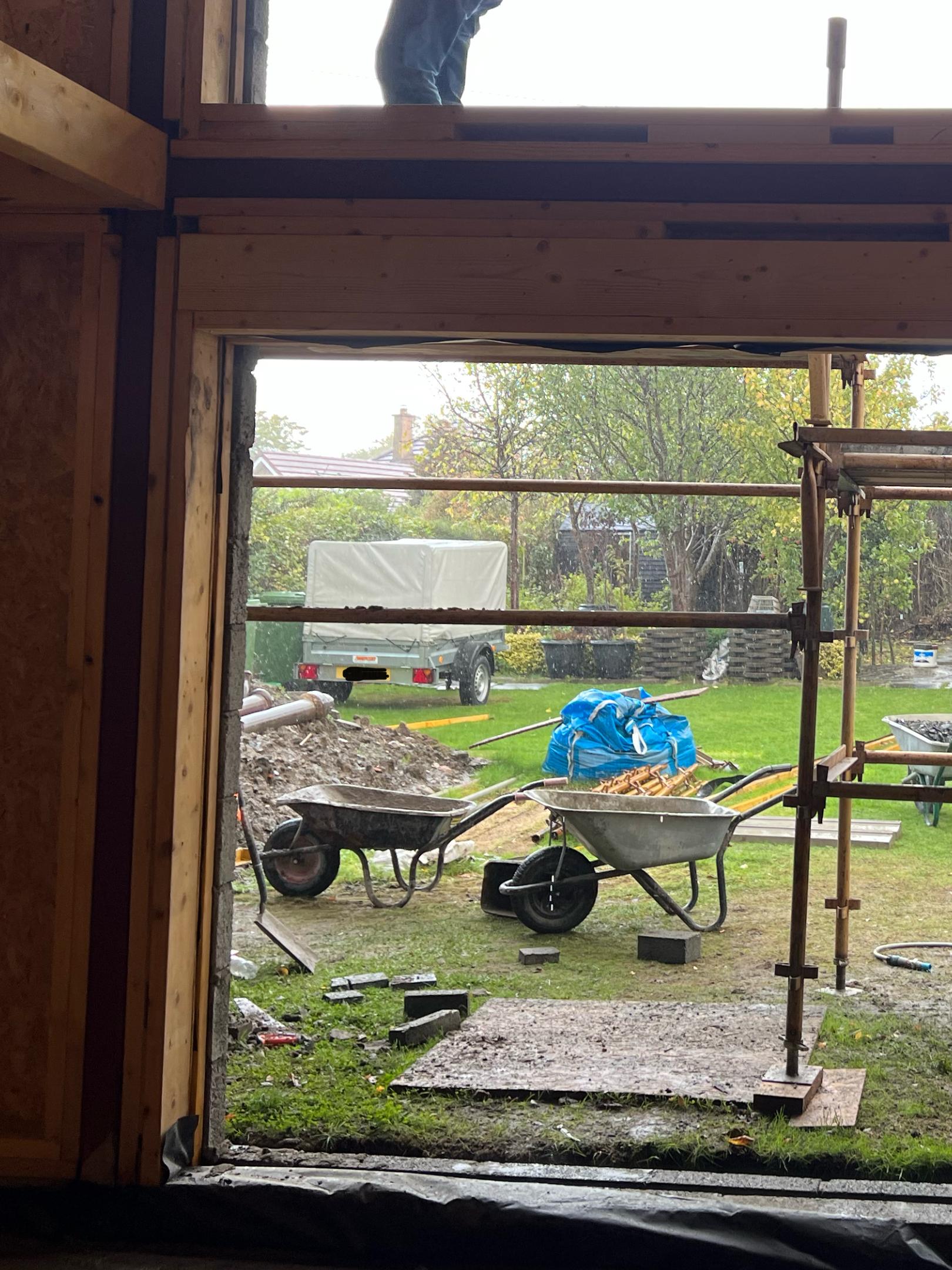

ggc Posted April 20, 2023 Author Share Posted April 20, 2023 Thanks @Kelvin We aren’t finished with them by a long mile….. Our Crittall door turned up to be fitted, and it has been ordered opening outwards, not inwards like we had verbally requested to the sales chap. He fudged the order confirmation, and we never noticed! It just gets better doesn’t it 🤦🏻♂️ Link to comment Share on other sites More sharing options...
Lofty718 Posted April 20, 2023 Share Posted April 20, 2023 @ggc I don't think you should accept this level of incompetence You're building a mega project and relying on these people to get it right. It's quite a big deal and not a small bodge that you can let slide I'd be pushing to get it all re done and spot on as you'd expect it to be. Rather difficult I know, because I imagine you want to be moving into the house asap and this could cause huge delays Link to comment Share on other sites More sharing options...
Adsibob Posted April 20, 2023 Share Posted April 20, 2023 8 hours ago, ggc said: Thanks @Kelvin We aren’t finished with them by a long mile….. Our Crittall door turned up to be fitted, and it has been ordered opening outwards, not inwards like we had verbally requested to the sales chap. He fudged the order confirmation, and we never noticed! It just gets better doesn’t it 🤦🏻♂️ I still can’t believe a company (and you, if I’m honest) didn’t insist on drawings being signed off before manufacture. It’s really basic stuff. Sorry, don’t mean to sound critical, I just can’t believe it. Link to comment Share on other sites More sharing options...
ggc Posted April 20, 2023 Author Share Posted April 20, 2023 Folks, Please correct me if I am wrong, but should the actual window frame be attached to the fire stop? As you can see in this photo it is nicely tucked in behind the blockwork creating the check reveal? The builders left this at least 10mm Im preparing to compose an email to be sent to the glazing company, and want to have my terminologies correct. Pic shows the inside of where the sliding door now resides This is the same on every window, a minimum 10mm check reveal cheers Link to comment Share on other sites More sharing options...
saveasteading Posted April 20, 2023 Share Posted April 20, 2023 Can i suggest that it isn't as simple (one way or the other,) as some are suggesting here? The client, as most, is doing this for the first and probably only time, so doesn't necessarily know the pitfalls, or that drawings can be proposed and approved. Asking an amateur client to approve technical drawings can be seen as offloading responsibility, so isn't standard. Mistakes happen. I think i might have measured to block instead of timber too. When projects are subdivided into multiple responsibilities it saves the client a huge amount of money but they take on risk. This is an interface that was liable to go wrong. As I see it: If (and only if) the window company can fit it so that it isn't substandard then there isn't much of a claim. Maximum claim would be the cost of remedial and adaptions not by the window co. Plus you could argue for 0.5m2 ,or whatever, less window area. If you went legal on this, that is all you would get. Similarly verbal agreements, which 'aren't worth the paper they are printed on'. Sorry. Building is very difficult and there are risks. 1 1 Link to comment Share on other sites More sharing options...
eandg Posted April 20, 2023 Share Posted April 20, 2023 8 hours ago, ggc said: Thanks @Kelvin We aren’t finished with them by a long mile….. Our Crittall door turned up to be fitted, and it has been ordered opening outwards, not inwards like we had verbally requested to the sales chap. He fudged the order confirmation, and we never noticed! It just gets better doesn’t it 🤦🏻♂️ Not meaning to sound unsympathetic but your contract is struck based on you accepting their written offer when you sign on the dotted line/part with your cash. We've had a couple of relatively minor, similar, issues with suppliers and they've all been caused by wee oversights on my part where I've not fully checked the small print and that's really on me - unless there's something significant which breaches the supplier's duty of reasonable care/professional competency then I don't see you having much of a leg to stand on if you've not got approved drawings/a schedule setting out a list of agreed sizes. 1 Link to comment Share on other sites More sharing options...
