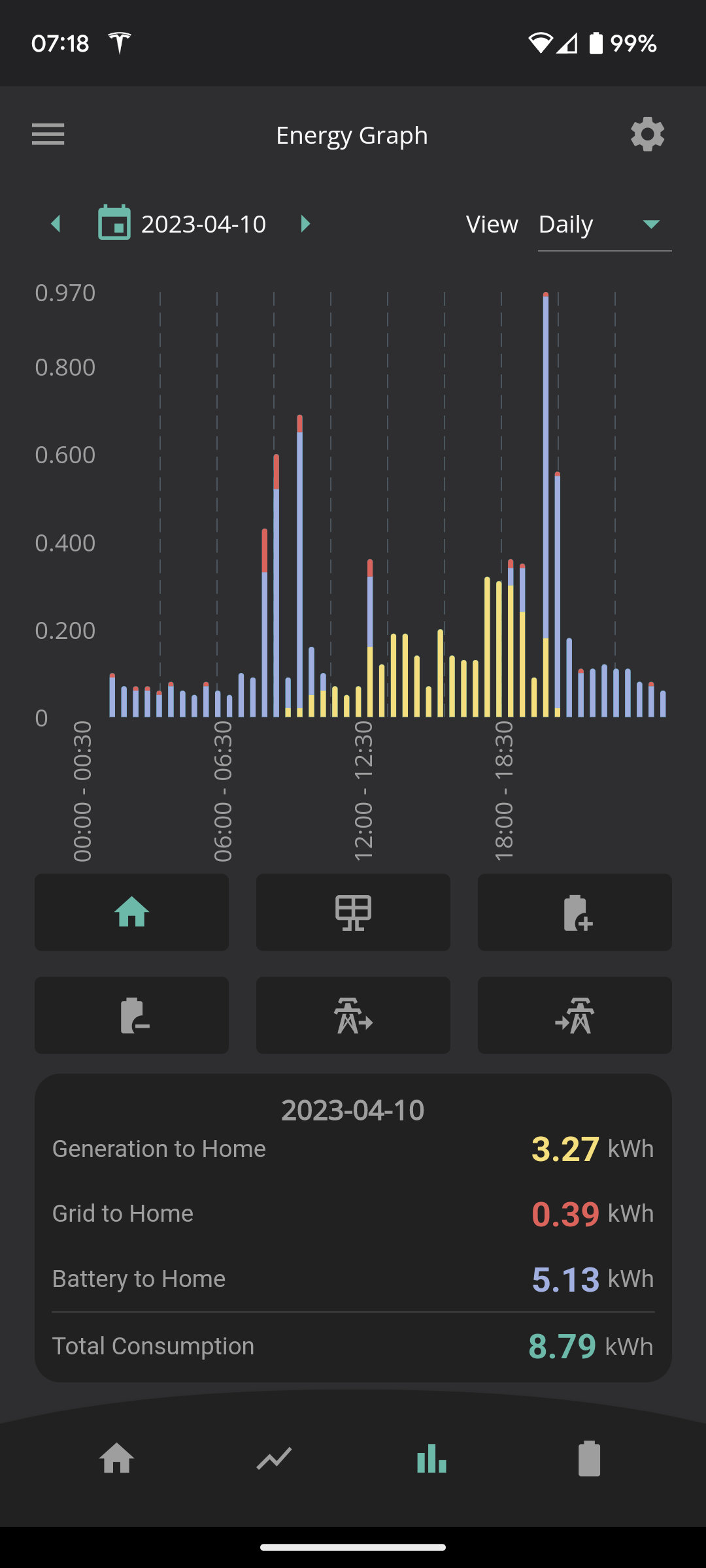

Simon R Posted April 14, 2023 Posted April 14, 2023 I'm for option 1 and spend the difference on battery storage. Our place is ICF and we use a small combi gas boiler for hot water, no HW storage. We don't have UFH either, and rely on a 3.5kW A2A unit in the open plan living area to provide heating and cooling as required. Using an A2A split unit was a lot simpler and cheaper than going for an ASHP and UFH. Even at this time of year we are getting enough power to run the house with very minimal import, 0.39Kw yesterday and 7.7kW export. Our battery is 9.5kWh. I've got and EV but only charge it from the Octopus Intelligent tariff overnight, trying to charge it from the solar during the day was more complex than initially envisaged. Hopefully I'll get it sorted soon so I'm no longer exporting.
