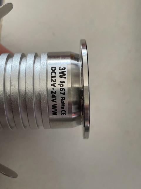

Thorfun Posted April 12, 2023 Posted April 12, 2023 in doing some research I bought one of these from AliExpress https://www.aliexpress.com/item/1005002156645871.html?spm=a2g0o.order_list.order_list_main.10.21ef18028Q8IPM (3W version) and one of these from Amazon to drive it https://www.amazon.co.uk/dp/B08QZ366KG?ref=ppx_yo2ov_dt_b_product_details&th=1 (12W version). when I put it together the light is pulsing in a slightly irregular pattern. I've checked with a voltmeter and it's rock steady 240V at the input to the driver but the output is pulsing from 0V DC to 24VDC (ish). the driver manual says 'Min. Load recommended) 7.2W. if I disconnect the light from the driver the voltage is still pulsing. have I simply bought the wrong driver? am I not loading the driver enough? or is the driver or the light faulty?
Temp Posted April 12, 2023 Posted April 12, 2023 14 minutes ago, Thorfun said: am I not loading the driver enough? That would be my guess. Sometimes a power supply can go unstable if its too lightly loaded. If it says minimum 7.2W and you only have 3W that might account for it. Got any 12 V car bulbs? Perhaps put two 10W bulbs in series to see if loading it up stops it flashing. Only having a working range from 7.2W to 12W is pretty poor. I happen to have the 24V 60W version of this one going spare. Its new and untested. No instructions but you can have it if it helps. It says "no minimum load" in the info. https://www.amazon.co.uk/dp/B0BRQ6Y9VZ?psc=1&ref=ppx_yo2ov_dt_b_product_details If interested PM me an address and I'll stick it in the post.
Thorfun Posted April 12, 2023 Author Posted April 12, 2023 47 minutes ago, Temp said: That would be my guess. Sometimes a power supply can go unstable if its too lightly loaded. If it says minimum 7.2W and you only have 3W that might account for it. Got any 12 V car bulbs? Perhaps put two 10W bulbs in series to see if loading it up stops it flashing. Only having a working range from 7.2W to 12W is pretty poor. I happen to have the 24V 60W version of this one going spare. Its new and untested. No instructions but you can have it if it helps. It says "no minimum load" in the info. https://www.amazon.co.uk/dp/B0BRQ6Y9VZ?psc=1&ref=ppx_yo2ov_dt_b_product_details If interested PM me an address and I'll stick it in the post. Thanks. It’s what I thought it might be. I’ll try and add extra load and see what happens. thanks for the offer of the other driver but I just wanted something to test Chinese lights with before I purchase a load. They will all eventually be driven by a driver in my Loxone cabinet.
Thorfun Posted April 13, 2023 Author Posted April 13, 2023 anyone know how I find out if a light is constant current or constant voltage? I don't see anything on the AliExpress website. I ask as I see drivers state 'not suitable for constant current fittings' so how do I know!
Carrerahill Posted April 13, 2023 Posted April 13, 2023 (edited) 17 hours ago, Thorfun said: in doing some research I bought one of these from AliExpress https://www.aliexpress.com/item/1005002156645871.html?spm=a2g0o.order_list.order_list_main.10.21ef18028Q8IPM (3W version) and one of these from Amazon to drive it https://www.amazon.co.uk/dp/B08QZ366KG?ref=ppx_yo2ov_dt_b_product_details&th=1 (12W version). when I put it together the light is pulsing in a slightly irregular pattern. I've checked with a voltmeter and it's rock steady 240V at the input to the driver but the output is pulsing from 0V DC to 24VDC (ish). the driver manual says 'Min. Load recommended) 7.2W. if I disconnect the light from the driver the voltage is still pulsing. have I simply bought the wrong driver? am I not loading the driver enough? or is the driver or the light faulty? Driver will be seeing that as open circuit and is pulsing the output "looking" for the load. Because of how drivers work, they need to work out what the drive voltage will be, so on startup they sort of ramp up until they detect the forward voltage of the LED (the point it starts to emit light) then they can drive it up will they get the rated current of the driver. Looking at those, I think those LED lights are just 12V because if they were say 100mA they would usually list the current not the voltage, 12V is also quite specific and few LED's will be a nice round, industry standard voltage like that. Edited April 13, 2023 by Carrerahill
Thorfun Posted April 13, 2023 Author Posted April 13, 2023 1 minute ago, Carrerahill said: Driver will be seeing that as open circuit and is pulsing the output "looking" for the load. Because of how drivers work, they need to work out what the drive voltage will be, so on startup they sort of ramp up until they detect the forward voltage of the LED (the point it starts to emit light) then they can drive it up will they get the rated current of the driver. are you saying that if I leave it for a while it'll stop pulsing?
Thorfun Posted April 13, 2023 Author Posted April 13, 2023 7 minutes ago, Thorfun said: anyone know how I find out if a light is constant current or constant voltage? I don't see anything on the AliExpress website. I ask as I see drivers state 'not suitable for constant current fittings' so how do I know! found a driver on Amazon that says: The led driver is a constant voltage power supply and is Incompatible for lighting products with adjustable luminosity and chromaticity, otherwise it is prone to burning. For example, dimmable LED lights and color-changing light bars. so does this mean that as my light fitting is dimmable I shouldn't be using a constant voltage driver?
Carrerahill Posted April 13, 2023 Posted April 13, 2023 Just now, Thorfun said: are you saying that if I leave it for a while it'll stop pulsing? No, they are incompatible, the driver behaves like that as it is ascertaining the characteristics of the LED, the fact it keeps going says they are not compatible.
Thorfun Posted April 13, 2023 Author Posted April 13, 2023 Just now, Carrerahill said: No, they are incompatible, the driver behaves like that as it is ascertaining the characteristics of the LED, the fact it keeps going says they are not compatible. ok. so is this the constant current/constant voltage question I'm also trying to figure out?
Carrerahill Posted April 13, 2023 Posted April 13, 2023 Having looked at the spec on AliExpress is says the input voltage is 12-24VDC - get a DC supply in that region capable of the wattage you need (add them all up for total wattage) and it will work.
Thorfun Posted April 13, 2023 Author Posted April 13, 2023 Just now, Carrerahill said: Having looked at the spec on AliExpress is says the input voltage is 12-24VDC - get a DC supply in that region capable of the wattage you need (add them all up for total wattage) and it will work. I'm so confused. I thought I HAD bought a 12-24VDC driver! 🫠
Carrerahill Posted April 13, 2023 Posted April 13, 2023 1 minute ago, Thorfun said: ok. so is this the constant current/constant voltage question I'm also trying to figure out? Their is nothing to suggest they are CC. If they were a current would be listed somewhere. 12-24DC. Hook one up to your car cigarette lighter or any other 12-24DC power supply you have and it will work.
Carrerahill Posted April 13, 2023 Posted April 13, 2023 Just now, Thorfun said: I'm so confused. I thought I HAD bought a 12-24VDC driver! 🫠 Maybe you have, but did you not say there was a minimum load?
Thorfun Posted April 13, 2023 Author Posted April 13, 2023 1 minute ago, Carrerahill said: Maybe you have, but did you not say there was a minimum load? ahh...yes. it did have a minimum load. sorry. so confused like I said. I'll just purchase another 12-24VDC driver that doesn't have a minimum load and see how I get on! might just purchase this instead though: https://www.amazon.co.uk/110-240V-Massager-Essential-Diffusers-5-5x2-1mm/dp/B09YQYJ4B8/ref=sr_1_6?keywords=24v+power+supply+led&qid=1681386910&sprefix=24v+p%2Caps%2C90&sr=8-6 I presume that'll do the job to test single lights?
Carrerahill Posted April 13, 2023 Posted April 13, 2023 Right, I have just looked at the transformer you bought, it is a half amp 24VDC power supply. How many of the little LED lights do you have? Are you overloading it? They state they are 1W/3W - LED's are funny, I would say at 24V they will be 3W as they are pulling more current as the forward voltage goes up, so do you have too many on it and thus are overloading it?

Radian Posted April 13, 2023 Posted April 13, 2023 5 hours ago, Thorfun said: so does this mean that as my light fitting is dimmable I shouldn't be using a constant voltage driver? I couldn't see where it says it's 'dimmable'? The 12V-24V spec means it has a buck regulator inside that maintains a constant LED current over the 12-24 volt range. Dimming can only be done with a PWM drive signal but that's not necessarily going to be nice to the buck regulator. Generally these are non-dimmable. 1
Temp Posted April 13, 2023 Posted April 13, 2023 The data for the LED on Aliexpress is confusing. It could be 12V DC, 12V AC or 12-24V DC. However one of the photos is a diagram showing how multiple LED are connected. This shows a 12V DC transformer. It also shows the LED wired in parallel. So I think it's most likely to require a 12V DC voltage (possibly 24V DC) and very unlikely to be a constant current type. With a constant current type LED you would either use one driver per LED or possibly wire multiple LED in series not parallel. 1
