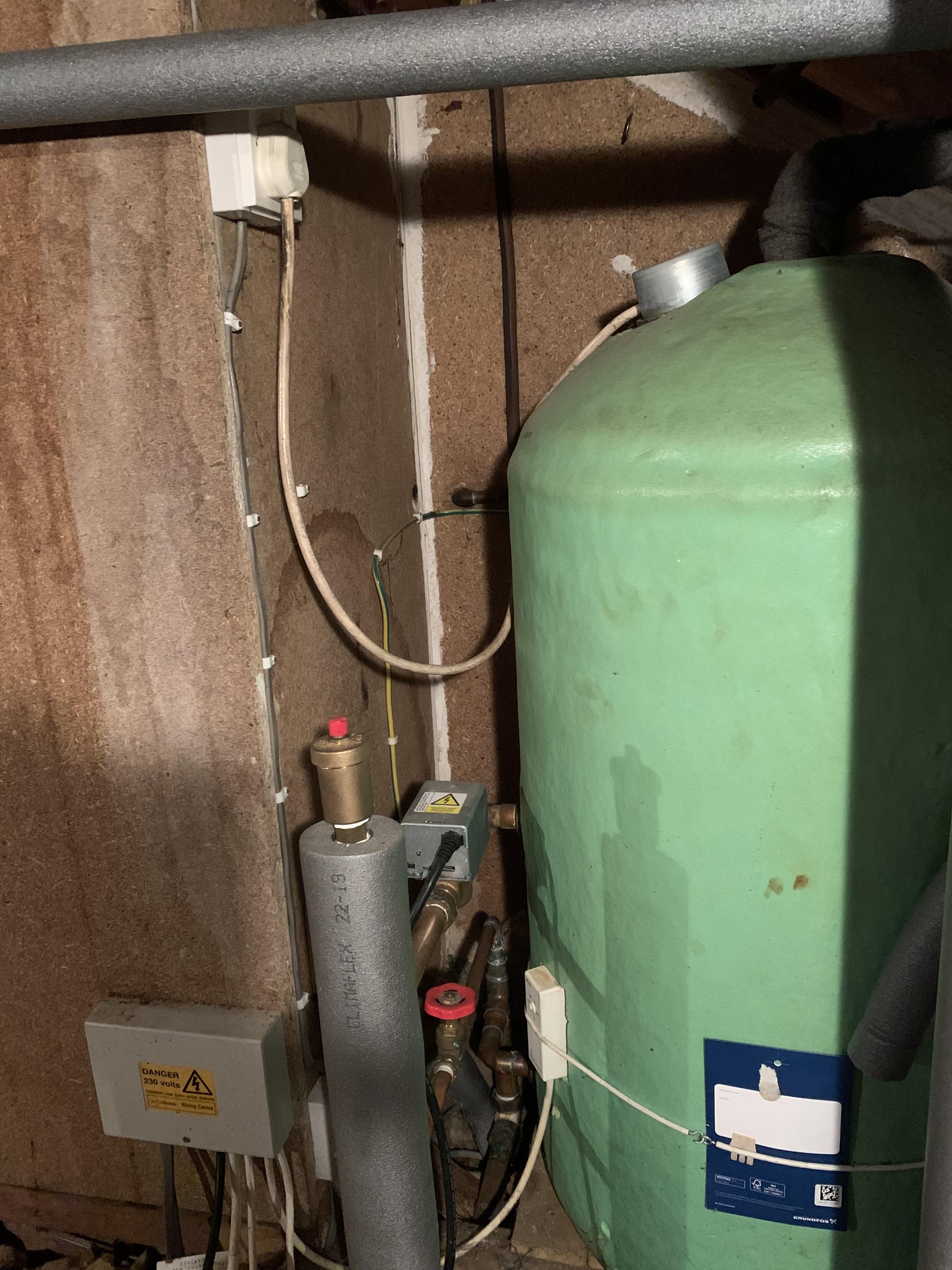

James94 Posted April 12, 2023 Author Share Posted April 12, 2023 (edited) There are a few spurs but none that isolate that I can see. The one round the corner looks like it goes up to a plug that’s connected to the immersion heater which is turned off. Edited April 12, 2023 by James94 Link to comment Share on other sites More sharing options...
ProDave Posted April 12, 2023 Share Posted April 12, 2023 I suggest the next step is get an electrician (one who understands heating systems, check that point first) to come and check the system over. He will find the isolator or if none fitted will fit one and check it all out and advise what is needed. Link to comment Share on other sites More sharing options...

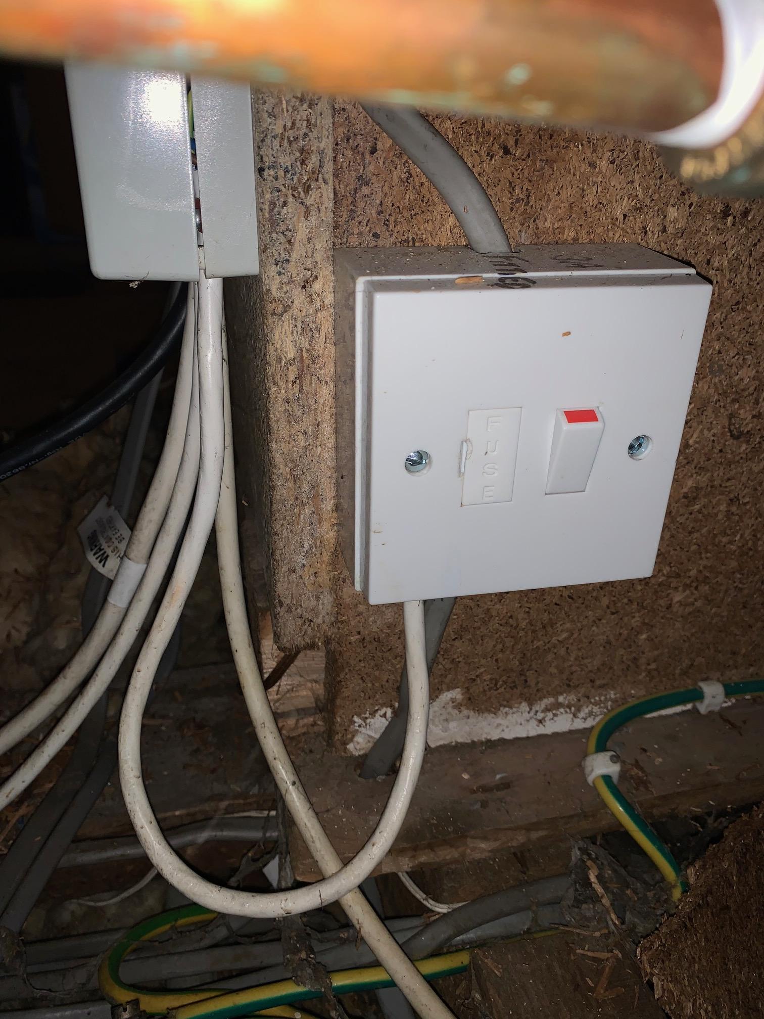

TonyT Posted April 12, 2023 Share Posted April 12, 2023 1 hour ago, James94 said: There are a few spurs but none that isolate that I can see. The one round the corner looks like it goes up to a plug that’s connected to the immersion heater which is turned off. behind the grey lagging at the same height as the wiring centre Link to comment Share on other sites More sharing options...
James94 Posted April 12, 2023 Author Share Posted April 12, 2023 @TonyT Oh just got a picture of that could be it, I’m back at work now so when I get back there I’ll isolate it and see where it goes in wiring centre and test it. Regards. James Link to comment Share on other sites More sharing options...
TonyT Posted April 12, 2023 Share Posted April 12, 2023 It’s your right hand side white flex on the wiring centre that comes from the spur Link to comment Share on other sites More sharing options...
James94 Posted April 12, 2023 Author Share Posted April 12, 2023 Thanks, been looking at the photos and the cable entries and trying to follow wires it’s a little difficult to see exactly where they go but I’ll look next time I’m there. Regards. James Link to comment Share on other sites More sharing options...
ProDave Posted April 12, 2023 Share Posted April 12, 2023 Turn that switched spur in the above picture off. Does the programmer downstairs go off? that's all you need to know at the moment. If so remove the programmer from it's connector plate on the wall, turn on again and do that test with the two motorised valves above. Or let us know id the boiler is running continuously. Link to comment Share on other sites More sharing options...
TonyT Posted April 12, 2023 Share Posted April 12, 2023 3 &4 from the programmer are the switch wires for the hot water and heating and should go to the wiring centre , but the colours are different at the wiring centre terminals for the corresponding function. Link to comment Share on other sites More sharing options...
James94 Posted April 12, 2023 Author Share Posted April 12, 2023 @ProDave @TonyT As soon as I go back I’ll try isolating the wiring centre with that fused spur and see what goes off. I did try that test which you said,not sure if anything was wrong. I’ll have to look at the wires and try following some cables to see what goes where and to what. Link to comment Share on other sites More sharing options...
SimonD Posted April 12, 2023 Share Posted April 12, 2023 4 hours ago, James94 said: @TonyT Oh just got a picture of that could be it, I’m back at work now so when I get back there I’ll isolate it and see where it goes in wiring centre and test it. Regards. James This is a good candidate as someone has sensibly written 3A fuse fitted on top. The behaviour of the programmer does indicate a problem there, but looking at the wiring centre, it's difficult to establish from the photos exactly what is going where as several of the wires are hidden behind others, and some seem to disappear behind it. From looking at the labelling, it hasn't been wired up according to the labelling either- which doesn't help. As @ProDave has said, I think you really need to have the system looked at either by an electrician who understands heating systems or a heating engineer that understands heating system wiring to ensure all the components are working correctly. If you are competent using a multimeter, then it's possible to work through the system methodically and trace any problem backwards. For this you need an S-plan wiring diagram and then to understand the various switched lives within the system. I'm afraid I simply don't have the time right now to go through the steps I'd take to figure it all out, but here's my partial take on the current wiring situation on the wiring centre (based purely on the photo so worth what you've paid for it 😉). T3 - this is your switched live from room thermostat to 2 port motorised valve for heating system - bridged to T9 with yellow T5 - white from Honeywell valve - ignore T6 - Switched live from both heating and hot water valves. This goes live (orange from each valve) when either/both the valves are open. This turns on your pump and boiler. If you're having a problem with boiler running constantly then look here with multimeter and check each orange. The red from T6 looks like it connects to T12 & T13 which are what look like the supplies for pump and boiler T7 - permanent live to motorized valves (grey) coming from red originating at T11 which appears to be permanent live either from programmer or other supply. T8 - brown to hot water valve coming from blue at T14 which should be your cylinder stat T9 - bridged to T3 - presume yellow from room stat e.g. heating from programmer via stat T10 - bridged to T15 - should be swiched live from programmer for hot water but I can't determine where the connected blue comes from T11 - permanent live bridged to T7 T12 - bridged switched live from T6????? - to pump or boiler T13 - bridged swtich live from T12 and T6 ?????? - to pump or boiler T14 - switched live from cylinder stat bridged to T8 T15 - switched from programmer for hot water????? - bridged to T10 which may go to cylinder stat????? Some of these clearly have some big question marks but hopefully help in some beneficial direction. Online videos for s-plan are plenty. On Youtube plumberparts and Allen Hart have videos on the topic. Link to comment Share on other sites More sharing options...

TonyT Posted April 13, 2023 Share Posted April 13, 2023 Well assuming you work safe of course you could power the circuit down, remove the programmer and join terminal 3 to the live conductor and apply power, this will energise part of the system. To let you see if everything opens/fires up. power off, reinstate terminal 3 and then do the same with terminal 4. Link to comment Share on other sites More sharing options...

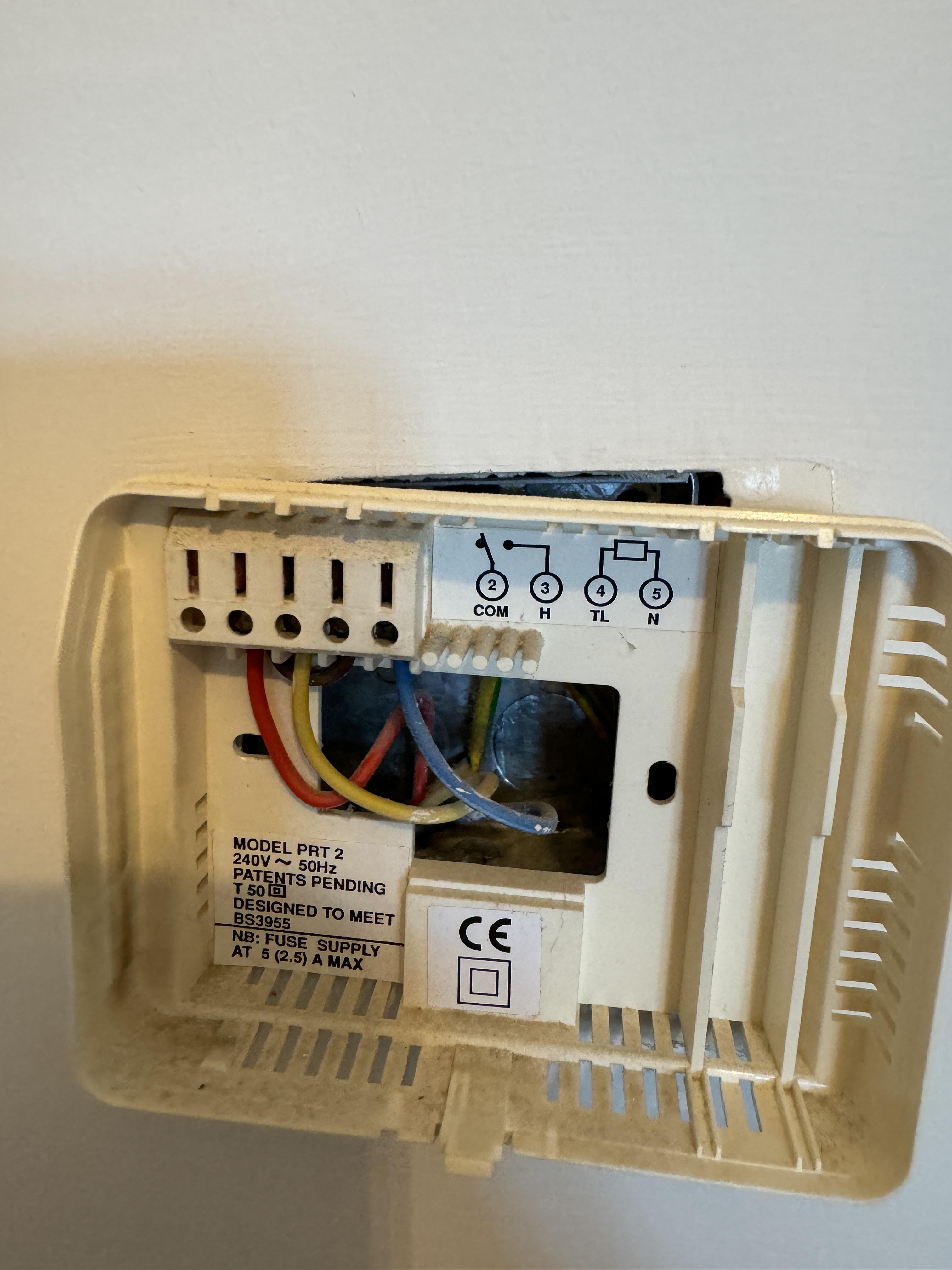

AliG Posted October 20, 2023 Share Posted October 20, 2023 On 12/04/2023 at 09:31, James94 said: @SimonD@temp Just removed the thermostat casing and taken a picture, if I choose not to or struggle tracing wires back to wiring centre. Is it just the case of a wago the live and yellow together that’s in three? what do I need to do with neutral and earth wires? Regards. James I am also trying to wire up a Hive system, although the existing system was working fine. Have been renovating my brother's flat and he asked for a new app controlled heating system. The old controls had turned yellow with age. I have connected up the Hive Receiver and it is working. I can use it to turn the hot water on and it was working to turn on the heating when the original Potterton PRT2 thermostat was in place. I then tried to bridge the old thermostat by connecting the red and yellow cables together here and isolating the blue one. That isn't working. I did think it might not work as the Neutral was previously connected to thermostat also. Can anyone tell me the right way to bridge the thermostat please. Link to comment Share on other sites More sharing options...
ProDave Posted October 20, 2023 Share Posted October 20, 2023 The neutral connection to an old type mechanical thermostat is just to power a tiny "accelerator heater" to eliminate the hysteresis between turn on and turn off point. So leaving that not connected won't be why it does not work. If you are just replacing a thermostat, there is probably a programmer somewhere that needs bypassing if you want it all to be controlled by the app. Link to comment Share on other sites More sharing options...
AliG Posted October 20, 2023 Share Posted October 20, 2023 I have already replaced the programmer with the Hive Receiver. This seems to be working fine. The receiver has manual switches to turn on the heating and hot water. I tested it with the original PRT2 thermostat in place and it worked fine. When I hit the hot water button the light goes green and the boiler fires up. When I hit the heating button it turns green but the boiler does not fire up. Now with the thermostat taken out of the circuit, I thought I could bridge it by connecting the red and yellow wires there, but the boiler is not firing up as I am guessing it is acting like the thermostat is not calling for heat. The wireless thermostat is connected to the Receiver and calling for heat, so I am wondering if it is how I have bridged the old thermostat. Link to comment Share on other sites More sharing options...
ProDave Posted October 20, 2023 Share Posted October 20, 2023 Typically a thermostat in a heating system will energise a motorised valve (either 2 port or 3 port) and the feedback switch in the motorised valve will call for heat from the boiler. So the boiler may not fire up for a few seconds after the thermostat closes. Are you SURE it was 100% working before you changed the thermostats? Yes normally linking the red and the yellow would be the same as turning the thermostat up. Link to comment Share on other sites More sharing options...
AliG Posted October 20, 2023 Share Posted October 20, 2023 I think I will get the old thermostat out of the bin just to check. Thanks for the help @ProDave Link to comment Share on other sites More sharing options...
ProDave Posted October 20, 2023 Share Posted October 20, 2023 If you have a multimeter, check that you have 240V between the red and the blue at the thermostat. If you don't then the "programmer" is off. Link to comment Share on other sites More sharing options...
