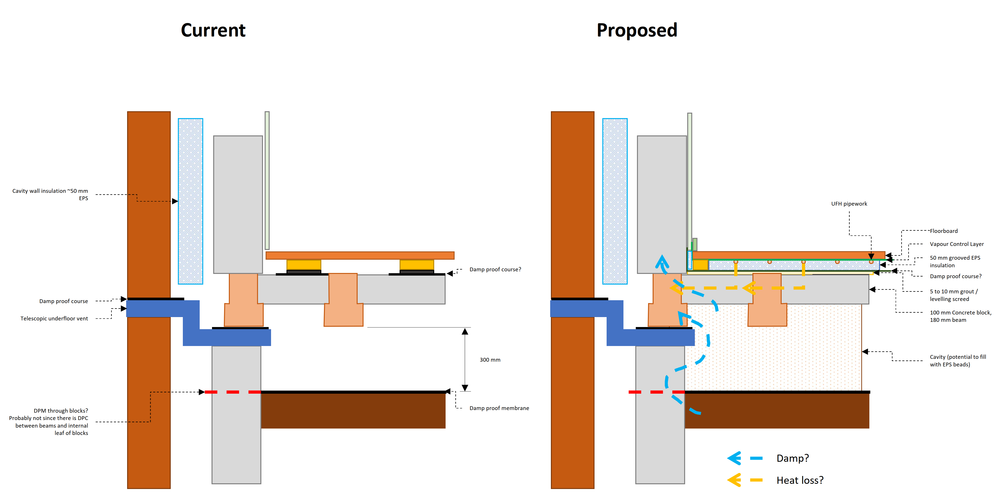

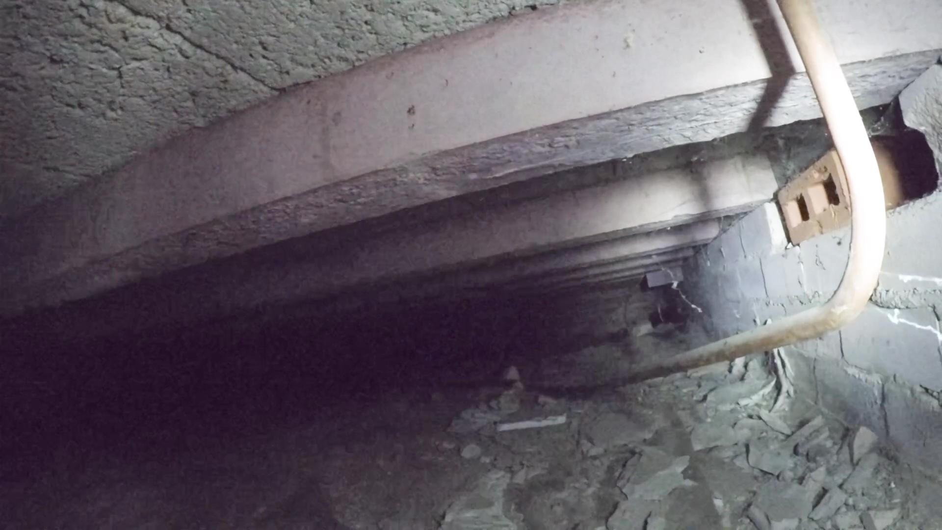

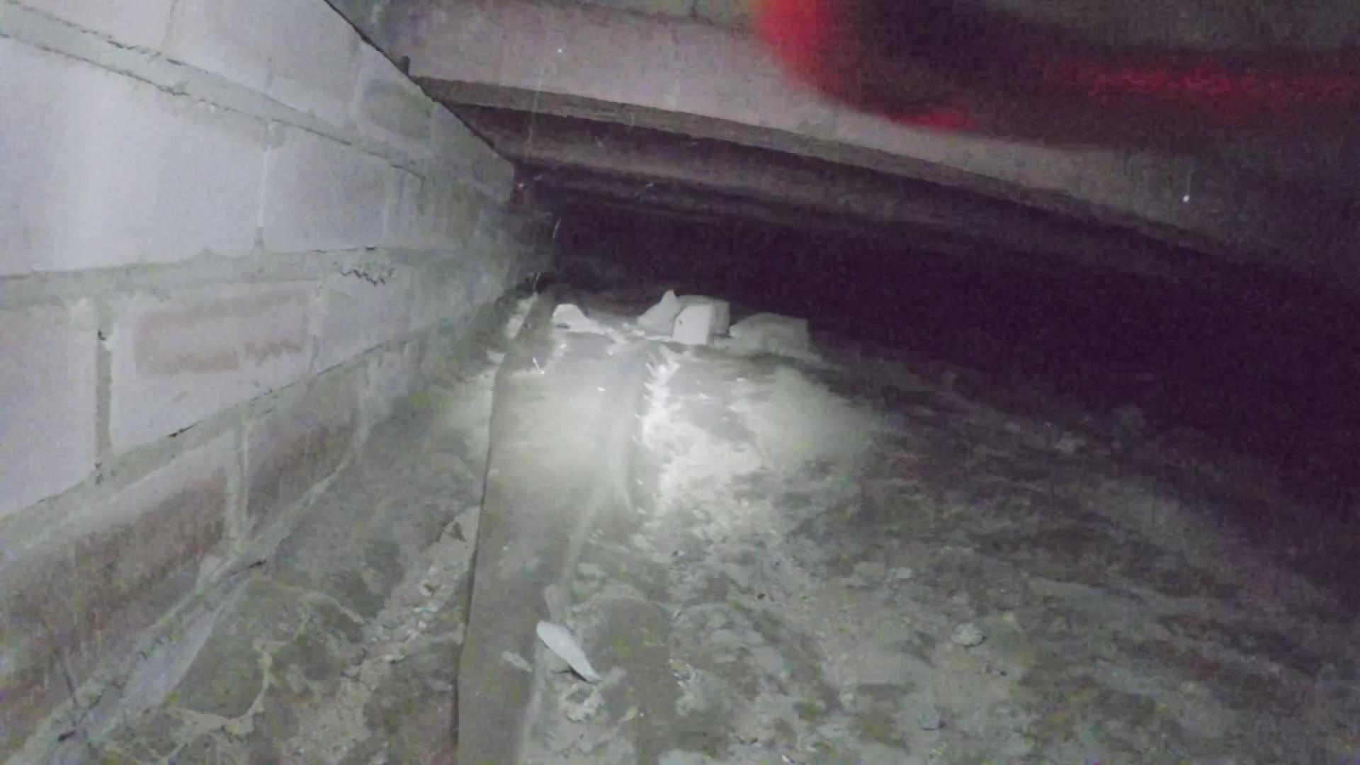

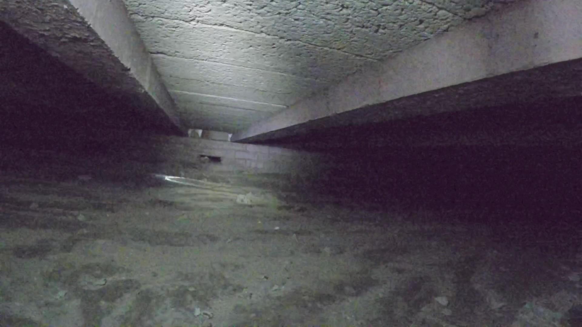

Looking for some advice on insulating the cavity of an existing beam and block sub floor. Our property was originally built ~1990 and is located in Edinburgh, Scotland. I’ve included a sketch of the current and proposed arrangements.
There is currently no access to the void space. I have managed a limited inspection of the void by fitting a GoPro through a penetration the last owners made in one of the blocks. There is currently a ventilated void of 300 to 380 mm (depending on interface with beams) beneath the subfloor. The ground is covered in what looks like a transparent damp proof membrane. I can’t see for definite how the membrane is terminated, so I’m not sure if it is simply loose around the edge of the block work, or whether it continues through the course of inner block work. There is no vegetation etc present, and everything in the void looks dry.
Upon inspecting the outer leaf of brickwork, I have found evidence of a damp proof course immediately above the telescopic underfloor vents.
I’ve identified the Super Bead system by Energy Store that we may be able to install to effectively insulate this void. The installer would pump EPS beads into the cavity in the same way as is done to retrofit cavity wall insulation. We’d manage the installation as part of other building works planned later this year, so are comfortable with installation process and level of disruption.
The installation guidelines state that the Damp Proof Membrane (DPM) should continue up the inner leaf and be secured beneath the beam & block floor system.
The installer estimates we can achieve a u value of ~0.10 W/m2K, compared to estimate of ~0.49 W/m2K for the current set up.
Energy Store Super Bead Beam and Block System Manual: https://source.thenbs.com/literature/energystore-beam-block-system-manual/ureVc5R4tbVEzchxsCNEWs/8hwTa8EYcje93NK8ytqXD1
I’ve read some discussion on this topic before, and would like some opinions on our specific situation:
·        Given the current arrangement, where is there risk of rising damp? What checks should I be doing to give confidence that this won’t happen?
·        If there is a risk of rising damp, are there any easy ways to mitigate?
·        Assuming we can mitigate risk of rising damp, should the telescopic vents be blocked?
·        I don’t know the detail between the concrete beam and block, and the inner leaf of blockwork. Is it fair to assume any thermal bridging around this perimeter would be insignificant in comparison to the benefit of insulation when compared to current / un-insulated arrangement?

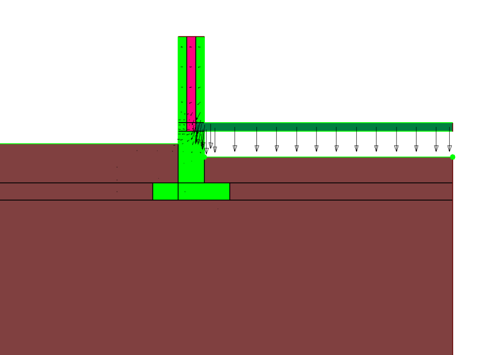

Posted

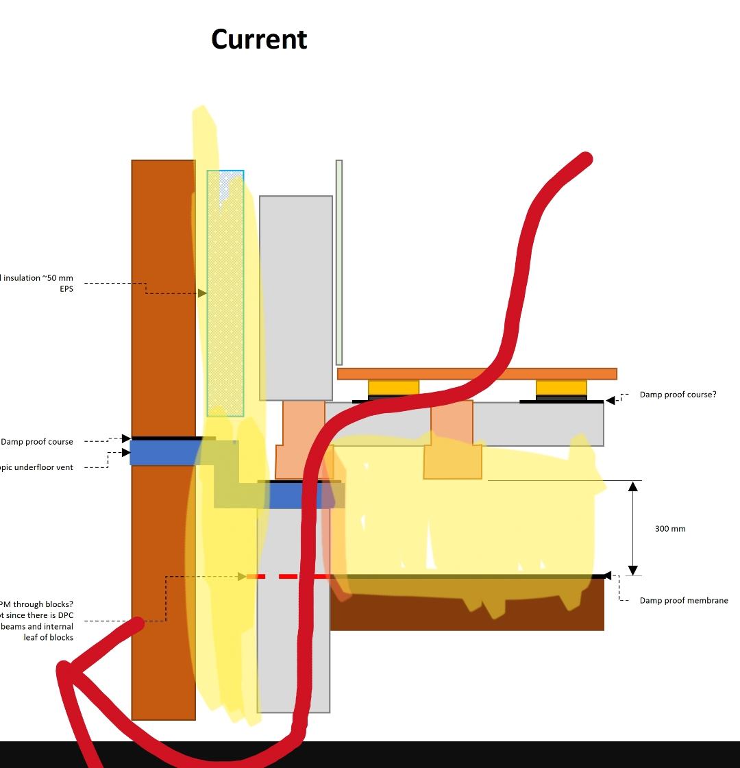

Not quite.
The residual wall cavity below the block and beam level.
Screenshot_2023-04-09-23-10-13-547-edit_com.android.chrome.thumb.jpg.4ce4e76ad346bbf32aae37fb88d2e266.jpg
Like this to make the heat have the longest most difficult path to leave the house.
Posted
Usually the cavity is filled below DPC so there is no "cavity" there.
As there will be a cold bridge from the beams out through the wall, I would perhaps mitigate this a bit by not taking the UFH all the way to the edge of the floor, as another way of giving the heat further to travel to get out of the house.

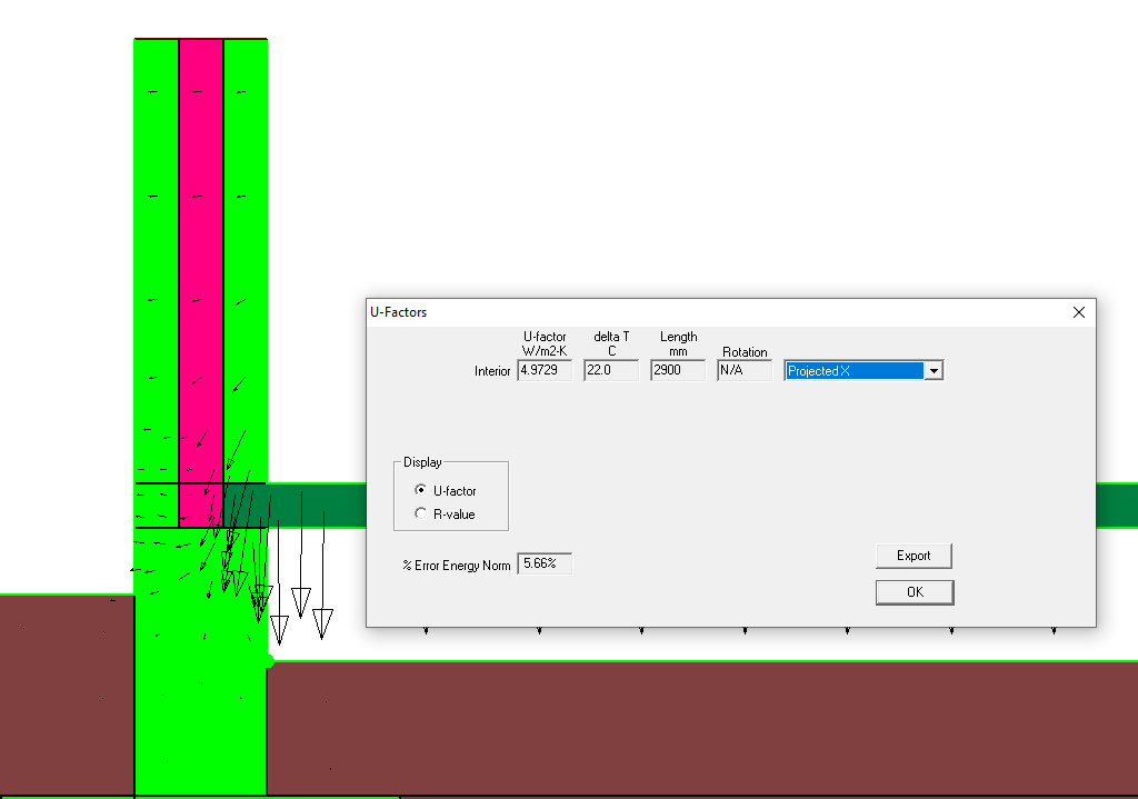

In terms of energy use it may be significant.
I'm away from my laptop for a few days. I might try to do a therm model if I get a chance at the end of the week.

Therm isn't that sophisticated. At least not in my hands. It's a static model.
Yes point losses are really tiny. Especially if spread over any distance above a few cm.
I did the calcs on our 250mm cavity wall for SS wall ties Vs Teplo and there was almost no benefit.

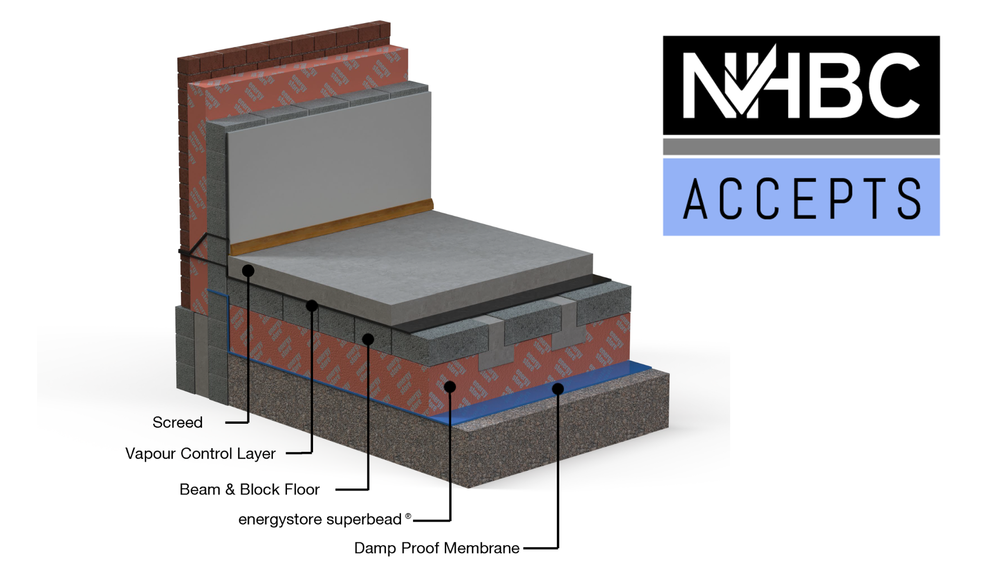

Unfortunately I cannot find a practical way to add more insulation above the sub-floor, without knocking the house down and starting again.
The supplier has obtained an NHBC acceptance certificate for this arrangement in a new build setting, which is why I wanted to understand if there are any other potential issues in a retrofit scenario.
Can you help me understand the specific concerns you have?
Posted
I can't see anything wrong with it. My concern would have been getting approval from BCO for a hybrid design but there is NHBC confirmation so should be ok.
so do not have air bricks.
Make sure that the dpm is utterly seales so that water cant get in (there is no way out again)
presumably the superbead is placed slightly prod so that there are no gaps.
How do you keep the superbead in place against the wind, and dry until the vcl goes in? or is this within a constructed house?

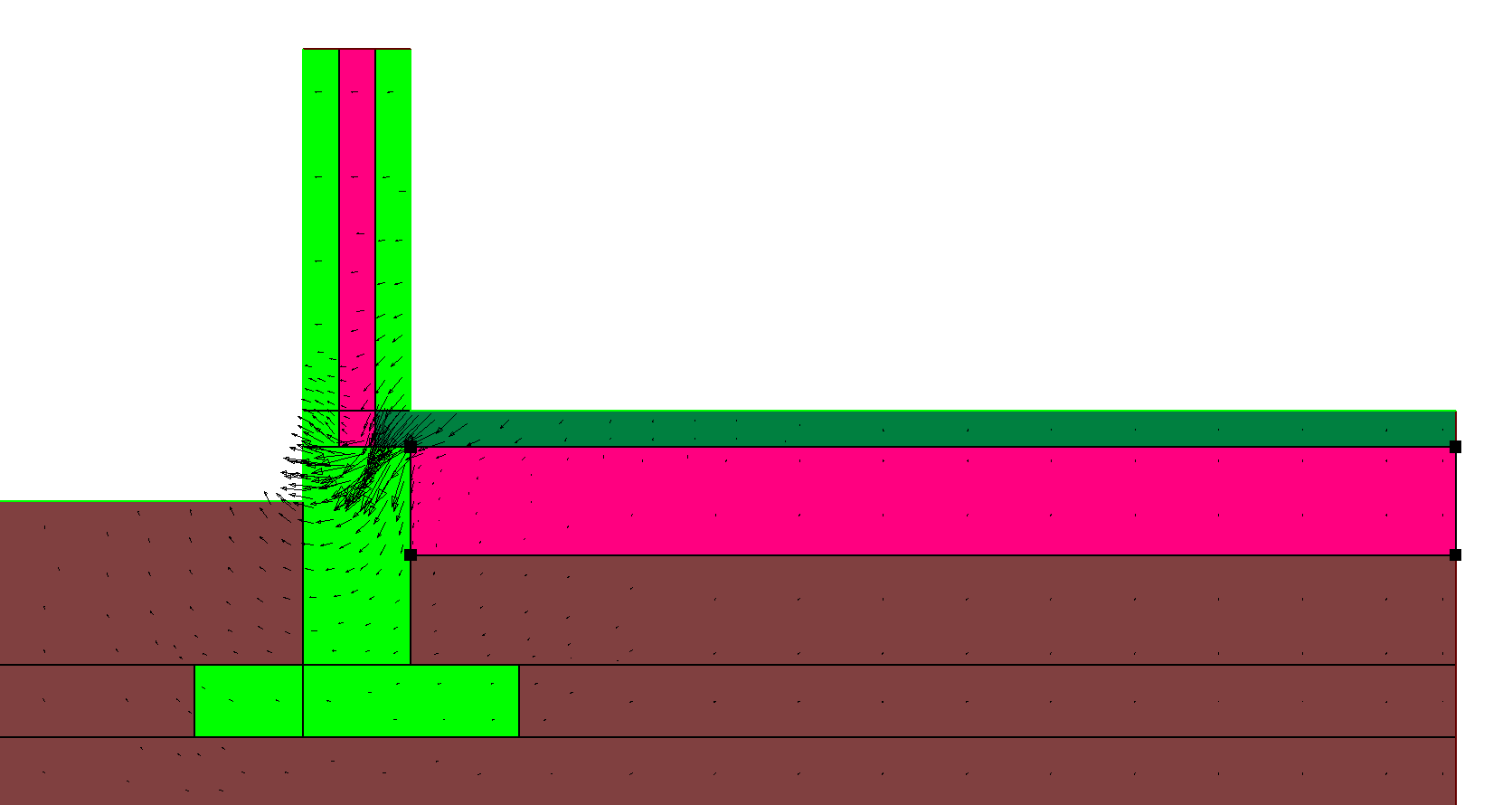

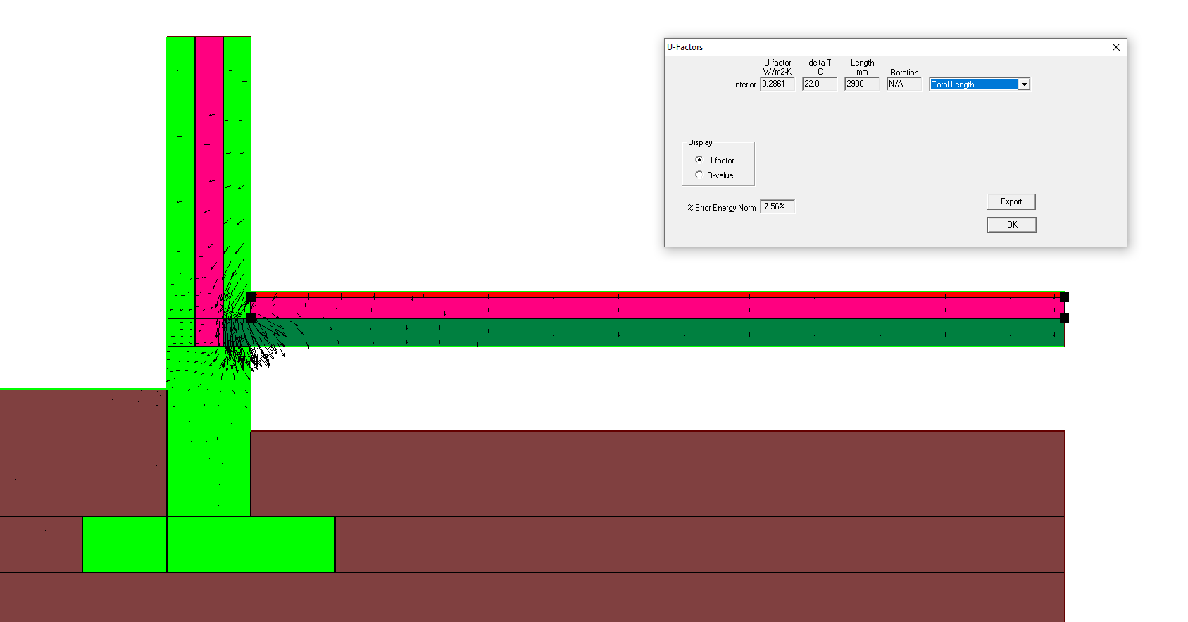

Posted

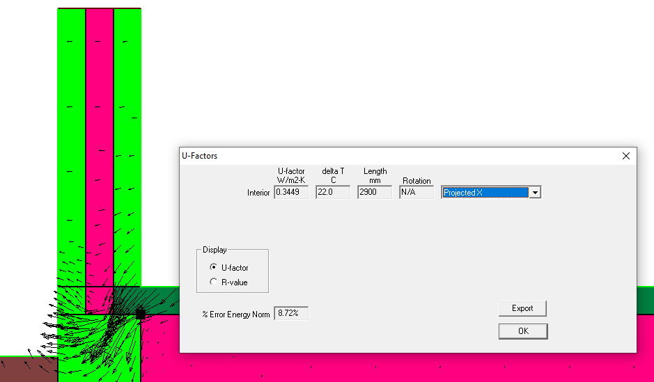

BEFORE
Without insulation. Assuming 100mm EPS in the cavity and full fill below ground level.
AFTER
With 300mm of EPS under the floor.
The U value drops significantly but given the effect of the thermal bridge not as far as you'd think.
