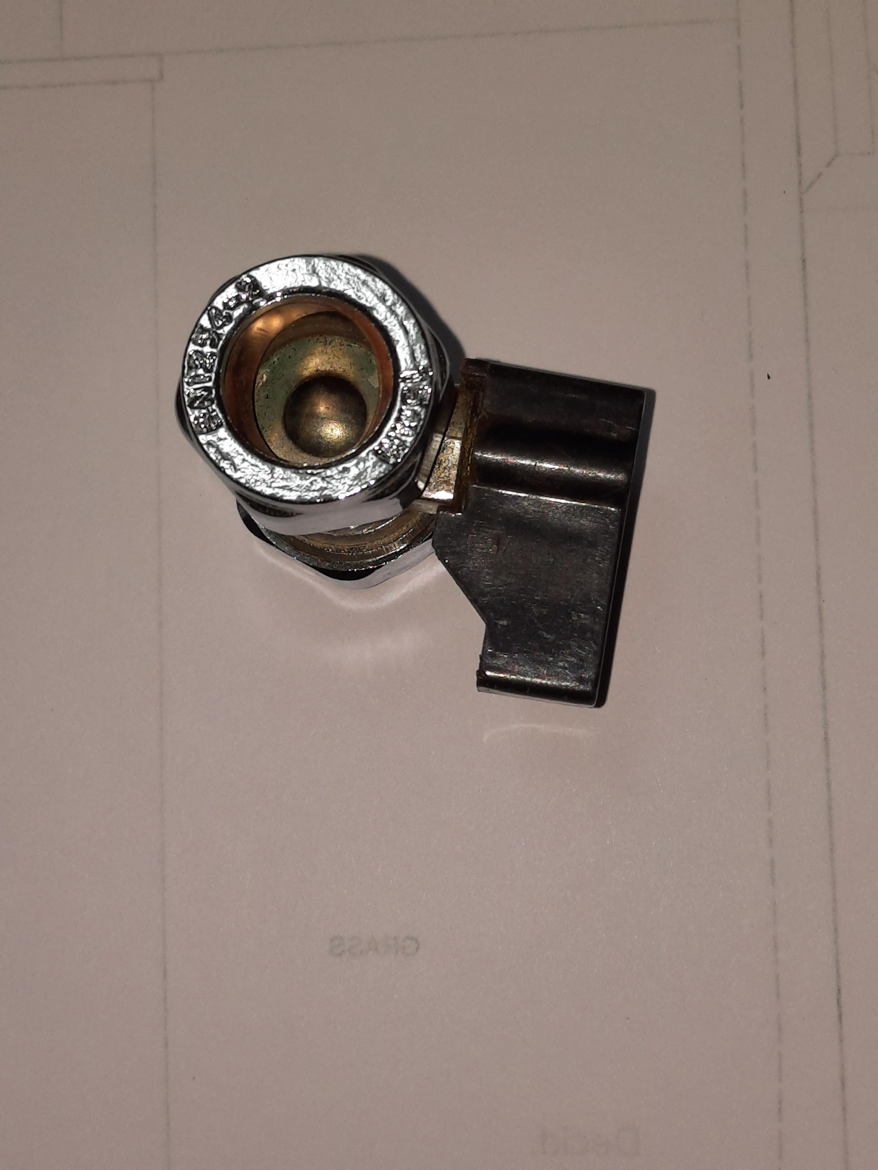

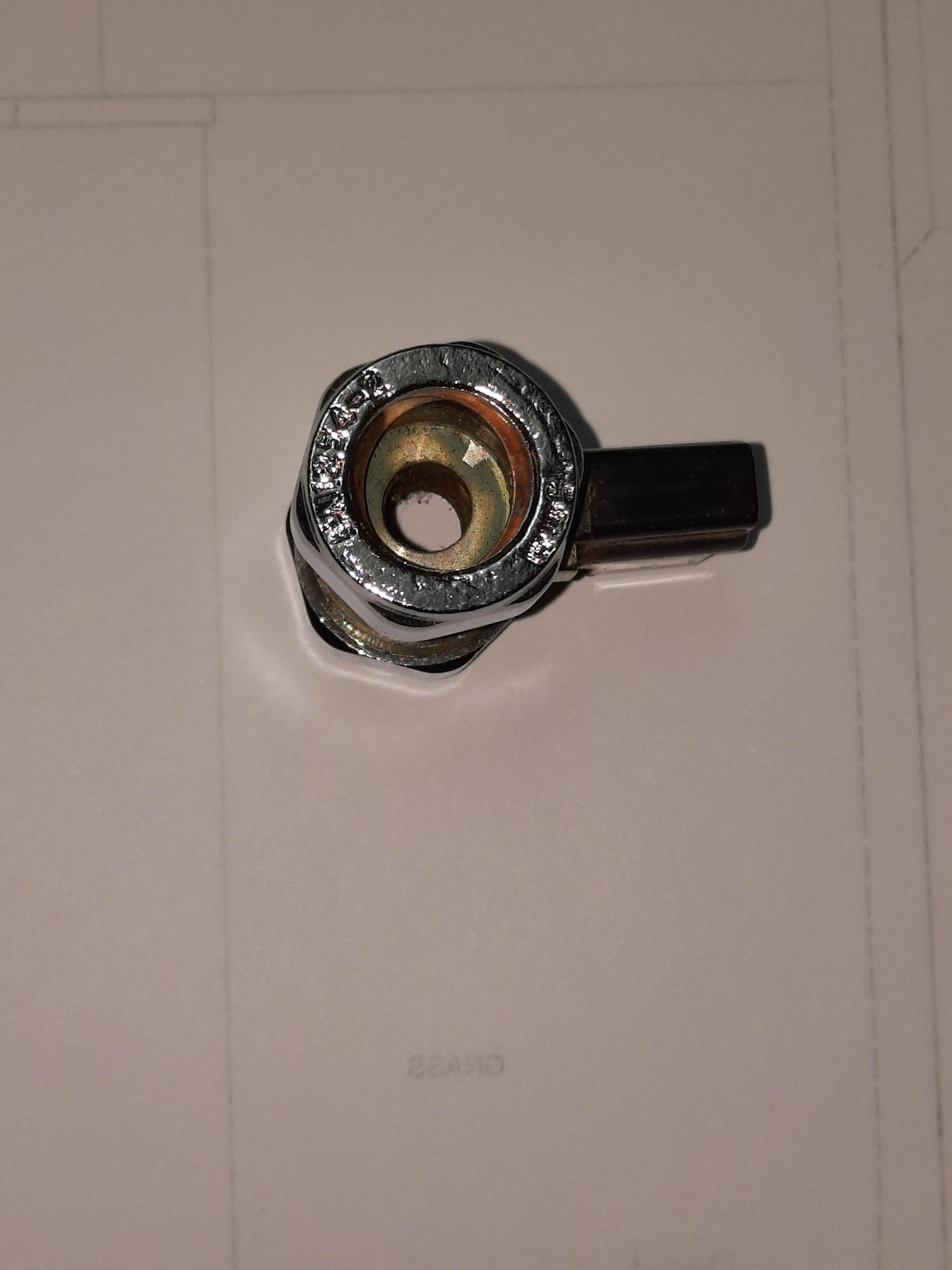

Marvin Posted April 11, 2023 Share Posted April 11, 2023 Hi @pepelepeu Judging from my experience the Expansion vessel is not working properly. Our ASHP system runs at 2 bar so the red line is about right. Is the valve on the pipework which allows the pressure to expand the vessel OPEN? looks closed to me. That's the one to the left of the PRV in your photo. Should it not be like this? and not this Good luck Marvin 1 Link to comment Share on other sites More sharing options...
pepelepeu Posted April 12, 2023 Author Share Posted April 12, 2023 19 hours ago, Marvin said: Hi @pepelepeu Judging from my experience the Expansion vessel is not working properly. Our ASHP system runs at 2 bar so the red line is about right. Is the valve on the pipework which allows the pressure to expand the vessel OPEN? looks closed to me. That's the one to the left of the PRV in your photo. Should it not be like this? 19 hours ago, Marvin said: and not this Good luck Marvin Yes it is closed Marvin, always has been...unless I use it to top up of course! Link to comment Share on other sites More sharing options...
Nickfromwales Posted April 12, 2023 Share Posted April 12, 2023 23 hours ago, pepelepeu said: This morning I went in and the air circulating around the flow pump was very noisy. Ok. There is defo a serious leak here as the system is part-draining down and is sucking air back in through the automatic air bleed vents ( they work both ways when there isn't any water inside ). Stop using the heating system immediately, as you're just constantly refilling with fresh oxygenated water which is corroding everything ferrous, hence the dirty look to the water. Get the plumber back in immediately to fix, give this to him in writing, text / email / WhatsApp and tell him either he fixes this, or you'll get someone else at his expense. 1 Link to comment Share on other sites More sharing options...
pepelepeu Posted April 12, 2023 Author Share Posted April 12, 2023 2 hours ago, Nickfromwales said: Ok. There is defo a serious leak here as the system is part-draining down and is sucking air back in through the automatic air bleed vents ( they work both ways when there isn't any water inside ). Stop using the heating system immediately, as you're just constantly refilling with fresh oxygenated water which is corroding everything ferrous, hence the dirty look to the water. Get the plumber back in immediately to fix, give this to him in writing, text / email / WhatsApp and tell him either he fixes this, or you'll get someone else at his expense. Thank you Nick Ive contacted him just waiting for a response. Link to comment Share on other sites More sharing options...
Marvin Posted April 12, 2023 Share Posted April 12, 2023 Hi @pepelepeu 5 hours ago, pepelepeu said: Yes it is closed Marvin, always has been...unless I use it to top up of course! I think it should be open. That is the black valve on the left ( I assume there are 2 valves and not just a bad photo). Link to comment Share on other sites More sharing options...
