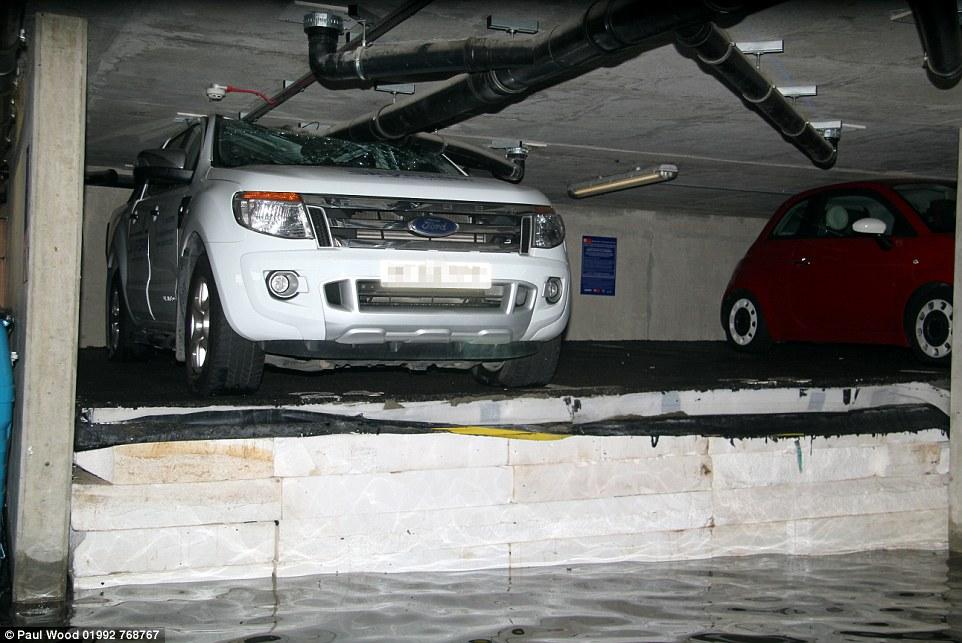

Insulation can be pretty strong....
https://www.dailymail.co.uk/news/article-3829379/Vehicles-CRUSHED-against-roof-burst-water-main-causes-polystyrene-insulation-beneath-car-park-float-raises-floor-four-feet.html
Quote
Cars and vans are CRUSHED against roof of underground car park when burst water main causes polystyrene blocks it was built on to float and rise up by 4ft
393D943500000578-3829379-image-a-77_1476027314749.jpg.ab95f7a893cfe1dc87be84c31695401f.jpg
Our 110m2 basement (300mm thick slab and 200m thick, 3m high walls) containing over 16t of rebar PLUS the 300 m2 timber frame house on top with render & slate roof is all sitting on 300mm thick EPS 200 grade - a 2.4mx1.2m block of which was 35kg and you'd struggle to leave an impression on it with a finger.
I guess this (or an equivalent grade) is what you're seeing in the image above.
The SE figured the point loading of the whole construction and we selected the EPS grade that just exceeded the spec.
By comparison, the sides of our basement were insulated with EPS70 - much softer (and cheaper) but enough to resist any sideways compression from the ground.
