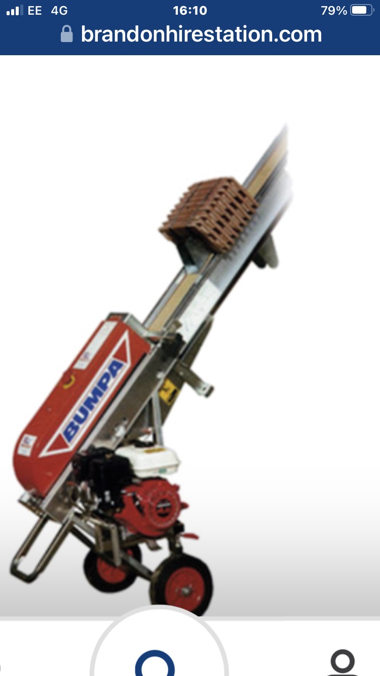

CalvinHobbes Posted April 2, 2023 Posted April 2, 2023 What are the methods to lift blocks up on a site? Looking at the most cost effective options. What about a winch? My dad (deceased) left one in a container. I know he used it years ago on a site.
nod Posted April 2, 2023 Posted April 2, 2023 Most sites use Tele-handlers Pricy for a one off I hired a bumpa hoist for the blocks and slates £110 per week from speedy 1
Declan52 Posted April 3, 2023 Posted April 3, 2023 You can use a trestle and planks positioned at the staircase opening and load this out with 40-60 blocks then hop up on to it and then lift the blocks up onto the first floor and then move them to wherever they need to go and just repeat this until you have enough up there. This is the cheapest option but obviously the slowest. It will also depend on what type of house your building. If it's a bungalow then you will have only blocks for the 2 peaks and maybe a few internal walls so not that many. But if it's a 2 storey with peaks again then your going to take need something mechanical. Either a nice local farmer with forks on a machine or a bumpa like above will be your best option. 1
