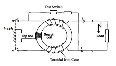

Gone West Posted April 2, 2023 Share Posted April 2, 2023 Is the direction of flow through the neutral of an RCD important? Link to comment Share on other sites More sharing options...
Mattg4321 Posted April 2, 2023 Share Posted April 2, 2023 In relation to the line conductor, yes. 1 Link to comment Share on other sites More sharing options...
ProDave Posted April 2, 2023 Share Posted April 2, 2023 Explain the issue you are having? Link to comment Share on other sites More sharing options...
Gone West Posted April 2, 2023 Author Share Posted April 2, 2023 1 hour ago, ProDave said: Explain the issue you are having? I don't have an issue as such, it's more a theoretical question. The garage that blew down a year ago had a small consumer unit in it and it looked like the neutral to the RCD connected at the bottom but the live connected at the top with the busbar at the bottom as normal. So I wondered if the neutral could go either way round as I've not seen it like that before. Link to comment Share on other sites More sharing options...
Temp Posted April 2, 2023 Share Posted April 2, 2023 Got a picture? Link to comment Share on other sites More sharing options...
Temp Posted April 2, 2023 Share Posted April 2, 2023 They work by passing both live and neutrals through a transformer of sorts. They way its wound means the field created by each winding should cancel out the other when they are the same. When they are different they don't cancel and the field produced trips the breaker. I think sending the current the wrong way on one would make it trip all the time because the field would add rather than subtract from each other. Link to comment Share on other sites More sharing options...
Nickfromwales Posted April 2, 2023 Share Posted April 2, 2023 The 'tripping coil' is kept in absolute equilibrium, regardless of direction, as power flows through line and neutral in equal 'quantities' in normal conditions. So in theory it will work with these reversed as there would be no pushing or pulling, just a constant current along both, ergo no potential present in the tripping coil. The RCD / RCBO gets tripped by the difference of potential created when line or neutral becomes partly compromised by being 'shorted' to earth, with there then being an electromagnetic flux thus created from this imbalance and that is collected ( detected ) by the coil ( a-la a CT clamp ), hence the name Residual Current Device. It's why you can get an RCD / RCBO to trip by shorting neutral to earth as well as line to earth. It's the reason birds can land on HV power lines and sit there, not becoming toast, as the left foot is at 132,000v, and the right foot is 132,000v so the difference between 132,000v and 132,000v is absolute zero. Poly happy. But, if they decided to sit in a row, and it was raining and the last one got his wet wing to ( or near to ) the earthed metal structure, then it's "en-flambe" for the lot of them. The 20 live birds who were sitting there energised at the line voltage ( 132,000v to 400,000v but have no current passing though them ) happily minding their birdy-business suddenly just got grounded, and the difference of potential is then 132,000v. Bye bye Polly. Link to comment Share on other sites More sharing options...
Nickfromwales Posted April 2, 2023 Share Posted April 2, 2023 4 hours ago, Gone West said: Is the direction of flow through the neutral of an RCD important? Absolutely. Yes, but for safety sake. 3 hours ago, Mattg4321 said: In relation to the line conductor, yes. Indeed, as you wouldn't want to get zapped when working on something that had defective / incorrect cabling downstream of the CU, and you come to then work on it as a 3rd party. Switching 'off' the front of house RCD or main switch should give double-pole isolation of the entire electrical installation from both sides of the incoming supply. 1 Link to comment Share on other sites More sharing options...

Onoff Posted April 2, 2023 Share Posted April 2, 2023 (edited) No offence but this simplified picture may be better. An imbalance, caused by leakage to earth, gets picked up by the search coil: Pushing the test button brings the resistor in and creates an imbalance. It is critical that the in/out wiring is correct. (Same as with current transformers). Edited April 2, 2023 by Onoff 1 1 Link to comment Share on other sites More sharing options...
