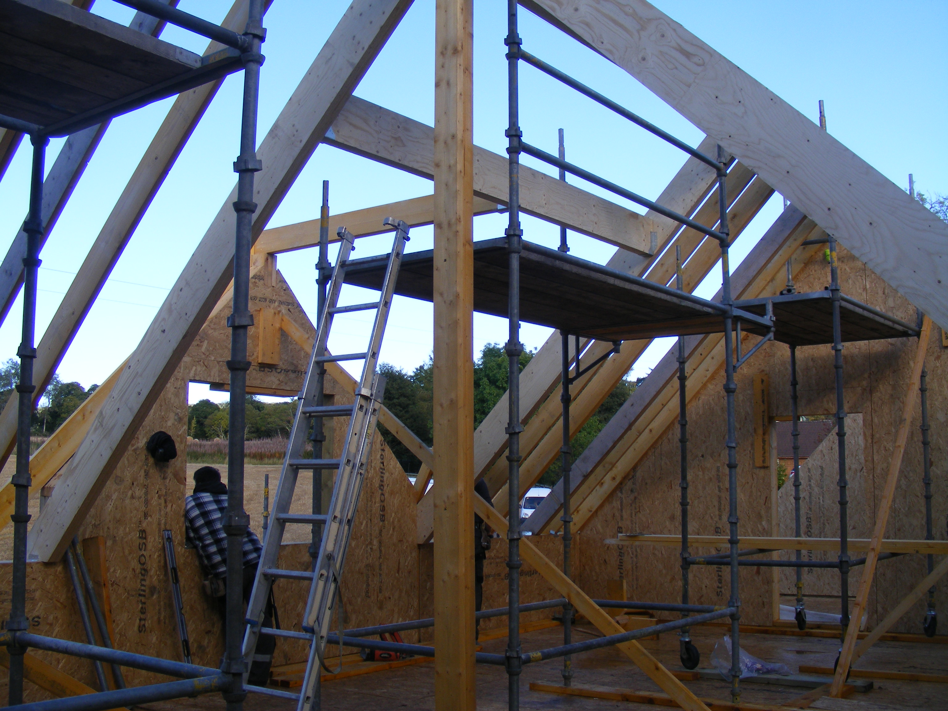

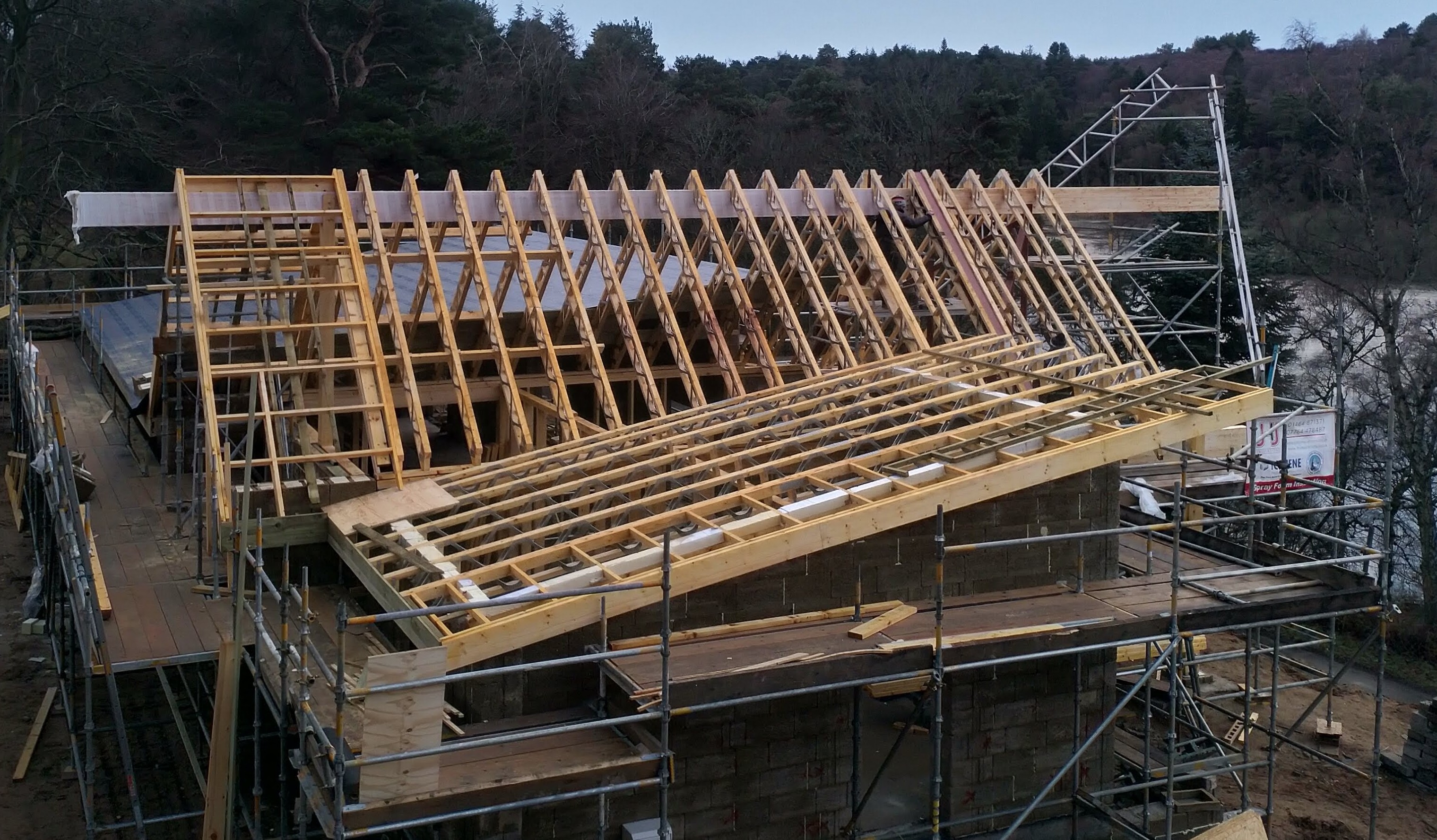

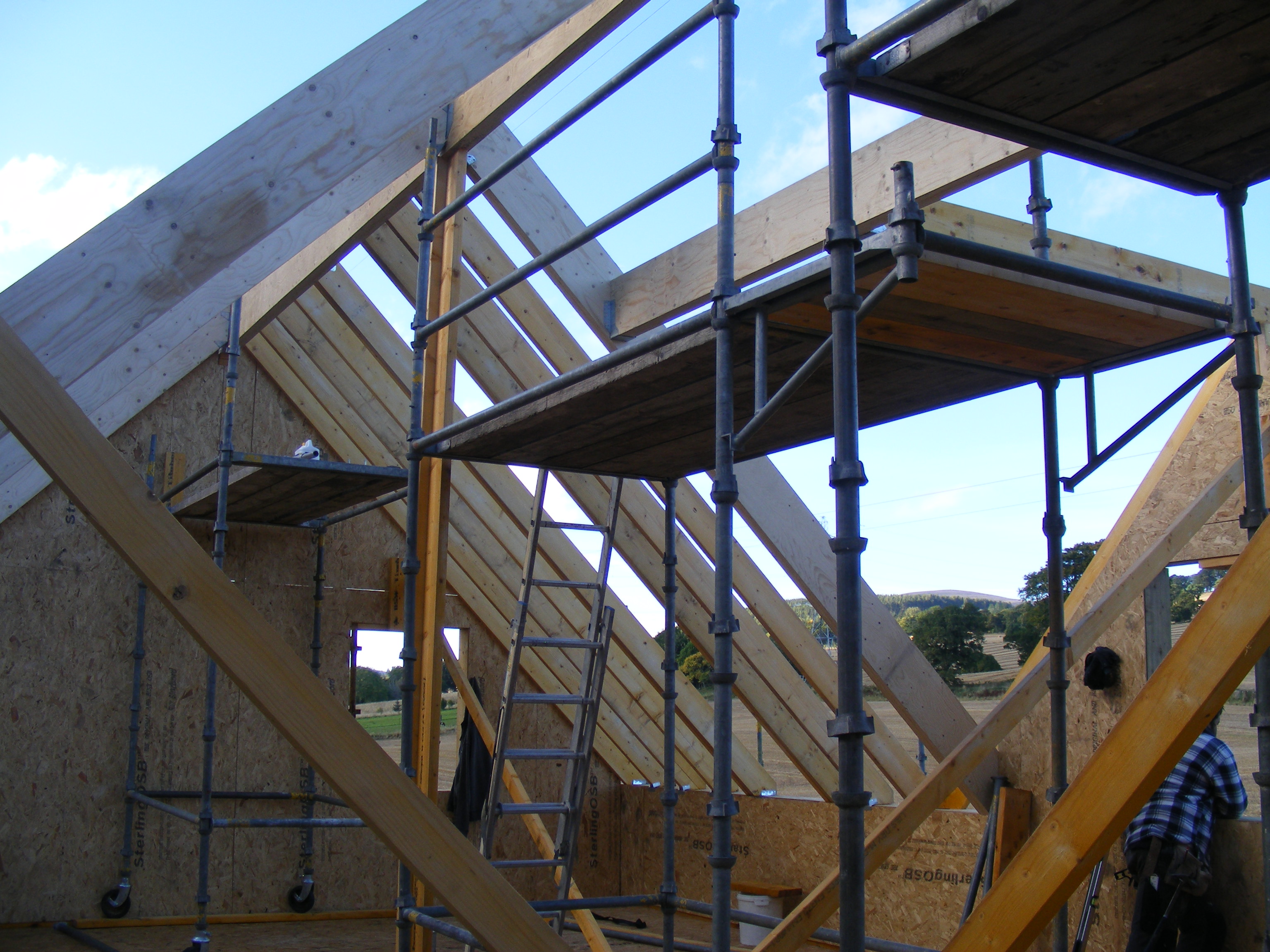

ProDave Posted April 1, 2023 Share Posted April 1, 2023 Is it room in roof? the velux windows suggest it will be. I thoroughly recommend what we did, and it is not difficult. Make it a cut roof supported on a big ridge beam. (the ridge beam will probably need intermediate support from internal walls) Then all the rafters span from the ridge beam to the wall plate, putting no outward load on the walls and giving unhindered use of all the roof space with no need for collar ties etc. You simply design the height of the ridge beam and rafters to allow for fitting insulation over the top of the rafters so by the time it is then battened and counter battened and tiled, your finished roof height matches what the planning drawings say. We used 100mm wood fibre above the rafters, and then 200mm Frametherm in between the rafters making it a hybrid roof. the air tight layer is immediately inside the rafters before plasterboarding (with or without a service void) Very easy, very simple, and performs very well, and very easy to get the air tightness detail done well. I will edit in a minute to add some photos......... 1 Link to comment Share on other sites More sharing options...

Thorfun Posted April 1, 2023 Share Posted April 1, 2023 I would suggest the OP do as @ProDave has suggested with a cut roof. having been through the process of filling our attic trusses with 195mm glass wool and adding 100mm PIR underneath I can tell you it is a pain on attic trusses! in our vaulted ceiling entrance hall we had a cut roof and it was a doddle not having to cut around trusses. but might I also add the suggestion of using very deep trusses as filling will blown cellulose instead of mineral wool and rigid insulation combo. if I had my time again I would do a cut roof with blown cellulose for sure! 1 1 Link to comment Share on other sites More sharing options...
JohnMo Posted April 1, 2023 Share Posted April 1, 2023 We basically did insulation between rafters, our pozi rafter are 256mm deep and we counter battened below 100mm and then spray foamed. Pozi joist come precut to size, and are a doddle to construct. Big ridge beam, wall plates and just assemble. Pozi joist company designs the whole thing, structural engineer approved and includes within the structural engineering certificate (for Scottish building warrant). From this To this 250m2 of roof ready to slate about 3 to 4 weeks, team of 3 guys. 1 Link to comment Share on other sites More sharing options...

Dave Jones Posted April 2, 2023 Share Posted April 2, 2023 15 hours ago, JohnMo said: We basically did insulation between rafters, our pozi rafter are 256mm deep and we counter battened below 100mm and then spray foamed. Pozi joist come precut to size, and are a doddle to construct. Big ridge beam, wall plates and just assemble. Pozi joist company designs the whole thing, structural engineer approved and includes within the structural engineering certificate (for Scottish building warrant). From this To this 250m2 of roof ready to slate about 3 to 4 weeks, team of 3 guys. lovely design. With hindsight, id warm deck the whole roof, not faff about in-between rafters, leave them exposed. Deck straight over the top 200/300mm Would look nice and chunky and could be done in a couple days. Link to comment Share on other sites More sharing options...
JohnMo Posted April 2, 2023 Share Posted April 2, 2023 6 minutes ago, Dave Jones said: lovely design. With hindsight, id warm deck the whole roof, not faff about in-between rafters, leave them exposed. Deck straight over the top 200/300mm Would look nice and chunky and could be done in a couple days. You are correct, I had proposed this to the architect but got quite a lot of push back. It would have quicker and way less work for me. Link to comment Share on other sites More sharing options...
