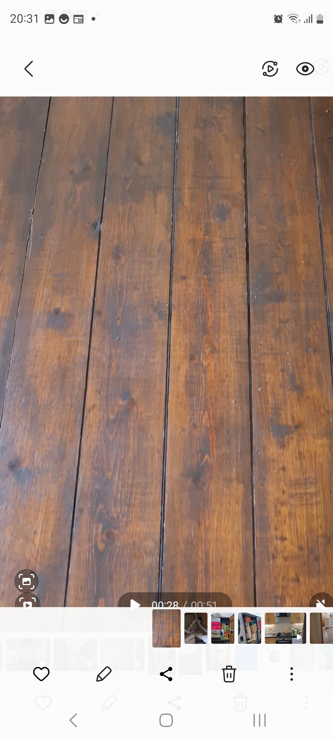

Screenshot_20230330_221214_Gallery.thumb.jpg.3284653473de1f539da61d2b16d6fb5e.jpgPlan was to fit laminate flooring so lifted carpets and found this.
100 year old Glasgow tenament fairy solid but 6 to 10mm gaps.
Read quite a lot but as it in good nick would want to nail the odd squeaky board then wax it.
I'm thinking a squirt od black silicone for the gaps afterwards?
What says the forum?
2nd floor so no real ventilation issues.
More the gaps collect grime.

No don't. It will look rubbish.
You get proper filler for the job, which is just the same as car body filler, that is tinted to the colour you want.
You could also router the gaps straight and in fill with wood, but that's a lot of work.
A rug over the worst bits?

Leave the gaps.
I think any filler will look bad and probably crack out due to flexing.

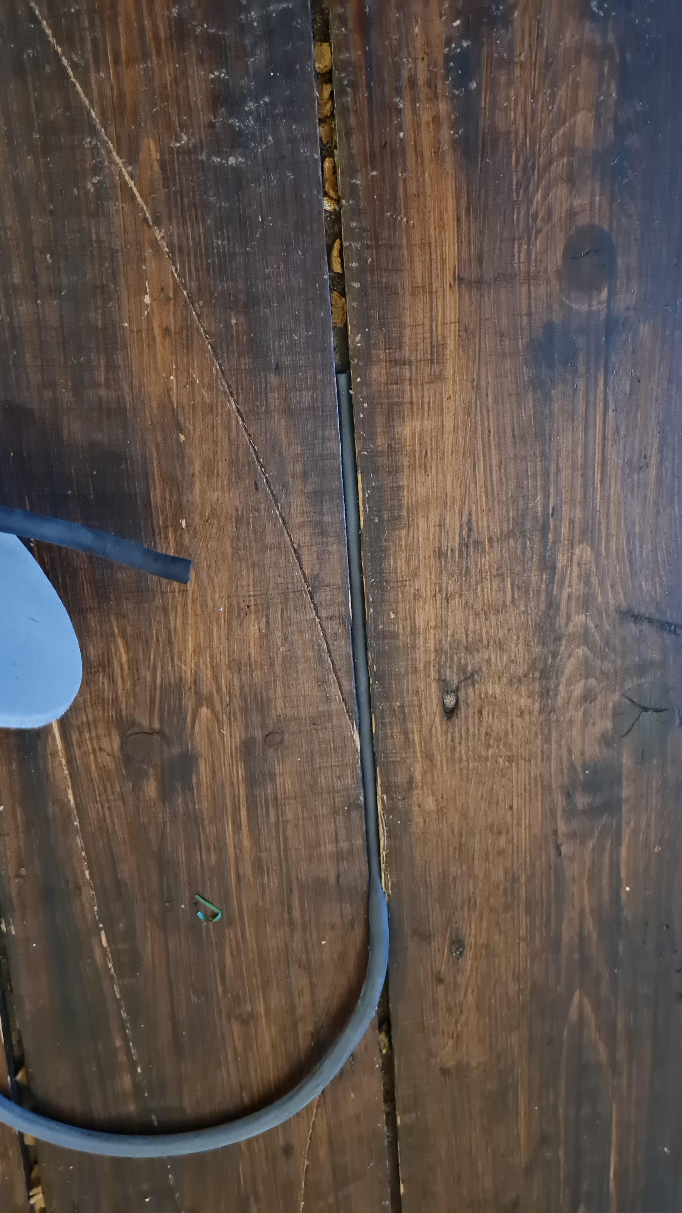

I've looked at the reviews for Draught Ex and for £31 it looks like it's worth a go.
Basically a foam tube that you stretch and ram into the gap, black in colour so if pushed well in creates a shadow.
Seems the trick is gauging the amount of stretch to make it thin with the amount of ramming in to the correct depth.
It then expands so you get a nice flexible deal.
Reviews say it can be hard on the old knees but if you take time a good result.
My knees are too sore so if the youth want a lesson then crack on, it's up to them.

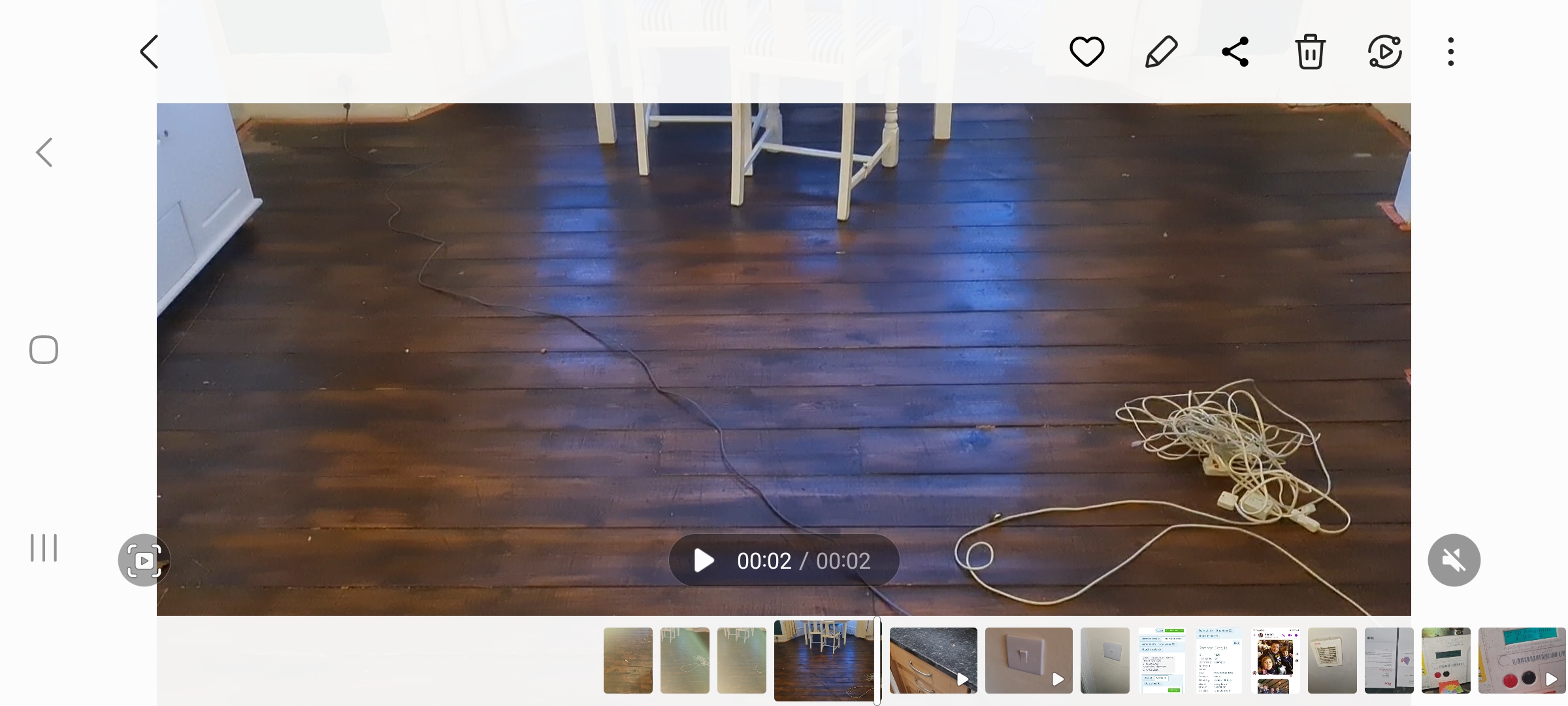

I’ve done several of these floor repair jobs on listed buildings. Often they want very little of the original fabric to change so the work arounds are to patch and repair where necessary. I buy replacement re-sawn old pine boards for any replacements. Issue with replacements is you can’t keep both the tongue and groove on the old board and include a new tongue and groove on the new board. You can half lap one side but it is rather labour intensive and requires nice clean cuts and a router. Many floors we have done where the replacement boards have been fitted all seem to shrink after they acclimatise at the 20+degrees inside the house over a year. If there is any flex in the old flooring, any ‘filler’ material is likely to pop out if it is brittle, like wood filler.
If you plan to re-sand the whole floor then using timber ‘slithers’ works very well. 1m long strips of wood cut into a slither sizing from 0mm-6mm/12mm. If the floor is well fixed down the slithers can be glued and hammered into the gaps to make up the gap. These can then be planed flat and sanded with the whole floor. This in my opinion is the best solution. Or, lift the old boards and re fit if it’s an option.
