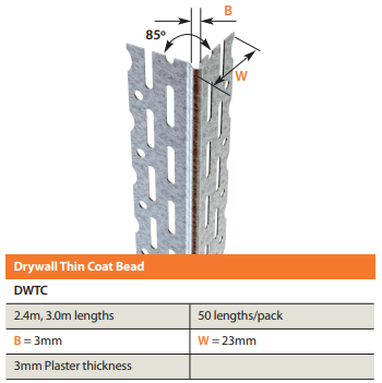

MortarThePoint Posted March 30, 2023 Share Posted March 30, 2023 I'm preparing for the Plasterer who is coming next week which is exciting. He's going to be plasterboarding the reveals and doing all the beads and scrim tape. Is it best to use moisture resistant plasterboard in window reveals? Is there anything I should do with blockwork cracks? Mesh? I've got them under the longer windows. I'm now frantically creating piles of sawdust as I prepare the window boards and door linings. 1 Link to comment Share on other sites More sharing options...

PeterW Posted March 30, 2023 Share Posted March 30, 2023 On 30/03/2023 at 20:14, MortarThePoint said: I'm preparing for the Plasterer who is coming next week which is exciting. He's going to be plasterboarding the reveals and doing all the beads and scrim tape. Is it best to use moisture resistant plasterboard in window reveals? Is there anything I should do with blockwork cracks? Mesh? I've got them under the longer windows. I'm now frantically creating piles of sawdust as I prepare the window boards and door linings. Expand Iโm assuming here that youโve got plasterboard reveals but full bonding / topcoat everywhere else direct to block ..? What sort of cracks are we talking as unless the mortar was strong and the blocks were thermolites or similar then you shouldnโt have cracks anywhere. You could mesh the base coat but it seems overkill - @nod any thoughts ..? Link to comment Share on other sites More sharing options...
nod Posted March 30, 2023 Share Posted March 30, 2023 No need to use moister boards on reveals Except for bathrooms Im guessing the wall arnt dabbed and are wet plaster backing If thatโs the case He should set the reveals then bead after the backing plaster goes on the walls No need for Scrim Just use the wider skim beads 40 mil 1 Link to comment Share on other sites More sharing options...

MortarThePoint Posted March 31, 2023 Author Share Posted March 31, 2023 On 30/03/2023 at 22:28, nod said: No need to use moister boards on reveals Except for bathrooms Im guessing the wall arnt dabbed and are wet plaster backing If thatโs the case He should set the reveals then bead after the backing plaster goes on the walls No need for Scrim Just use the wider skim beads 40 mil Expand Walls are blockwork and are to be wet plastered. Plasterer specifically asked for Catnic beads, though said the BG ones are good too. I'm sure it's a matter of whatever you are used to, but I wanted to get as asked. I've ordered these, but they have a 23mm bit. Do you know who does a 40mm one? I'm guessing he wants the scrim tape for the plasterboard ceilings and partitions Link to comment Share on other sites More sharing options...
nod Posted March 31, 2023 Share Posted March 31, 2023 Probead Link to comment Share on other sites More sharing options...
PeterW Posted March 31, 2023 Share Posted March 31, 2023 On 31/03/2023 at 11:10, MortarThePoint said: I've ordered these, but they have a 23mm bit. Do you know who does a 40mm one? Expand They are thin coat beads - you want wet plaster or render beads Search for Plaster Standard Angle Bead Link to comment Share on other sites More sharing options...
