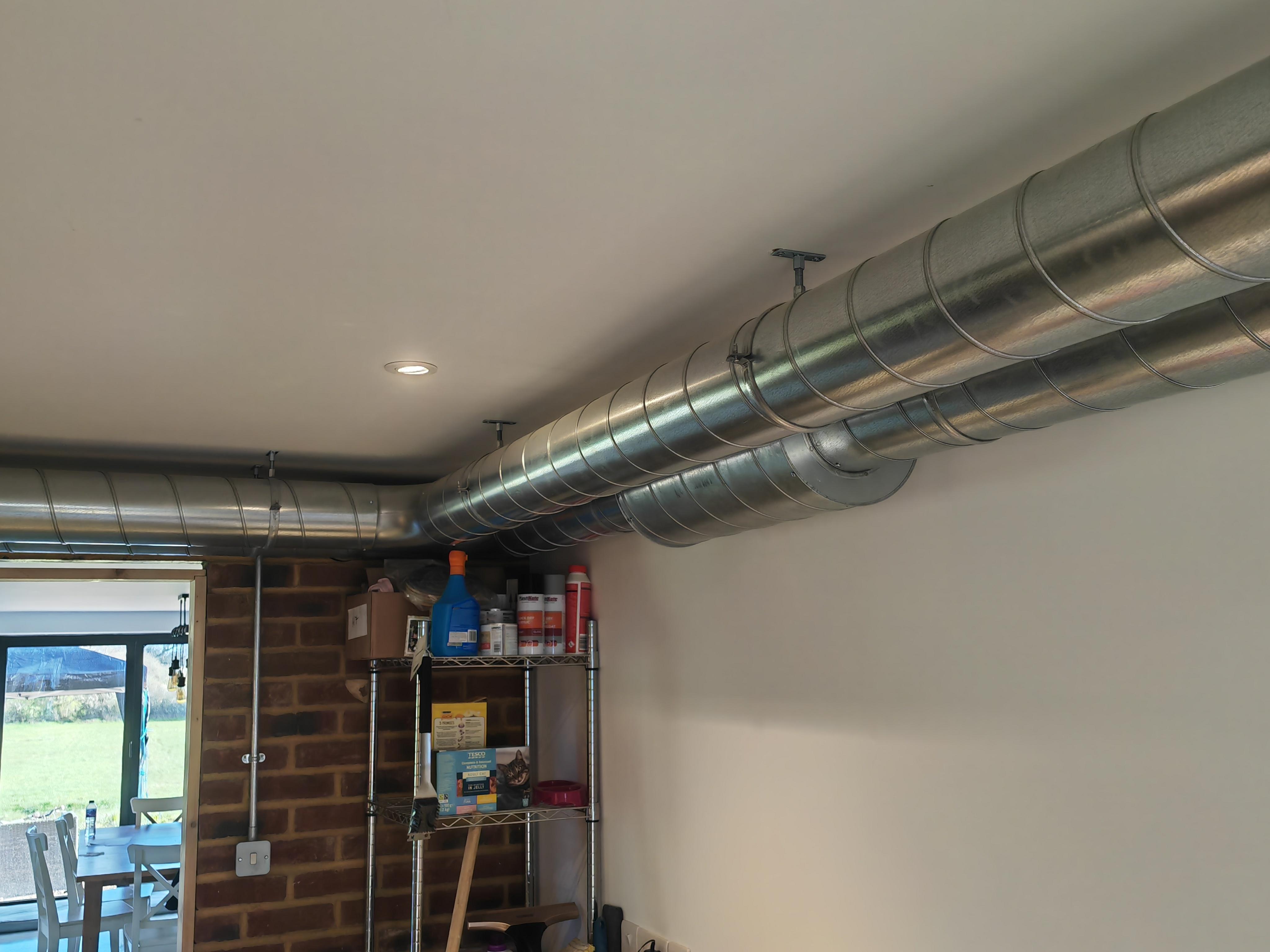

mattman Posted April 12, 2023 Share Posted April 12, 2023 (edited) We used a Beam C90 MVHR system supplied and all fully installed and commissioned for just over £5k, just before xmas. It covered a total floor area of 264sqm and used exposed galvanised steel ducting (as shown in the pic) because we wanted the industrial look plus it was all retrofit. They did an amazing job and worked till late each day getting the job done. It's really quiet and we get no condensation anymore and we also have no heating upstairs so any warmth generated downstairs is distributed throughout the house. Definitely recommend the system and company https://www.rbcentralsystems.co.uk/ who installed and commissioned it. Edited April 12, 2023 by mattman 1 Link to comment Share on other sites More sharing options...
