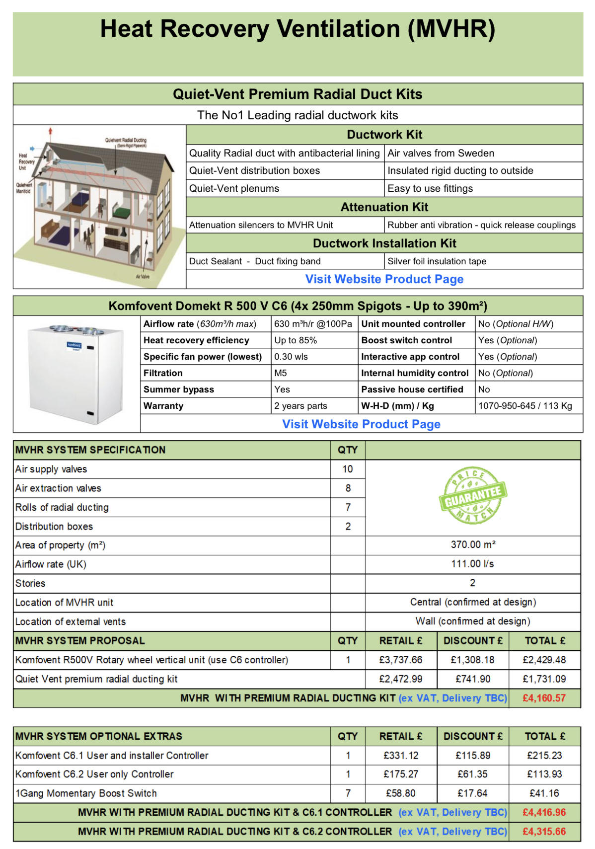

Mikey Posted March 28, 2023 Share Posted March 28, 2023 Hi all, would value opinions on the attached spec for the MVHR in our new build! Feels cheap! I’m looking for a good spec system as once it’s in, it’s in for life!… but I don’t know what good looks like. Maybe the attached is perfect. Not sure! Any advice appreciated Link to comment Share on other sites More sharing options...
gc100 Posted March 28, 2023 Share Posted March 28, 2023 Good price. Make sure those pipes are insulated in the loft area of a cold space 1 Link to comment Share on other sites More sharing options...
Iceverge Posted March 28, 2023 Share Posted March 28, 2023 Looks fine really. Check the silencer, rigid ones like a car exhaust are better than flexible ones IMO. I can't see any external grills or ducting clips. 1 Link to comment Share on other sites More sharing options...
Miek Posted March 29, 2023 Share Posted March 29, 2023 If your house is 370m2 as it says you may have some long runs which often means double or triple, depending on room size and type as its 75mm ducting. Worth considering having a detailed layout done from your plans so you know exactly what you need and where. Personally I would consider going up a pipe diameter to 90mm or so to have fewer pipe runs. Not sure if BPC offer this, though other suppliers are available. 1 Link to comment Share on other sites More sharing options...
JackofAll Posted March 29, 2023 Share Posted March 29, 2023 2 hours ago, Miek said: If your house is 370m2 as it says you may have some long runs which often means double or triple, depending on room size and type as its 75mm ducting. Worth considering having a detailed layout done from your plans so you know exactly what you need and where. Personally I would consider going up a pipe diameter to 90mm or so to have fewer pipe runs. Not sure if BPC offer this, though other suppliers are available. So by going up to 90mm there is no need to double up on the runs that otherwise require it using 75mm? 1 Link to comment Share on other sites More sharing options...
Thorfun Posted March 29, 2023 Share Posted March 29, 2023 6 minutes ago, JackofAll said: So by going up to 90mm there is no need to double up on the runs that otherwise require it using 75mm? i think it all depends on the airflow required and needs to be calculated. we had 90mm ducts specified as our unit was pushing the limits of the area of the house and so by upping the duct size it made it all work. 1 1 Link to comment Share on other sites More sharing options...
Mike Posted March 29, 2023 Share Posted March 29, 2023 The Komfovent DOMEKT R 500 V is an unusual choice. Counterflow heat exchangers are mostly chosen for domestic use, rather than rotary ones. I wonder why they've picked it? Komfovent do have a similar model on the Passivhaus component database, and the performance looks reasonable, if not class-leading. Link to comment Share on other sites More sharing options...

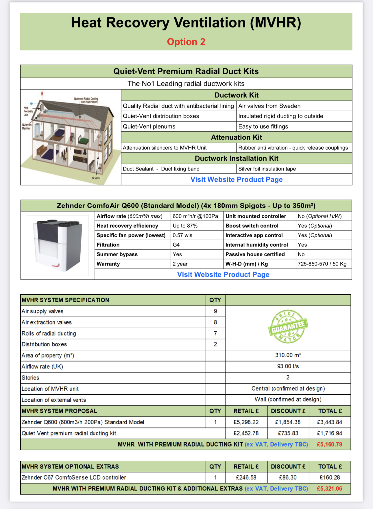

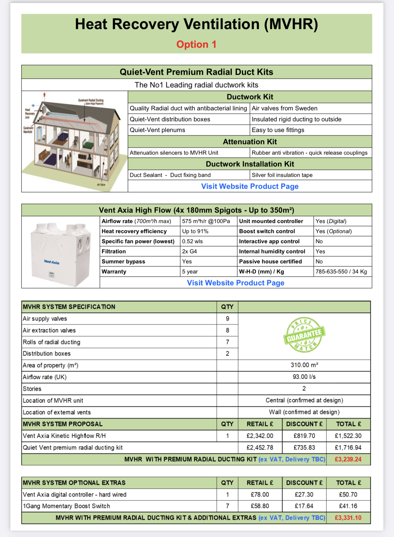

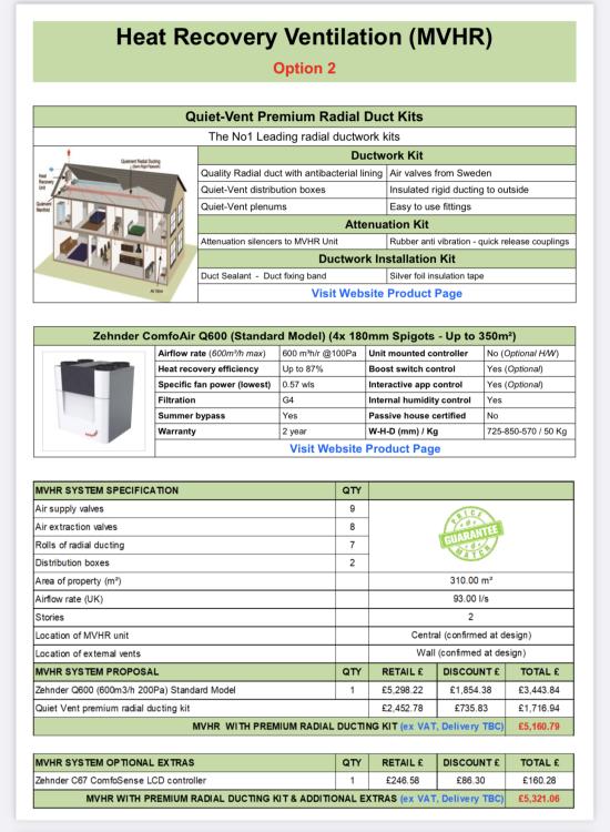

Mikey Posted March 30, 2023 Author Share Posted March 30, 2023 I’ve asked them to remove the annex from the quote as we don’t need it in there. They’ve given two further options (attached). What we really don’t want is cold drafts blasting out in winter, so I’m leaning towards the Zehnder ComfoAir Q600 option but the pre-heater version (not the standard one as quoted in option 2 attached). Link to comment Share on other sites More sharing options...
Mikey Posted March 30, 2023 Author Share Posted March 30, 2023 Just spoke to the supplier and they said the main difference between the two options above was the Zehnder had an app and the Axia didn't! (an app would be nice but not £2k nice!) They also said the Axia was the most reliable on the market - very few maintenance issues. I guess hence the 5 yr warranty they offer. I'll be going with the Axia option. So far I've been impressed with BPC! Hope this thread helps others. Thanks for all your input. Link to comment Share on other sites More sharing options...
Blooda Posted March 30, 2023 Share Posted March 30, 2023 With the vent axia make sure you have the remote control - this replicates the display on the machine, this link is for the kinetic but there should be one for the high flow version. Sentinel Kinetic Wired Remote Controller | Vent-Axia We put ours on the landing - saves going up to the loft when messing around with it. And wire in your boost to your light switches as the vent as the vent axia wireless ones look very 1980's See if they will price match this- Vent Axia 408449 Lo Carbon Sentinel Kinetic High Flow MVHR Heat Recovery Unit Right Hand Flow (powerdiscount.co.uk) save £26.40 - every little helps Link to comment Share on other sites More sharing options...
