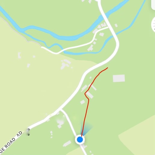

Losingsleepoverdrainage Posted March 29, 2023 Author Posted March 29, 2023 On 29/03/2023 at 08:22, Kelvin said: You said in the op that one of the options is to discharge into a waterway. Is this just the EA saying you can (generally after exploring all other options) or there is a waterway/ditch nearby you could discharge to? Expand Yes, there is a river and mill stream around 150m downhill past the pipe, so if we have a STP in place, would sort the permit problem (as in no need for one). It seems like the only sensible way to make everyone - including land owner property - compliant.

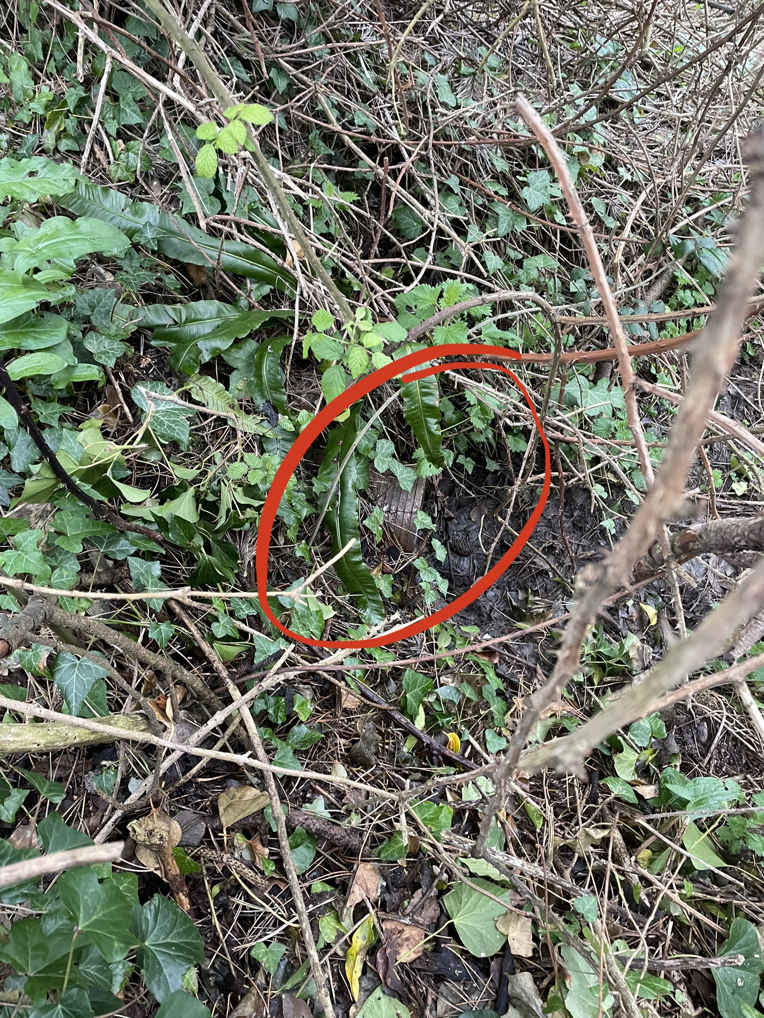

Losingsleepoverdrainage Posted March 29, 2023 Author Posted March 29, 2023 Basic of most basic maps, it seems obvious to me what to do, and how to do it. Photo of end of pipe
Kelvin Posted March 29, 2023 Posted March 29, 2023 I’m sure you would have said but I assume there isn’t a ditch that follows the road?

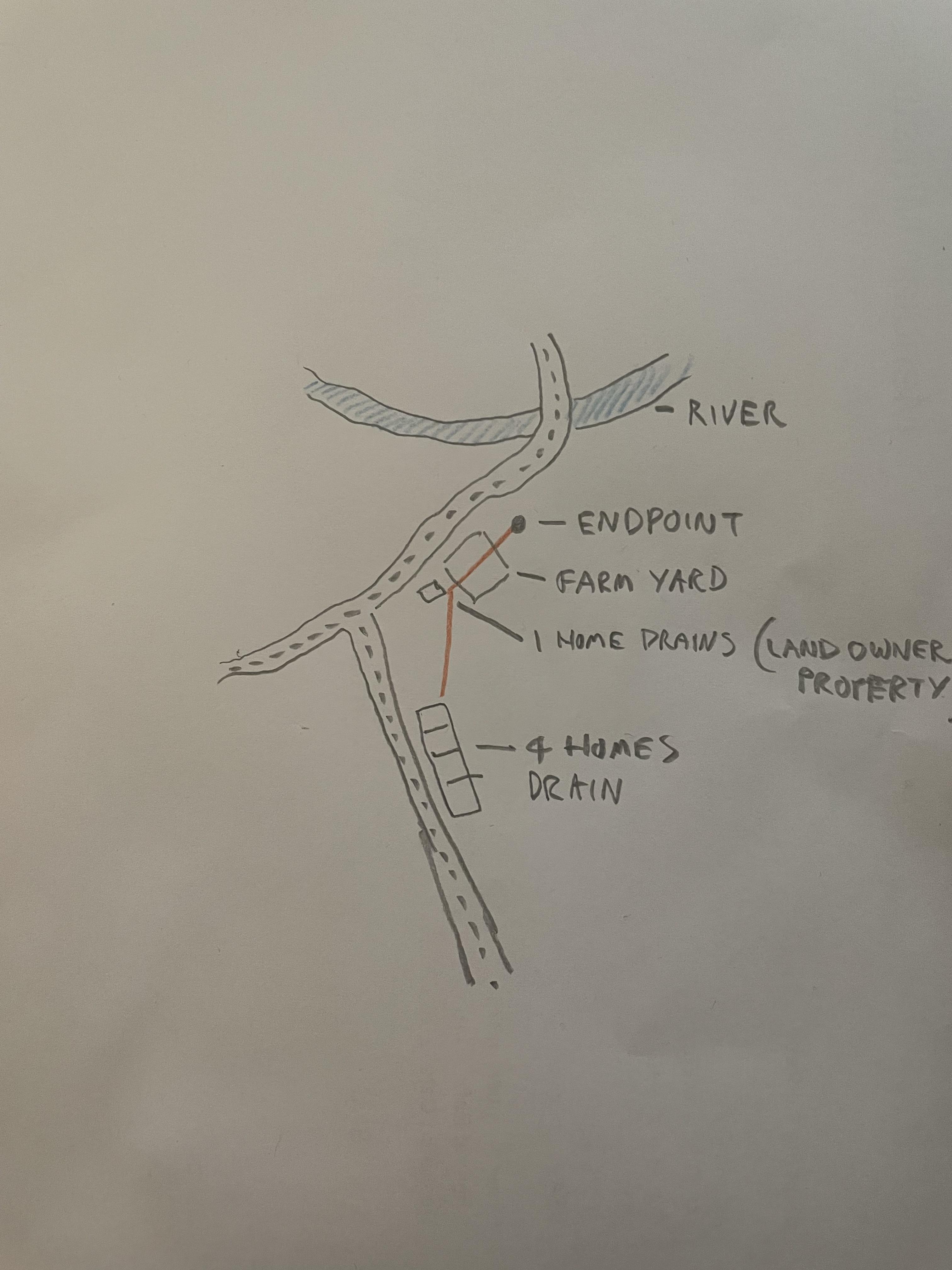

ToughButterCup Posted March 29, 2023 Posted March 29, 2023 On 29/03/2023 at 08:37, Losingsleepoverdrainage said: .... Will try and send over a map this morning. Expand Happy to help annonomise the graphic if that helps. PM me and attach the graphic if you like. ... I'm bored as hell recovering from a hip operation at the moment, so I've got time on my hands .....

Losingsleepoverdrainage Posted March 29, 2023 Author Posted March 29, 2023 On 29/03/2023 at 09:07, Kelvin said: Where did you think the pipe terminated when you bought the house and what difference would that have made to your problem if it did? Expand We thought (had a doc to demonstrate amongst deeds and paperwork) it drained to a soakaway on the farm below us. Neighbours under this impression too. And we only discovered last week that the 4th house on our row was connected to our pipe, they were not aware of this. Our homes are converted from an old barn of the farm, which has since been purchased by the estate. No way of tracking down who fitted the drainage for all properties now, and I’d imagine they would own up to nothing. To clarify, we purchased our house at end of Dec 2019. I mentioned 2 years ago earlier in thread, it feels like 2 (we all lost a year or two somewhere) but was in fact 3 so pre new binding rules, but would still have been on radar of solicitors/estate agents etc. We should have had a drainage survey at the time, I know that.
Losingsleepoverdrainage Posted March 29, 2023 Author Posted March 29, 2023 On 29/03/2023 at 08:59, ToughButterCup said: Happy to help annonomise the graphic if that helps. PM me and attach the graphic if you like. ... I'm bored as hell recovering from a hip operation at the moment, so I've got time on my hands ..... Expand Oh thank you, but Mr has managed to draft one up. Feel better soon! 1

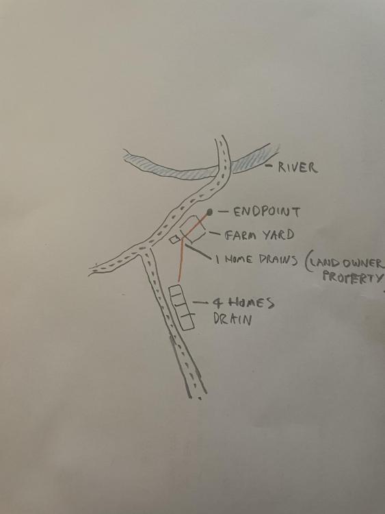

Losingsleepoverdrainage Posted March 29, 2023 Author Posted March 29, 2023 Not sure if this is any more clear

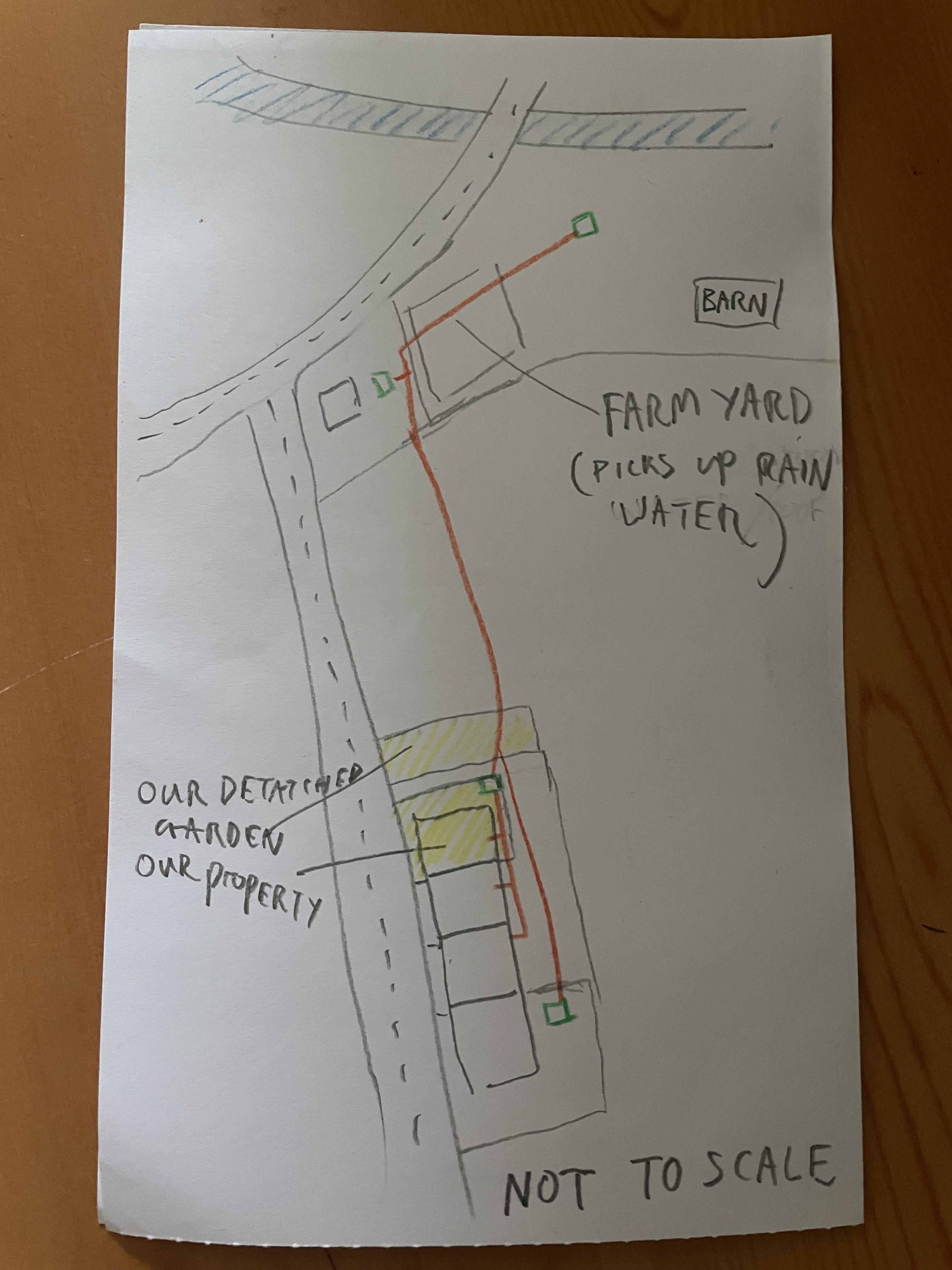

ProDave Posted March 29, 2023 Posted March 29, 2023 Looking at that pipe, my guess is initially a drainage field was installed, which proved inadequate and the land became a swamp, so some enterprising chap extended it to run out onto a bit of rough ground nobody ever goes near and it would be alraight. but your drain surveyor has found him out. Can you re do the sketch in more detail showing the in and out connections to each treatment plant or septic tank please? Who owns the land immediately behind your houses? Is is the same land owner? Or someone else who might be more reasonable?
Temp Posted March 29, 2023 Posted March 29, 2023 You said there is no ditch by the road but are there any surface water drains along/in the edge of the road? Frequently in the past old ditches had pipes dropped in them and filled in when the road was widened (so called piped ditch). On 29/03/2023 at 12:36, Losingsleepoverdrainage said: We’ve now had a conversation this morning with the land manager, where he threatened to chuck a bucket of concrete down our end of the pipe and cut us off! He claims we have no right to drain across the field towards the farm. We do. Nice chap! So much drama! Expand I think time to discuss your rights with your solicitor or a firm that specialises in drainage rights. Does he own the land all the way to the river? If you can prove to him you have a right to discharge he might be more amenable to allowing the pipe to be extended to the river.

Losingsleepoverdrainage Posted March 29, 2023 Author Posted March 29, 2023 On 29/03/2023 at 13:45, ProDave said: Looking at that pipe, my guess is initially a drainage field was installed, which proved inadequate and the land became a swamp, so some enterprising chap extended it to run out onto a bit of rough ground nobody ever goes near and it would be alraight. but your drain surveyor has found him out. Can you re do the sketch in more detail showing the in and out connections to each treatment plant or septic tank please? Who owns the land immediately behind your houses? Is is the same land owner? Or someone else who might be more reasonable? Expand Yes I agree, although I think it’s been shortened rather than extended. Another neighbour (not connected to issue) remembers in last 30 years seeing water draining onto the road from further down the site, on the reg. Suspects the old farm manager cut it, as it suddenly stopped one day. See sketch. End point is pipe connected to a tank. Not a septic tank, but likely an old slurry tank from farm yard above. No longer serving original purpose though, just a chamber as far as we know. It has a corrugated roof just covered in soil, under an access track to the field beyond. And yep, land owner owns everything around us. Many thanks

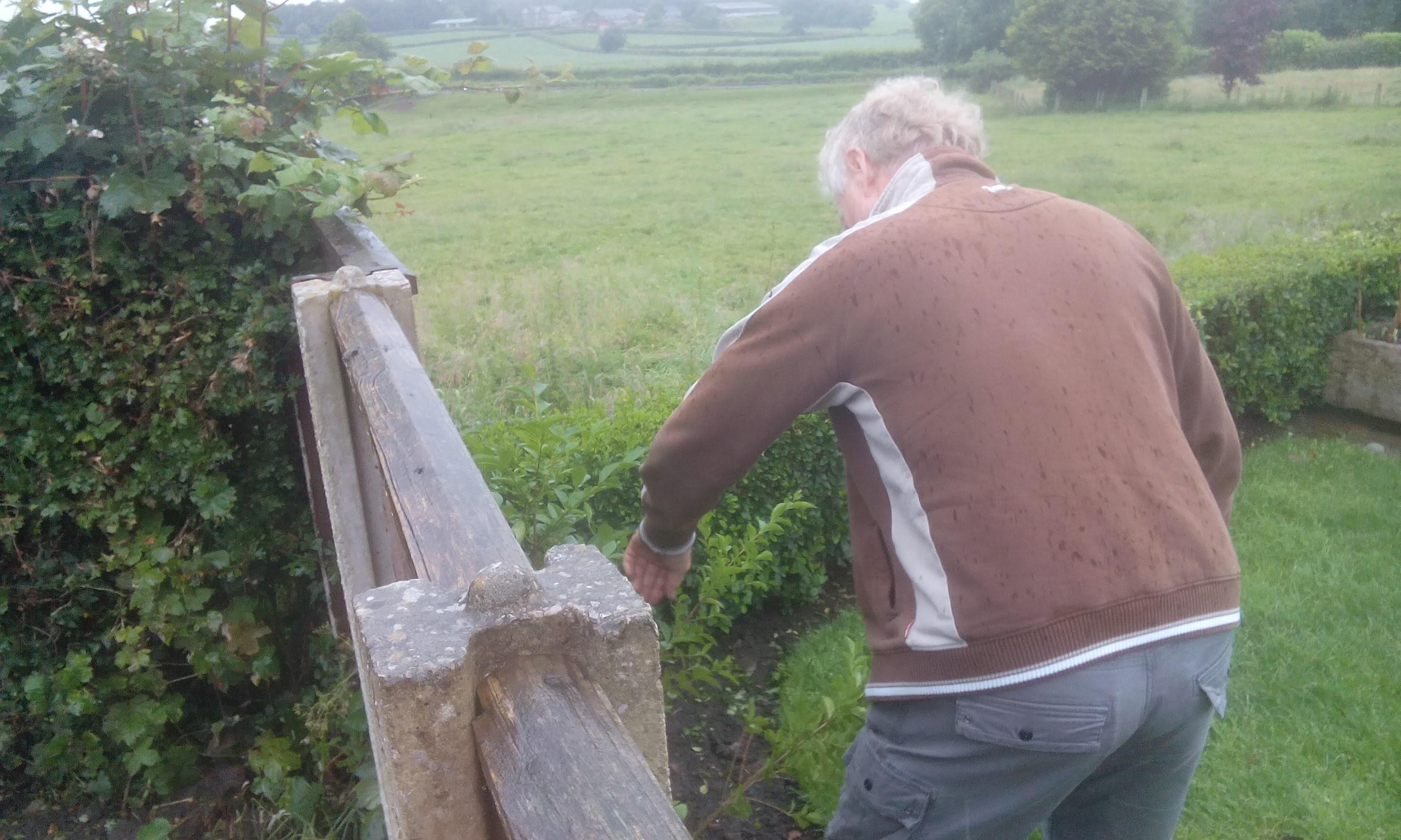

ToughButterCup Posted March 29, 2023 Posted March 29, 2023 (edited) You are not alone in suffering unreasonable and threatening behaviour where soft and smelly stuff is concerned. Here's my neighbour cutting off (by nailing the gate shut) access to our Skeptic Tank when he heard we had gained Planning Permission. I can't be sure, but I think I remember that I might have reversed the nailing process with the bucket on my digger. Surprisingly easy to make mistakes like that I am told. From that day to this, we've not paid a penny towards pumping the tank . Saved £400. That makes it about £10 per nail. Edited March 29, 2023 by ToughButterCup
