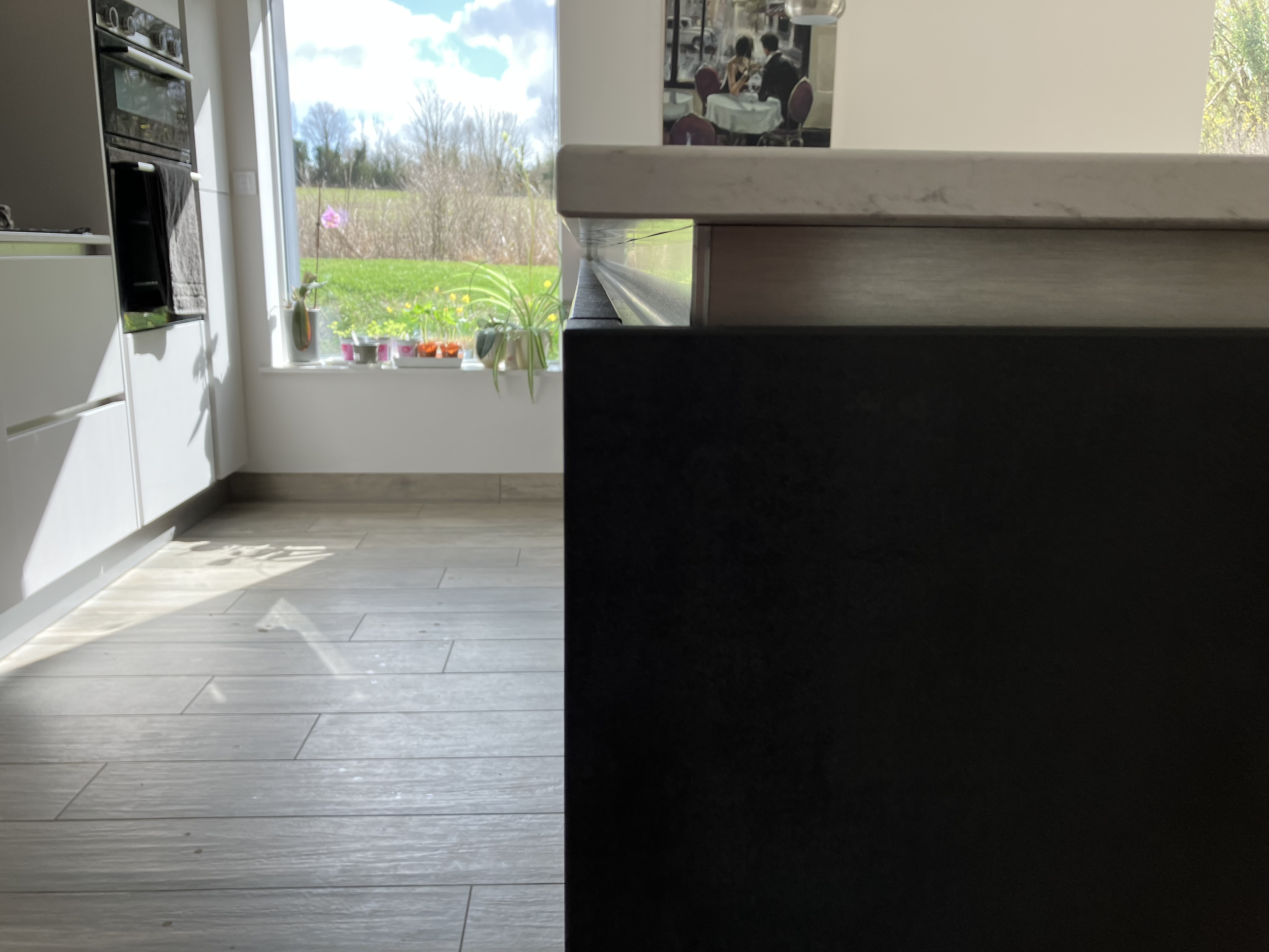

revelation Posted March 25, 2023 Author Share Posted March 25, 2023 5 hours ago, Elton said: I sort of agree with don't sweat the small stuff and be happy with what you have. But I template kitchen tops every day and if the doors are fitted straight i would have done 2-3mm overhang. Max 10mm if doors are a bit out but never 20mm on handle less. However that profile gives a lot of room to get your fingers in so I'm sure you will get used to it and not notice If it has been up to 5mm I don't think I would be so bothered, but 20mm is a lot. Link to comment Share on other sites More sharing options...
AliG Posted March 25, 2023 Share Posted March 25, 2023 I just checked ours, it overhangs by 2-3mm. If a large amount of liquid is spilled 90% of it goes down the front/onto the floor. 20mm is surely going to result in scraped knuckles. Putting handles on a handleless kitchen is a non starter. I would be asking for a new worktop. I guess the argument comes in to whether you were told/asked about the overhang, was it shown on drawings you signed off etc? I think that is a laminate worktop, so presumably they cannot cut it down. Link to comment Share on other sites More sharing options...
Gone West Posted March 25, 2023 Share Posted March 25, 2023 On 23/03/2023 at 02:01, revelation said: Aesthetically I think the worktop looks better flush. I agree. 7 hours ago, revelation said: I am inclined to bite the bullet and get a new worktop that is the exact right dimension. If it really bugs you, then change it, is my view on things. I was told everything had to be flush. Link to comment Share on other sites More sharing options...
Russdl Posted March 25, 2023 Share Posted March 25, 2023 @revelation your kitchen is spookily similar to ours. Our worktop is as near as damn it flush. If it bugs you it’ll probably bug you forever but I guess you could live with it for a while and see if it does actually bug you? Link to comment Share on other sites More sharing options...
Dan F Posted March 25, 2023 Share Posted March 25, 2023 16 hours ago, AliG said: I just checked ours, it overhangs by 2-3mm. If a large amount of liquid is spilled 90% of it goes down the front/onto the floor. 20mm is surely going to result in scraped knuckles. Putting handles on a handleless kitchen is a non starter. I would be asking for a new worktop. I guess the argument comes in to whether you were told/asked about the overhang, was it shown on drawings you signed off etc? I think that is a laminate worktop, so presumably they cannot cut it down. Ours is also only a couple of mm at most, very similar to @Russdl. Any more than this with a handleless kitchen and finger access becomes a problem IMO. So, unless 20mm was explicitly discussed and/or drawn and signed off I'd be going back to them. Aesthetically I agree with others it's only a minor detail in the grand scheme of things, but if using the kitchen is going to be a pain for years to come, or if you are going to need to add handles to a handleless kitchen to make it usable.. that is a significant issue. 1 Link to comment Share on other sites More sharing options...
Lofty718 Posted March 29, 2023 Share Posted March 29, 2023 Beautiful kitchen, why don't the units closest to the garden go right to the wall? My worktop has a smaller overhang, it seems quite large. Who templated it? kitchen company? I doubt you need a whole new worktop, they can probably remove it, cut and refit. Link to comment Share on other sites More sharing options...
Lofty718 Posted March 29, 2023 Share Posted March 29, 2023 On 25/03/2023 at 08:40, Gone West said: I agree. If it really bugs you, then change it, is my view on things. I was told everything had to be flush. Your kitchen is not a true handleless one, but a j-pull one. So it's a bit different and you can have the worktop flush like that Link to comment Share on other sites More sharing options...
Dan F Posted March 29, 2023 Share Posted March 29, 2023 (edited) 47 minutes ago, JoeyF said: Your kitchen is not a true handleless one, but a j-pull one. So it's a bit different and you can have the worktop flush like that No/minimal overhang (for fingers to get in and able to pull doors) is more important with handleless than with j-pull Edited March 29, 2023 by Dan F Link to comment Share on other sites More sharing options...
revelation Posted April 2, 2023 Author Share Posted April 2, 2023 On 29/03/2023 at 19:15, JoeyF said: Beautiful kitchen, why don't the units closest to the garden go right to the wall? My worktop has a smaller overhang, it seems quite large. Who templated it? kitchen company? I doubt you need a whole new worktop, they can probably remove it, cut and refit. Well noticed, We have some curtains which will hang from a ceiling track, during the day we wanted the curtains tucked back out of the way of the doors. The kitchen company designed and supplied the worktop, it is a compressed laminate top so has been factory cut and edged, so could probably be done but would have to go back to the factory and then be done there. Link to comment Share on other sites More sharing options...
