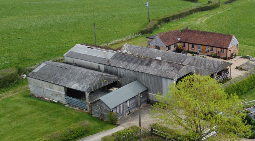

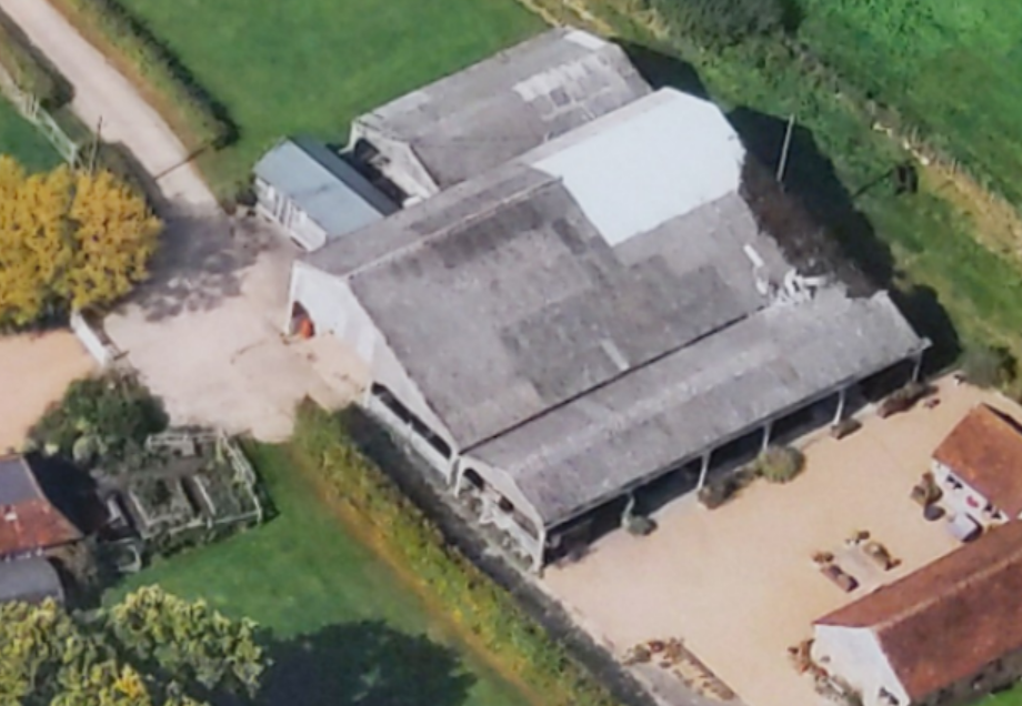

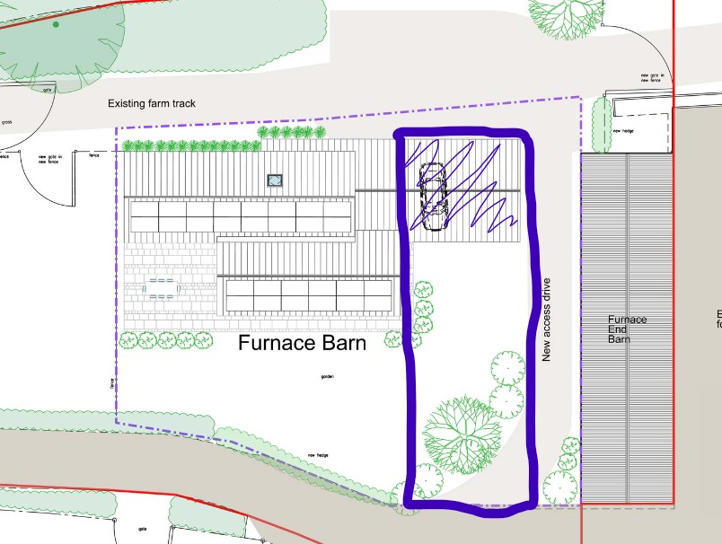

Furnace Posted March 22, 2023 Posted March 22, 2023 Any suggestions about ways to deal with this after all the sheeting has been removed? I'm considering: dismantling of roof trusses and purlins, posts to be cut off at ground level for potential giveway if collected. dismantling intact and arranging for them to be taken away. crushing on site for possible build use or sale as clean hardcore. Any thoughts?

saveasteading Posted March 22, 2023 Posted March 22, 2023 Ok something i know about. The asbestos cement has to be removed and disposed of with a certificate. You can diy this but i suggest you don't, as a demo company will be very efficient. Shouldnt say demo, as it is dismantling. Then the frames. There is a market for concrete frames. They are cut off at ground level so gradually get smaller, farm by farm. Allow for them getting taken apart for zero. But if you will need hardcore then the best plan is to crush on site as in the video above. The machine looks like a dinosaur. Just insist that it is crushed again to ensure usefully small pieces. The demo people will take the tangled steel away. It is such a spaghetti mess that there is more air than steel. In summary, a demo company to do the whole job. One price to take away and another to keep the hardcore. The foundations are still there. Either the groundworker takes them out or you try to integrate them.

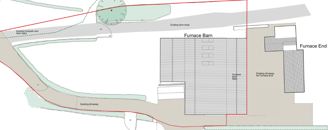

saveasteading Posted March 23, 2023 Posted March 23, 2023 8 minutes ago, Furnace said: , my 3 tonne digger won't be up to the job. I'm not sure it would even lift the bucket. It will be a very big machine. Handy all round as it can reach high and far to lift or break out the rafters...then squash them. I don't have names for you. Knock up an email to describe the project, including timing. Make it clear you are an individual not a business. With an informal email you can circulate to loads of demo companies without wasting their time, some of which will show interest. Not just local, include medway where the heavy work happens, and Sussex because it is not Sevenoaks. If I remember properly you have to make or extend a driveway. This hardcore will suit being on the bottom. Are you building new on the footprint?
Furnace Posted March 23, 2023 Author Posted March 23, 2023 11 minutes ago, saveasteading said: Are you building new on the footprint? Overlapping the existing footprint Depending on levels I'm thinking there will be need for hardcore, and clean hardcore from the crushing would be better than bought-in stuff.

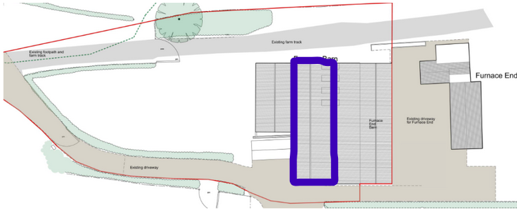

saveasteading Posted March 23, 2023 Posted March 23, 2023 It won't be necessarily better (than expensive sub-base) but it will be clean, and you must get it down to a size.. You will certainly need some bed under the new area of slab. Are you retained the existing slab assuming there is one, or breaking out and replacing,?
Furnace Posted March 23, 2023 Author Posted March 23, 2023 (edited) 1 hour ago, saveasteading said: Are you retained the existing slab assuming there is one, or breaking out and replacing,? It depends on final levels, but the existing slab is only present in the blue bordered area so will only be beneath the garage, not the main gaff. Realistically, I think most of it will be broken up. Edited March 23, 2023 by Furnace muppetry

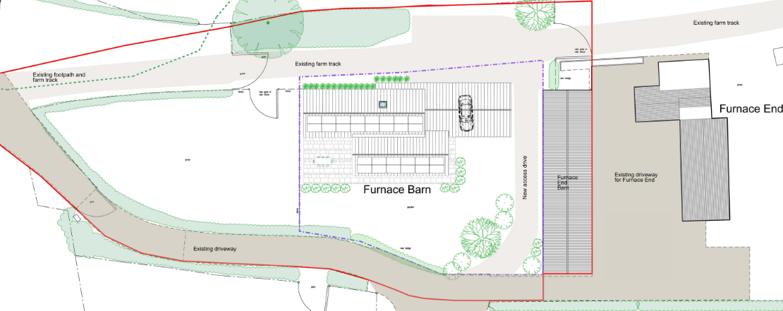

saveasteading Posted March 23, 2023 Posted March 23, 2023 43 minutes ago, Furnace said: , I think most of it will be broken up If it is too high to build above then it has to go, and join the crushed pile, then can go back down again in the new construction. If it can be built on, and high is good in houses esp with any flood risk, then it can probably stay instead of, or as well as, sub base. Too often they are broken out pointlessly.
Furnace Posted March 23, 2023 Author Posted March 23, 2023 The carport/garage will be well above the existing slab, so that can stay but most of the rest is where garden is proposed so will be broken and reused elsewhere. 4 hours ago, saveasteading said: Knock up an email to describe the project, including timing. Make it clear you are an individual not a business. With an informal email you can circulate to loads of demo companies without wasting their time, some of which will show interest I've got two companies visiting on Wednesday to give quotes. 👍

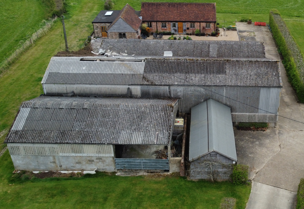

Furnace Posted March 23, 2023 Author Posted March 23, 2023 I really don't know how much it'll be. I think it's quite possible that a pukka no hassle job could well be £40k, but a DIY job with my neighbouring farmer, and a telehandler could be less than half that. I got an Asbestos 'removal disposal only' quote for about £16/m2. There's about 400m2 of sheeting...

Furnace Posted March 28, 2023 Author Posted March 28, 2023 First set of quotes are in and (rarely for this locale) don't appear to be outrageous. To remove and dispose of 400m2 of asbestos sheeting, including scissor lift hire: £5,375 + VAT (Online quote from photos and dimensions I provided). To demolish and crush (leaving crushed concrete on site) concrete posts , rafters, lintels and some concrete blocks. Rebar removed from site: £7,950+ VAT I've got another firm visiting to quote tomorrow.
