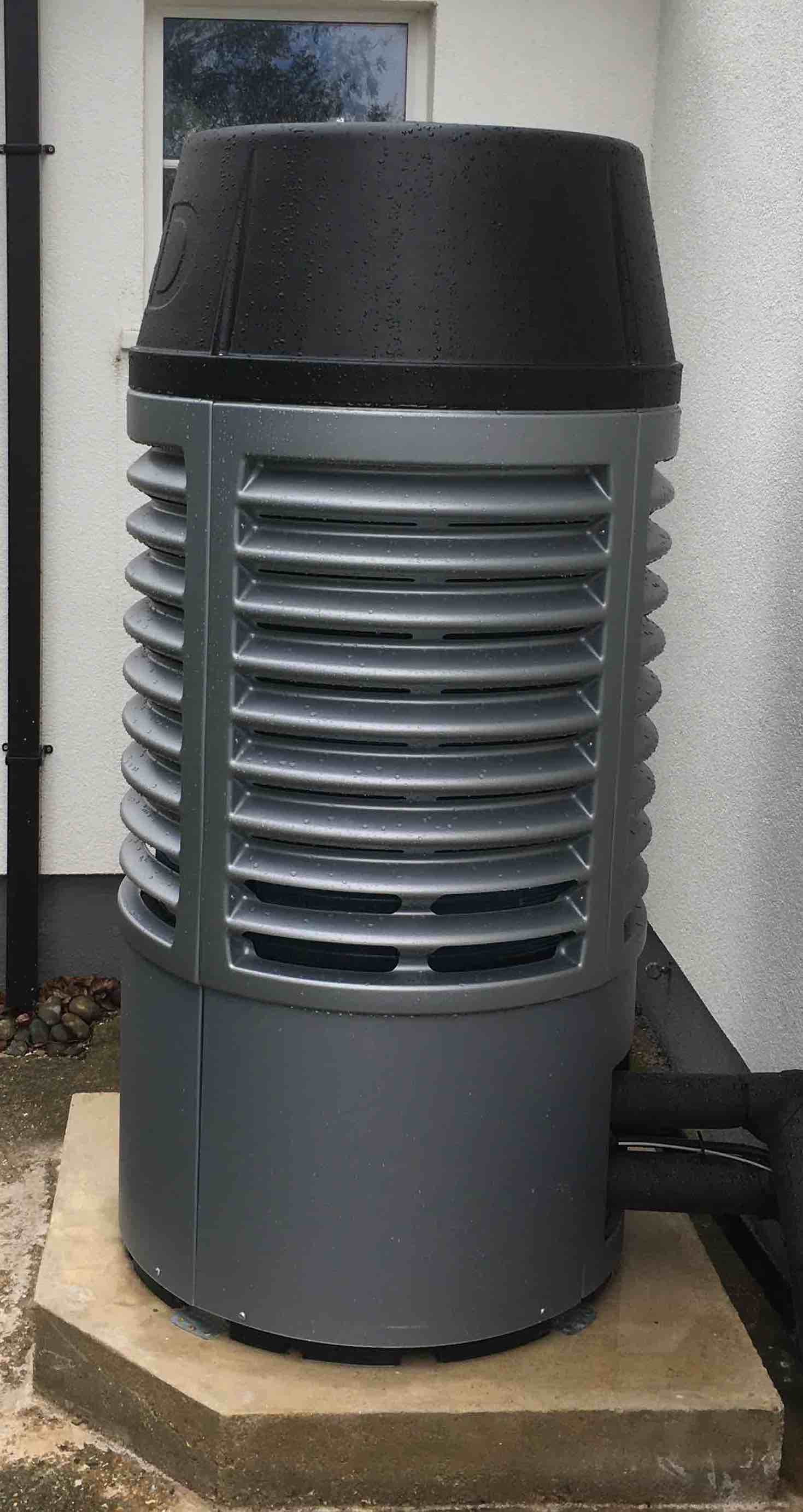

Garald Posted March 22, 2023 Share Posted March 22, 2023 The heat-pump from Mitsubishi has been installed - and guess what: the contractor tells me that noise is a non-issue. Hurray for Mitsubishi Ecodan Silence! ... but the wind from the machine (which would be very cold in the worst of winter) will blow right in the face of some of the neighbors as they go out of their front door. (Yes, this was the least bad place to put it.) I don't think Paris regulators remembered to forbid this (they just set strict noise limits), but obviously I don't want to be an arse. How to solve this? It would seem simpler, cheaper, more aesthetic and probably also more effective to set up some sort of solid fence or barrier (possibly homemade) rather than a sound-reducing capsule (which is meant for a different problem, is expensive, might decrease efficiency by a not completely trivial amount, and may not change the direction of the "wind" at all). Is this right? If so, at what distance should it be so as not to interfere with the operation? PS. Answers to my previous question are also appreciated: Link to comment Share on other sites More sharing options...

ProDave Posted March 22, 2023 Share Posted March 22, 2023 I assume the open door in the picture is yours? Rotate the ASHP 90 degrees so it blows along the passage not across it. It would blow the cold air past your front door not your neighbours. Putting screens in front of them is very bad, on another thread recently someone posted a you tube clip of an experiment to box one in, and it ended up recirculating it's own air and choking itself. 1 Link to comment Share on other sites More sharing options...

JohnMo Posted March 22, 2023 Share Posted March 22, 2023 (edited) If you install a screen, do angled (say 45 deg) vertical slats to turn the flow down the passageway, or horizontally to throw the air upwards. Edited March 22, 2023 by JohnMo Spelling Link to comment Share on other sites More sharing options...

ProDave Posted March 22, 2023 Share Posted March 22, 2023 7 minutes ago, Garald said: But the result shown in the video is that a fence doesn't bring efficiency down perceptibly, even though one can see smoke recirculating! I suspect what it will do, is at temperatures close to the dew point, is increase icing up as the recirculated air will be colder, and increase defrosting frequency, and hence reduce efficiency that way. I still favour rotating the unit 90 degrees so the cold air gets blown past your door not across to your neigbour. Link to comment Share on other sites More sharing options...
Garald Posted March 22, 2023 Author Share Posted March 22, 2023 17 minutes ago, ProDave said: I still favour rotating the unit 90 degrees so the cold air gets blown past your door not across to your neigbour. Right, this seems so evident that I wonder why it wasn't done. I was trying to get to my head contractor today, without success. Of course he'll hate me when I suggest this, since apparently he stayed up until 9:30pm working on this with the heat-pump installer (that's a late hour for non-academics, or so I am told). Link to comment Share on other sites More sharing options...
