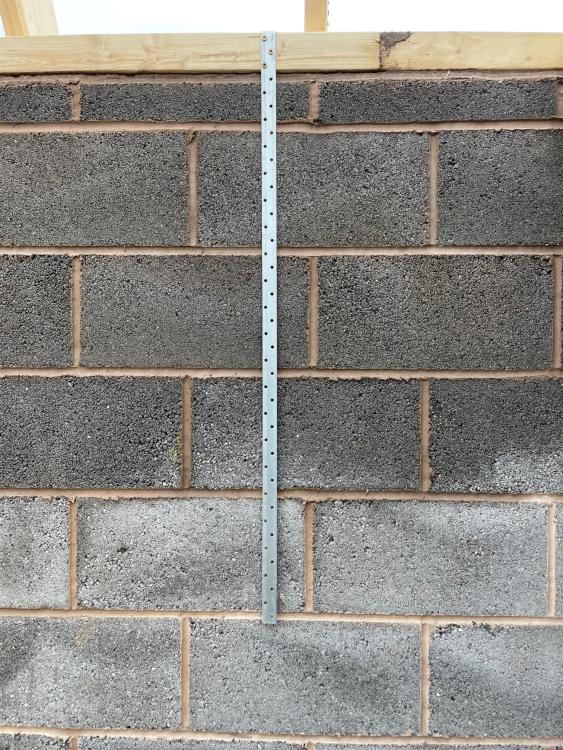

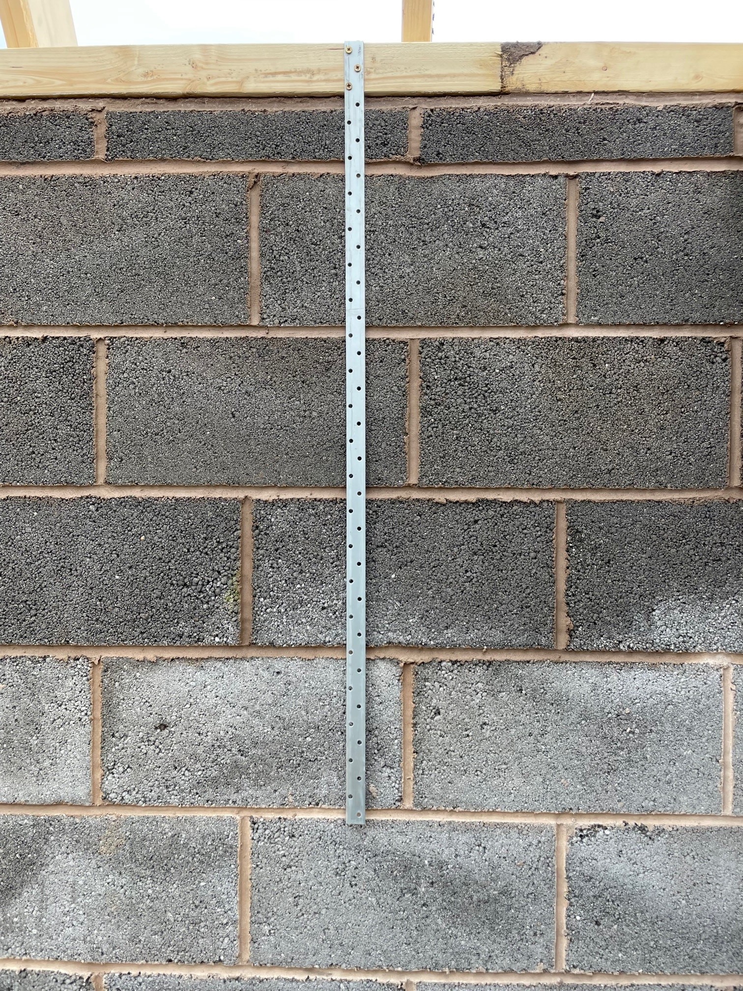

richo106 Posted March 20, 2023 Share Posted March 20, 2023 Hi All I have got the fix the wall plate restraint straps to the fibolite blocks on my build Speaking to my builder they normally use 50mm screws (5mm) with brown plugs They said one per block is sufficient, so in this case 5 (attached pic) Is this OK? Is there better screws to use? etc Any advice welcome Link to comment Share on other sites More sharing options...
Rob99 Posted March 20, 2023 Share Posted March 20, 2023 My builder used concrete screws - these https://www.screwfix.com/p/easydrive-tx-countersunk-concrete-screws-7-5-x-60mm-100-pack/3313h Link to comment Share on other sites More sharing options...
joe90 Posted March 20, 2023 Share Posted March 20, 2023 Either will do in my opinion. Link to comment Share on other sites More sharing options...
Mr Punter Posted March 20, 2023 Share Posted March 20, 2023 Yes 50mm 5s are fine, as is one per block. Wall plate would have been better half lapped but it is done now. 1 Link to comment Share on other sites More sharing options...
nod Posted March 20, 2023 Share Posted March 20, 2023 1 hour ago, Mr Punter said: Yes 50mm 5s are fine, as is one per block. Wall plate would have been better half lapped but it is done now. Good point BC will pick that up also Link to comment Share on other sites More sharing options...
PeterW Posted March 20, 2023 Share Posted March 20, 2023 Pan head 80mm concrete screws drilled with a 5.5mm drill bit. Depends on the blocks you can sometimes drop to a 5mm bit as the screws bite better Link to comment Share on other sites More sharing options...
richo106 Posted March 20, 2023 Author Share Posted March 20, 2023 7 hours ago, Mr Punter said: Yes 50mm 5s are fine, as is one per block. Wall plate would have been better half lapped but it is done now. What do you mean by half lapped? Many Thanks Link to comment Share on other sites More sharing options...
Canski Posted March 20, 2023 Share Posted March 20, 2023 46 minutes ago, richo106 said: What do you mean by half lapped? Many Thanks They mean that the wall plate should have had a halving joint in it and not have 2 pieces butted up to each other. Link to comment Share on other sites More sharing options...
