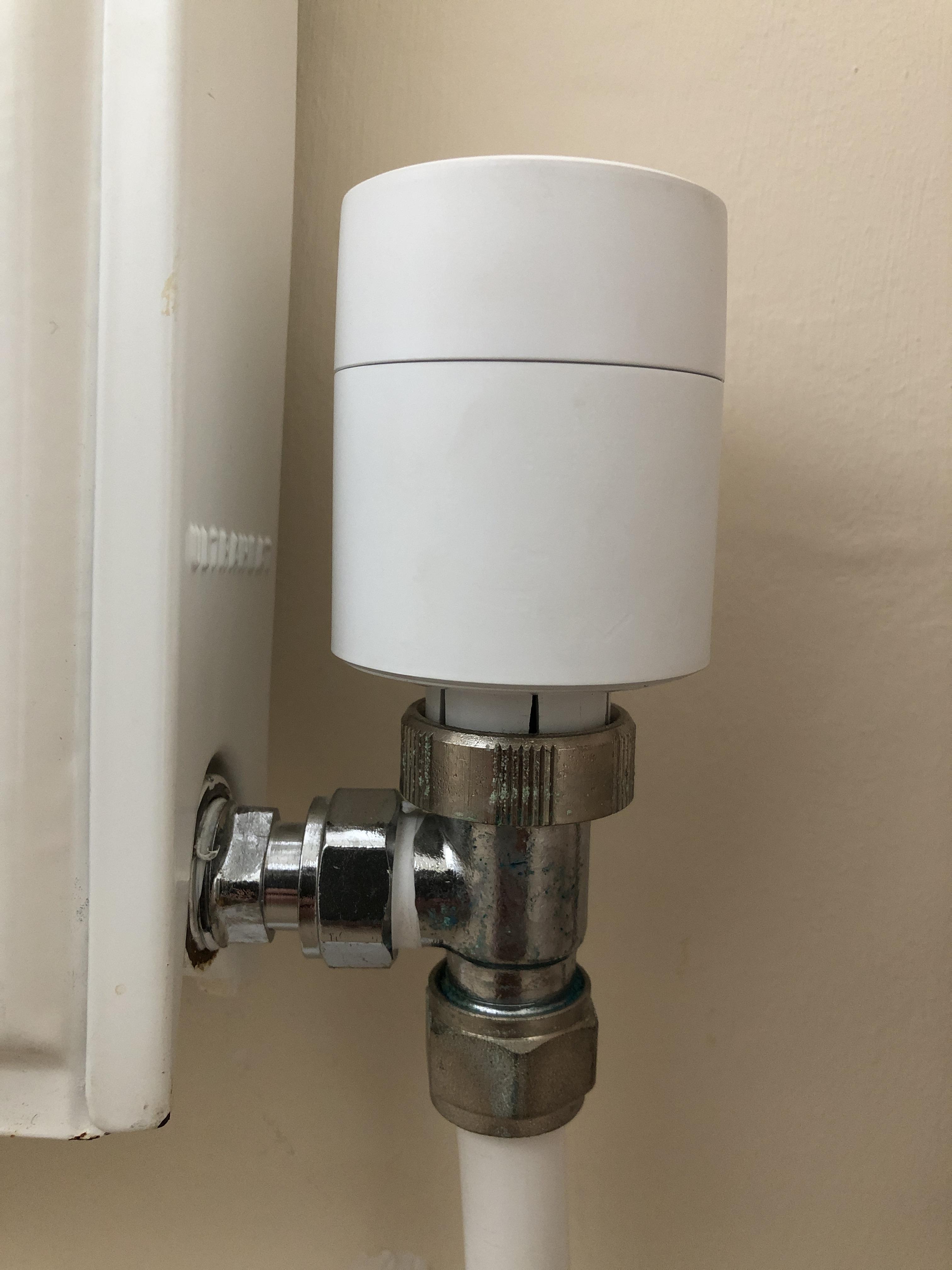

MikeGrahamT21 Posted March 17, 2023 Posted March 17, 2023 (edited) Or alternatively do what I did, and stick an appropriate euro cone in a standard TRV and Lockshield, and have the 16mm MLCP straight into the radiator, no connectors needed. Let me know if you want any photos, and I can get some. As for laying MLCP in concrete, i can't see an issue, pretty much what they were designed for. Edited March 17, 2023 by MikeGrahamT21 2
Fallingditch Posted March 18, 2023 Author Posted March 18, 2023 21 hours ago, MikeGrahamT21 said: Let me know if you want any photos, and I can get some. That would be a good idea. They were discussed in the Plastic vs Copper thread, but I didnt see any images of what their final appearnce is ... how do they compare to (eg) sheathed 15mm plastic? (The room has an original victorian panelled bay window, so I am planning on installing two 600 x 400 x 160 T3 ultraheat convector radiators either side of the bay, so they are as unobtrusive as possible. Getting neat F&R pipes rising to them is also pretty important).
MikeGrahamT21 Posted March 18, 2023 Posted March 18, 2023 3 hours ago, Fallingditch said: That would be a good idea. They were discussed in the Plastic vs Copper thread, but I didnt see any images of what their final appearnce is ... how do they compare to (eg) sheathed 15mm plastic? (The room has an original victorian panelled bay window, so I am planning on installing two 600 x 400 x 160 T3 ultraheat convector radiators either side of the bay, so they are as unobtrusive as possible. Getting neat F&R pipes rising to them is also pretty important). they end up looking like this… this is a standard 15mm TRV with a Tado smart radiator stat and 16mm MLCP pipe going into a 16mm eurocone. The only discernible difference is the compression nut is slight larger as you can see vs the standard ones for 15mm
