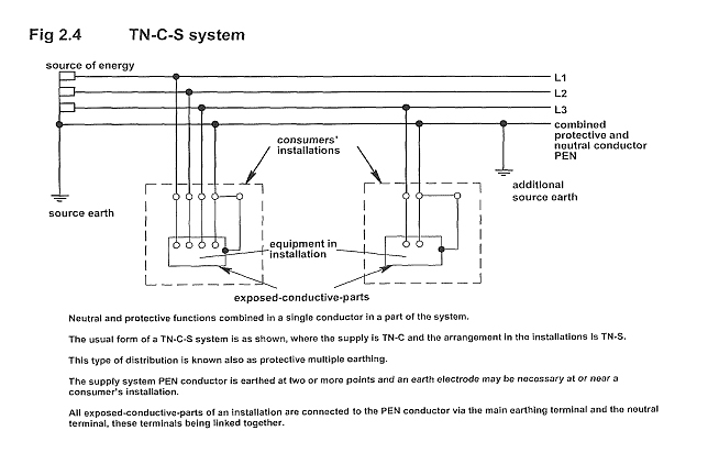

Russell griffiths Posted July 29, 2017 Author Posted July 29, 2017 How is this earthed. Does an earth have to run back to the main switch by the meter? Oris it earthed to a ground spike by the new house by the cu. if it runs back to the main switch by the meter do I run a separate single earth or is the earth combined in the swa. Not the outer steel protection as I know this is not a recommended method any more.
Jeremy Harris Posted July 29, 2017 Posted July 29, 2017 On 29/07/2017 at 10:41, Nickfromwales said: What about 35mm 4-core and have a second phase too? Any advantage to that ? Expand 4 core could give three phase at the house, as you may not want to export the PE down the cable, so could TT it at the house end (should be no problem getting a good earth given the lakes around). 35mm² would restrict the current to around 90A per phase, to stay within the 5% voltage drop limit, and that would be masses of power. One phase could be used to run the house (90A is more than enough - I have our main supply fused at 80A), and another phase could be used to feed the garage/workshop, if need be. If you think that the total single phase load will always be under about 90A, then you could just run a 35mm² single phase cable. In practice this would be fine at the full 100A, as although the peak voltage drop would just exceed 5% (5.5% at 100A), in practice it's very unlikely that you would ever draw 100A.
Jeremy Harris Posted July 29, 2017 Posted July 29, 2017 On 29/07/2017 at 10:58, Russell griffiths said: How is this earthed. Does an earth have to run back to the main switch by the meter? Oris it earthed to a ground spike by the new house by the cu. if it runs back to the main switch by the meter do I run a separate single earth or is the earth combined in the swa. Not the outer steel protection as I know this is not a recommended method any more. Expand You can either export the earth down the 100m cable (might well mean increasing the cable size to get the loop impedance down) or you could just use an earth rod at the house end and have a TT installation. I'd do the latter, as you'll get a very good earth with those lakes around. It's cheaper, too, as for single phase you could run two core SWA, rather than 3 core. 1

ProDave Posted July 29, 2017 Posted July 29, 2017 I would not rely on just the DNO's earth over that distance. I would probably still connect to it and add my own local rod(s) making it a true Protective MULTIPLE Earth
Nickfromwales Posted July 29, 2017 Posted July 29, 2017 Aren't you better off with just a rod at that stage so you can't get two separate earths at two different potentials? ( Didnt Harold mention this in one of his rants? )
ProDave Posted July 29, 2017 Posted July 29, 2017 That is debatable and some have very strong opinions. If you just rod it and use a TT earth, then your earth impedance will never be as low as a PME earth. However I would never just export a PME earth that distance. By adding a local rod, you are reinforcing the concept of the multiple earthing. A true PME is earthed at many places along it's route though no doubt the DNO stick a PME sticker on any TNCS supply even if there is no multiple earthing (PME is always TNCS, but TNCS is not always PME) This is exactly what I have done for my house, even though my distance is about 20 metres. (my static caravan is on it's own TT earth as the regs prohibit connecting a caravan to a PME earth)
Jeremy Harris Posted July 29, 2017 Posted July 29, 2017 (edited) On 29/07/2017 at 14:23, Nickfromwales said: Aren't you better off with just a rod at that stage so you can't get two separate earths at two different potentials? ( Didnt Harold mention this in one of his rants? ) Expand Yes, there was indeed a rant at me over a typo related to exactly this. I chose to keep my workshop PE separate from the incoming exported earth, which is a strict interpretation of the regs. There's nothing in the regs I'm aware of that specifically says you can't add a supplemental earth, making, as Dave says, a true PME installation. This is just an extension of the local LV distribution network topology, that has a number of intermediate earth connections along the length of the supply cables, in order to ensure that the earth impedance at the consumer end is always low. If you want to stay strictly within a defined scheme, and not cause too much angst with whoever is signing it off, then it's probably better to just consider the consumer end of the long cable as not providing a PE, and using a standard TT earthing arrangement. That will be understood well by whoever is signing things off if they get a bit pedantic. There's no good reason why you can't just do exactly as Dave suggests though, as although unusual it is safe. Edited July 29, 2017 by JSHarris

Russell griffiths Posted July 29, 2017 Author Posted July 29, 2017 (edited) So are we sort of saying you have an Earth that runs all the way from the meter aprox 100m but also have a spike local to the cu as belt and braces type of thing. If this earth runs from the meter box is it a separate single to the swa or is it contained within the swa hope that makes sense. Any thoughts on depth this new cable should be at. Minimum depth required to avoid finding other services. So what is a TT earth and what is PME. Edited July 29, 2017 by Russell griffiths Forgot a bit.
Onoff Posted July 29, 2017 Posted July 29, 2017 (edited) On 29/07/2017 at 15:14, Russell griffiths said: So are we sort of saying you have an Earth that runs all the way from the meter aprox 100m but also have a spike local to the cu as belt and braces type of thing. If this earth runs from the meter box is it a separate single to the swa or is it contained within the swa hope that makes sense. Any thoughts on depth this new cable should be at. Minimum depth required to avoid finding other services. So what is a TT earth and what is PME. Expand Start here: http://electrical.theiet.org/wiring-matters/16/earthing-questions.cfm?type=pdf EDIT: Link old but good pics, same as in the current AMD3 On Site Guide I have here.....and I can't really scan that! Edited July 29, 2017 by Onoff 1
