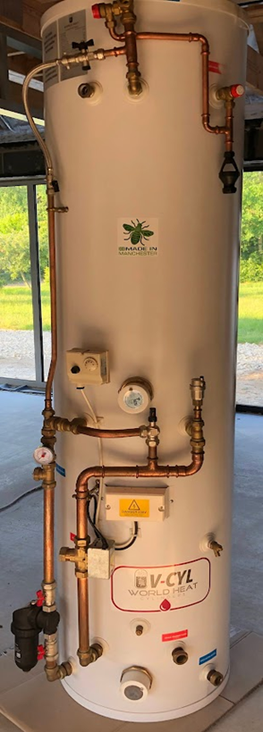

crispy_wafer Posted March 16, 2023 Author Posted March 16, 2023 (edited) Todays addition to party was a grant 250l pre plumbed cylinder, should be with us next week. I figured this would be a wise choice for us. Got a plumber lined up for some evenings and weekend work to help with the install. Edited March 16, 2023 by crispy_wafer
crispy_wafer Posted May 15, 2023 Author Posted May 15, 2023 Just updating as i've gone quiet on this lately, slowly accumulating parts for the install A couple of retailers have failed on the pre plumbed cylinder that I wanted, think there must have been supply chain issues, so have bought a 250l unit off ebay, as link listed in the marketplace. Costs so far. Grant 6kW Heatpump - 1280 Rubber Feet - 40 WH 250L Cylinder - 740 Primary pipework, press fit levers, press elbows, T's etc, caleffi antifreeze valves, pipe insulation, flexible pipes - 400(ish) Grant buffer/llh - 325 Grant wiring centre ep001 - 40 Grant Hot water boost kit - 70 Mag Filter - 100 Waiting for the cylinder to turn up now, so what's needed re: expansion/filling etc.

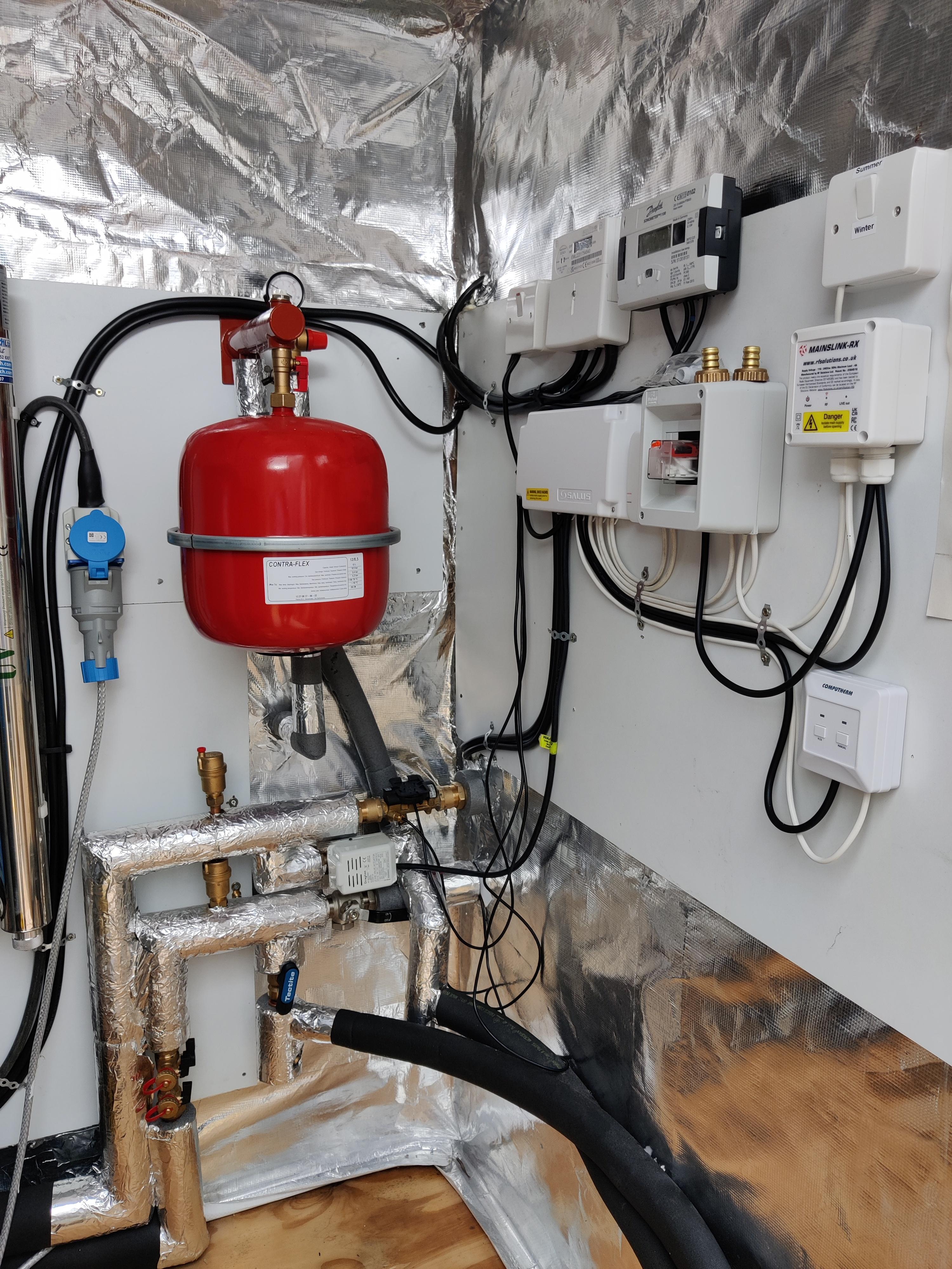

JohnMo Posted May 15, 2023 Posted May 15, 2023 For a filler I used the brass assembly at the bottom of the silver vertical pipes. Fill and Flush Valve - 28mm from BES about £55. Worked well. For expansion you need to check if one is already installed in the ASHP, but possibly not. So you will to size based on system capacity. I used an arm coming out of the wall, which had all the control stuff and bleed already included. Flamco - Contra-Flex Heating Expansion Vessel 12 Litre FCST 012 Tesla T-BAR Expansion Vessel Fixing Bar Kit (T-BARKIT) from unvented components £60 delivered for both. For the 3 way diverter I used eBay, plenty of good deals on there. 1
Jenki Posted May 15, 2023 Posted May 15, 2023 (edited) 9 hours ago, crispy_wafer said: Waiting for the cylinder to turn up now, so what's needed re: expansion/filling etc. @crispy_waferMy tank came with the expansion vessel, although he didn't think it did. So although I've not unpacked it I think you will get everything you need with the cylinder🤞 Comes with the 3 way valve. If I get chance tomorrow, and can get to it I'll take some photos of the 210l Edited May 15, 2023 by Jenki More details

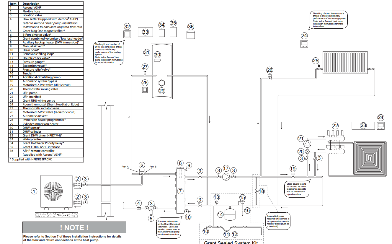

eniacs Posted June 15, 2023 Posted June 15, 2023 On 15/05/2023 at 09:14, crispy_wafer said: Just updating as i've gone quiet on this lately, slowly accumulating parts for the install A couple of retailers have failed on the pre plumbed cylinder that I wanted, think there must have been supply chain issues, so have bought a 250l unit off ebay, as link listed in the marketplace. Costs so far. Grant 6kW Heatpump - 1280 Rubber Feet - 40 WH 250L Cylinder - 740 Primary pipework, press fit levers, press elbows, T's etc, caleffi antifreeze valves, pipe insulation, flexible pipes - 400(ish) Grant buffer/llh - 325 Grant wiring centre ep001 - 40 Grant Hot water boost kit - 70 Mag Filter - 100 Waiting for the cylinder to turn up now, so what's needed re: expansion/filling etc. Crispy where are you finding these parts for so cheaply - even the caleffi valves on ebay cost £75 each. You are also lucky to have such a cheap wiring centre - my mitsubishi has just cost me £750 I did manage to get the mag filter for £60 though, did you manage to get a "Heat pump filter" i had to send back the first one as it was too restrictive.
crispy_wafer Posted June 15, 2023 Author Posted June 15, 2023 6 minutes ago, eniacs said: Crispy where are you finding these parts for so cheaply - even the caleffi valves on ebay cost £75 each. Ebay, and patience (which is difficult for me), I don't need to install it 'next week' so am picking up bits as and when they pop up. The caleffi valves I paid 80 ea for. I need to get a zone wiring center. Heatmiser uh4/8 i think. I've got the grant buffer/llh to sell on, and the grant mag filter as the cylinder I purchased has a 50l buffer underneath and a mag filter attached... There's the cylinder. and that's the drg I'm working to, but now without any rad circuit, and probably not a secondary pumpset - we'll see!
eniacs Posted June 15, 2023 Posted June 15, 2023 Nice diagram, ive not really worked to any diagram yet! What's the flow setter for? Why would you not just want full flow and turn the pump down if its too high? I've negated the isolation valves at the pump as i couldn't see the point in them. Surely these will only be used when the unit is replaced which hopefully isn't often. Also haven't got a automatic air vent, not sure if that's essential either, i usually just vent the radiator at the highest point.
crispy_wafer Posted June 15, 2023 Author Posted June 15, 2023 Just now, eniacs said: Nice diagram, ive not really worked to any diagram yet! What's the flow setter for? Why would you not just want full flow and turn the pump down if its too high? I've negated the isolation valves at the pump as i couldn't see the point in them. Surely these will only be used when the unit is replaced which hopefully isn't often. Also haven't got a automatic air vent, not sure if that's essential either, i usually just vent the radiator at the highest point. It's from the Grant guide, it's the one that closely resembles the plumbing on my cylinder with a 3 port diverter valve and buffer, I'm not competent enough to draw out my own diagram from scratch, however from what I've seen most are similar in that they work on either the premise of a 3 port valve, or a couple of two port valves with logic to decide hot water or heating. The flow setter, from what I understand is there to ensure an acceptable temperature differential between flow and return. So yes you could adjust the in in built pump via the dip switches and the addition of the flow setter may be to give a more finer control?
Jenki Posted June 15, 2023 Posted June 15, 2023 1 hour ago, crispy_wafer said: It's from the Grant guide, it's the one that closely resembles the plumbing on my cylinder with a 3 port diverter valve and buffer, I'm not competent enough to draw out my own diagram from scratch, however from what I've seen most are similar in that they work on either the premise of a 3 port valve, or a couple of two port valves with logic to decide hot water or heating. The flow setter, from what I understand is there to ensure an acceptable temperature differential between flow and return. So yes you could adjust the in in built pump via the dip switches and the addition of the flow setter may be to give a more finer control? Nice cylinder 😜, I've not un-packed mine yet as there's no house😁, Just for your info, you will need to install a two port valve as well to comply with unvented cylinder regs. You can't just have a 3 port valve.
crispy_wafer Posted June 15, 2023 Author Posted June 15, 2023 2 hours ago, Jenki said: Nice cylinder 😜, I've not un-packed mine yet as there's no house😁, Just for your info, you will need to install a two port valve as well to comply with unvented cylinder regs. You can't just have a 3 port valve. 👍 A 2 port valve to allow flow to the ufh like the schematic or somewhere else not shown on the schematic?
Jenki Posted June 15, 2023 Posted June 15, 2023 16 minutes ago, crispy_wafer said: 👍 A 2 port valve to allow flow to the ufh like the schematic or somewhere else not shown on the schematic? For the cylinder. You need a 2 port if the max thermal cut out stat is tripped. A quirk, but if you have a 3 port you still need a two port to act as a dead stop. All unlikely with a heat pump, but thats the regulations. 1
