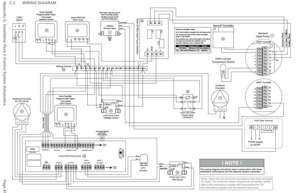

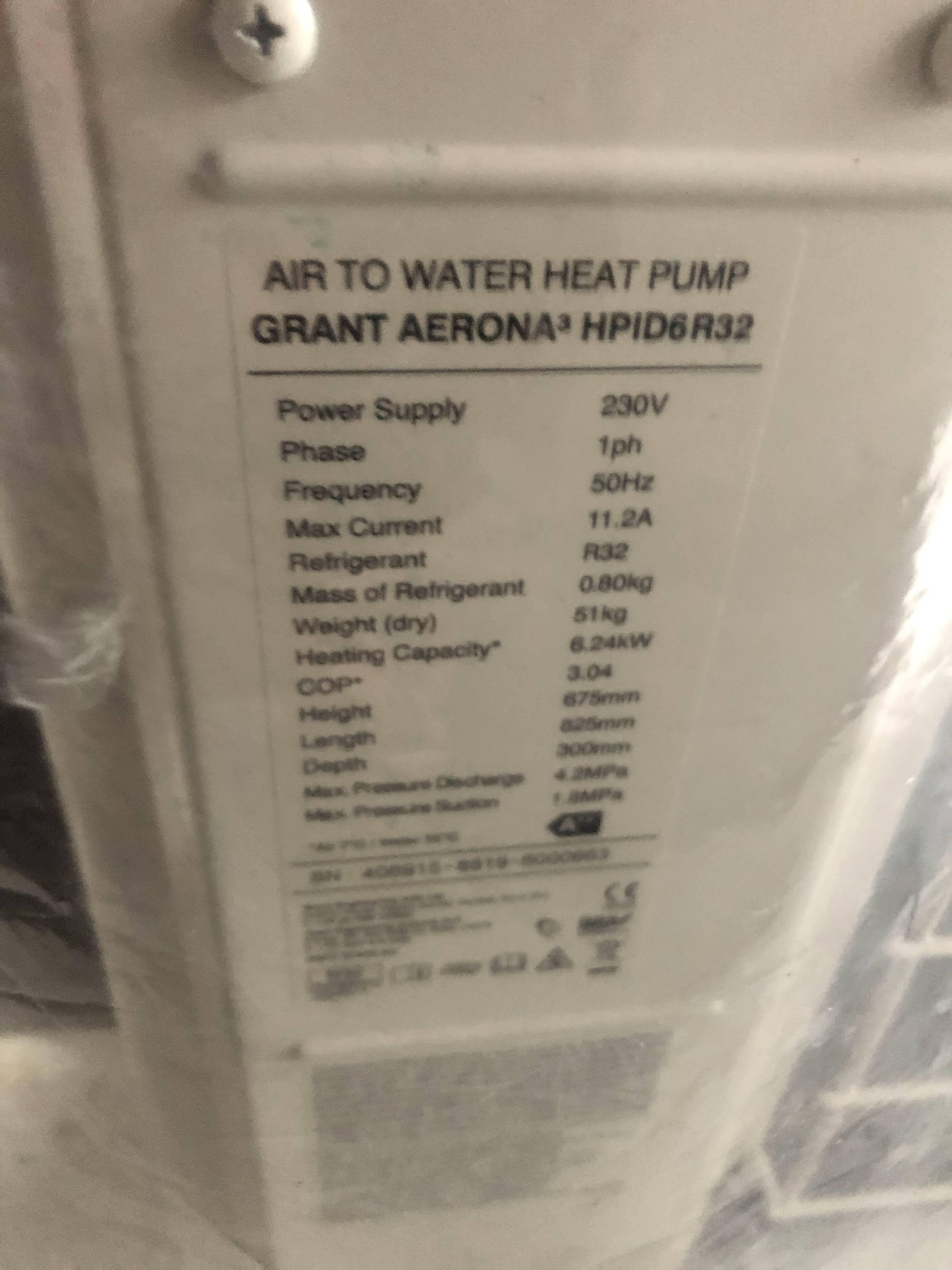

crispy_wafer Posted March 14, 2023 Posted March 14, 2023 So, I managed to bag a small Grant ASHP which I intend self installing, as much as I possibly can. It'll be a relatively simple system comprising DHW and UFH, Spark and plumber will be doing the wiring and cylinder for me. So getting stumped at the first hurdle, as I start looking for other bits needed for install... Although I'm a bit hesitant to ask questions as it shows my lack of knowledge somewhat, here goes the first few questions to enter my head.. How would I size the pipework from the ASHP to the UFH manifold, is there a rule of thumb? The UFH has a design flow rate of 16.4 l/min, and the manifold is a max of 10 metres away from the heat pump. 5 bends at the most as the pipe goes up round and down! How do you decide if a buffer is needed? UFH Design volume is about 96 Litres this is a ground floor system, and all the loops are in rooms which will be used frequently so I'm happy to have the system act as a single zone. Pumps? Should I rely on the ASHP pump solely, or wire up the UFH pump too, then would I need to have a LLH, or is this a case of check the pump on the UFH circuit and see if it closely matches with the pump settings on the ASHP? Cheers Marek
ProDave Posted March 14, 2023 Posted March 14, 2023 UFH manifolds with a circulating pump and a temperature blending valve should be used. I used 22mm pipe but the plumbers may have a better recommendation. the Grant install manual will specifify the minimum system volume, they sell their own "volumiser" that can be used as s a simple extra volume or piped as a low loss header, again I will leave that to the plumbers. 1
DanDee Posted March 14, 2023 Posted March 14, 2023 25 minutes ago, ProDave said: temperature blending valve should be used. Question - what is there to blend?
sharpener Posted March 14, 2023 Posted March 14, 2023 How small is a "small" unit? Stick with the min pipe size to match the HP tappings as per the Grant instructions here, which is 3/4 in or 22mm for the smallest. There are also the Chofu instructions here which do show UFH but unlike the diagram on p14 you could omit the blending valve. As @DanDeeimplies this is only required for a boiler flow at ~60C, then you do not need a secondary pump or LLH either. As you will see from the curves on p13 even the 6kW unit has a pump easily able to push 16 l/s against a sizeable pd, actually it can develop a higher pressure than the 10kW. Grant do stipulate using a volumiser, you will still need this to prevent short cycling on DHW only. On p13 they say install it on the flow if it has an auxiliary heater, however on p18 they show it on the return which has lower losses, there are extensive discussions about this on this forum. Good luck, let us know how you get on! 1

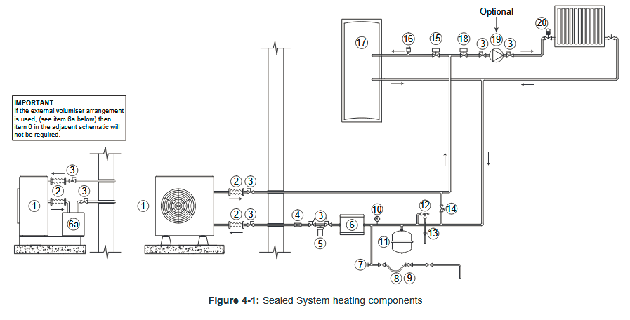

sharpener Posted March 14, 2023 Posted March 14, 2023 (edited) Sorry @JohnMo but it is the same R410a one, the current Grants use R32 though it is not clear what exactly the OP has bought, perhaps he will tell us? <It is normal to have a buffer on the central heating side of the 3 way valve.> Not what the Grant manual shows, [6] is the volumiser in the pic below. If you are going to have one at all then I would think it would still help to have it in circuit for the DHW (as they do). But you could argue that when the CH cuts in you have the extra volume of water at a higher temperature than you want/need/is good for the efficiency. N.b. the pic shows an S-plan setup, this allows both circuits to be in use at once, best not to allow this as the temps you want are very different esp without a blending valve. As others have said this allows for a drop-in boiler replacement in a system with just rads, but the downside is you get far from optimal efficiency with any attached UFH. @JamesPa <wrote Conclusion was that a 5 C temp diff and a 3sq m coil was ok with my planned hp which modulates down to 4kW> So almost certainly OK with the OP's 6kW unit then. Edited March 14, 2023 by sharpener
sharpener Posted March 14, 2023 Posted March 14, 2023 So up to date then. The difference might explain the better CoP figures mentioned by @DanDee in this thread.
JohnMo Posted March 14, 2023 Posted March 14, 2023 16 minutes ago, sharpener said: Grant manual shows, [6] is the volumiser in the pic below. If you are going to have one at all then I would think it would still help to have it in circuit for the DHW (as they do). It on the return leg which good

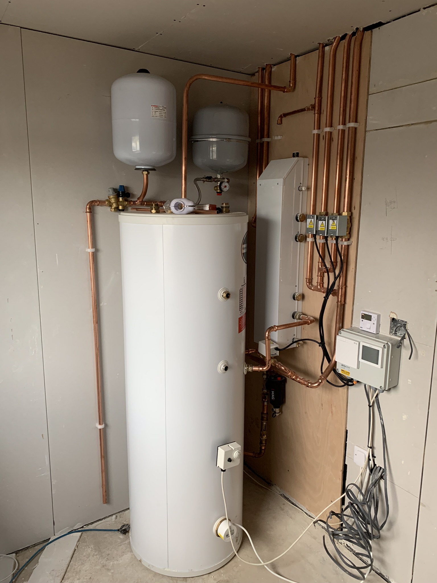

Bonner Posted March 14, 2023 Posted March 14, 2023 I have a Grant 13kW MCS installed. Can’t vouch for it’s performance yet but the installers seemed to know what they were doing. Two UFH manifolds, radiators and a separate towel rad circuit. Grant supplied package including volumiser. PM me if you want any more info. 1
crispy_wafer Posted March 14, 2023 Author Posted March 14, 2023 10 minutes ago, Bonner said: I have a Grant 13kW MCS installed. Can’t vouch for it’s performance yet but the installers seemed to know what they were doing. Two UFH manifolds, radiators and a separate towel rad circuit. Grant supplied package including volumiser. PM me if you want any more info. Pictures are great, gives me something to work towards, when I pickup the tools up in anger! Your guys have used press fit too, which is cool! I'm looking to snag a tool on ebay at the moment, I think they are amazing bits of kit.
ProDave Posted March 14, 2023 Posted March 14, 2023 Here's one I did earlier. Well I only did the wiring, not the plumbing. UVC and volumiser supplied as a package with the ASHP. I am not sure I agree with the plumbing, but there are two UFH manifolds a second one just to the right out of shot and the only circulating pump in the system is the one in the ASHP. And no thermal mixing valves on the manifods so water circulates at temperature set by the ASHP. 1

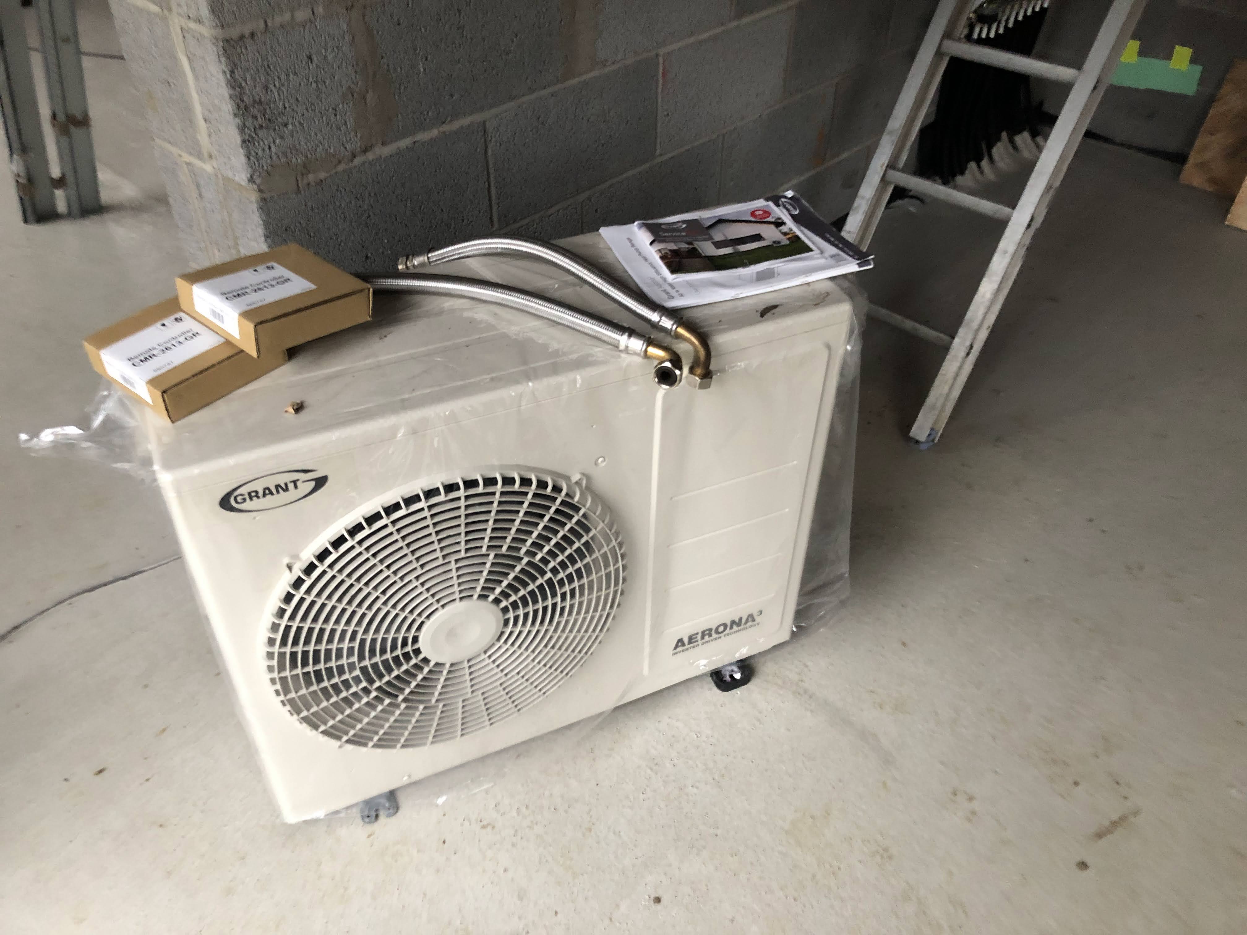

crispy_wafer Posted March 16, 2023 Author Posted March 16, 2023 Popped over to Liverpool yesterday to pick up the little beastie. Got it from a renewables firm that had installed a few of these, but the heating calcs system they were provided with had some under sizing errors. They then had to pull these units out at of use and replace, so were selling the small units off. Had about 2 weeks worth of work, comes with controllers and most of the bundled accessories. 1st job on the agenda is sorting out it final position, then putting in the condensate drain and concrete pad. I'm redoing the soil and waste drainage outside as I don't like the builder did. So, any reason I cant feed the condensate into a 110mm which will eventually end up in the WTP?
