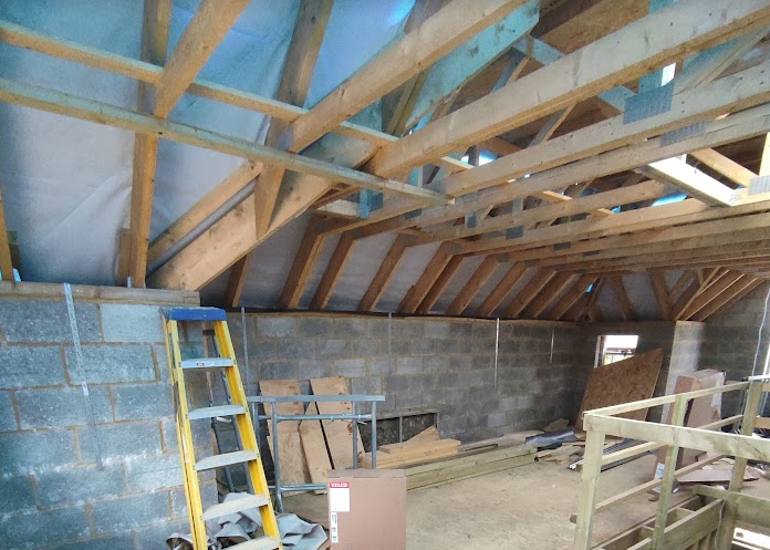

BadgerBadger Posted March 9, 2023 Posted March 9, 2023 Our build is finally getting through the masonry section (hurrah!) but it does mean I'm back at the bottom of the learning curve now we're getting on roofing! Can I just sanity check I'm buying the right timber please?! For wall plates can I just use a 47 x 100 C16 treated eased-edge carcassing timber that's widely available in all the merchants, or does it need to be something else?

BadgerBadger Posted March 10, 2023 Author Posted March 10, 2023 Thank you - I took the NHBC guidance as my starting point which states "38 x 100 or in accordance with local practice". But can't really find 38x100 easily in merchants, which made me think everyone must do something different! My architect drawings show approx. 50mm total plate height, so currently building the masonry to that level. What are the advantages of going thicker at 75x100, as opposed to 47x100?

BadgerBadger Posted June 24, 2023 Author Posted June 24, 2023 I've used 47x100 on one roof section which seems to have worked well, but on the second section my as-built masonry height has worked out lower than anticipated. ~100x100 would bring it back to where it needs to be, bit harder to source, but is this too thick? Or is it ok? Failing that, I might need to take the top block course off and re-cut 🫤

markc Posted June 26, 2023 Posted June 26, 2023 BCO shouldn’t have any problem with 2x stacked timbers, stagger joints and nail together and you have a sound fixing 1
BadgerBadger Posted June 26, 2023 Author Posted June 26, 2023 Thanks all - any immediate concerns with going straight to 100 x 100 do you think? I think I've sourced some, and need some elsewhere anyway, so avoids any doubt about stacking.
markc Posted June 26, 2023 Posted June 26, 2023 37 minutes ago, BadgerBadger said: Thanks all - any immediate concerns with going straight to 100 x 100 do you think? I think I've sourced some, and need some elsewhere anyway, so avoids any doubt about stacking. No, just allow for and make a decent fit half lap joint because it will be so much more visible with 100x100 1
Mr Punter Posted June 26, 2023 Posted June 26, 2023 8 hours ago, markc said: BCO shouldn’t have any problem with 2x stacked timbers, stagger joints and nail together and you have a sound fixing Agreed. They use double and triple sole plates frequently on timber frame. You probably won't even require half lap joints, just stagger the layers. 47 x 100 treated timber is easily sourced, cut and fixed. 1
