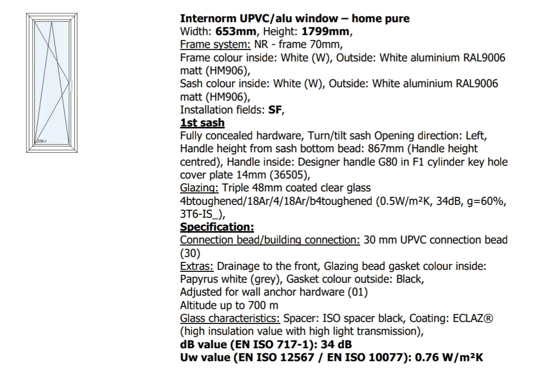

Conor Posted March 9, 2023 Posted March 9, 2023 How many openings do you have and how big are they? Drawings would help as well as screenshot of window spec, e.g.
Kelvin Posted March 9, 2023 Posted March 9, 2023 1.7 is poor even if you could mitigate it with more insulation elsewhere it wouldn’t be advisable. As others have suggested you need to fit better windows. We compromised elsewhere in our design to fit triple glazed units. Our average U value is 0.78.

Conor Posted March 9, 2023 Posted March 9, 2023 2 minutes ago, CADjockey said: I might add at this point that we are replacing a house that was entirely of wooden construction (1950s), 150mm thick (empty) walls with no insulation, single glazing and even cedar shingle roof tiles. So in some ways, what we are building will be at least twice+ as insulated. If the GSHP, UFH and MVHR do their jobs we will be more likely to be complaining about solar gain from the south facing bifolds 😅 That said I am looking into better as I type... I feel cold just reading that! Yeah, but you should be comparing to the average modern standard. You want to be better than that. Re bi-folds... Be very wary of these esp the weather and air ingress ratings. We spent a lot getting a good spec model from solarlux. How big are they? You should have solar gain modelled. Oh, and a good quality triple glazed units will reduce solar gain compared to standard double glazed unit.
