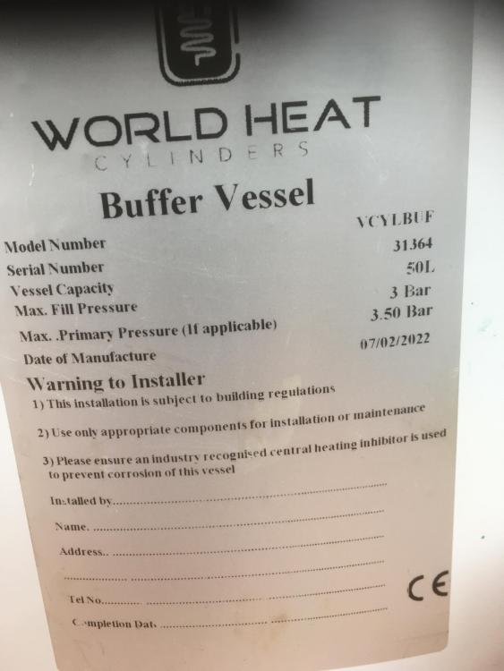

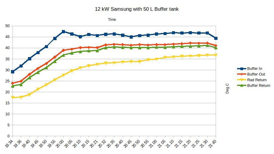

IanR Posted March 12, 2023 Share Posted March 12, 2023 (edited) 33 minutes ago, JohnMo said: Your inlet outlet temp for flow and return? Your flow in-out should be the same temperature, if working as you describe if no mixing is occurring. So your temps are? Equal, within a degree, at the times they should be. Unfortunately the thermocouples I have are +/-0.5° accuracy. But that's close enough for me. How about yours? I hadn't appreciated you had a 4P buffer installed. Is it designed for stratification? What's the model number? what ASHP have you got attached to it? and how are you controlling it? Edited March 12, 2023 by IanR Link to comment Share on other sites More sharing options...

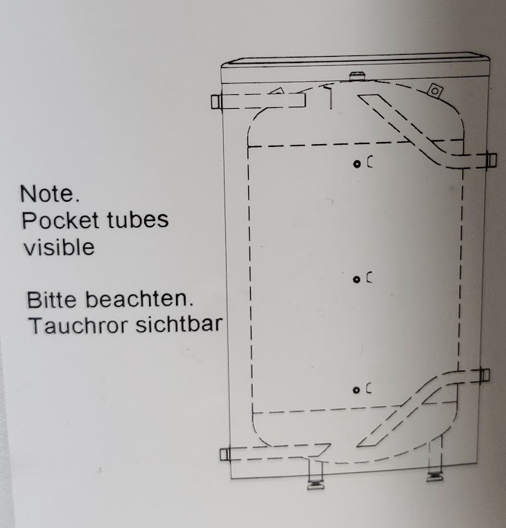

dpmiller Posted March 12, 2023 Share Posted March 12, 2023 12 hours ago, IanR said: and the diagrams of the internal porting that came in the paperwork can we see these please? Link to comment Share on other sites More sharing options...
IanR Posted March 12, 2023 Share Posted March 12, 2023 10 minutes ago, dpmiller said: can we see these please? To hand, I have the labelling on the tank itself, which this is a photo of: In the paper work, somewhere, there is the same image but with a little more detail. It's only used in a schematic showing the plumbing options, so isn't intended to be a set of engineering drawings of the internal details, but if I find it I will post it. Link to comment Share on other sites More sharing options...

JohnMo Posted March 12, 2023 Share Posted March 12, 2023 That's a good cylinder design, you have, that possibly explains why there is always stratification in your buffer. It's a pity they are not all designed that way. Most are designed with a compression fitting swaged or brazed to the cylinder shell and nothing to actively promote stratification, just an empty cylinder full off water swirling and sloshing about. Cannot measure my temps as I am away for a few days. But I have a 2 port design with oversized tees to give hydraulic sepereration. Mine is on a low flow temp gas boiler at present. When the heat pump is installed there will be no buffer. Link to comment Share on other sites More sharing options...

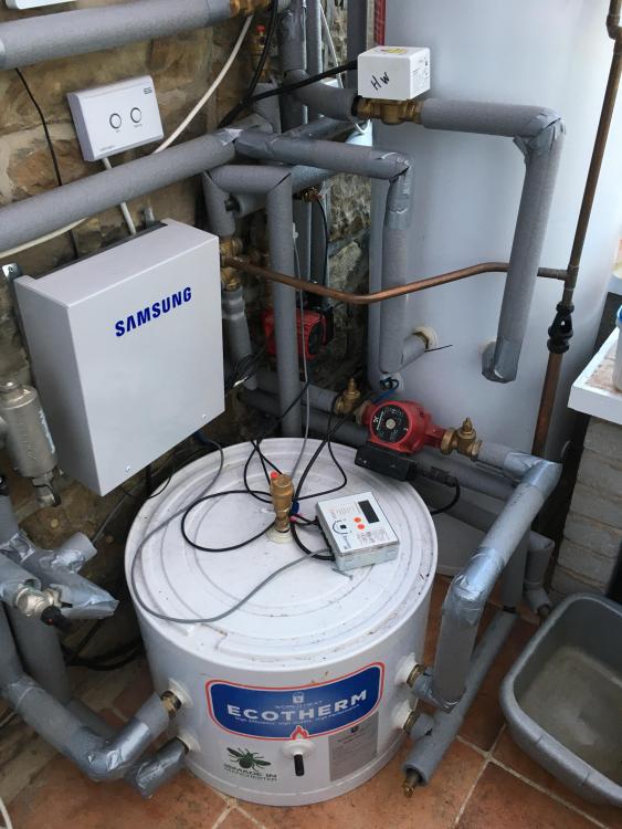

ReedRichards Posted March 12, 2023 Share Posted March 12, 2023 My buffer tank has an immersion heater fitted, although it has never been connected. It's also integrated with (underneath) the hot water cylinder which makes it short and squat and probably the opposite of the optimal configuration. I wonder if I could add a tall thin buffer, bypass two ports on my existing buffer and just use it as a volumiser? Link to comment Share on other sites More sharing options...
sharpener Posted March 12, 2023 Author Share Posted March 12, 2023 What does your present setup not achieve, and do you need a buffer at all? @IanR's list posted 1750 last Friday seems a good checklist for this. If not then yes, connecting the existing tank as a volumiser in the return line might give an improvement. Link to comment Share on other sites More sharing options...
ReedRichards Posted March 12, 2023 Share Posted March 12, 2023 One thing that my present setup does not achieve is circulation through the heating system when the heat pump is off. There is a short period of a few minutes when both the water pumps are on whilst the heat pump is not active. But as soon as the heat pump stops pumping heat then the water pump for the central heating goes off. I would have to strip off some insulation to measure the pipe temperatures to and from the buffer; I haven't got around to doing that so I don't know if I get mixing inside the buffer or not. Even then, I have only the one thermometer and measuring a temperature differential is quite difficult because temperatures very rarely hold constant. Also, I could not use the existing tank alone as a volumiser because the water pump inside the ASHP would have to pump water through the stopped central heating water pump in order to defrost. Link to comment Share on other sites More sharing options...
sharpener Posted March 12, 2023 Author Share Posted March 12, 2023 9 minutes ago, ReedRichards said: One thing that my present setup does not achieve is circulation through the heating system when the heat pump is off. There is a short period of a few minutes when both the water pumps are on whilst the heat pump is not active. But as soon as the heat pump stops pumping heat then the water pump for the central heating goes off. No quick fix for this. How is the ch pump controlled, is it from the HP itself or from the system call for heat and can you change it somehow? Is there a programmable run-on setting? Can you wire the ch pump to be on all the relevant time and if necessary put an NRV in parallel with the HP? 12 minutes ago, ReedRichards said: Also, I could not use the existing tank alone as a volumiser because the water pump inside the ASHP would have to pump water through the stopped central heating water pump in order to defrost. That's easier, you can put an auto bypass valve across F and R, after the volumiser but before the ch pump. It may be necessary anyway if your rads all have TRVs. That is the layout I am contemplating. Link to comment Share on other sites More sharing options...

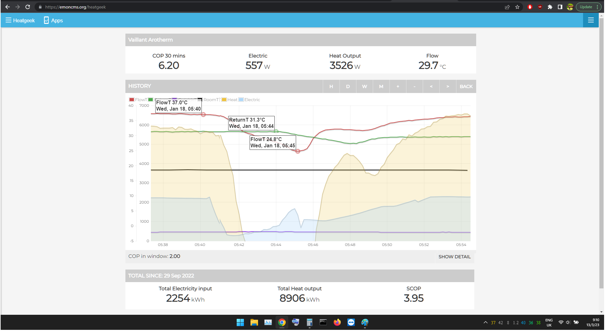

JamesPa Posted March 13, 2023 Share Posted March 13, 2023 23 minutes ago, ReedRichards said: Also, does the flow reverse for defrosting, or is that just my fanciful imagination? The refrigerant flow reverses for defrosting but not the water flow. Link to comment Share on other sites More sharing options...
IanR Posted March 13, 2023 Share Posted March 13, 2023 36 minutes ago, JamesPa said: The refrigerant flow reverses for defrosting but not the water flow. Now I'd assumed the water flow reverses, pulling heat out the emitter circuit or buffer (or UVC when on DHW heating cycle) I can't see there'd be sufficient energy in the "water" in the condenser, to defrost the ASHP, without pulling warm water back out of the house. Link to comment Share on other sites More sharing options...
JamesPa Posted March 13, 2023 Share Posted March 13, 2023 Just now, IanR said: Now I'd assumed the water flow reverses, pulling heat out the emitter circuit or buffer (or UVC when on DHW heating cycle) I can't see there'd be sufficient energy in the "water" in the condenser, to defrost the ASHP, without pulling warm water back out of the house. The water flow doesn't need to reverse for this to happen. The water can keep circulating in the same direction through the heat exchanger in the hp and, provided the refrigerant is colder than the water, heat will transfer to the refrigerant. Same as when the unit is in cooling mode. Link to comment Share on other sites More sharing options...
IanR Posted March 13, 2023 Share Posted March 13, 2023 (edited) 15 minutes ago, JamesPa said: The water flow doesn't need to reverse for this to happen. The water can keep circulating in the same direction through the heat exchanger in the hp and, provided the refrigerant is colder than the water, heat will transfer to the refrigerant. Same as when the unit is in cooling mode. Ah, ok, you're not saying the water flow is stopped, just that it continues in the same direction. But that still puts water that's at least 5°C below what was the retuned temp, back into the emitters, or top of a 4P buffer. Hopefully mine doesn't do that, I had assumed not, and haven't seen/noticed that sort of temp drop off. Something for me to investigate, since it if does, I need some additional control to stop the emitter circuit circulating when the ASHP is defrosting. Edited March 13, 2023 by IanR Link to comment Share on other sites More sharing options...
DanDee Posted March 13, 2023 Share Posted March 13, 2023 (edited) 24 minutes ago, IanR said: Now I'd assumed the water flow reverses, pulling heat out the emitter circuit or buffer (or UVC when on DHW heating cycle) I can't see there'd be sufficient energy in the "water" in the condenser, to defrost the ASHP, without pulling warm water back out of the house. Water doesn't reverse the flow as it's taking the heat from the return side, and the flow becomes colder. https://emoncms.org/heatgeek Edited March 13, 2023 by DanDee https://emoncms.org/heatgeek Link to comment Share on other sites More sharing options...
JamesPa Posted March 13, 2023 Share Posted March 13, 2023 (edited) 9 minutes ago, IanR said: Ah, ok, you're not saying the water flow is stopped, just that it continues in the same direction. But that still puts water that's at least 5°C below what was the retuned temp, back into the emitters, or top of a 4P buffer. Hopefully mine doesn't do that, I don't know that it does, simply that it can. I imagine a hp that knows there is a buffer _and_ which has control of both pumps might switch off the ch circulation pump and switch on the buffer pump, so that the energy is taken from the buffer. Once defrost is finished it might then heat the buffer up before switching on the ch circulation pump back on. Having said this provided the temperature of the water circulating in the ch is above the room temperature, it will still give up heat to the room so letting it continue to circulate is likely OK. I really have no idea how heat pumps in practice manage this, particularly if they don't have control of both pumps. Edited March 13, 2023 by JamesPa Link to comment Share on other sites More sharing options...
HughF Posted March 13, 2023 Share Posted March 13, 2023 1 minute ago, JamesPa said: I don't know that it does, simply that it can. I imagine a hp that knows there is a buffer _and_ which has control of both pumps might switch off the ch circulation pump and switch on the buffer pump, so that the energy is taken from the buffer. Once defrost is finished it might then heat the buffer up before switching on the ch circulation pump back on. I really have no idea how heat pumps in practice manage this, particular they don't have control of both pumps. They don't.... defrost just sucks some heat out of the water circuit by reversing the F-Gas valve. Be that a buffer, or a direct connection to the heating circuit. Link to comment Share on other sites More sharing options...
JamesPa Posted March 13, 2023 Share Posted March 13, 2023 2 minutes ago, HughF said: They don't.... defrost just sucks some heat out of the water circuit by reversing the F-Gas valve. Be that a buffer, or a direct connection to the heating circuit. Thanks, ... and provided the temperature of the water circulating in the ch is above the room temperature, it will still give up heat to the room, so letting it continue to circulate is OK. Link to comment Share on other sites More sharing options...

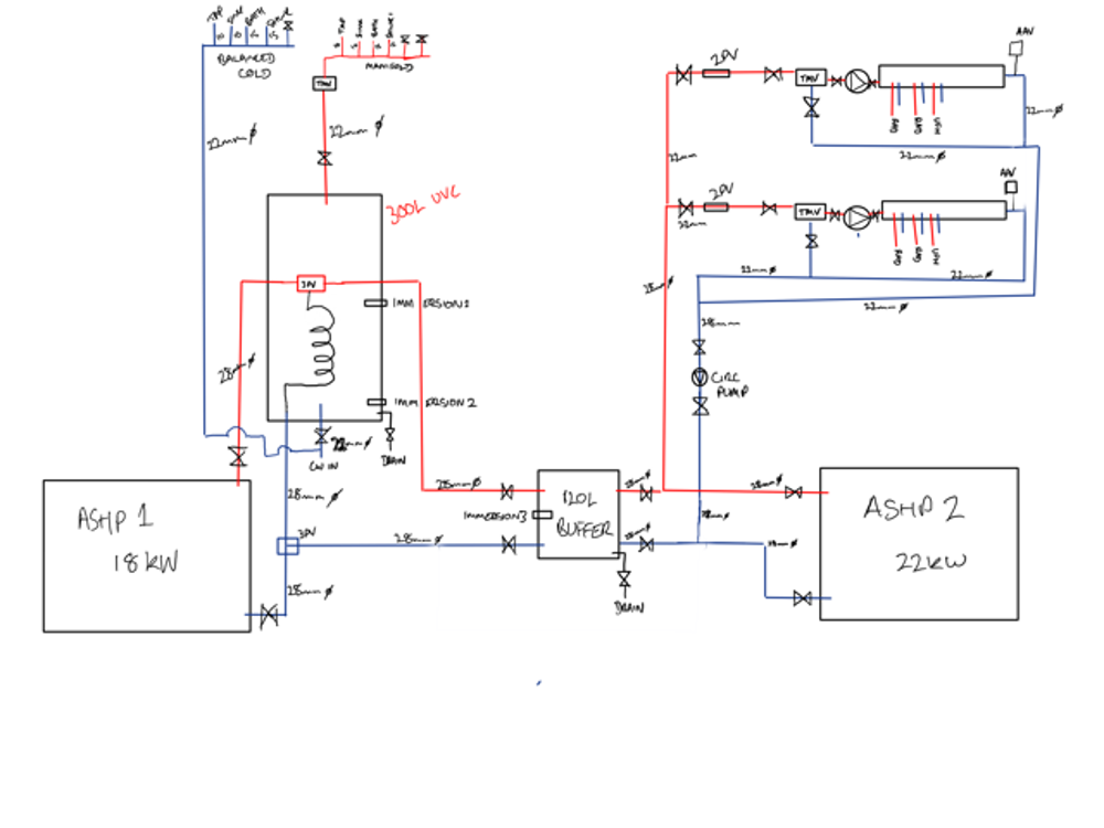

Wil Posted March 16, 2023 Share Posted March 16, 2023 On 13/03/2023 at 11:49, JamesPa said: Does the water cool below room temperature during the defrost cycle. I would have expected hps to stop this happening, to avoid the risk of condensation. If water stays above room temperature then no harm is done if it continues to circulate. I've never seen it happen, but not sure that it CAN'T. I have the CoolEnergy 120l buffer and it definitely has an immersion which I use for dumping excess heat after the HW tank has had it's fill. The 120l immersion gets turned over bloody quickly by my system though: my heating is still just Rads, and no 3Pv on the cold return to ASHP 1 but otherwise it's pretty much ready for me to do the renovation and change the emitters. ASHP1 is HW led but primary heating and ASHP2 only comes in if ASHP1 isn't coping with the heat loss. They have two thermostat pockets at different height in the buffer tank, so I can confirm a small degree of stratification going on, it's what I use to ensure HP2 cuts off and leaves HP1 running (Hp1 stat lower in the tank). Sadly Immersion 1 doesn't exist either for a part-tank top up. Link to comment Share on other sites More sharing options...
JohnMo Posted March 16, 2023 Share Posted March 16, 2023 Why do you need the circulation pump on the return going ASHP 2, the heating manifold pumps will do just fine, pulling from the buffer and returning it. You have 4 pumps, without hydraulic seperation, so you could/will end up with pumps chasing there tails. ASHP 1 and 2 seem huge. If No 2 is just back filling if No 1 doesn't cope. Link to comment Share on other sites More sharing options...
