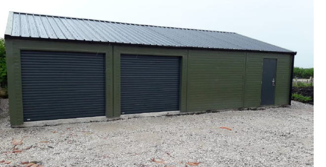

Jack757 Posted March 7, 2023 Share Posted March 7, 2023 Our intentions are to put in a 12M x 8M workshop/garage at the bottom of the garden under permitted development. This to be approx 2.4M and 2M away from boundaries. To have 2 roller doors and single privacy door. No electrics to be fitted yet until main house is built which could be a couple of years after. This would be the structure, groundworks and installation. Access not an issue. We are stuck on the best structure to use between insulated steel frame/roof or block with render. I believe brick would be far too expensive. We are looking for the most cost effective option but also that it will not condensate and is suitable for storing classic cars and working on them (Ramp will not be needed). Ideally would also like to fix whatever we need to the inner walls. Also being in the country we are prone to rodents so needs to be pest proof and long lasting. We've had a couple of quotes for steel structures with installation around 40k (no groundwork costs yet) but are yet to look into block. Anyone got anything similar? Any advice please? Link to comment Share on other sites More sharing options...

Jack757 Posted March 8, 2023 Author Share Posted March 8, 2023 @Gus Potter Thanks. So this is an image of what we have been quoted on so far which is what we were potentially looking at for a steel structure. 12x8Mx2.4M to eaves. 2 manual roller doors, and privacy door. 40mm insulation to walls and roof, just the cost seems very high without groundworks cost, whatever that will add on. We've got a house to build after so don't want to go to OTT with the workshop funds. We are in the East so cold not too much of an issue, he can add electric heaters in the future if he's too chilly!!! No lift/hoist needed. To be honest we are so busy we would rather just get someone to do the lot and it means we don't have to be on site either. Link to comment Share on other sites More sharing options...
