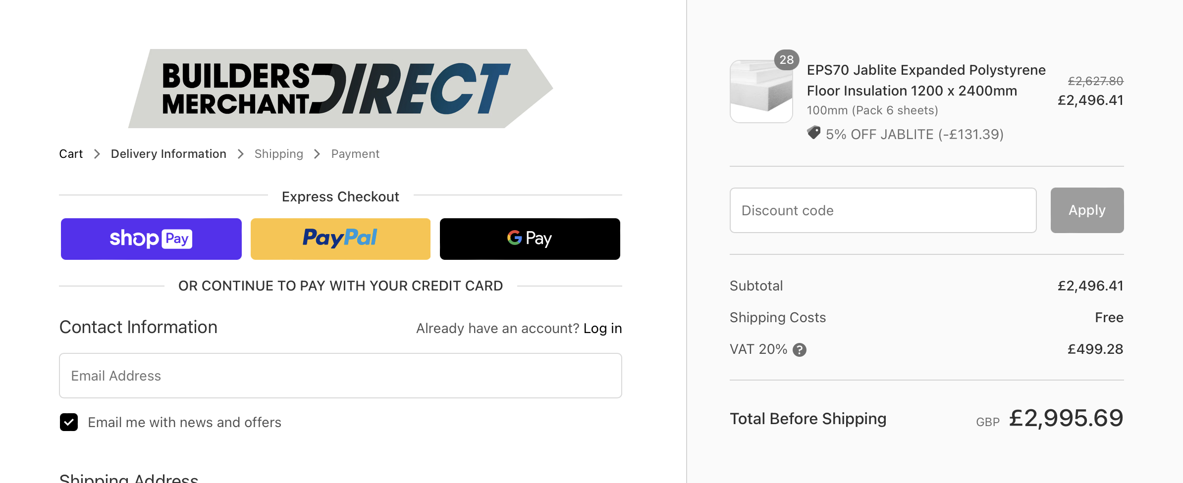

Iceverge Posted March 2, 2023 Posted March 2, 2023 300mm of EPS @0.038 will be about the same as about 180mm of PIR but about £2444 cheaper than 2x90mm Celotex boards from the same supplier. 1

Dave Jones Posted March 3, 2023 Posted March 3, 2023 11 hours ago, Iceverge said: 300mm of EPS @0.038 will be about the same as about 180mm of PIR but about £2444 cheaper than 2x90mm Celotex boards from the same supplier. yup EPS all the way! 2
