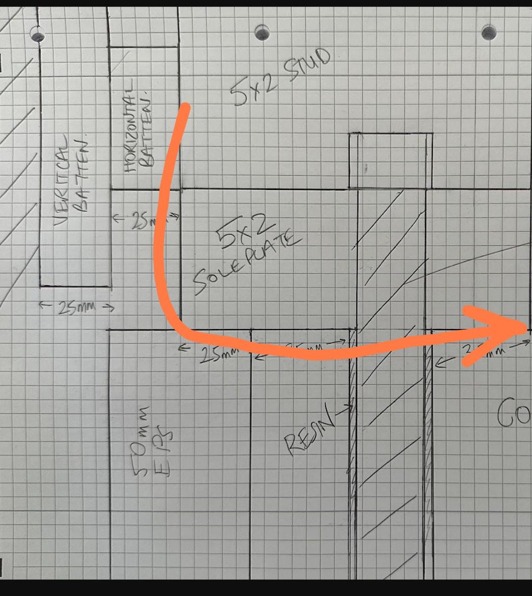

Ticky Posted May 2, 2023 Author Share Posted May 2, 2023 @Nickfromwales You say heat it 'somehow' - you feel it's not going to be easy to heat with anything 'above' the concrete? @saveasteading I'm definitely open to options when it comes to fixing the threaded bar/bolts - think I've seen the epoxy approach on Oakwood Garden Rooms. My concern in drilling once dry was that i'd be close to the edge of the concrete and don't want to cause it to 'blow out'. If I have 5x2 soleplate, 50mm is covering the upstand leaving 75mm over the concrete. Image below is to scale. Would aiming to fix the threaded bar, in the middle of that 75mm (approx 37mm in from the edge) be about right? And how deep does it need to go? I'll have to make sure I'm not hitting any rebar/mesh too Link to comment Share on other sites More sharing options...

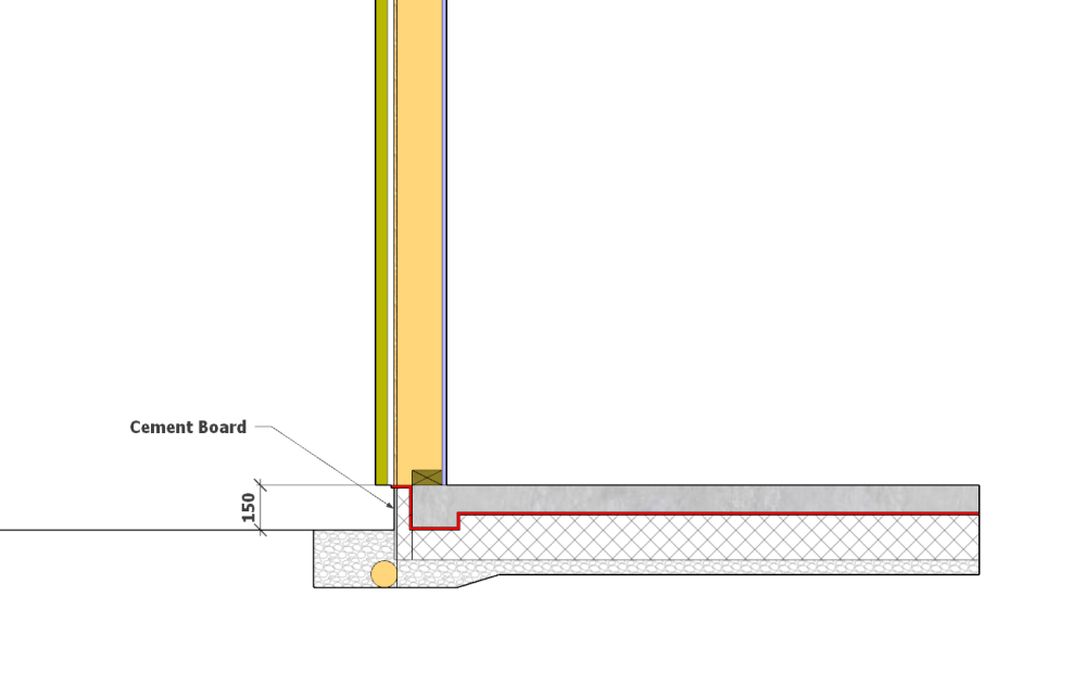

saveasteading Posted May 2, 2023 Share Posted May 2, 2023 How about this? 100 hardcore with sand blinding. Dpm 25mm pir board. Dpm 100 concrete. wall plate on edge of concrete. Cladding oversails. Live with the heat loss the slab perimeter. Air to air heater/ chiller. Roof osb then battens and metal. The gap will allow a lot of the sun heat to dissipate. This will save you a lot of time and construction cost, and enough insulation to avoid the worst extremes. Logic? If heating the air only in daytime, by the time the slab has warmed up, you are turning it off again. Link to comment Share on other sites More sharing options...

saveasteading Posted May 2, 2023 Share Posted May 2, 2023 27 minutes ago, saveasteading said: 100 concrete. Pir stops short of the edge by 150. Concrete at perimeter sits on the hardcore. Hard-core is min 150 outside the slab. Link to comment Share on other sites More sharing options...

Ticky Posted May 3, 2023 Author Share Posted May 3, 2023 I was thinking.... as I'm going to have OSB + double battens and then cladding extending the depth of the walls, does that not give me wiggle room to bring the timbers more over onto the concrete? Even if it was by an extra 25mm, that would mean 100mm of the wall is over the concrete with only 25mm over the upstand. Any issues with that? I drew it out but missed out the OSB layer. Link to comment Share on other sites More sharing options...

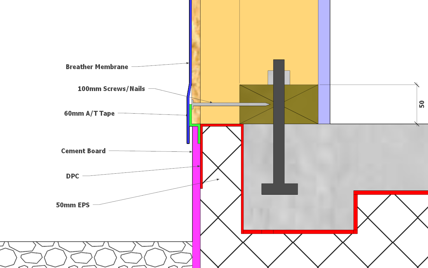

Iceverge Posted May 4, 2023 Share Posted May 4, 2023 Beware water ingress via this route. At the very least the OSB sheathing should be flush with the insulation so that the breather membrane can lap over the insulation. Preferably outside it in my opinion. Hence my suggestion earlier of a 100*50 sole plate with 150*50 studs on top. The 50mm overhang will allow you to put insulation outside the sole plate too breaking the thermal bridge of the wall plate. For the doors, fit them that that they rest partially on the concrete and partially on the insulation upstand. This will sort your thermal bridge here. Are you committed to bi-folds? They are draughty. Would a french door with a fixed panel suffice? Cheaper and better IMO. Link to comment Share on other sites More sharing options...
Ticky Posted May 4, 2023 Author Share Posted May 4, 2023 36 minutes ago, Iceverge said: Hence my suggestion earlier of a 100*50 sole plate with 150*50 studs on top. Apologies, but i'm struggling to visualise again. Is that an extra strip of insulation? and I thought the sole plate was what the studs were attached too. Part of the wall frame? (I'm probably wrong again ha ha) 1 hour ago, Iceverge said: Are you committed to bi-folds? Not really, just thought they looked better. Didn't realise you could get Aluminium ones that looked like bi-folds. Link to comment Share on other sites More sharing options...
saveasteading Posted May 4, 2023 Share Posted May 4, 2023 I dont like the exposed polystyrene on the outer face. It will get damaged, and isnt easy to fix or to fix a face onto. How about a compromise and use a thin but durable insulating board like Wedi Board? I would just use 12.5mm to take the edge off the cold bridge. but thicker is available. Sole plate to edge of concrete, then wedi over the concrete and the sole plate. Link to comment Share on other sites More sharing options...

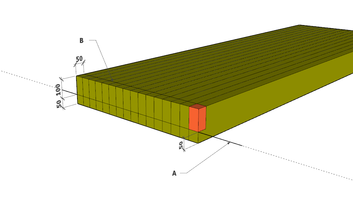

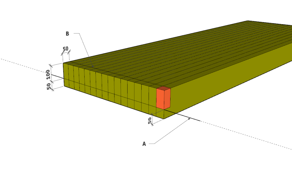

Iceverge Posted May 4, 2023 Share Posted May 4, 2023 3 hours ago, Ticky said: Apologies, but i'm struggling to visualise again. Is that an extra strip of insulation? and I thought the sole plate was what the studs were attached too. Part of the wall frame? (I'm probably wrong again ha ha) Have a look at this one I did earlier. You may need to notch the studs to fit over the wall plate but you'll have a continuous line of insulation from the upstand to the wall. Use at least 150mm screws for the bottom layer of sheathing so that they go all the way through the studs into the wall plate. You'll have a 100mm bearing on the concrete which will be fine. Link to comment Share on other sites More sharing options...

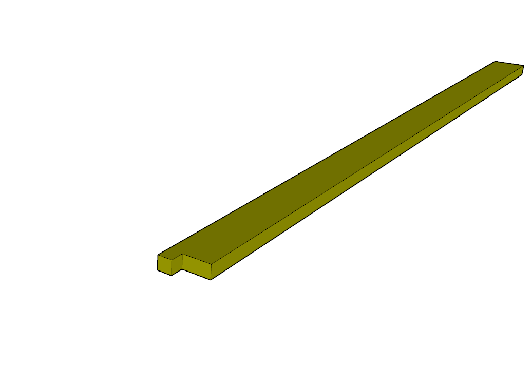

Ticky Posted May 4, 2023 Author Share Posted May 4, 2023 That's the image that I was looking at and couldn't fully work out. What purpose does the notch have? That seems like it would be a lot of effort to cut out a notch for every stud. Wouldn't the OSB finishing to the top of the upstand do a similar job? Like this? (corrected my previous attempt) Link to comment Share on other sites More sharing options...

Iceverge Posted May 4, 2023 Share Posted May 4, 2023 1 hour ago, Ticky said: That's the image that I was looking at and couldn't fully work out. What purpose does the notch have? This is what I mean. The notch will sit outside a 100 x 50 soleplate. Without the notch you'll not be able to "squeeze" the OSB sheathing into the sole plate. It'll just bend the OSB. The notch will create a 50mm gap outside the sole plate to stuff some mineral wool to break that thermal bridge. Despite what @saveasteadingsays I think It's important to keep the soleplate warm. Without it there's a risk of it getting cold, especially in contact with the slab and then you get condensation and rot. Not an issue with a permanently heated house but an intermittently heated garden room it'll save you in the long run. Line up all your studs on a bench and clamp. Snap a line and set your saw to 50mm and cut them "end on" along Line A . Set your circular saw to max depth/100mm and cut along line B. You'll probably need to do some tidy up with a hand saw but it'll be quick. Have a look at the detail above. I would use all 50mm sheets of EPS. Use 150mm under the main part of the floor and then thin that down to 100mm under the thickened edge of the slab. Also use 50mm for the insulation upstand. Lay the DPC as with plenty of spare over the edges. Lay your at the centreline (50mm) of the concrete on chairs. Tie the foundation bolts to the mesh in the correct place with some wire or cable ties. Pour your concrete. Level with a stick and float by hand. When it is set take your soleplates and use the hammer method to find the right hole location. Drill out holes and ensure it's correct/square. Notch your studs and build the wall as normal including OSB sheathing. Fold DPM over Upstand. Apply A/T tape for air sealing. Similarly tape all joints in OSB externally. Very effective and simple. Tape outside of doors and windows similarly. Apply breather membrane, batten and clad. 1 Link to comment Share on other sites More sharing options...
Nickfromwales Posted May 4, 2023 Share Posted May 4, 2023 Just put the 100mm soleplate down, then lay the 150mm soleplate for the footer of the stud framing onto that. Carry the upstand insulation up another 44mm ( or whatever the thickness of the soleplate is ) and for 50mm of overhang the OSB will be as happy as Larry. 1 Link to comment Share on other sites More sharing options...
Iceverge Posted May 4, 2023 Share Posted May 4, 2023 That would work too. I'm just exceptionally cheap. Link to comment Share on other sites More sharing options...
