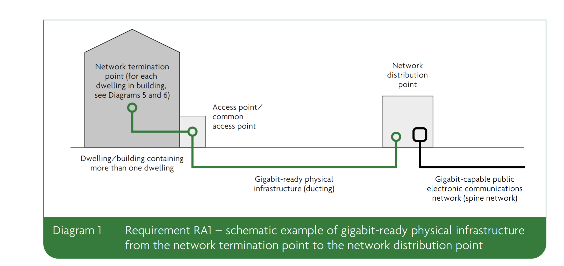

Temp Posted March 1, 2023 Posted March 1, 2023 2 hours ago, Adrian Walker said: I would have a duct from the road to your house so that you can accept fibre to the property - FTTP. +1 And put an 8mm polypropylene draw rope in it. Part R (England) appears to allow this if you don't have the right to lay cables in the road?... Quote 1.9 Where the developer does not have the right to extend the infrastructure to the distribution point, the developer is required to extend the infrastructure to the point that is as close as is reasonably practicable to the network distribution point (see Diagram 2). 1.10 For example, if there is a point that is as close to the distribution point as the developer can extend the gigabit-ready physical infrastructure to, but this would not be reasonably practicable for the developer due to the condition of the land in question, the infrastructure should be extended to an alternative point that is reasonably practicable. Developers are encouraged to work with relevant network operators to identify suitable routes for such infrastructure.
joth Posted March 1, 2023 Posted March 1, 2023 (edited) This is a useful diagram (page 5 or part R) For RA1, put a spare CAT6A (and fiber if feeling flush) plus mains power from the house to an external covered "access point" and a duct from that out to a cabinet near the street and specify that as the gigabit ready strategy. For RA2 you probably need to show no operator will install gagibit in the area at a reasonable cost Edited March 1, 2023 by joth
