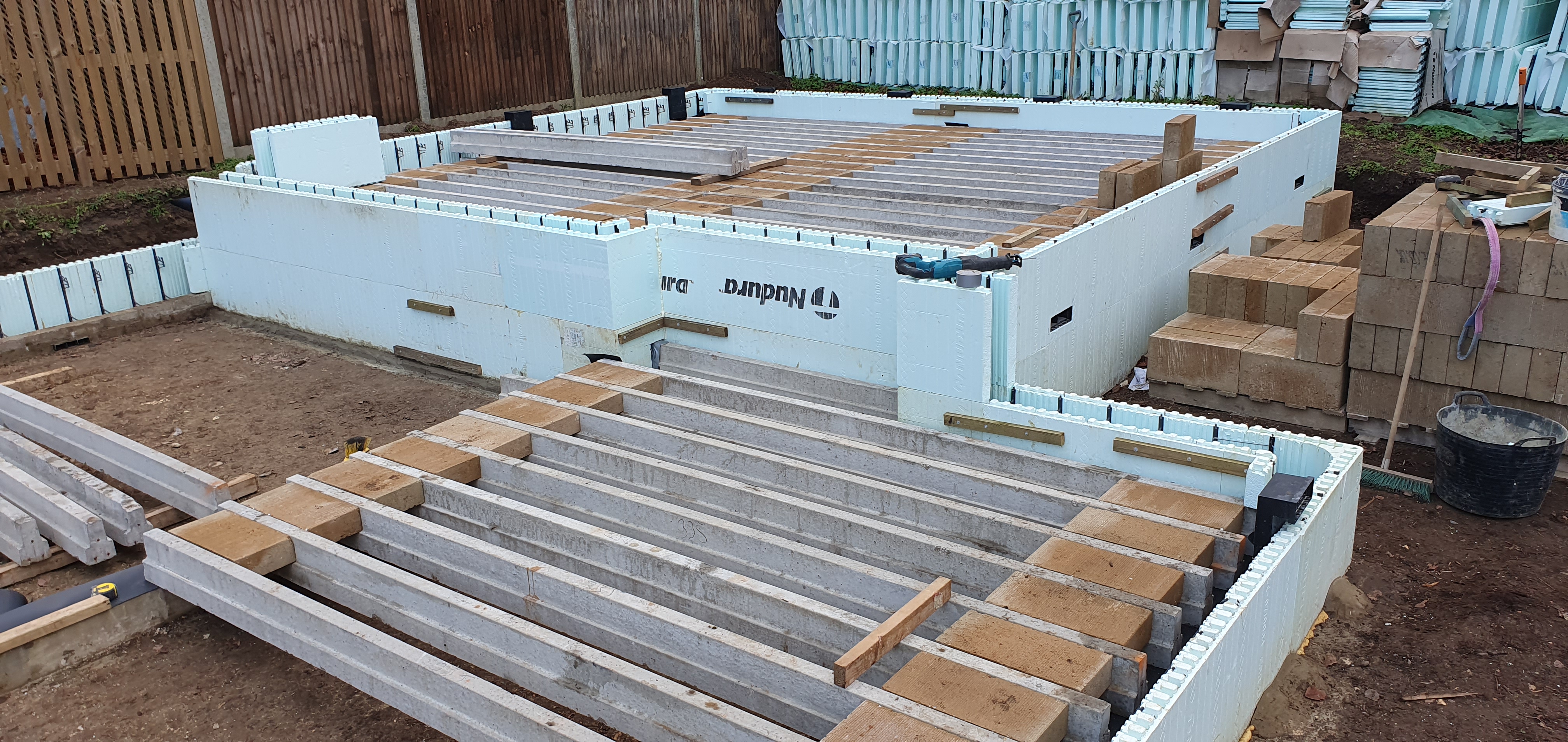

Mulberry View Posted February 27, 2023 Share Posted February 27, 2023 So, day one of DIY installing our Beam & Block went well. I've managed to get most of the 40 beams in my Living Room area in place. This is being done with no machinery, all beams are inside the perimeter, which is a blessing and a curse! To note, our beams are 175mm deep and are ALL spaced at 275mm centres, due to my paranoia about floor bounce. Longest span is 3.9m (the ones in the photo are around 2.85m). What's the expectation with the beam standards? My beams all look to have been cut by Stevie Wonder, none of the ends are straight and some have chunks out of top/bottom surfaces. As part of a change of building tact, I had to cut around 100mm off almost every one of the 180 beams in my scheme, which was no fun, but this allowed me to cut the damaged ends off, so that's OK. However, now that I'm laying them, I'm seeing as much as 10mm differential in the vertical beam height. This is sometimes owing to nobbles in the concrete on the bearing face, easily knocked off with a chisel. However, some are harder to sort, needing a full re-dress with a grinder. Is this normal? Or should I be turning a blind eye to 10mm deviations in the installed surface? Link to comment Share on other sites More sharing options...
Canski Posted February 27, 2023 Share Posted February 27, 2023 The ones I get are usually ok on the ends apart from the odd one or two so I wouldn’t be happy with your delivery. It’s lucky you had to cut them. I would have sent them back. The 10 mm wouldn’t bother me but then I don’t usually get involved with the insulation or screed but it allways looks ok in the end. Link to comment Share on other sites More sharing options...
Dave Jones Posted February 28, 2023 Share Posted February 28, 2023 all normal. 10mm nothing in floor makeup. make sure you sit the beams on dpc, hard to tell from the pics. Link to comment Share on other sites More sharing options...
Mulberry View Posted February 28, 2023 Author Share Posted February 28, 2023 10 minutes ago, Dave Jones said: all normal. 10mm nothing in floor makeup. make sure you sit the beams on dpc, hard to tell from the pics. OK. not so bad then. The middle sleeper walls are 215mm blockwork and have 250mm DPC laid on them. The outer walls are 100mm blockwork and have 450mm DPC laid to allow me to turn up and over the top. More, I think, than is needed, but we love a bit of overkill at Mulberry View. The raised up part is the Living Room, lovely to get an impression of the size now for the first time. The photo was taken from the Dining portion of the Kitchen/Dining Room. I hope to have these two rooms done tomorrow, well in terms of beams laid and spaced. Can anyone give me tips on grouting? Link to comment Share on other sites More sharing options...

BartW Posted February 28, 2023 Share Posted February 28, 2023 Don't forget to paint all beam ends with black bitumen paint. Essential to prevent corrosion of rebars. Also, the 10mm is due to "natural" camber. Quite surprised you had to cut them, as it is possible to order full design with beams in the correct size for your application. Link to comment Share on other sites More sharing options...
Mulberry View Posted February 28, 2023 Author Share Posted February 28, 2023 14 minutes ago, BartW said: Don't forget to paint all beam ends with black bitumen paint. Essential to prevent corrosion of rebars. Also, the 10mm is due to "natural" camber. Quite surprised you had to cut them, as it is possible to order full design with beams in the correct size for your application. I spoke with our Beam manufacturer about painting with bitumen paint and was told there is no need. The discrepancy is in the comparative heights of the bearing surfaces, so isn't camber related. I had to cut them due to a change in the approach of how the lower portion of our building is constructed. This meant repositioning the perimeter bearing surface and consequently having to adjust the beams to suit. Not fun, but not everything is! Link to comment Share on other sites More sharing options...
BartW Posted February 28, 2023 Share Posted February 28, 2023 28 minutes ago, Mulberry View said: I spoke with our Beam manufacturer about painting with bitumen paint and was told there is no need. Ok, I would check with BC if I were you. Mine point blank insisted, and wanted to see they had been done. The following source seems to suggest the same: https://www.labcwarranty.co.uk/technical-blog/damp-protection-for-concrete-floor-beam-systems Link to comment Share on other sites More sharing options...
