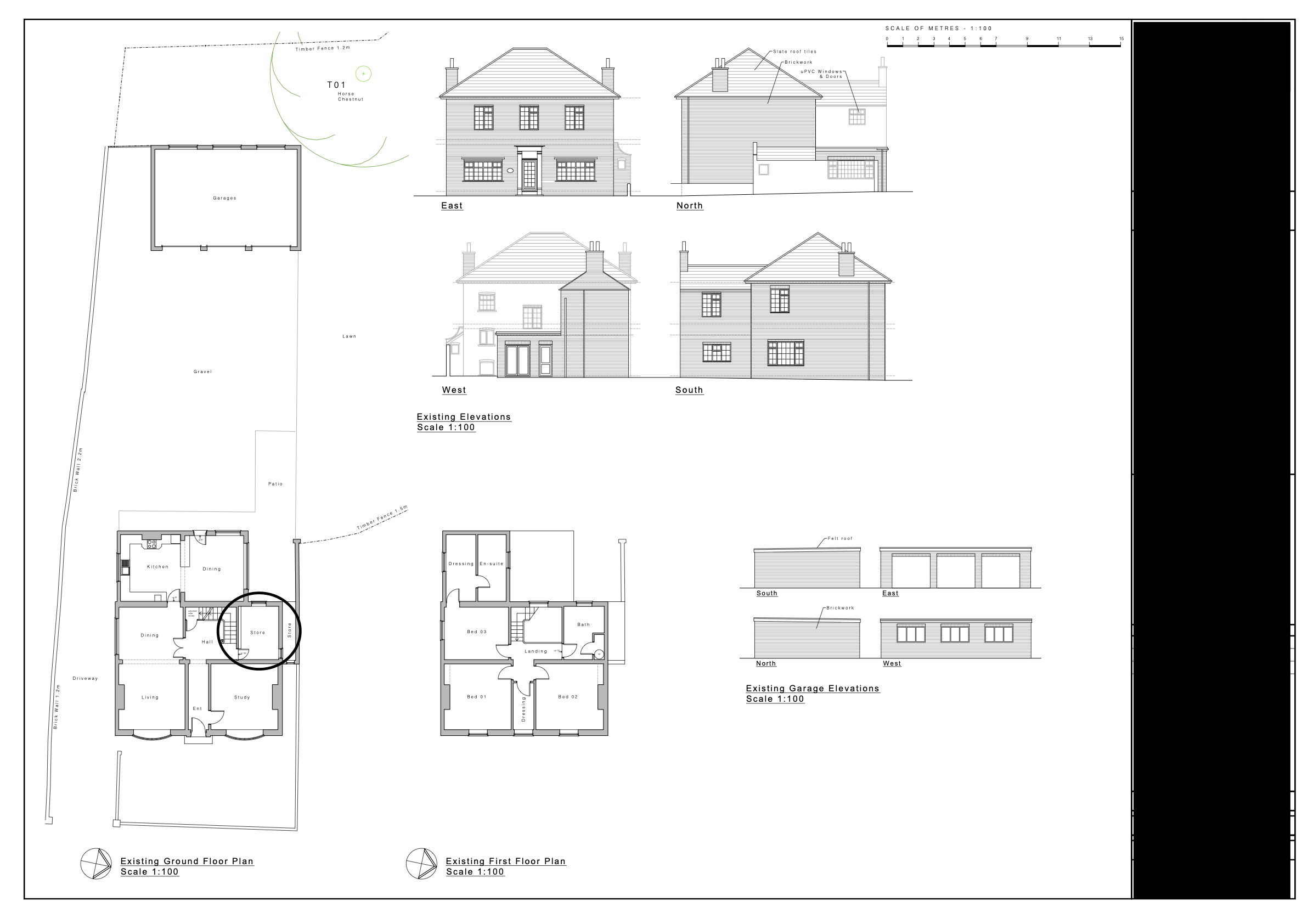

If you post a plan, folk here can make suggestions ;)  Where the door and window(?) are etc will affect the design / layout.

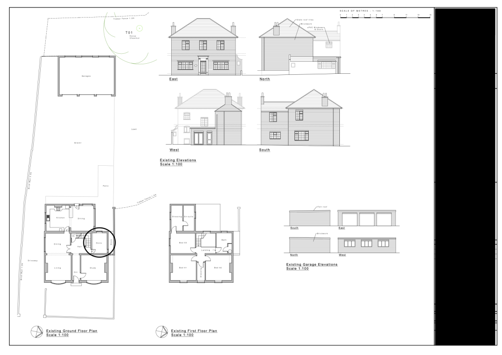

Good thinking. I've circled the room in question, currently labelled "Store". It's approx 2.5m x 3.5m is West facing but has a pretty small window (approx 800mm x 800mm) so lightening isn't great for much, which is why I was wondering whether a downstairs W/C + Utility might be a good idea there, coupled with the services already being in that area...
Thoughts/opinions welcome!

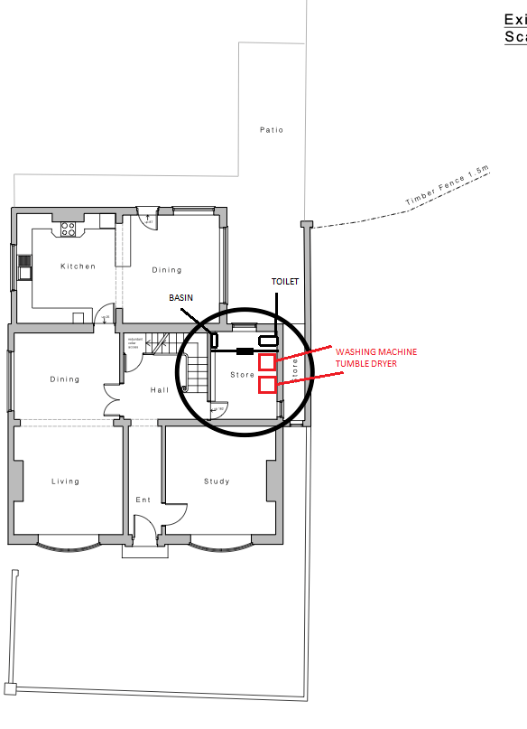

1 hour ago, patp said:
Is there no other downstairs wc? If so it is a no brainer to put one in.
We had originally planned to make what is labelled "Store" our home office and partition what is labelled "dining" into a utility and w/c and extend the hallway around into the kitchen. But given that's a south facing window, it seems crazy to put a utility room in there.

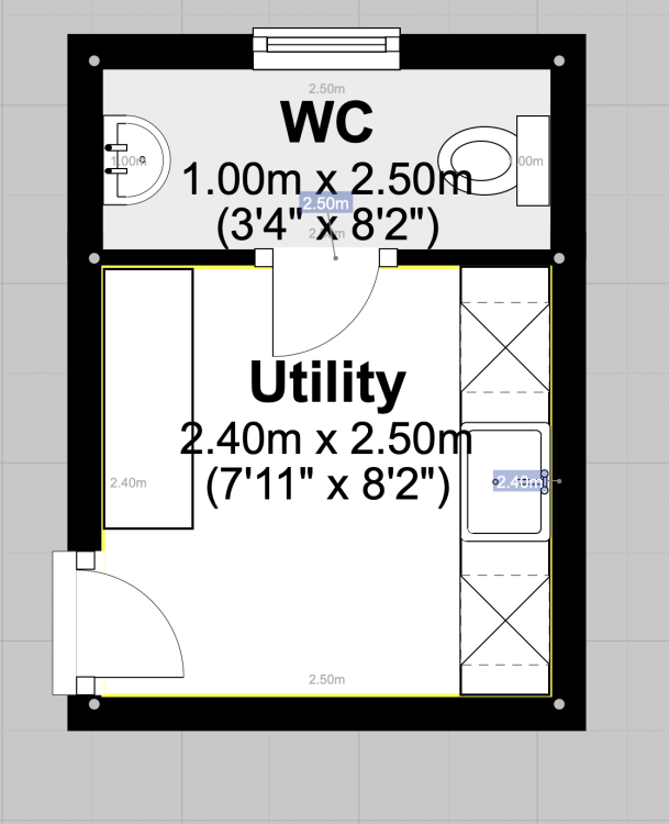

Our current house (not the new build) has exactly this. It's 2m x 1.5m with 3 standard 600mm units (one is a washing machine) down one wall with an inset stainless sink and the toilet on the other wall at the back.
I'm not keen on it but it makes reasonably efficient use of the space.

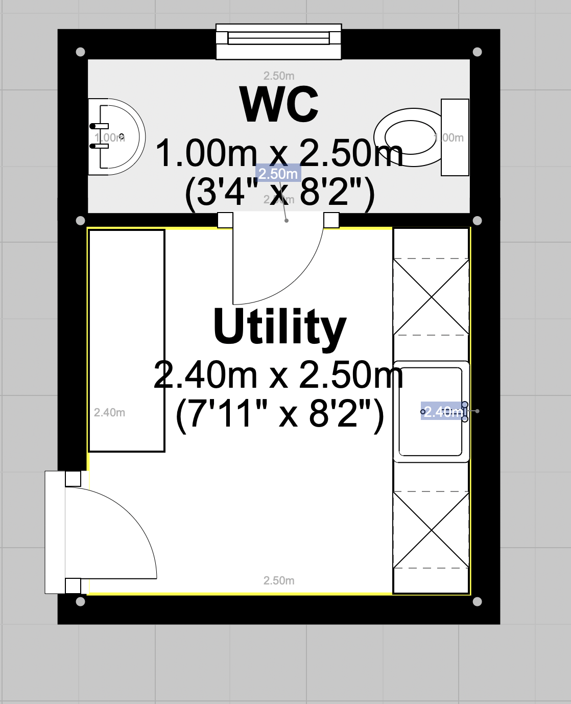

22 hours ago, Nickfromwales said:
Have a sliding pocket door from utility to WC. Bob's your Uncle and Fanny's your Aunt.
Thank me with beer. :)
Something like this;
Certainly feels usable, which I guess is all you need for a utility room and a place to spend a penny!
