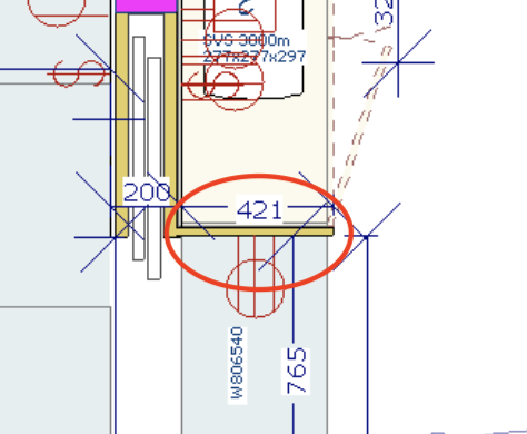

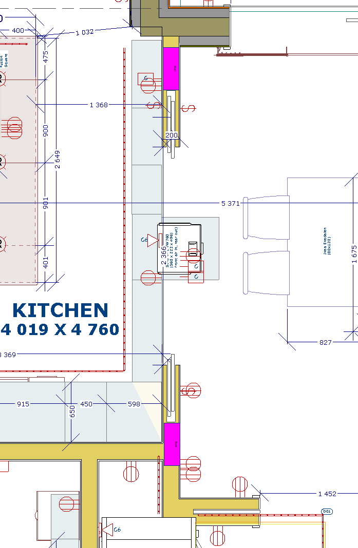

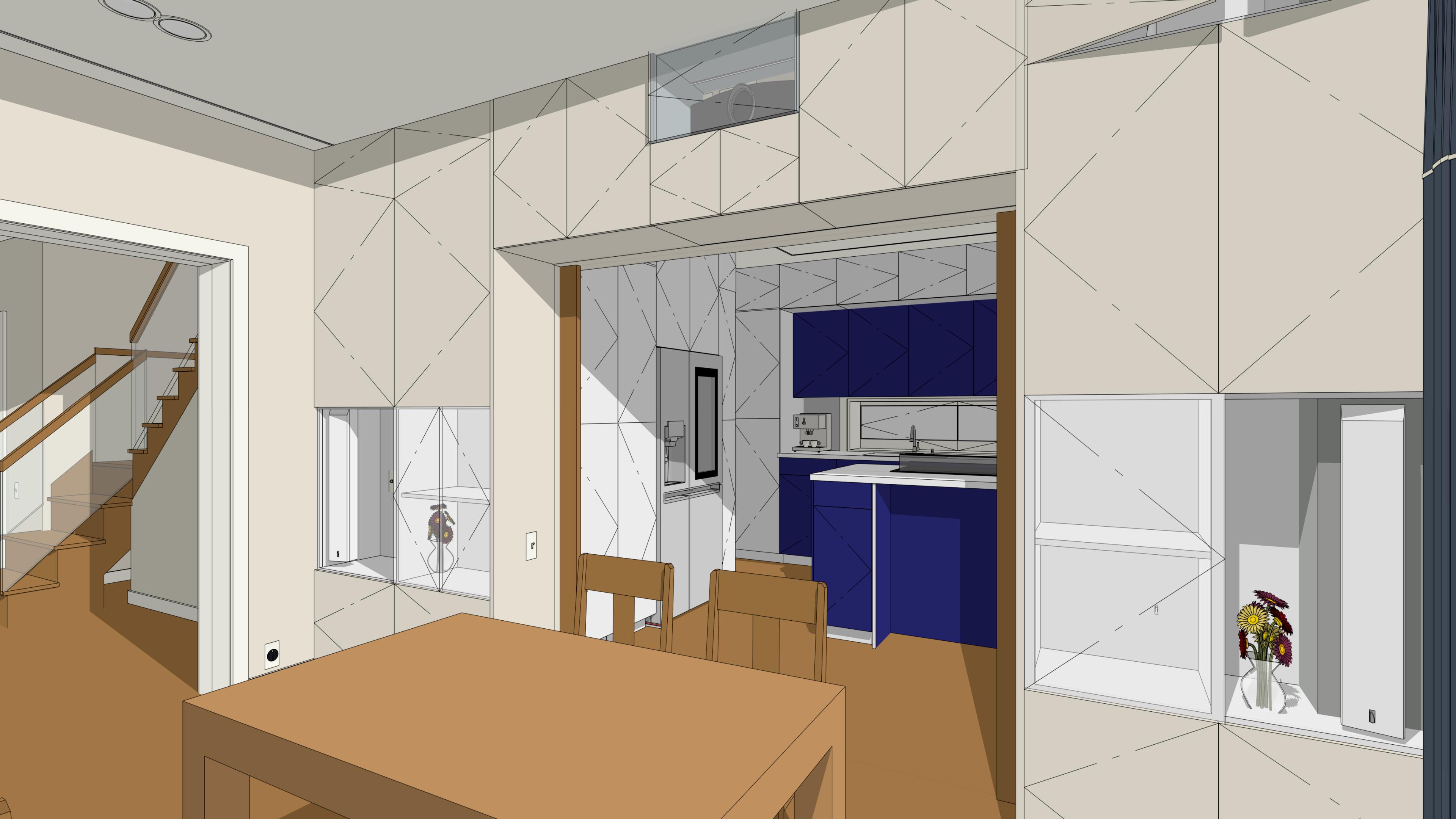

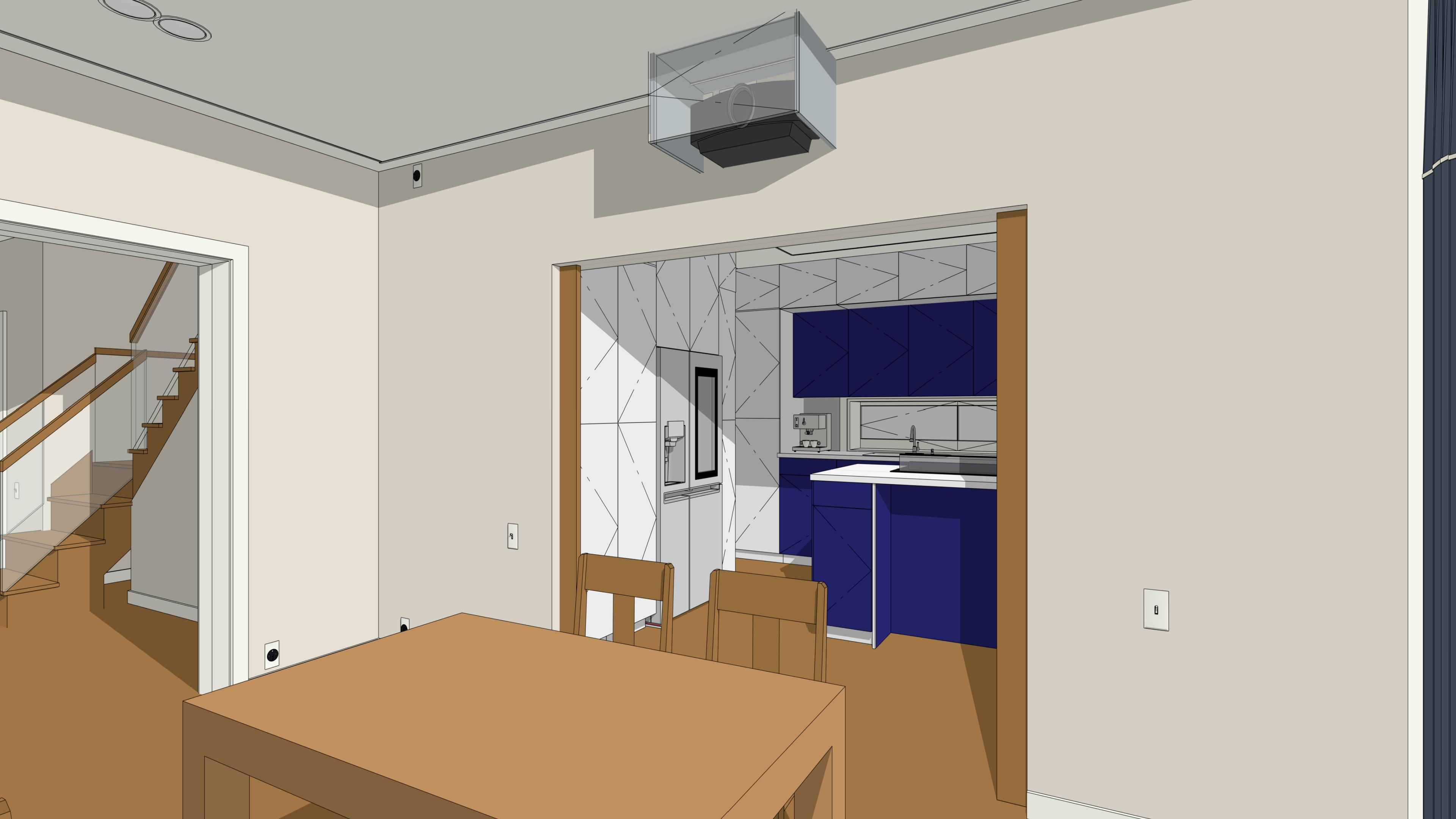

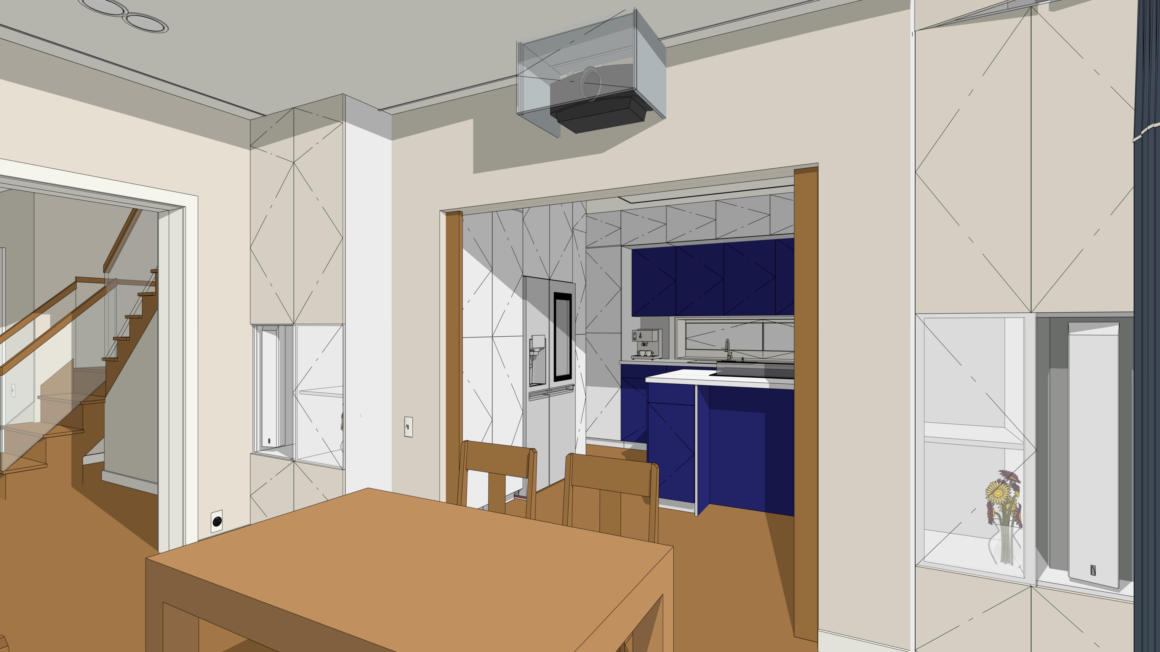

puntloos Posted February 21, 2023 Share Posted February 21, 2023 (edited) So I've got a pocket door (in my design), separating livingroom from kitchen. there's a projector protruding above the door (ceiling height 2.70m allows this). There's cabinets above the door that can hide the bottom of the projector. On the livingroom side we do want the projector to be enclosed in something (fan noise) It looks this way. (ignore the projector for now) We have added storage: But, should we make the storage look like built-in and create a pocket tunnel by extending the wall surrounding the pocket door a little? And the core questions which one would you pick? What is the best solution? Or something else? Edited February 21, 2023 by puntloos 1 Link to comment Share on other sites More sharing options...
Kelvin Posted February 21, 2023 Share Posted February 21, 2023 The deeper wall reveal looks nicer to me which hides the projector. Any concerns about the projector getting too warm though? Like the detailed drawings certainly compared to ours Link to comment Share on other sites More sharing options...
Thorfun Posted February 21, 2023 Share Posted February 21, 2023 I like the built-in look too but would worry about the projector overheating. what if you put a grill behind the projector that vents (via a small computer fan?) in to the kitchen? then the warm air will be taken away by the MVHR extract in there? just a thought. I wouldn't worry about fan noise as, even though you will hear the fan when you have the sound up on the film/tv/game you're utilising the projector for you won't hear the fan. Link to comment Share on other sites More sharing options...
puntloos Posted February 21, 2023 Author Share Posted February 21, 2023 Thanks both, overheating is being thought of, we have a few options. The projector breathes in at the front and pushes air out at the back, so we are probably going to supply air from the top-front (ceiling void, perhaps a small fan) and leave the back open into the kitchen. Link to comment Share on other sites More sharing options...

Temp Posted February 28, 2023 Share Posted February 28, 2023 Not sure about this but.. Would it be better to move the wall/door nearer the table so the cupboards shown are on the kitchen side. Would there be enough room above the door lintel for a small hole just big enough for the projector lens. Eg projector in kitchen cupboard. Link to comment Share on other sites More sharing options...

ProDave Posted February 28, 2023 Share Posted February 28, 2023 I was going to suggest if noise is a concern to put a glass front on your projector pocket / tunnel, but you would then seriously have to look at ventilation. I assume modern projectors use LED's net energy hungry and hot halogen lamps? Link to comment Share on other sites More sharing options...
