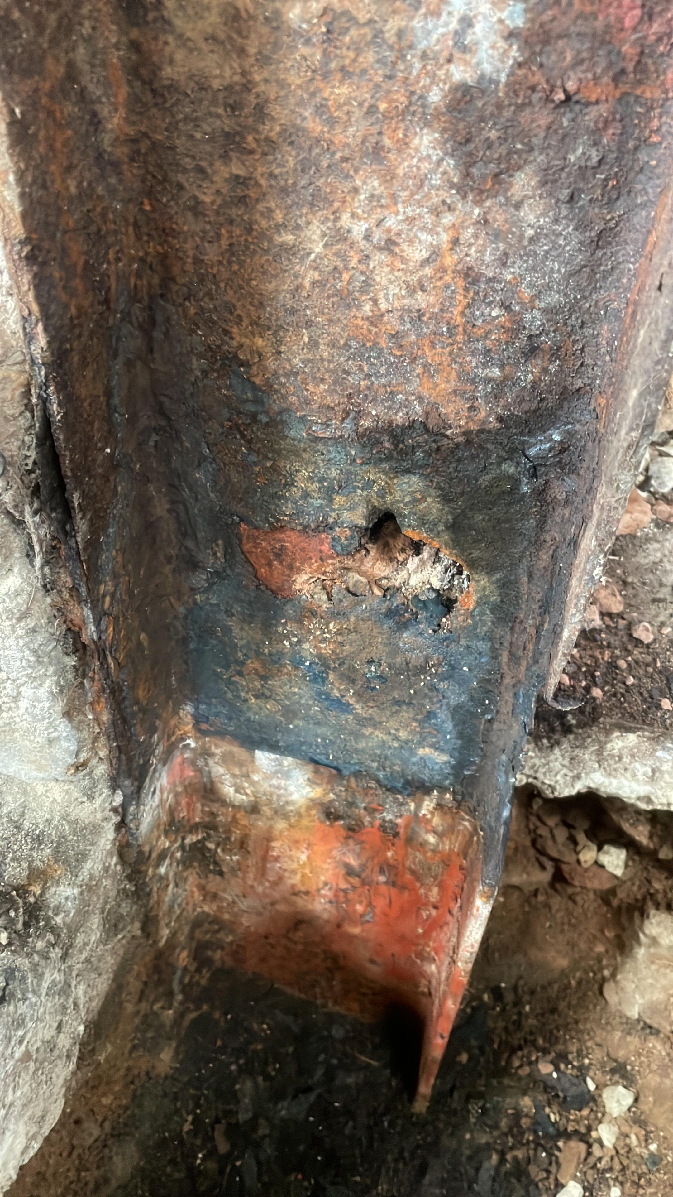

markc Posted February 24, 2023 Share Posted February 24, 2023 I have also seen a lot of corroded columns, once cut a wind brace and the column dropped about 4 inches because the foot had rotted away Link to comment Share on other sites More sharing options...
HughF Posted February 24, 2023 Share Posted February 24, 2023 This is the sort of mess I have to deal with... Link to comment Share on other sites More sharing options...
markc Posted February 24, 2023 Share Posted February 24, 2023 4 minutes ago, HughF said: This is the sort of mess I have to deal with... Yep, loads of farm building done with pocket founds, then you drop a steel or concrete column into the pocket, erected the building and then fill pocket with concrete. Unfortunately the pocket acts like a tank and holds any water that runs down the columns or pocket sides. Link to comment Share on other sites More sharing options...
HughF Posted February 24, 2023 Share Posted February 24, 2023 1 minute ago, markc said: Yep, loads of farm building done with pocket founds, then you drop a steel or concrete column into the pocket, erected the building and then fill pocket with concrete. Unfortunately the pocket acts like a tank and holds any water that runs down the columns or pocket sides. We use 45 gallon drums for our pole barn bottoms. Dig them into the ground, pole goes in, concrete it up. 1 Link to comment Share on other sites More sharing options...
markc Posted February 24, 2023 Share Posted February 24, 2023 2 minutes ago, HughF said: We use 45 gallon drums for our pole barn bottoms. Dig them into the ground, pole goes in, concrete it up. Yes, done that a few times too, at least this way you don’t form a tank Link to comment Share on other sites More sharing options...

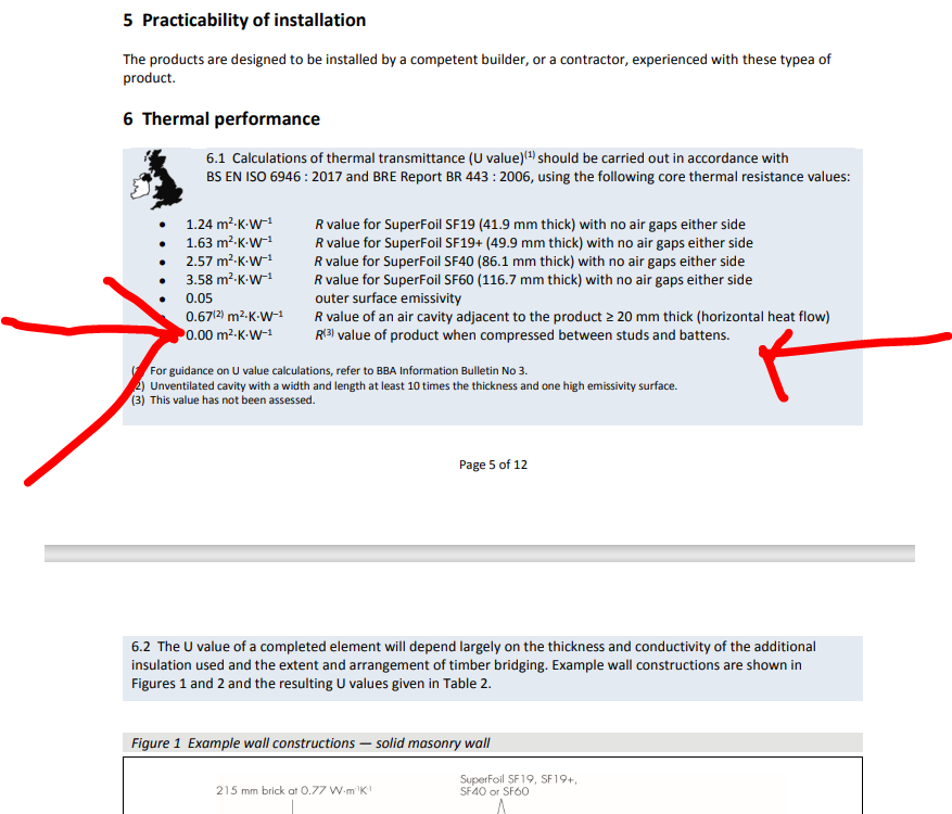

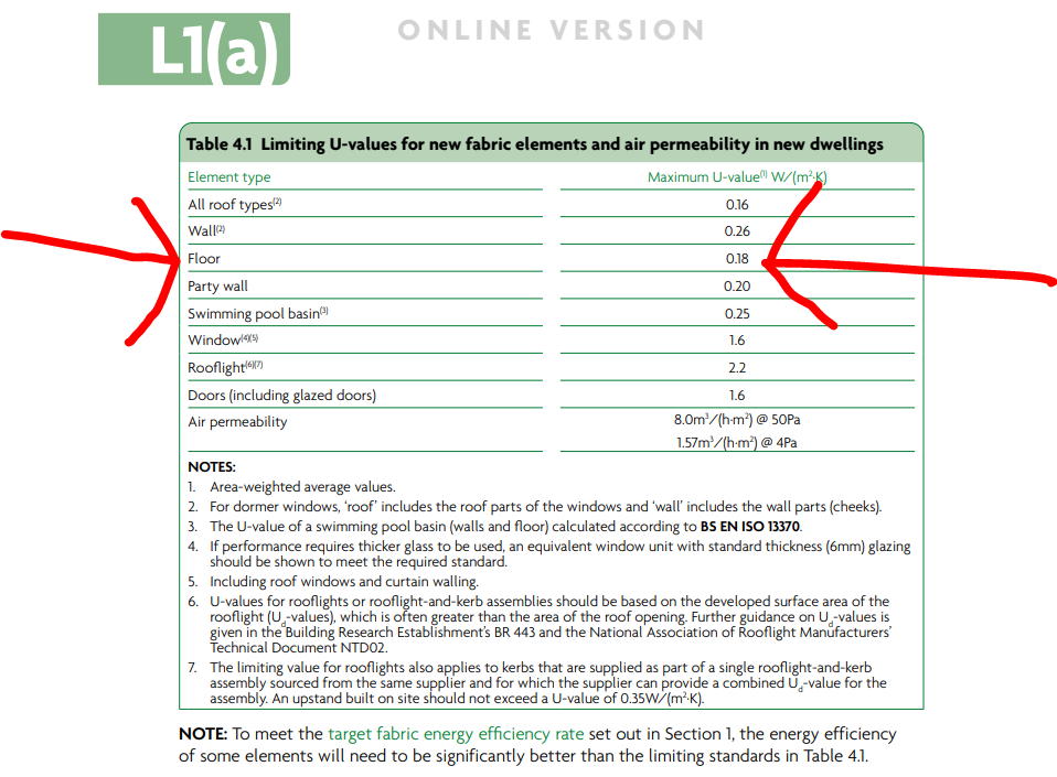

seano Posted February 24, 2023 Author Share Posted February 24, 2023 On 23/02/2023 at 11:43, Iceverge said: @seano That is 2 layers of OSB3 floating 1 layer of this for the UFH (its about £30/m2) 110mm of the K103 Phenolic insualtion @ about £55/m2. 157mm. Total £85/m2 not cheap. You could bin the UFH and use rads and save 25mm and just meet the 0.18W/m2/K limit with just 110mm K103 @ 132mm. Out of interest, what do you think of these calcs from Superfoil? Do you think this could work? We haven't yet decided on floor finish - could be stone, porcelain tile or wood. February 2023 - Sean O'Halloran - Solid Floor - 2x SFUF and 75mm PIR - 0.13.PDF Link to comment Share on other sites More sharing options...
Iceverge Posted February 24, 2023 Share Posted February 24, 2023 17 minutes ago, seano said: Out of interest, what do you think of these calcs from Superfoil? Do you think this could work? We haven't yet decided on floor finish - could be stone, porcelain tile or wood. February 2023 - Sean O'Halloran - Solid Floor - 2x SFUF and 75mm PIR - 0.13.PDF 487.87 kB · 0 downloads Not much I'm afraid. Even by their own (very optimistic) calculations you'd be better off replacing the 6mm+6mm of Superfoil with 12mm of PIR. Then you'd end up at about a U value of 0.025W/m2K without any shenanigans regarding ground conductivity and perimeter areas. There's no BBA cert for their floor products. From the BBA cert for their wall products if you squash it between studs and battens it has zero thermal resistance. It relies on stationary air (like most insulants) to give any thermal resistance. The low emissivity (shiny) foil may help in cold loft situations to keep temperatures lower under direct sunlight but it does almost nothing to keep the heat in. In short there's better places to put your money. Link to comment Share on other sites More sharing options...
seano Posted February 24, 2023 Author Share Posted February 24, 2023 On 23/02/2023 at 11:43, Iceverge said: @seano That is 2 layers of OSB3 floating 1 layer of this for the UFH (its about £30/m2) 110mm of the K103 Phenolic insualtion @ about £55/m2. 157mm. Total £85/m2 not cheap. You could bin the UFH and use rads and save 25mm and just meet the 0.18W/m2/K limit with just 110mm K103 @ 132mm. Me again. If we kept the UFH, would the floor finish (floorboards or porcelain tile, go ove the top of the build up you have illustrated or replace the top layer? Link to comment Share on other sites More sharing options...
Iceverge Posted February 24, 2023 Share Posted February 24, 2023 No my area of expertise I'm afraid. Porcelain would certain need something solid. I imagine it would be much the same as tiling over floorboards. Link to comment Share on other sites More sharing options...

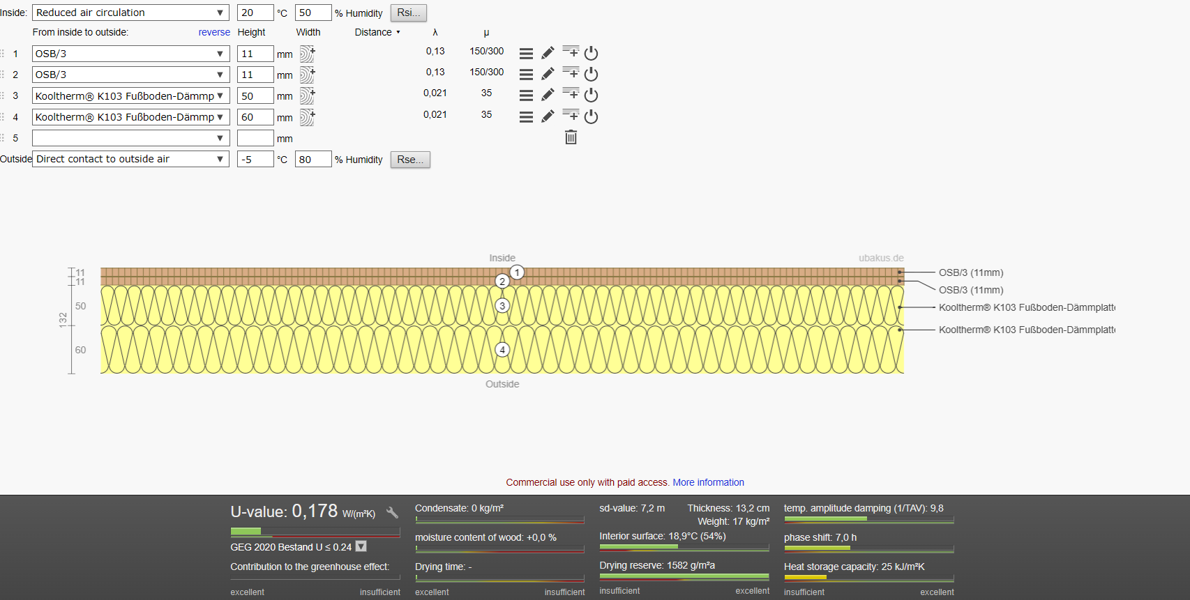

Iceverge Posted April 26, 2024 Share Posted April 26, 2024 To feel any heat through the engineered wood flooring you're going to need very high flow temps. This will kill the efficiency of any heating system, espically an ASHP and will exacerbate any downwards heat losses. As its an old conversion it'll lightly have higher heat losses and an intermittent heating strategy is probably the most economical. In this case you need to concentrate on heating the internal air rather than the structure. Get rid of the UFH and use large radiators. From your other post you have 100mm plus 70mm screed and engineered flooring planned. Let's say 20mm for that. Total 190mm. Phenolic insulation is slightly better than PIR but almost never worth it in a financial sense. This is my recommended build up: 20mm engineered flooring glued down. 18mm T&G OSB layed at 45deg to the engineered flooring, glued together. 50mm PIR 100mm PIR with joints staggered to upper layer. Levelling compound over concrete slab. U value about 0.14W/m2K. The engineered wood will be warm underfoot in any case but I would consider adding electric UFH matt on any tiled areas just for the extra comfort. Link to comment Share on other sites More sharing options...
