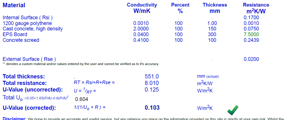

seano Posted February 20, 2023 Share Posted February 20, 2023 (edited) I'm new here and loving the knowledge of users. Were looking at converting a portal barn that already has PP. It has an offset ridge and so one roof slope cones down quite low at the eaves. We want to retain the existing concrete slab and insulate over it but want to find the thinnest material build up that will still meet regs for U values. So our bottom layer is 100-150 slab and top will be 65mm screed with UF heating. What can we put between these two? Thanks Edited February 20, 2023 by seano Link to comment Share on other sites More sharing options...
IanR Posted February 20, 2023 Share Posted February 20, 2023 13 minutes ago, seano said: I'm new here and loving the knowledge of users. Were looking at converting a portal barn that already has PP. It has an offset ridge and so one roof slope cones down quite low at the eaves. We want to retain the existing concrete slab and insulate over it but want to find the thinnest material build up that will still meet regs for U values. So our bottom layer is 100-150 slab and top will be 65mm screed with UF heating. What can we put between these two? Thanks Welcome @seano Ideally you'll want 200mm of PIR insulation so that the UFH is efficient. Regs will allow you to drop lower, but I'll let others say by how much as I've not looked at this since the U Values were recently changed. But, a few questions first. Do you own the barn? have you had a good look at the levels of the floor and the condition of the bottoms of the portal frame? Agricultural barns/sheds will typically have a fall on their slabs. If it was built for animals then it could be quite significant for draining slurry. My own had a 200mm fall from one end to the other. Often the base of the portal uprights, which are likely bolted to a foundation pad, are then concreted over when the slab gets poured. It can trap water, or worse, slurry, that can corrode steel columns, or the reinforcement of concrete columns. It may be worth considering taking the existing slab out, and digging a bit lower to install an new insulated raft foundation. 1 Link to comment Share on other sites More sharing options...
Nickfromwales Posted February 20, 2023 Share Posted February 20, 2023 2 minutes ago, IanR said: It may be worth considering taking the existing slab out, and digging a bit lower to install an new insulated raft foundation. There's no "may" about it, and it would be the best money spent. Ola @seano, welcome to the madhouse 28 minutes ago, seano said: We want to retain the existing concrete slab and insulate over it but want to find the thinnest material build up that will still meet regs for U values. If I can be blunt, no, you do not want to. It doesn't sound like you'd have room to ad the minimum 140mm of phenolic rigid insulation which would be the very minimum insulation I'd ever install for a client if they wanted UFH. If the SE says this can all be dug out, then please do so! You'll need to examine the foundations first and strategize how this could be done ( by leaving sufficient undisturbed ground around footings / pads etc, but it would be well worth the effort. Plus, you'd end up with a new, flat, even slab to have underfoot. FYI, the UFH pipes would then reside in the concrete and all the insulation would go under the, then, constructional slab. 2 Link to comment Share on other sites More sharing options...

Dave Jones Posted February 21, 2023 Share Posted February 21, 2023 you want 300mm of XPS, its a simple job to get the floor up (drains ???) and do the job properly. Link to comment Share on other sites More sharing options...

Nickfromwales Posted February 21, 2023 Share Posted February 21, 2023 1 hour ago, Dave Jones said: you want 300mm of XPS, its a simple job to get the floor up (drains ???) and do the job properly. 200mm of XPS or 300mm of EPS ( much cheaper but you need to cost for the extra excavations / muck-away then ) so I'd go with 200mm of rigid which will be around Passiv standards. 300mm unnecessary. 1 Link to comment Share on other sites More sharing options...
Nickfromwales Posted February 21, 2023 Share Posted February 21, 2023 240m2 / 2.88 ( an 8x4 sheet ) = 83 sheets for minimum advised thickness of 150mm of insulation. 83 x £75 = £5,810 for 150mm of kingspan / cellotex ( you may get cheaper using seconds / damaged boards ). Then you'll need prob 120mm of RC35 concrete, laid in sections with expansion joints, with reinforcing / anti-crack mesh, and then UFH pipes get zip=tied to the mesh prior to the pour. You'll need sand blinding, then 25mm of EPS as a sacrificial layer, then the DPM, plus some perimeter insulation skirting ( 30mm PIR ). Not inconsequential amounts of money / labour as that's a big old floor! 1 Link to comment Share on other sites More sharing options...

Dave Jones Posted February 21, 2023 Share Posted February 21, 2023 52 minutes ago, Nickfromwales said: 240m2 / 2.88 ( an 8x4 sheet ) = 83 sheets for minimum advised thickness of 150mm of insulation. 83 x £75 = £5,810 for 150mm of kingspan / cellotex ( you may get cheaper using seconds / damaged boards ). Then you'll need prob 120mm of RC35 concrete, laid in sections with expansion joints, with reinforcing / anti-crack mesh, and then UFH pipes get zip=tied to the mesh prior to the pour. You'll need sand blinding, then 25mm of EPS as a sacrificial layer, then the DPM, plus some perimeter insulation skirting ( 30mm PIR ). Not inconsequential amounts of money / labour as that's a big old floor! your right of course regarding muckaways but 300mm of XPS is still 40% cheaper than 150mm celotex for a much better U value. Link to comment Share on other sites More sharing options...
Nickfromwales Posted February 21, 2023 Share Posted February 21, 2023 17 minutes ago, Dave Jones said: but 300mm of XPS is still 40% cheaper than 150mm celotex for a much better U value. Where have you been getting prices? Link to comment Share on other sites More sharing options...
Dave Jones Posted February 21, 2023 Share Posted February 21, 2023 (edited) https://flooringwarehousedirect.co.uk/product/jablite-polystyrene-insulation-board-150mm-eps70-2400mm-x-1200mm/ Travis are cheaper for us though at £6.25 /m2 Edited February 21, 2023 by Dave Jones Link to comment Share on other sites More sharing options...

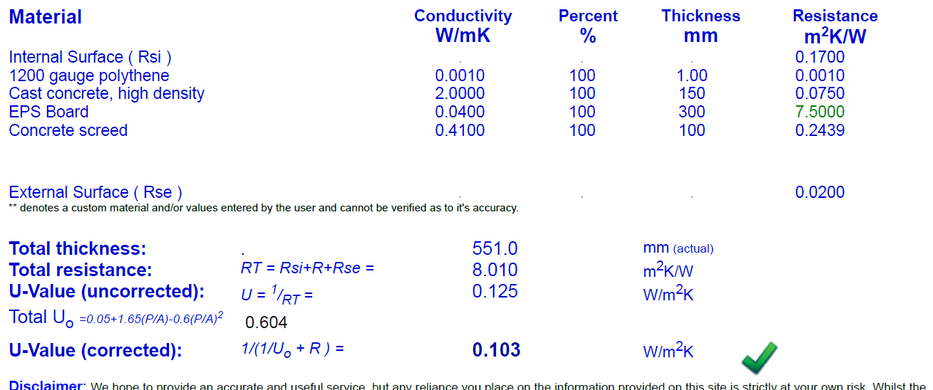

Dave Jones Posted February 21, 2023 Share Posted February 21, 2023 (edited) 50 minutes ago, dpmiller said: XPS and EPS are a wee bit different y'know... i was referring to and linked EPS, unfortunately i have dyslexia so autocorrect doesn't always catch everything. Here is the standard buildup giving a U value of 0.103 against a min spec of 0.13 Edited February 21, 2023 by Dave Jones 2 Link to comment Share on other sites More sharing options...
Chanmenie Posted February 21, 2023 Share Posted February 21, 2023 So 2 layers to give 300mm at £30 a sheet is £60 plus the extra muck away won’t be much if any cheaper than 200mm PIR. I used 2 layers of 100mm Celotex so 88 sheets £4500 1 Link to comment Share on other sites More sharing options...
