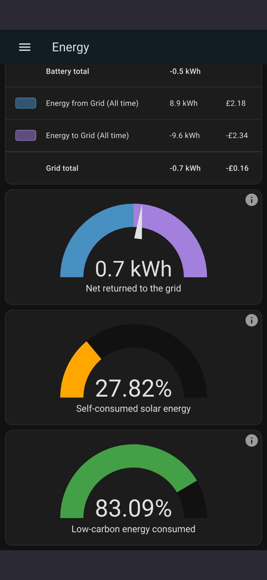

Nick Thomas Posted March 18, 2023 Share Posted March 18, 2023 On 16/03/2023 at 15:38, S2D2 said: I've skipped the force discharge for now as I only have a small battery so it gets used between 7pm and 2am.  I guess exporting at 35p/kWh isn't *that* different to importing at 33p 😅  Yesterday was a nice sunny day. As a result, I exported lots and managed to break even (I think for the first time since I got the solar panels installed last autumn):   Summer is going to be great.  4 Link to comment Share on other sites More sharing options...

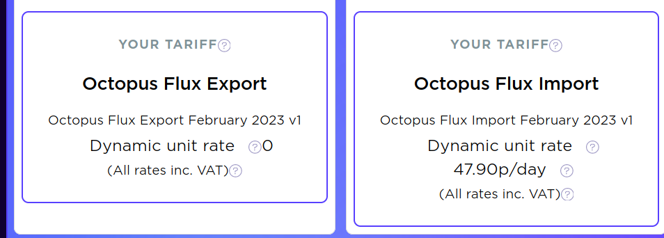

MikeGrahamT21 Posted April 21, 2023 Share Posted April 21, 2023 On 15/02/2023 at 17:03, pocster said: Anyone else looking at this ?? Â Â Â The prices are now available by region, this is mine: Â Link to comment Share on other sites More sharing options...
SteamyTea Posted April 21, 2023 Share Posted April 21, 2023 1 hour ago, MikeGrahamT21 said: The prices are now available by region Do you have a link to the regional prices. Be interesting to see what they are charging in one of the poorest places in the UK. Link to comment Share on other sites More sharing options...

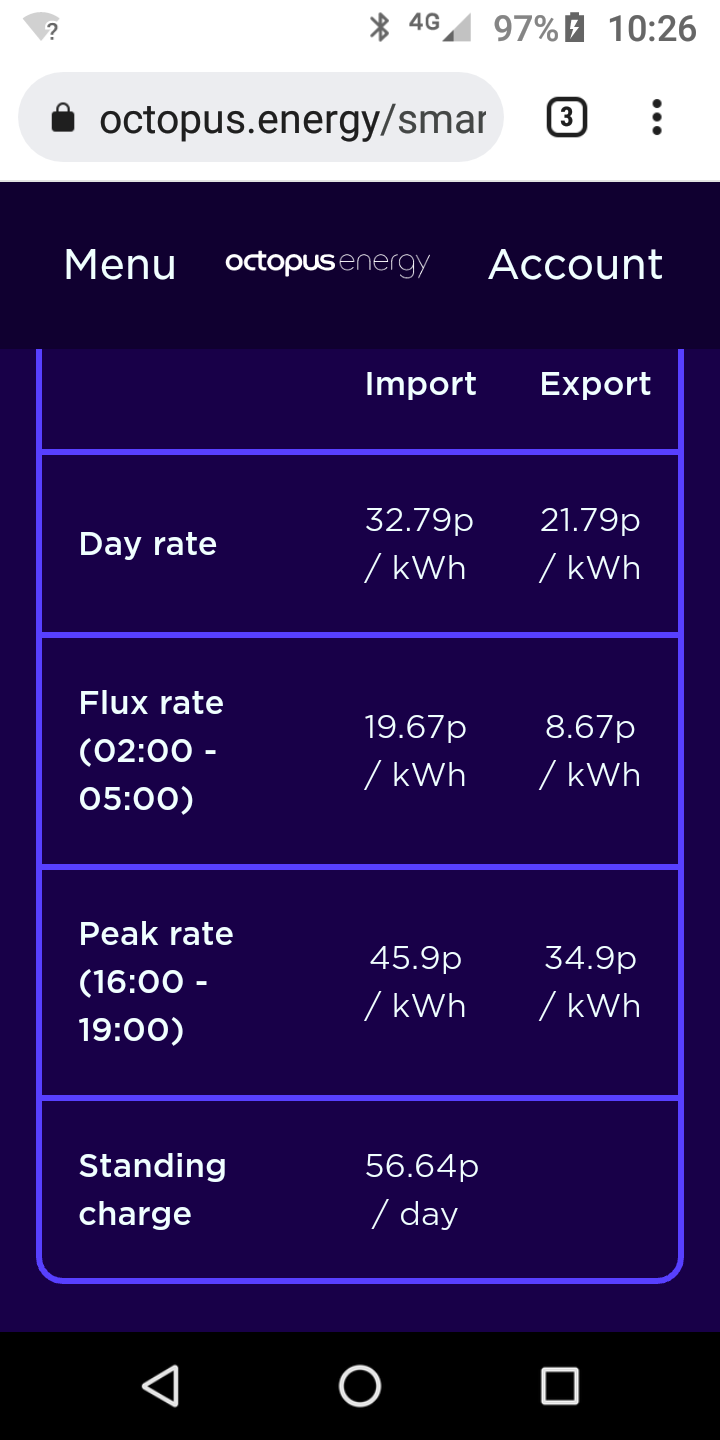

Ronski Posted April 21, 2023 Share Posted April 21, 2023 You can check rates at https://octopus.energy/smart/flux/ just scroll down the page. Link to comment Share on other sites More sharing options...
SteamyTea Posted April 21, 2023 Share Posted April 21, 2023 (edited) Seems to be the same, almost. Â Edited April 21, 2023 by SteamyTea Link to comment Share on other sites More sharing options...
Dave Jones Posted April 21, 2023 Share Posted April 21, 2023 do read this correctly, you are paid 34.9p kw/h if you export during peak rate ?  Why not arbitrage it with a battery, charge at cheap export at peak ?  greenenergy uk off peak is 9.52p kw/h which is what i ise to charge up the powerwall if it needs it. Link to comment Share on other sites More sharing options...
