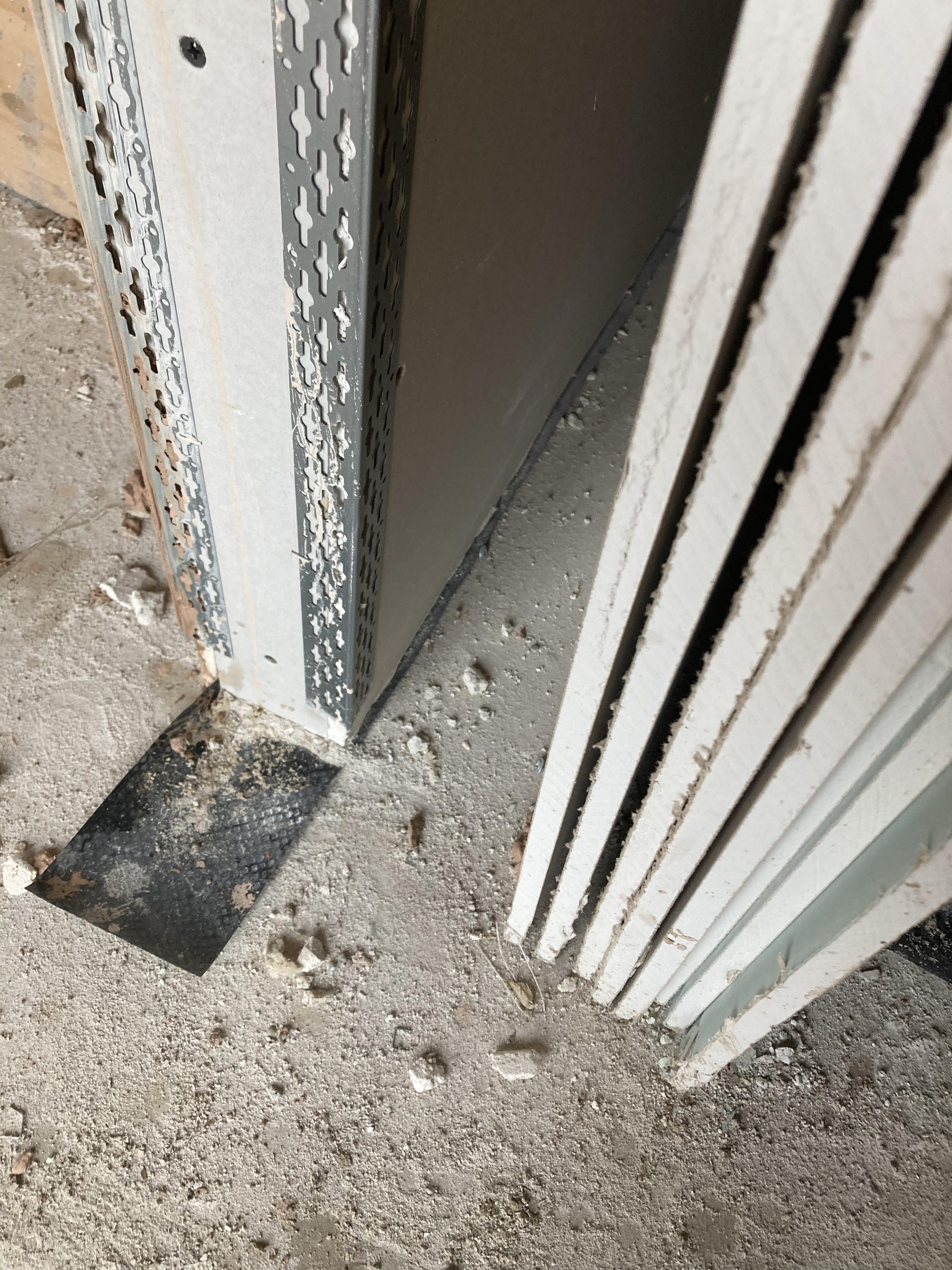

Dave Jones Posted February 15, 2023 Posted February 15, 2023 On 15/02/2023 at 12:08, BotusBuild said: I thought the answer might be Yes. Reaction: Feck! 🙂 "Hey, get those acroprops out again!!" 🙂 Expand if the stud is already in I wouldn't worry about it. 1
deancatherine09 Posted February 28, 2023 Posted February 28, 2023 We have MBC on site at the moment and they have put DPC under all stud walls even though there is a DPM under the concrete in the insulated raft 🙂 1
Iceverge Posted February 28, 2023 Posted February 28, 2023 I also wouldn't worry about it. In fact I'm against it. Putting in impermeable membranes "just because" is a bad plan. When building my garage, TF on blockwork, I put one DPC under one sole plate. It was saturated as the moisture was trapped in the gap between the timber and the DPC. Mostly from rain during construction mind you .On the rest I didn't bother and they got wet but dried super fast in comparison. You're not trapping water in there permanently. I didn't bother either for the few stud walls in the house we have and absolutely nothing went wrong. Timber never got wet. 1
Dave Jones Posted February 28, 2023 Posted February 28, 2023 it is an NHBC requirement. https://nhbc-standards.co.uk/6-superstructure-excluding-roofs/6-3-internal-walls/6-3-13-damp-proof-courses/
