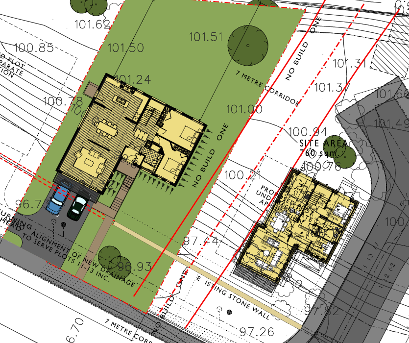

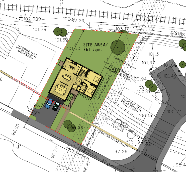

Ferdinand Posted July 23, 2017 Posted July 23, 2017 (edited) 2 hours ago, Sjk said: I've got plans which show where the services are, they are all within a few meters of the plot. So fingers crossed it wouldn't be too expensive although I'm ready to be shocked! The seller knows I need finance etc. Although it is a risk, I don't think the council are out to screw me in this way. They have sold off a few similar plots recently. @SjkIt was more services going elsewhere through your plot that I was warning about. There's a member here with a major oil pipeline going through .. but this is more stuff they might not have told you about such as sewers and electricity going to other people. Councils sometime have form here. That is about mitigating risk as far as you can before sinking money into a potential hole of indeterminate size. If they aren't out to screw you then they will relax the 7 days if asked when you have provided a reasoned justification. GIving you 4-6 months should be quicker than marching all the way back down the hill and up again. If they have sold off other similar plots then I would also consider going and knocking on a few doors and having a few candid but cautious conversations about the Council's approach. If there are people still in residence who bought the plots they will enjoy telling you how well they did or may take a grim satisfaction in telling their war stories. You may need to be circumspect about the particular plot, but it should be possible to find some things out. IF you find your local property professional and pay them for some advice they may well know some background; if the Council are acting aggressively the property grapevine will know - another reason for finding a HOG with deep local roots. That is also about identifying unknown unknowns. Edited July 23, 2017 by Ferdinand 1

Sjk Posted July 23, 2017 Author Posted July 23, 2017 Thanks again all. A major oil pipe, Jesus! Has anyone used the Build It estimating service? Maybe it's better to just use a quantity surveyor.
Jeremy Harris Posted July 23, 2017 Posted July 23, 2017 (edited) 15 minutes ago, Sjk said: Thanks again all. A major oil pipe, Jesus! Has anyone used the Build It estimating service? Maybe it's better to just use a quantity surveyor. Members here have had to deal with all sorts, from a major oil pipeline with a wide "no build zone" either side, to buried HV cables that have similar restrictions. A very big problem is that plans for things like this, and services, are often very wildly inaccurate, so if there is even a hint that there may be a pipe or cable near the plot it is very wise to check exactly where it is. As an example, have a read of this post, which is far from untypical when it comes to the accuracy of plans: Edited July 23, 2017 by JSHarris 1

Ferdinand Posted July 23, 2017 Posted July 23, 2017 (edited) On the pipeline, it is not that it was there, it was that the documentation said it was in the wrong place. They believed it was a known known where it was actually a known unknown. Our member @AliMcLeod came off alright when the pipeline wasn't where the plans said it was, but the neighbour had to move the corner of his house inwards by nearly 4m. I do not know how the neighbour identified and managed the risk of the pipeline plan being wrong, but he should have had a clause in the purchase contract for a holdover or a chargeback based on the lost value if the pipe was not as believed, or could alternatively have sat on his hands until the constraint had been properly identified by a survey. The most important thing I ever say on here (apart from about HOGs and construction cocktails, to which I need to add a Harvey Wallbanger to drink when a wall collapses), is the Risk vs Money vs Time tradeoff. When you choose not to spend adequate time now, you choose to spend more money later. Your job is to find all potential risks to your build, and eventually get to the point where you are confident that the money you are offering is an appropriate number vs the initial price given the risks you have identified, and your strategies that will manage those risks and the related cost. It is a very old principle that a risk or elephant trap not identified until one further stage in the project will cost perhaps an order of magnitude more money to fix. eg Has the existing building got asbestos? Is there a neighbour dispute, a covenant or a ransom strip? Do you have the right to drive out onto the road? What is past use and is the ground full of contamination (b****y expensive)? Are there trees with TPOs that will add 15k to your build costs? Are there birds, bees, bats or brown bears in the trees that will stop you removing some first? Are there any substations around - where do the wires go? You need to decide how much money and time you will spend on identifying risks, and eventually - just like those 10 word slogan competitions, use your skill and judgement to make your decision. You cannot negotiate the price wrt to something that you do not find until later. There was one on Homes Under the Hammer recently where some romantic people bought a site of a set of former Council Garages, and after purchase found about a dozen electricity supplies crossing where they wanted to build a house. Pricey to move - like 10k+ . Tip: as well as FOI-ing the entire planning file, also FOI any material talking about the potential sale. Who knows, a Planner may have warned to Head of Assets that PP was unlikely (or likely) on the record. F Edited July 23, 2017 by Ferdinand 1

Ferdinand Posted July 23, 2017 Posted July 23, 2017 (edited) The pipeline maps from the linked post. What the official drawing on the Approved Plans said: Where it actually turned out to be: Caveat Aedifex :-) They basically lost 8-12 ft off one side of a tight plot. (That's me done on this topic ... things to do). Edited July 23, 2017 by Ferdinand 1
