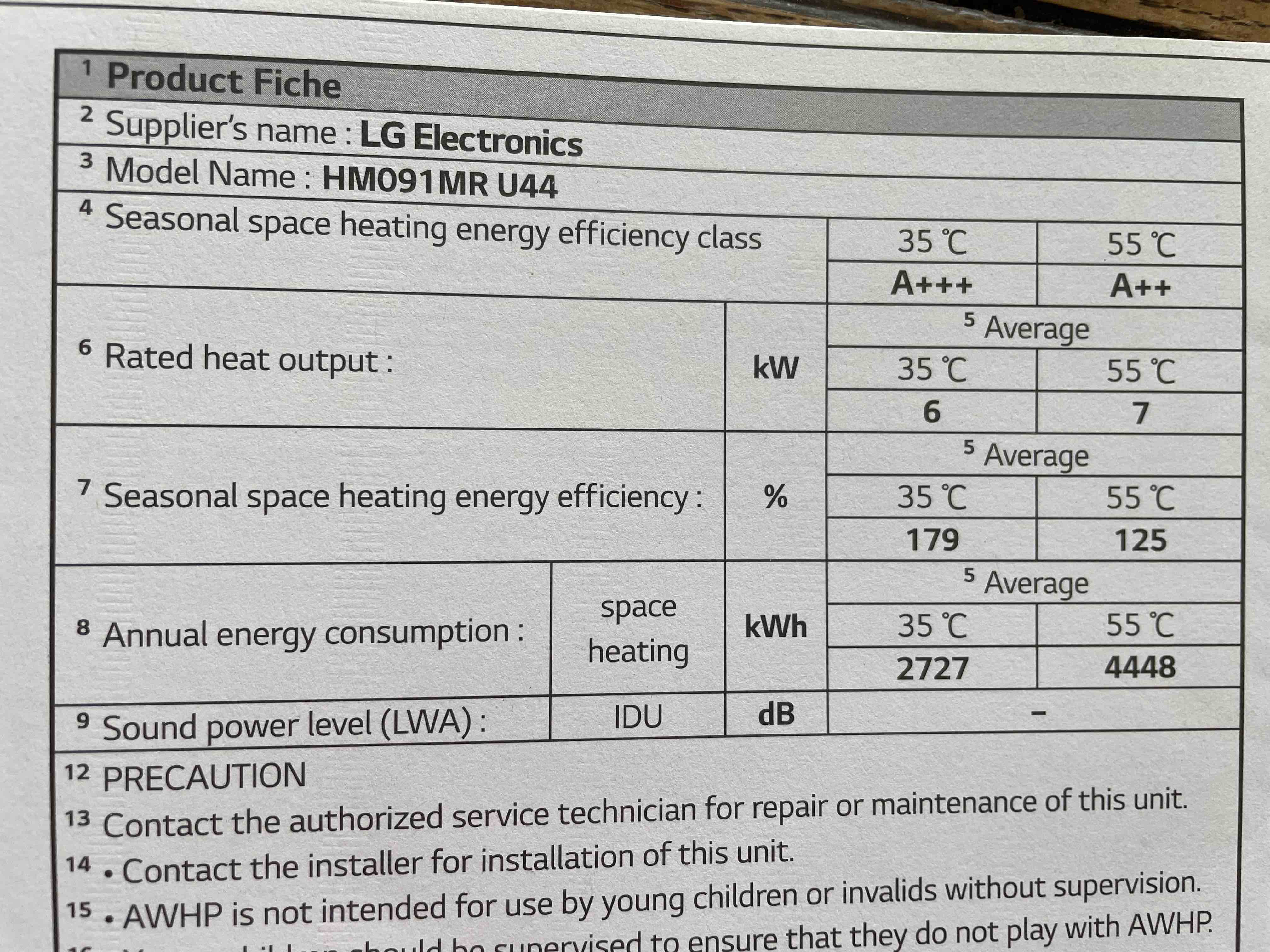

HandyAndy Posted February 8, 2023 Posted February 8, 2023 I’d like to test my experience with an ASHP installation which I’ve been unsuccessfully discussing with the installer.  It’s in a 1960s 3-bed detached house in Fife which I’m in the process of improving thermally (triple glazing, better roof insulation), and extending (50m2 extra including 1 more bedroom/ bathroom; an en-suite; and bigger kitchen/dining room). The system is based on an LG Therma V ASHP (9kw), with a 200 litre thermal store. The store is used to provide both heating and hot water. New radiators have been installed throughout, which are connected using plastic pipe (15mm for main flow and return, with 10mm supplies to each radiator).  The system didn’t perform particularly well during the winter, when it appeared to struggle to produce hot water and heating has been variable (some rooms are hot, others cold even with radiators on maximum). The supplier thinks I’m not using the system appropriately (and to be fair, we have learned as we’ve gone on), but he has been unable or unwilling to explain how he has designed the system to meet current and future needs. As examples: 1.     Initial demand was calculated at 7250W, which I was assured would still leave 1750W capacity for the extension. But it appears that the actual output of the pump in Scotland is 7kW – so already appears to be under-powered. He tells me these figures are not relevant 2.     10mm pipes appear to go against MCS recommendations, which say they will rarely provide the output needed. A practical impact of this appears to be that the radiators furthest from the thermal store are the coldest (though he also admits that the system has not been properly balanced) 3.     The installer says that the temperature drop across the radiators is irrelevant and does not need to be taken account of when sizing radiators. I’m surprised – a quick calculation using the Stelrad tool suggests it makes a big difference 4.     Having one bath makes a fairly substantial drop in the TS (say 5’C). The supplier suggests this can be overcome by temporarily increasing the temperature to 60’C before a bath. Apart from the faff, I can’t see this being an efficient way to run the pump  While I think these are questions he should be able to answer, I’m beginning to question whether I’m talking sense or not. I’d hugely appreciate views, and quite happy to be told I’m wrong!

mike2016 Posted February 8, 2023 Posted February 8, 2023 Ouch! One of the reasons I'm getting an independent design for my new build in advance and that's what the installer will have to deliver. Try a heatgeek / their youtube channel for some videos and see if there is one in your area you could chat to? There's excellent knowledge here as always too. Just confused about the expected SCOP - if it's a 9kW heat pump and the heating load is 9kW - surely with a COP of 2 or 3 it should be able to ramp up more than enough heat to warm up the rooms? I wonder what size / model the Gas boiler was? Was any grant forthcoming, if so you should be entitled to the paperwork from someone and hopefully access to the figures used? What is the flow and return heat showing on the controller, does it have a big drop, what length of run is it / how many rads? Anyway, sorry to hear it's struggling and hope you get to the bottom of it soon Â

Nickfromwales Posted February 8, 2023 Posted February 8, 2023 4 hours ago, HandyAndy said: The system is based on an LG Therma V ASHP (9kw), with a 200 litre thermal store. The store is used to provide both heating and hot water. New radiators have been installed throughout, which are connected using plastic pipe (15mm for main flow and return, with 10mm supplies to each radiator).  15 minutes ago, PeterW said: He’s an idiot… Peter is correct. 10mm runs should only ever come off 22mm 'main' pipework. 10mm pushfit off 15mm pushfit is 1st year apprentice plumbing. Did you have to give this one a bottle of warm milk every 4 hours?  For your build / fabric type I think 9kW is way too low an output. If there NEEDS to be a thermal store, then the ASHP should have been spec'd as a high-temp split. Not the best I'm afraid.
Temp Posted February 8, 2023 Posted February 8, 2023 1 hour ago, mike2016 said: Just confused about the expected SCOP - if it's a 9kW heat pump and the heating load is 9kW - surely with a COP of 2 or 3 it should be able to ramp up more than enough heat to warm up the rooms?  I assume its a 9kW output model.  If Im looking at the right model here.. https://www.lg.com/uk/heating-awhp/monobloc I think it can manage 8.5kW with -15C Air temp and 55C flow temperature.
HandyAndy Posted February 10, 2023 Author Posted February 10, 2023 All. thanks for the various replies and at least making me laugh with the comments and advice ...  On 08/02/2023 at 19:17, mike2016 said: Just confused about the expected SCOP - if it's a 9kW heat pump and the heating load is 9kW - surely with a COP of 2 or 3 it should be able to ramp up more than enough heat to warm up the rooms? I wonder what size / model the Gas boiler was? Was any grant forthcoming, if so you should be entitled to the paperwork from someone and hopefully access to the figures used? What is the flow and return heat showing on the controller, does it have a big drop, what length of run is it / how many rads?  There are 12 radiators currently; it's a 2 storey house so not massive drop; max distance from thermal store to outlying radiator is c 18m; and flow/return to and from the heat pump ranges from 51-44 to 59-52 in the monitoring I've done in the last day when there's been no heat demand. Oh, and it's a 9kW output model ASHP.  On 08/02/2023 at 20:23, PeterW said: @HandyAndy is this a plate heat exchanger thermal store or a coil one..? Probably a McDonald Engineering one if you’re north of the border .. System is set to 55'C. It does appear to maintain 55'C when there is no DHW demand, though when that kicks in the store temperature drops 7-8'C. You're right, it is a Macdonald store, and has a 3m2 coil.  On 08/02/2023 at 20:43, Nickfromwales said: 10mm runs should only ever come off 22mm 'main' pipework. 10mm pushfit off 15mm pushfit is 1st year apprentice plumbing. Did you have to give this one a bottle of warm milk every 4 hours?  For your build / fabric type I think 9kW is way too low an output. If there NEEDS to be a thermal store, then the ASHP should have been spec'd as a high-temp split. Not the best I'm afraid.  On 08/02/2023 at 21:03, Temp said:  I assume its a 9kW output model.  If Im looking at the right model here.. https://www.lg.com/uk/heating-awhp/monobloc I think it can manage 8.5kW with -15C Air temp and 55C flow temperature. @Temp I think it was a 24kW boiler previously; interesting re the heating capability of the ThermaV: the product fiche it came with suggests 7kW rated heat output (though I now see this is "average", however they calculate that). So at least that's slightly reassuring, though probably only tinkering at the edges ...  It would be tempting just to let it lie given his stonewalling and trying to blame user error for the performance though think I'll continue with NAPIT process (who I think have been helpful so far) - and hope that escalating will mean they involve an independent technical person to mediate between us. I'll let you know how it goes if useful to forum members.
