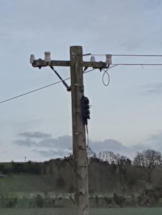

Susie Posted September 5, 2023 Posted September 5, 2023 It appears OR don’t have one set of rules for all installations. they gave me for free the ducting a large junction box with manhole cover a huge pull cord and the cable. It’s all on my land except the last metre which goes to the pole at the boundary with my neighbour. we haven’t even started the foundations yet.

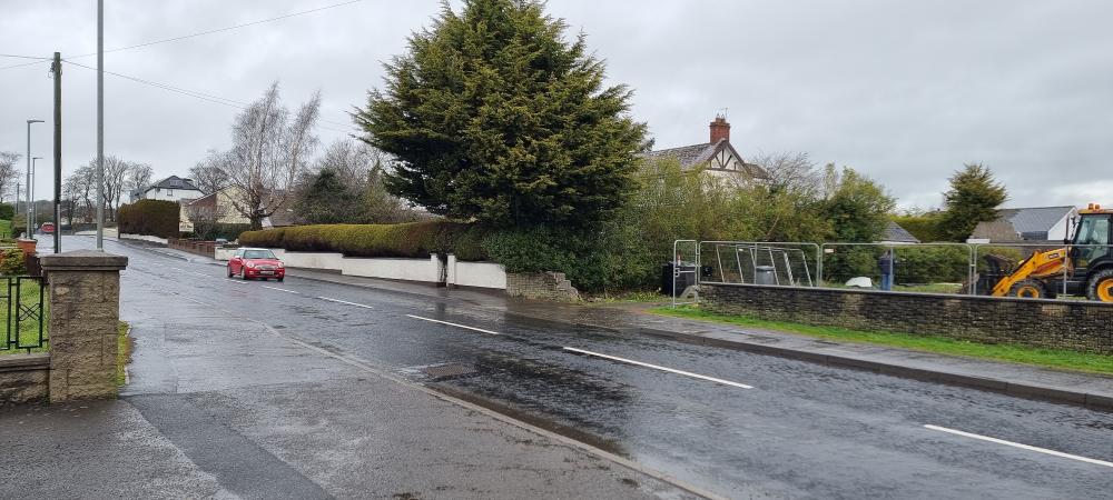

LSB Posted September 5, 2023 Posted September 5, 2023 2 hours ago, Susie said: It appears OR don’t have one set of rules for all installations. they gave me for free the ducting a large junction box with manhole cover a huge pull cord and the cable. It’s all on my land except the last metre which goes to the pole at the boundary with my neighbour. we haven’t even started the foundations yet. ours is not quite that simple. pole the other side of the road blocked by our current house, next pole 200+m up the road, so I think they will need a new pole, or go under the road. But how do they know, they haven't done a survey, our current house has fibre from about 2 months ago

LSB Posted September 6, 2023 Posted September 6, 2023 15 minutes ago, Susie said: I didn’t need any road closures it’s all on private land 99m on mine and 1m on neighbour. we wouldn't need a road closure if they used poles, would do it they went underneath. when they put in our fibre in June they didn't have to close the road, I wasn't watching, but I guess he must have just thrown it over the road, it is very quiet though.
