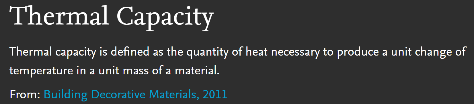

RobLe Posted February 2, 2023 Posted February 2, 2023 If a house is continuously occupied, then insulation is best placed externally. Or in a very wide brick cavity. Either way, you'll end up with a high thermal capacity. Thermal capacity is then desirable - fewer overheating events, easier to "ride through" a cold snap. On the flip side - if you only use the house 10% of the time, high thermal capacity is wasteful - it's cold at first, it costs money to heat it all up, and that's all wasted if later you're not there! IWI is then more appropriate. 1
